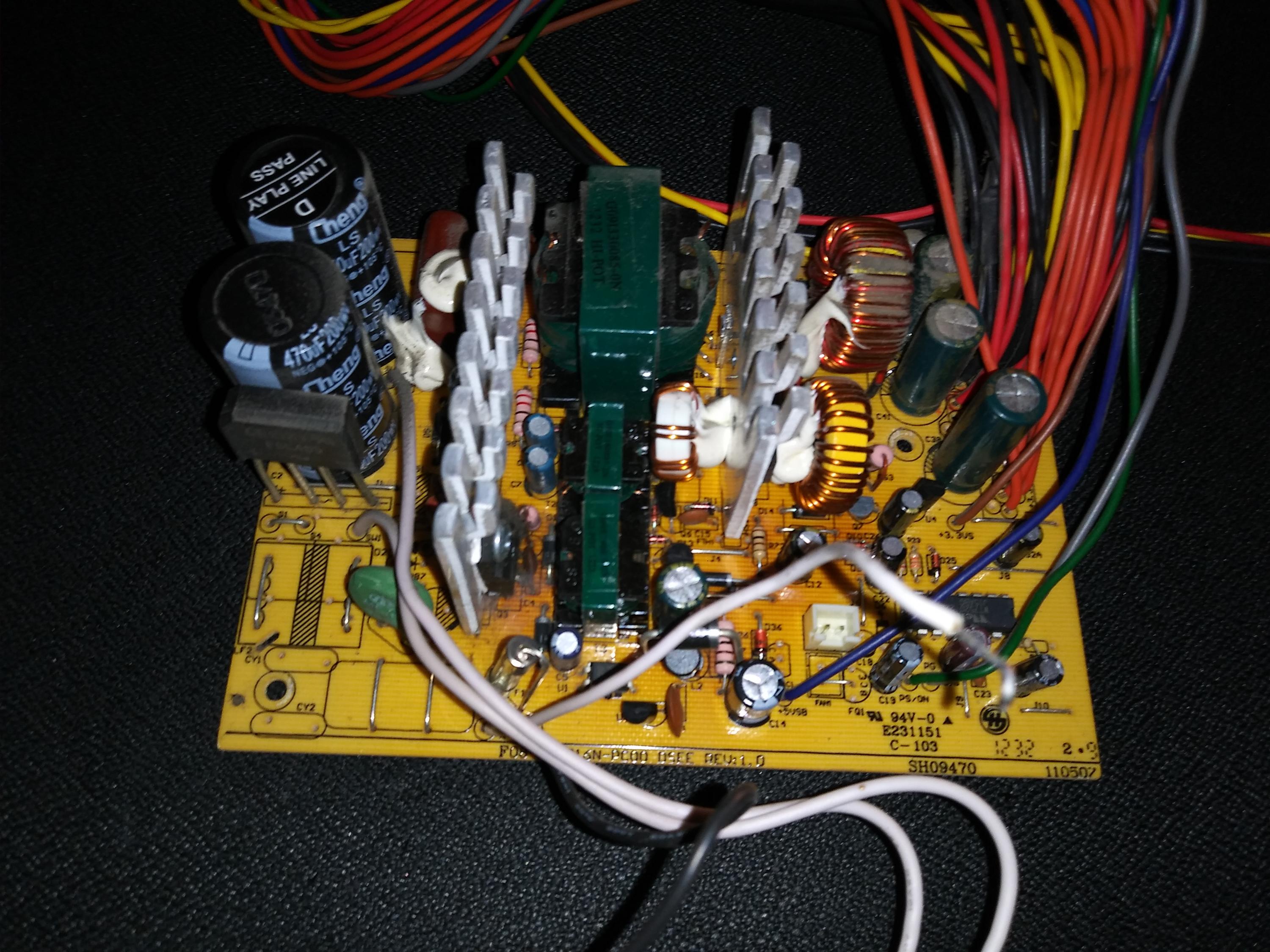

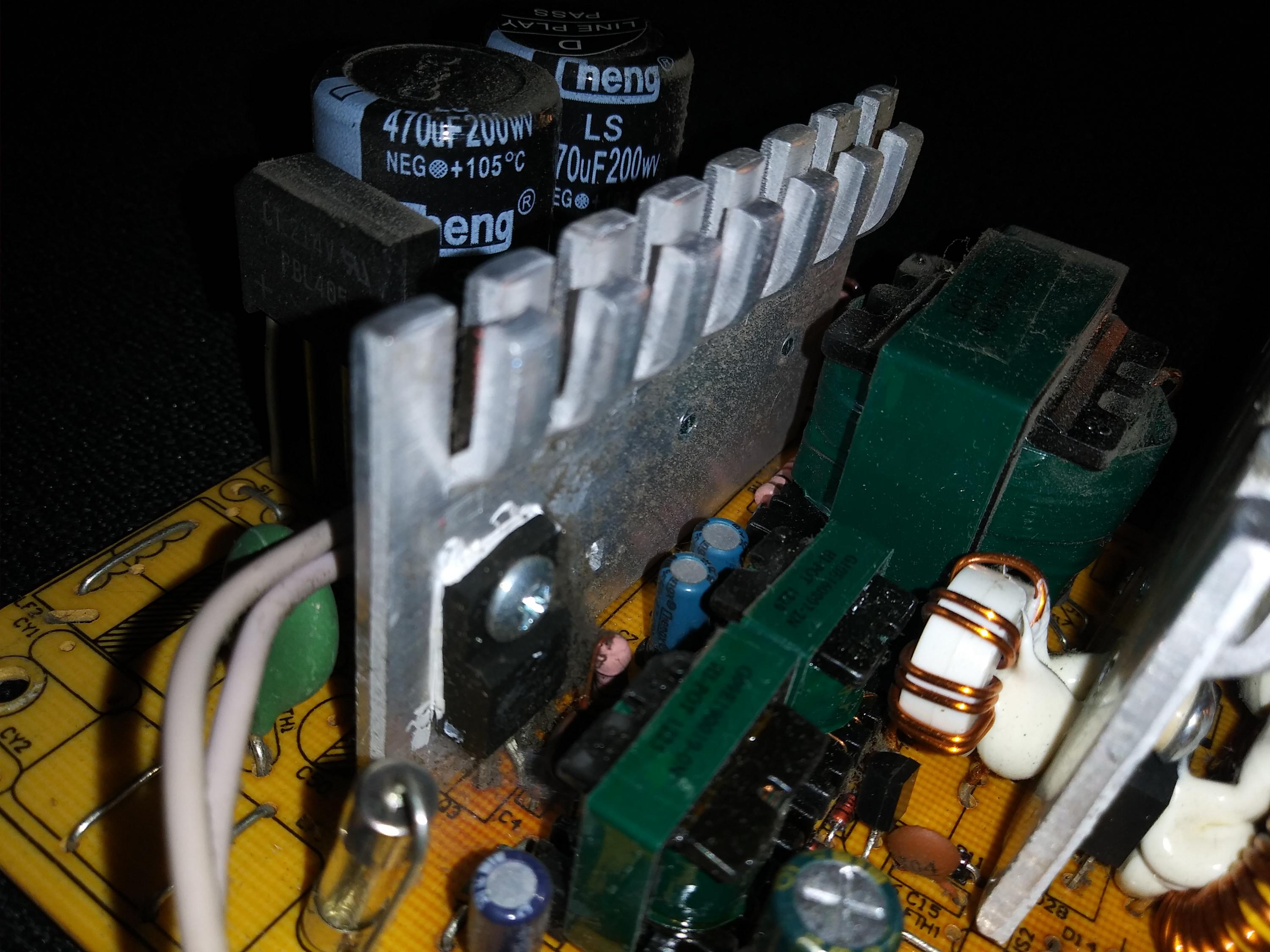

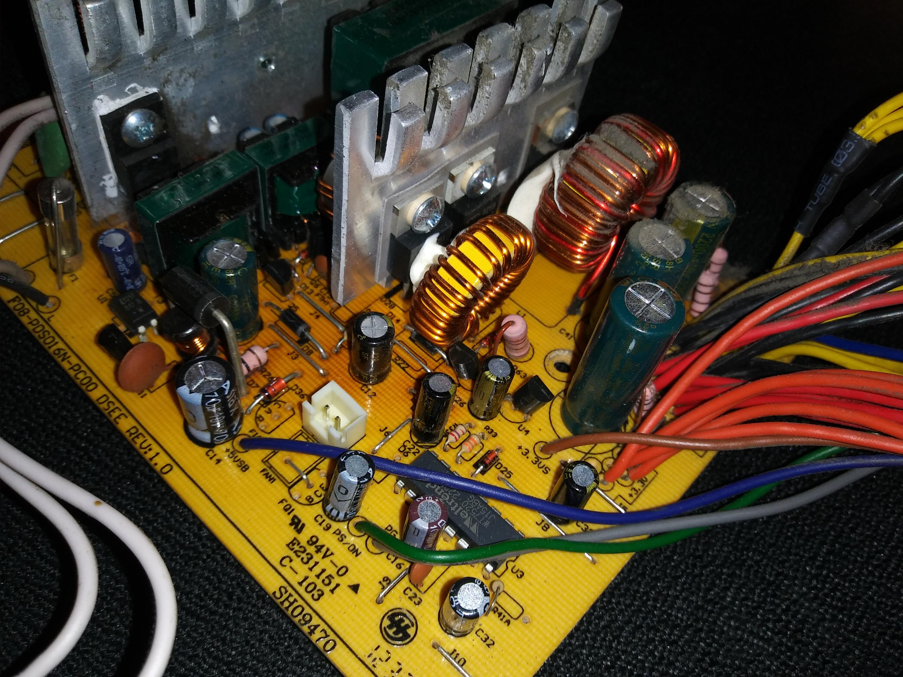

              Rhino PSU, Model: SP-450Y 450w PC Power Supply.
              I think this unit may have overheated.
              Label.............
              Looks cheap.
              Top Side..................
              Bottom Side.............................
              Soldering looks bad.
              Primary side..........................................
              There are no common mode chokes, X-class capacitors or Y-class capacitors at all
              The primary caps are 2 Cheng LS 470uf 200v.
              The primary switching transistors are two KSH13009A's.
              The 5VSB Mosfet is an SVF2N60F.
              There is a fuse, not sure how good it is though.
              Secondary side......................................................
              The capacitors are a mix of ChengX CD288H, GR, SF, and Asia'X TNX.
              The 3.3v rail and 5v rail both use MBR3045CT diodes.
              The 12v rail uses the STTH1602CT diode.
              The 3.3v rail has one 3300uf 10v capacitor with no PI coil.
              Both the 5v and 12v rails have one 2200uf 16v capacitor with no PI coil.
              And the fan............................................................................
              The fan is seized up and it looks like the motor got really hot, there was also a plastic sheet in front of half the fan but I removed it before taking the photo.
              Overall this thing is and will always be garbage.

                Looks like they copied a bunch of crappy brands - Raidmax for the label, Deer for the heatsinks and possibly Linkworld for the PCB design.

                    With those heatsinks and the 470uF input lytics that might be a credible 250W PSU. 450W? Extra crispy.
                      Those always seem to be rated twice what they can barely do.

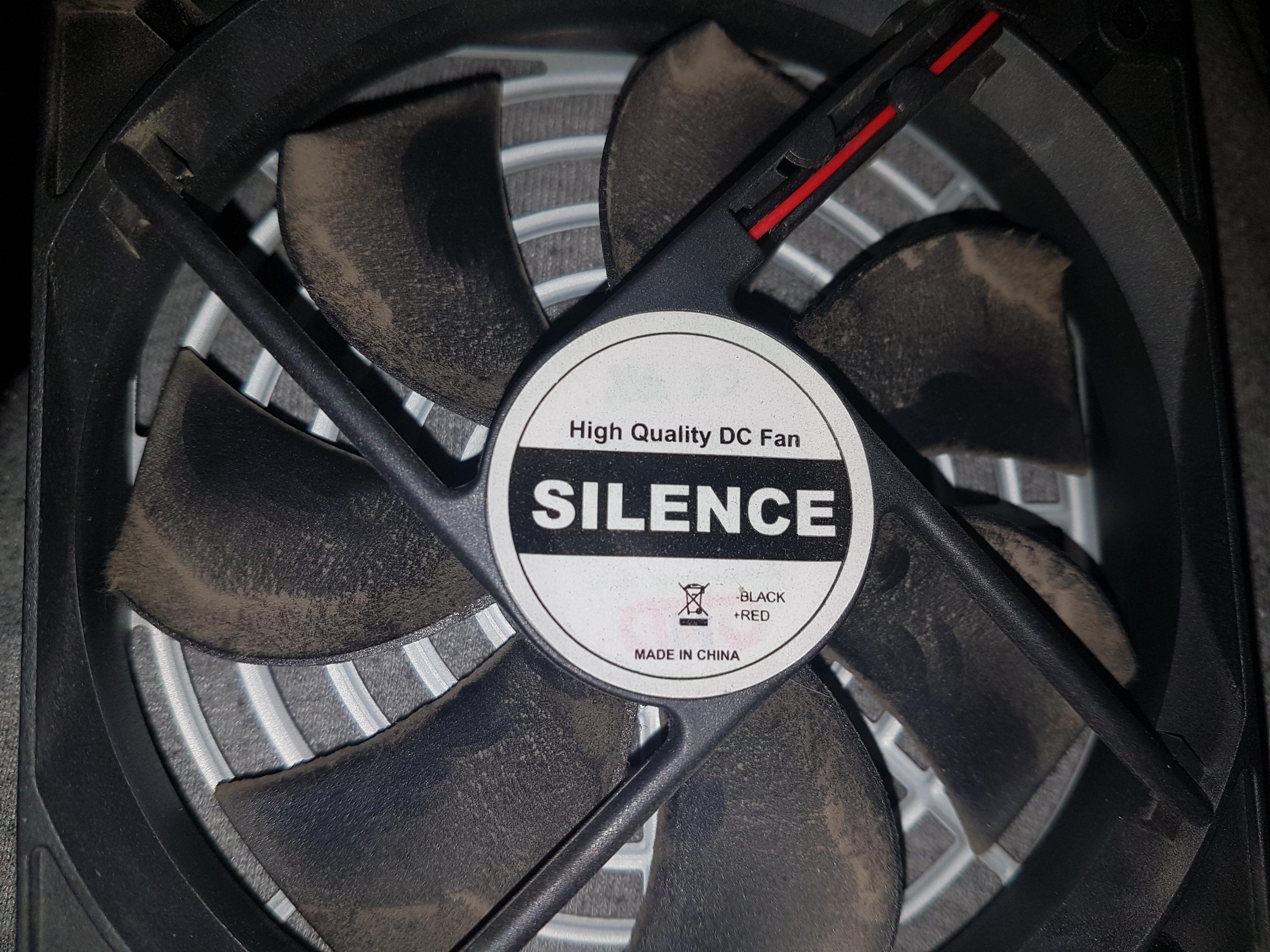

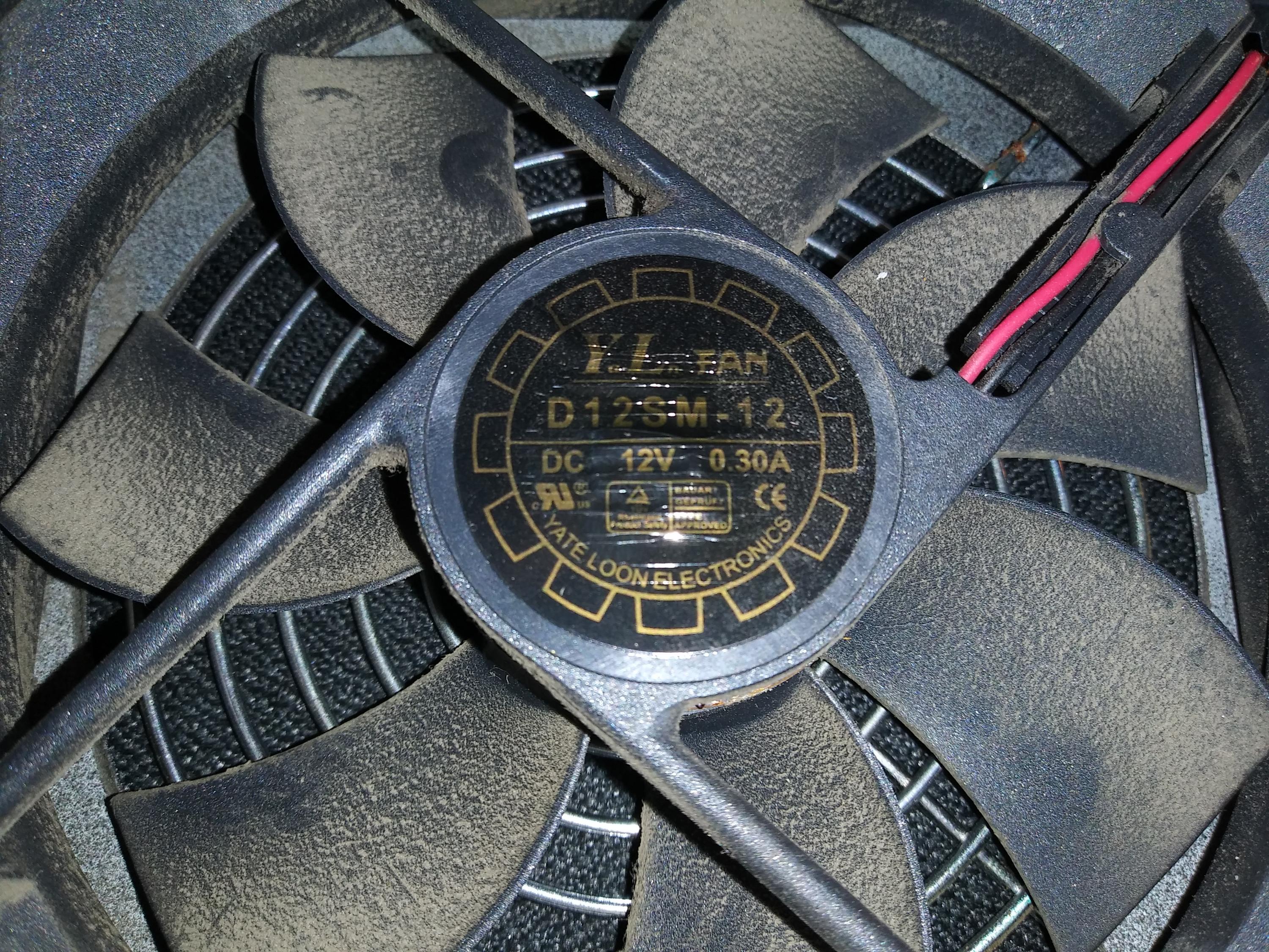

                        But it's a Yate Loon, so it's probably still okay if you disassemble it and clean the bearing (I would certainly save it ).
                        And that's only if you ignore the massive ripple and noise that would be present on the output at that power level. With a single cap per rail, good luck trying to get more than 150 Watts out, if even that much (though the design can impact that a little... but in a cheapo PSU, I doubt it).
                          I tried doing that but the fan is in really bad shape, it also looks like it got water damaged as it's all rusted inside.

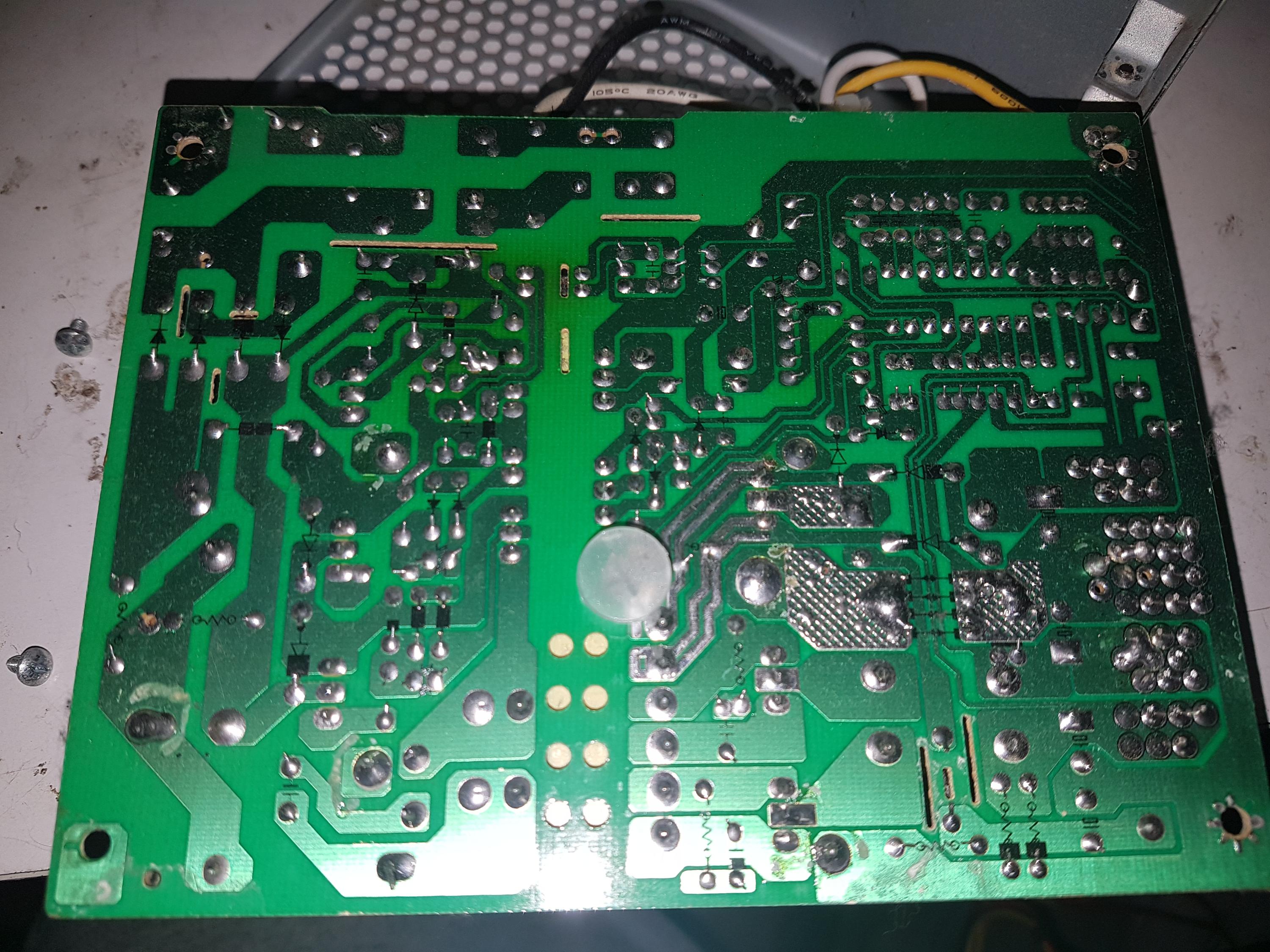

                            The worst PSU I've had in my hands, a Deer, has burned resistors (with Viva and rulycons capacitors )

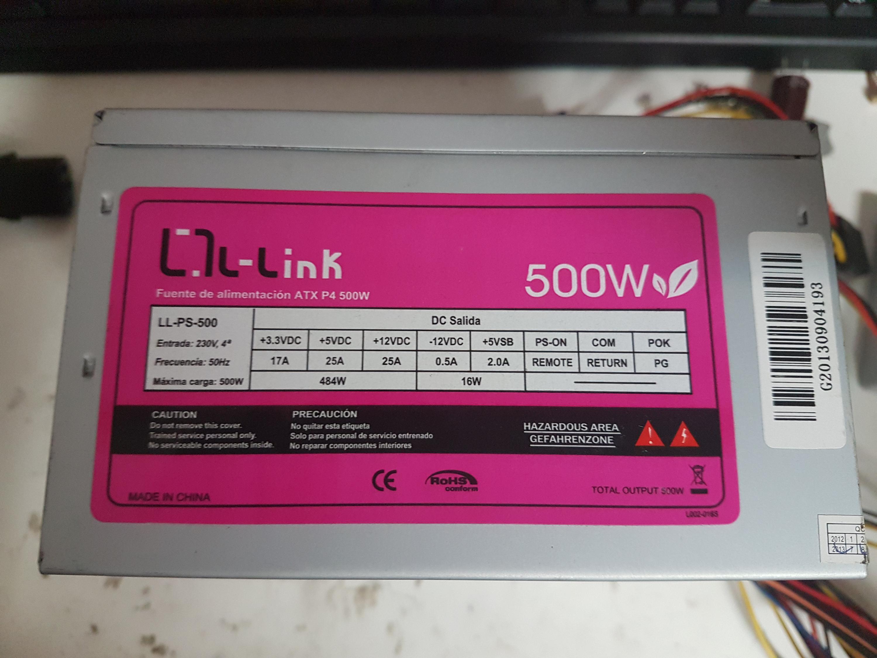

                                    One more:
                                    L-LINK "500W" I imagine that L-LINK warns the buyer, if you put it at 500w, we are not responsible for the explosions caused by our product.

                                      OMG! Is that beefless POS good for 200W continuous? And if it "is", which would be worse, the output ripple or the chances of transformer core saturation?
                                        Now that's a classic Deer for you!
                                        The burned resistors are a product of a runaway single-transistor oscillator 5VSB design (no optocoupler feedback). One of them is actually used in series with the Vcc power rail for the KA7500 / DBL494 PWM chip. So the voltage there must have been in excess of 30V for that resistor to burn.
                                        And yes, you get Viva and Rulycon caps, haha! And a lovely DOB rectifier for the 12V rail (Diodes-On-a-Bracket)
                                        All things considered, though... I would probably trust that Deer PSU slightly more than the L-Link above. At least the Deer has a 33 mm core transformer, somewhat better heatsinks, and "a lot more" output filtering (relatively speaking, of course ) - not that this means anything with Rulycon caps doing the filtering.
                                        And last but not least.... that CBE fan. These fans are extremely crap quality, but they have surprisingly good sleeve bearings. Once cleaned and oiled properly, they will last a long time. I used one of these as a case fan and later on as a PSU fan for a HiPro PSU that didn't have a shell/case. I haven't oiled that fan in more than 5 years, and it's still running fine (though lately it hasn't seen much use).
                                        I doubt it. Probably even 150 Watts would be a stretch with that 28 mm transformer, given that this is an old, slow-switching h-bridge design. And that's probably if you load all the rails somewhat equally. The 12V rail appears to have a 12 Amp rectifier, so that limits it to 144 Watts. I seriously doubt you'd be able to pull that much off of it before the output toroid releases the magic smoke. But with the crappy heatsinks of this unit, maybe the 12V rectifier will overheat and short-out to save the output toroid.
                                        And then just imagine the ripple on the 12V rail at that power level. Your mobo will be surfing for sure - no, not surfing the internet, but those huge voltage ripple/noise waveforms from the PSU.
                                          I do not think it passes more than 140 watts as Momaka says, I'm afraid to demand power haha, I do not want to explode in the face xD. And just by seeing that there are only 3 capacitors for the 3 most important lines, I can fear the worst, that PSU already in itself must deliver a bestial ripple.
                                          The Deer even in spite of being a garbage of PSU, has better filtering in the lines, and inductors.
                                          Strongly agree, the Deer is better than the L-LINK. Although, none of the 2 I trust, are bombs xD.
                                          A pity that I do not have an oscilloscope, I would love to try the ripple, to see if I can one day, I will acquire an oscilloscope, I will save the PSU for when I have the oscilloscope and I will share the results in the new post hall shame ripple.
                                          I'll take advantage of that CBE, the fan barely has use.
