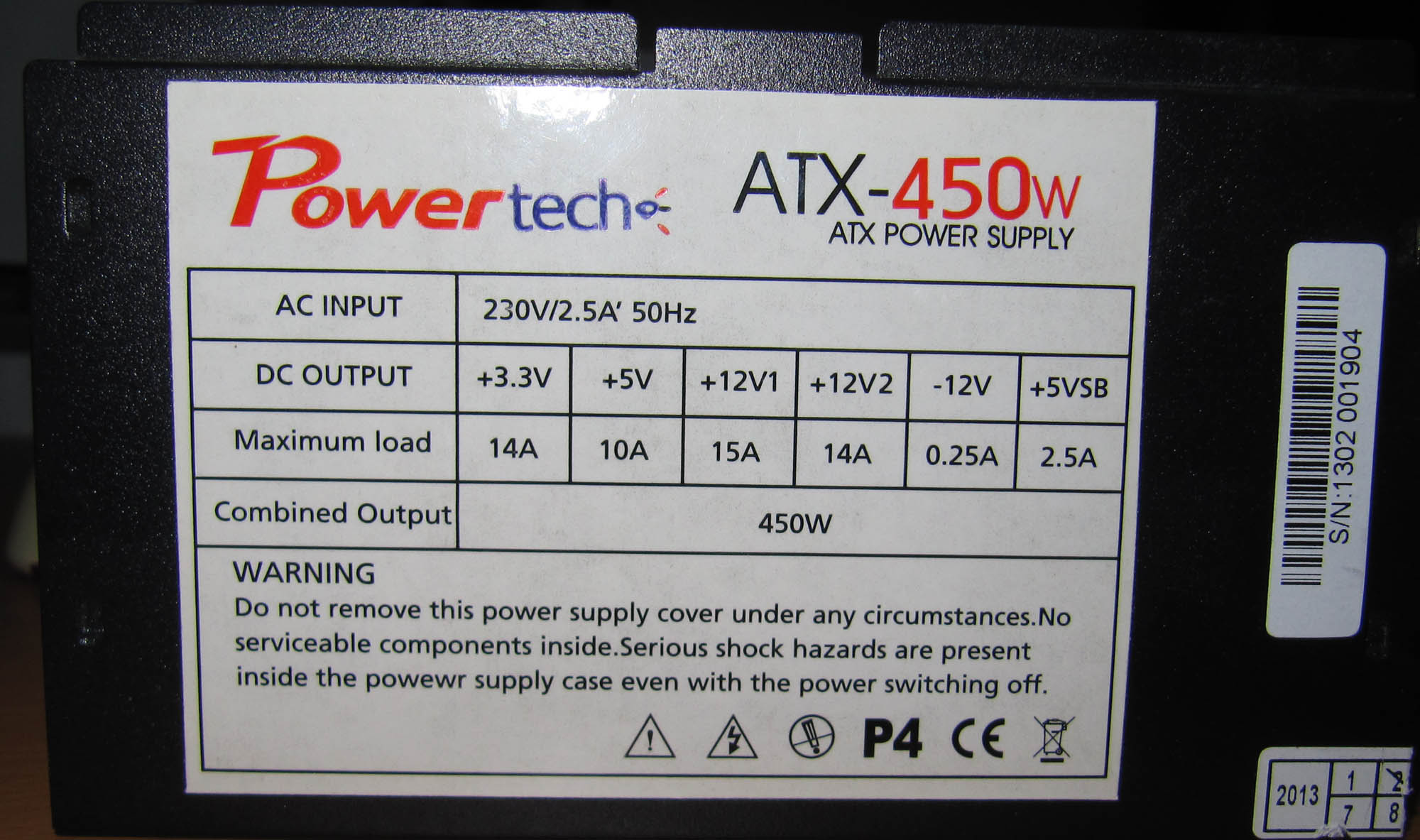

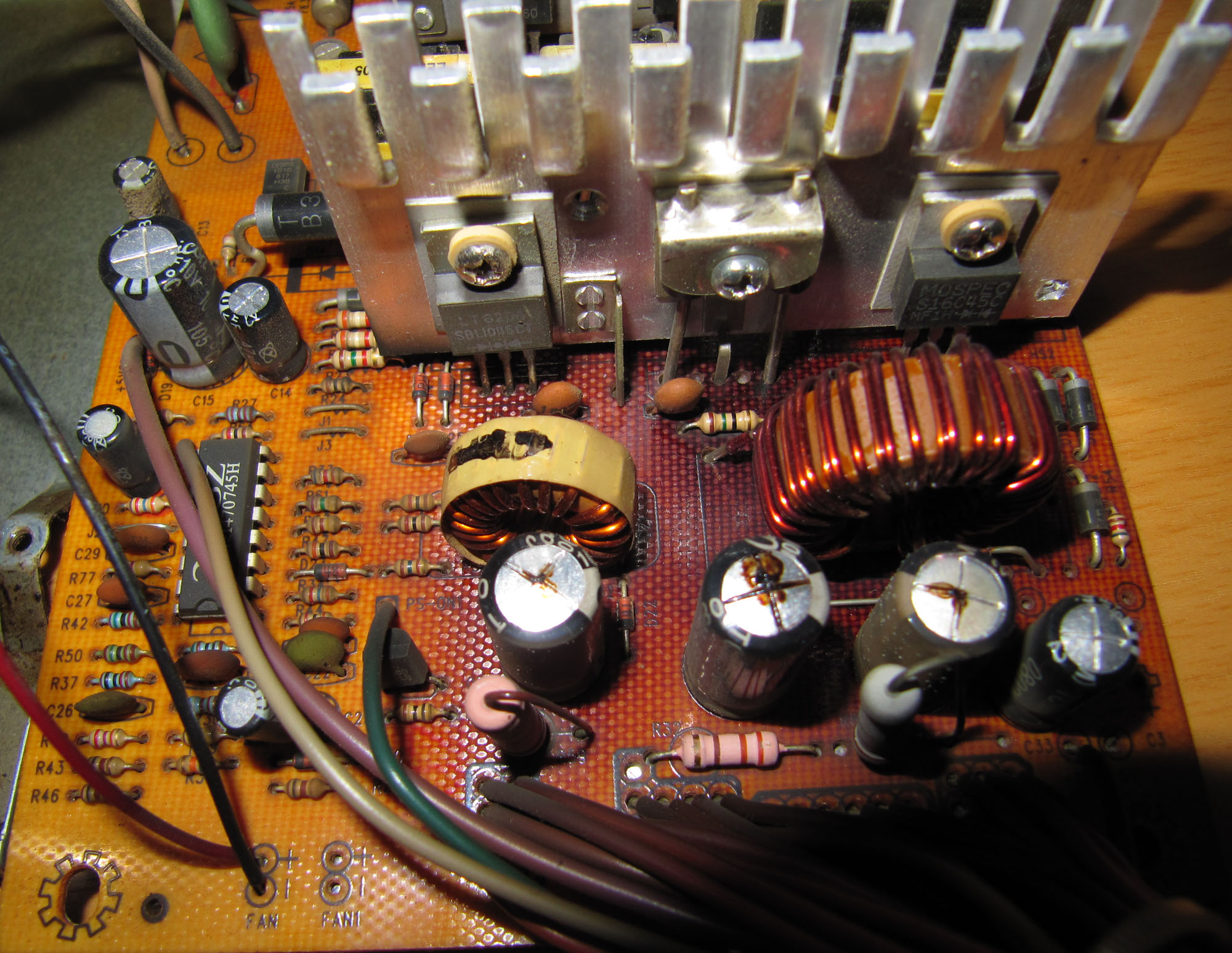

          Powertech ATX-450W
          -No PFC
          -No input filtering. Just one thermistor
          -330uF Canicon (no, you can't!) main caps
          -group regulation output toroid coil smaller than a 3.3V toroid coil from a semi-decent psu
          -tiny 3.3V toroid coil
          -output filters: just 1 cap per rail, 1 bulging
          -serious heat damage in secondary section near 12V rectifier and diodes
          -HQ caps
          -16A rectifier for main output voltages
          -WAM fan
          -paper thin heatsinks
          -no fan controller

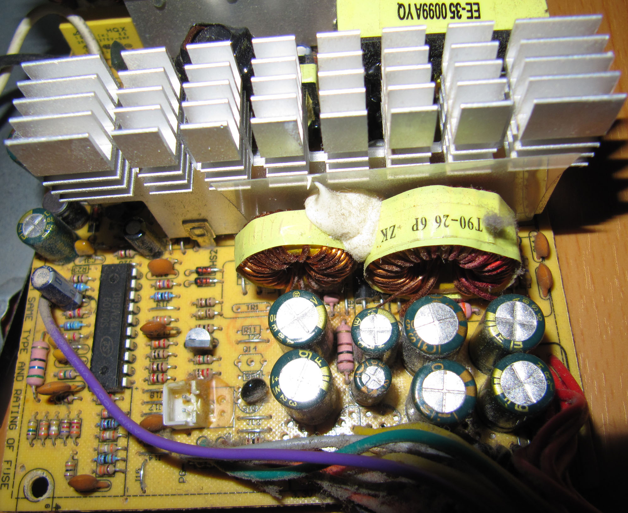

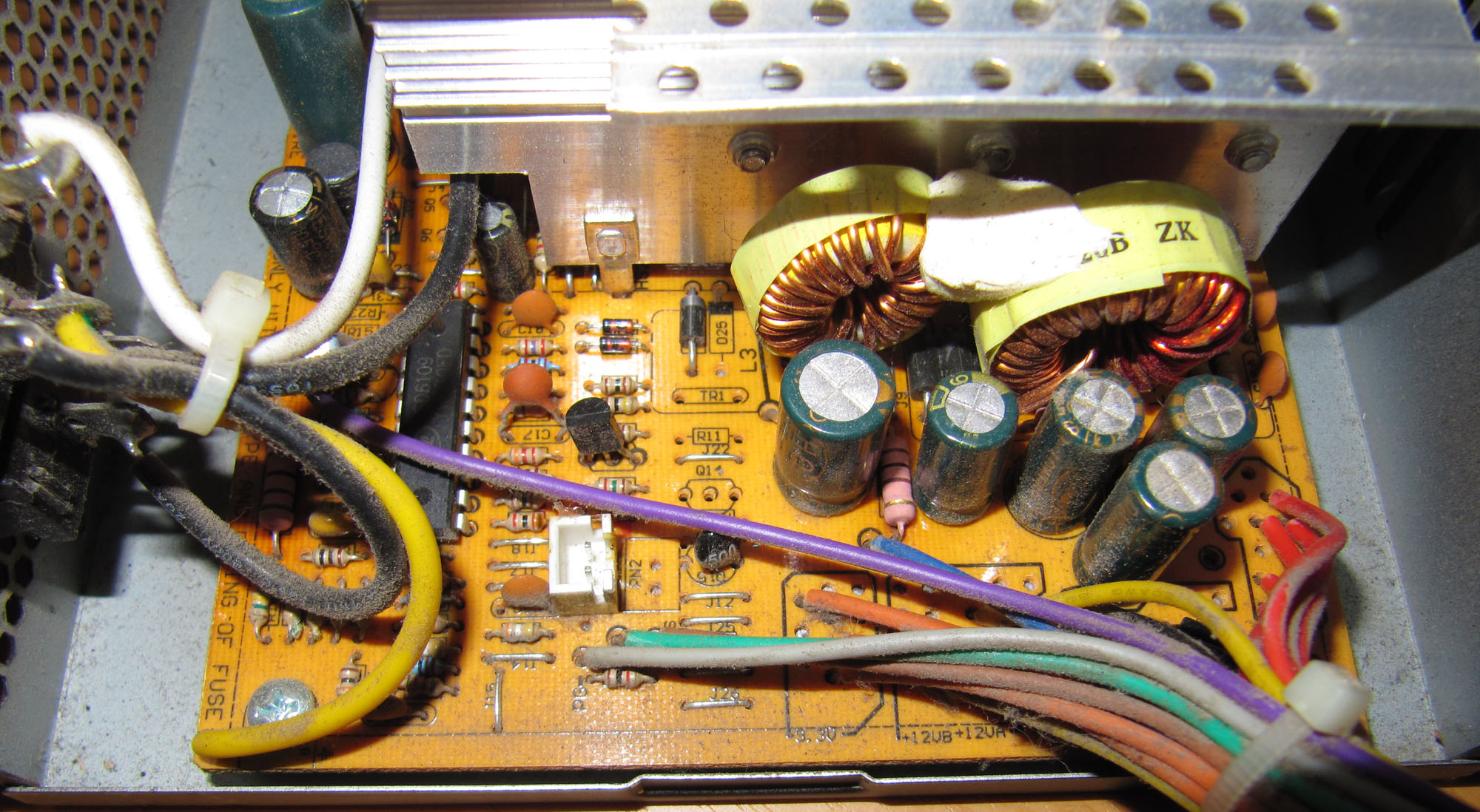

            Powertech ATX-530W
            -No PFC
            -No input filtering. Just 2 Y caps and thermistor
            -470uF main caps
            -group regulation toroid coil small
            -output filters: 2 caps per rail, no coil
            -HQ, Cheng and Asia X caps
            - S1645CT @ 3.3V
            MBR2045CT @ 5V
            F16C20CT @ 12V
            -WAM / Legend fan
            I got 2 "530W" units, one made at 2012 and another at 2013.
            The first has its fuse blown along with some resistors and diode that are part of the 5vsb circuit.
            Pics attached:

              #1386
              Re: the gutless, bloated, and fried power supply hall of shame
              And pics of the 2013 unit. It works but the PG cable needs re-soldering to PCB.
              I wouldn't use it in any computer though.

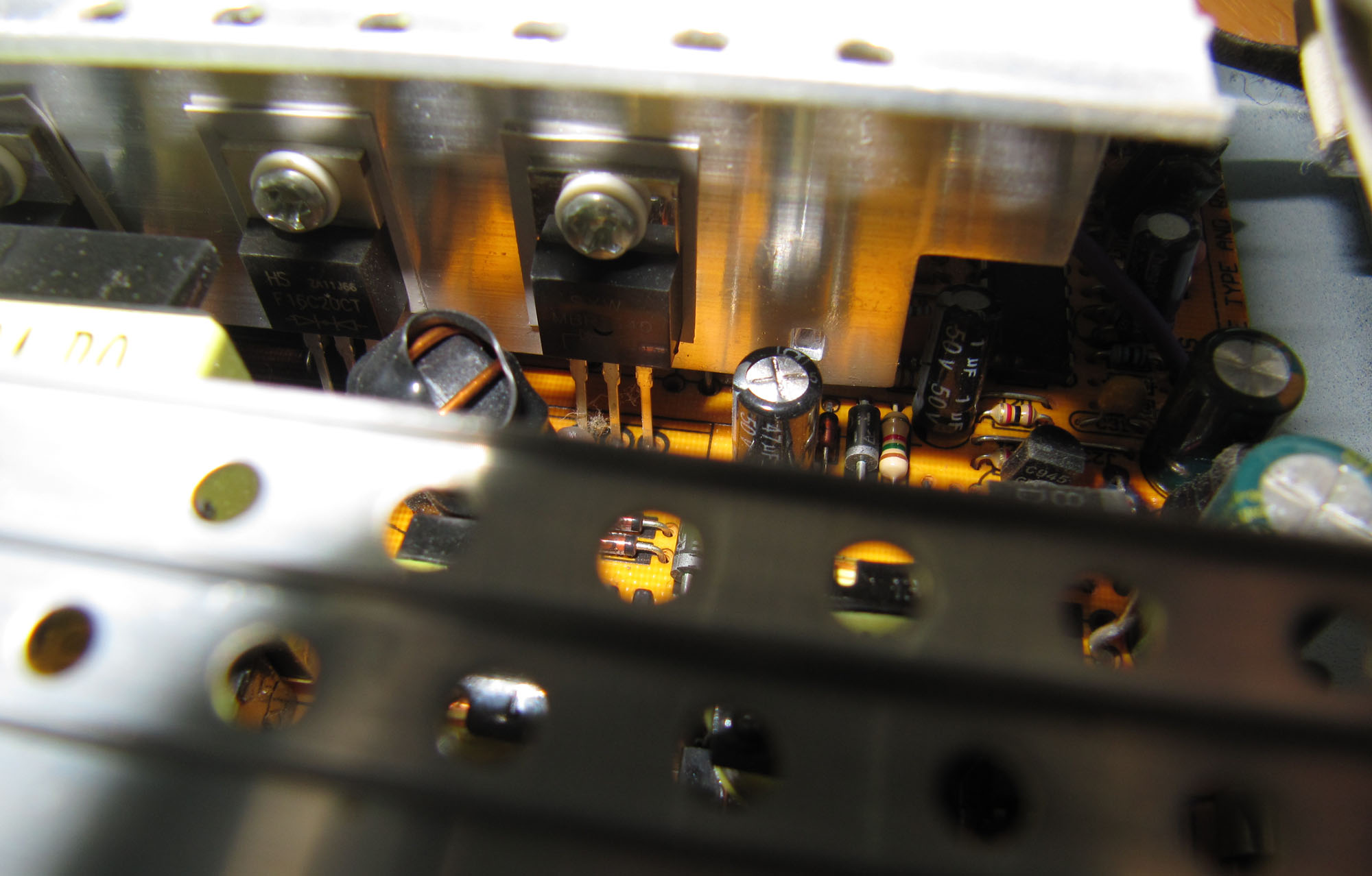

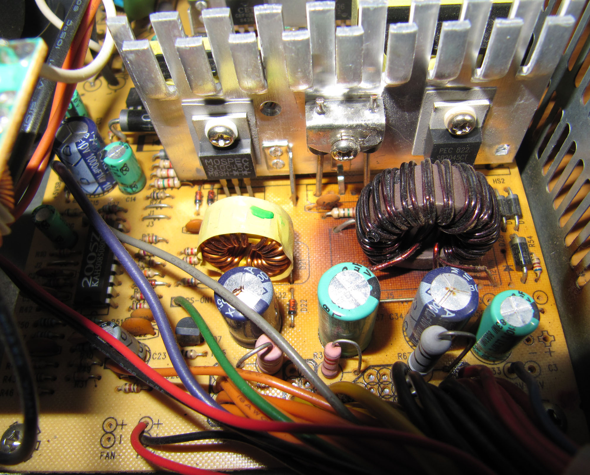

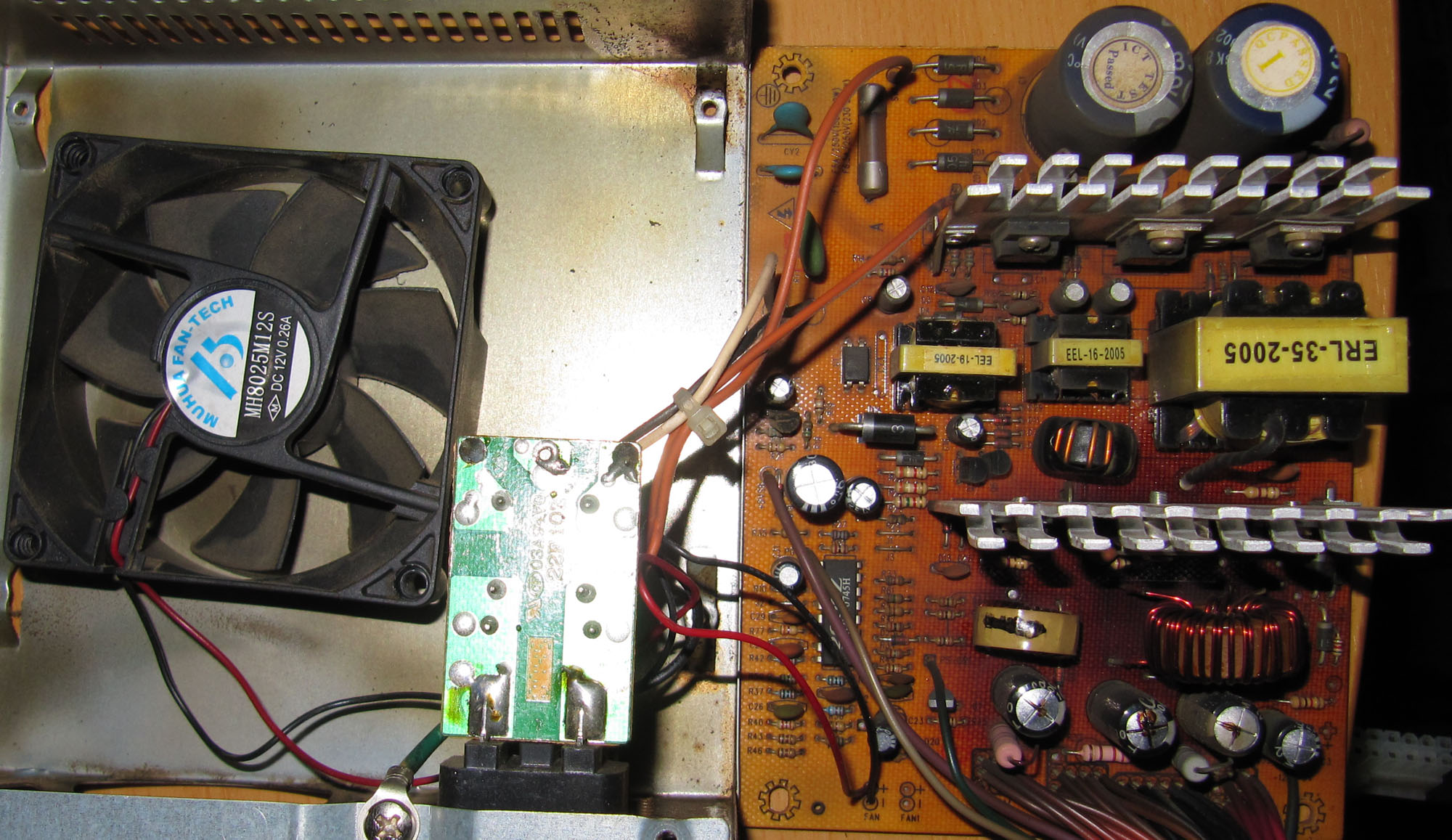

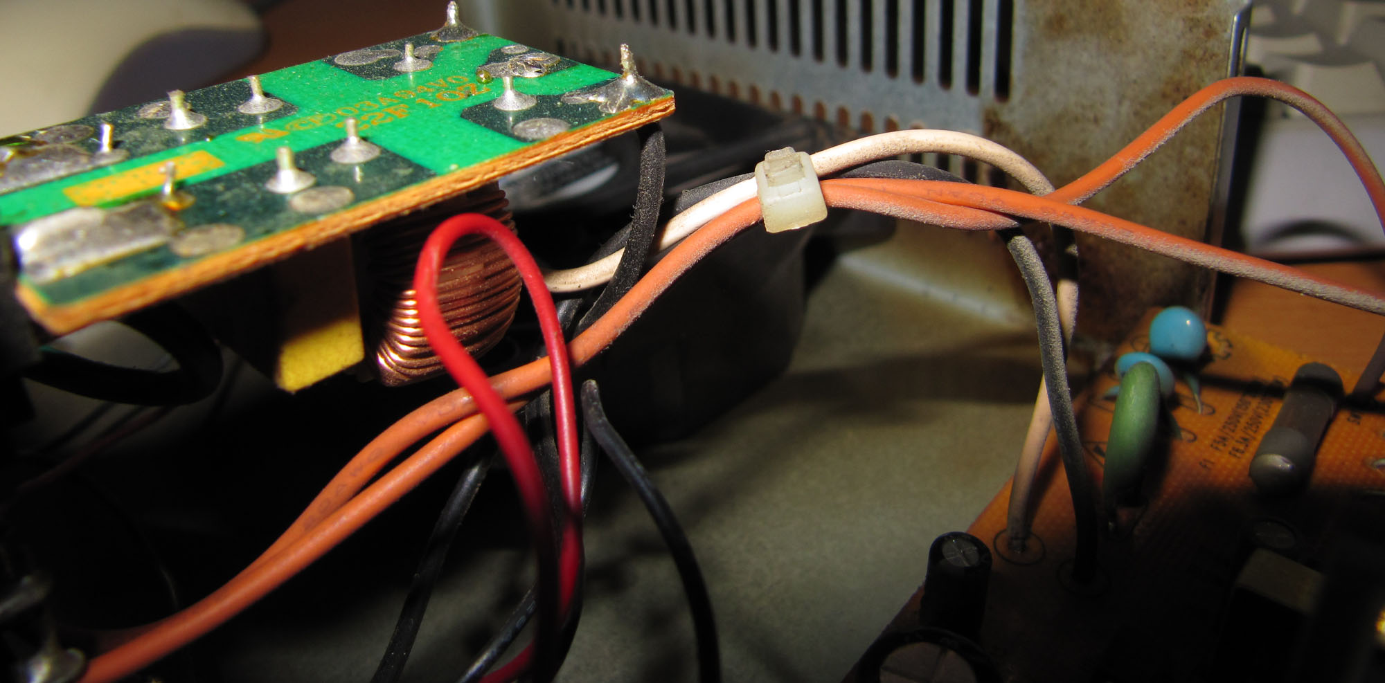

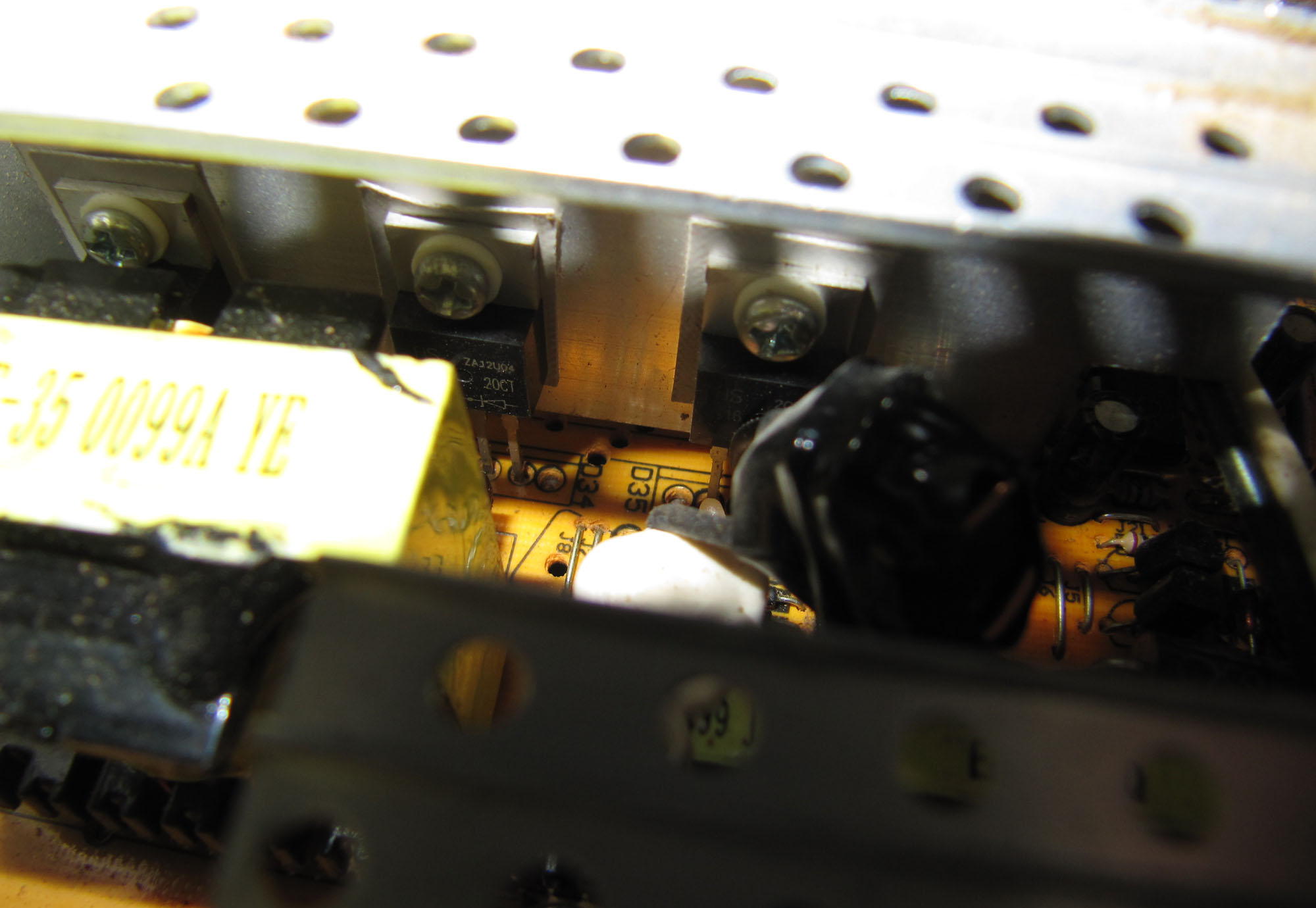

                          I got 13 Deer/L&C/Allied/Solytech power supplies for free, but most of them are badly burnt due to fan getting seized.
                          I am going to post some pics without many comments. Τhere isn't much to talk about anyway, because there are hardly any parts inside these power supplies
                          Premier DR-8400BTX (MAX 400W)
                          Have you ever seen a power supply so badly burnt?
                          The fan that seized is a "Muhua Fan-Tech".
                          What I like here is that the PCB was evenly burnt in most of its surface! The output caps are all bulging, the cables have burnt too!
                          The primary transistors 2x D4206 are rated for 7A continuous, worse than 130007 rated for 8A.
                          12V gets 2 DIODES on a bracket, there is not a single pi coil on that psu!
                          Edit: 5vsb survived! The rest is dead.

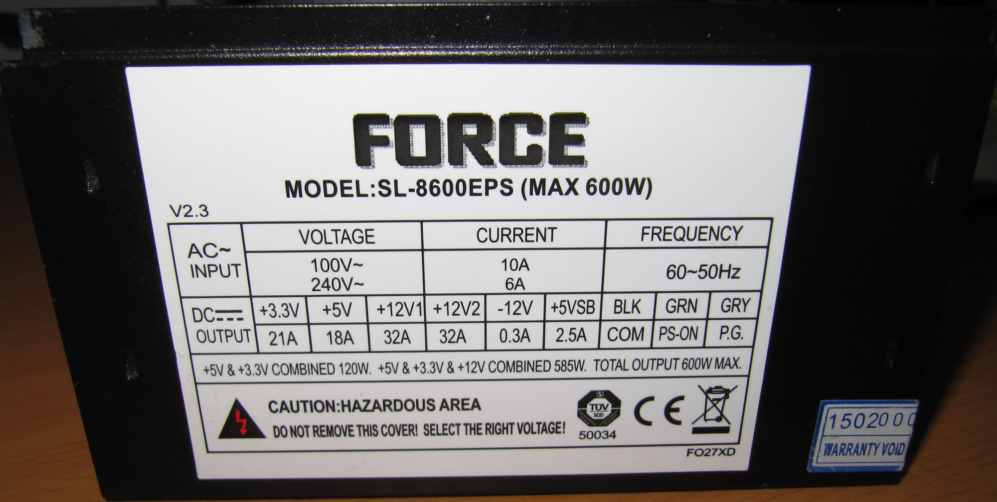

                                          Force SL-8600EPS (MAX 600W)
                                          The PWM/supervisor combo is the chip of the year "2012".
