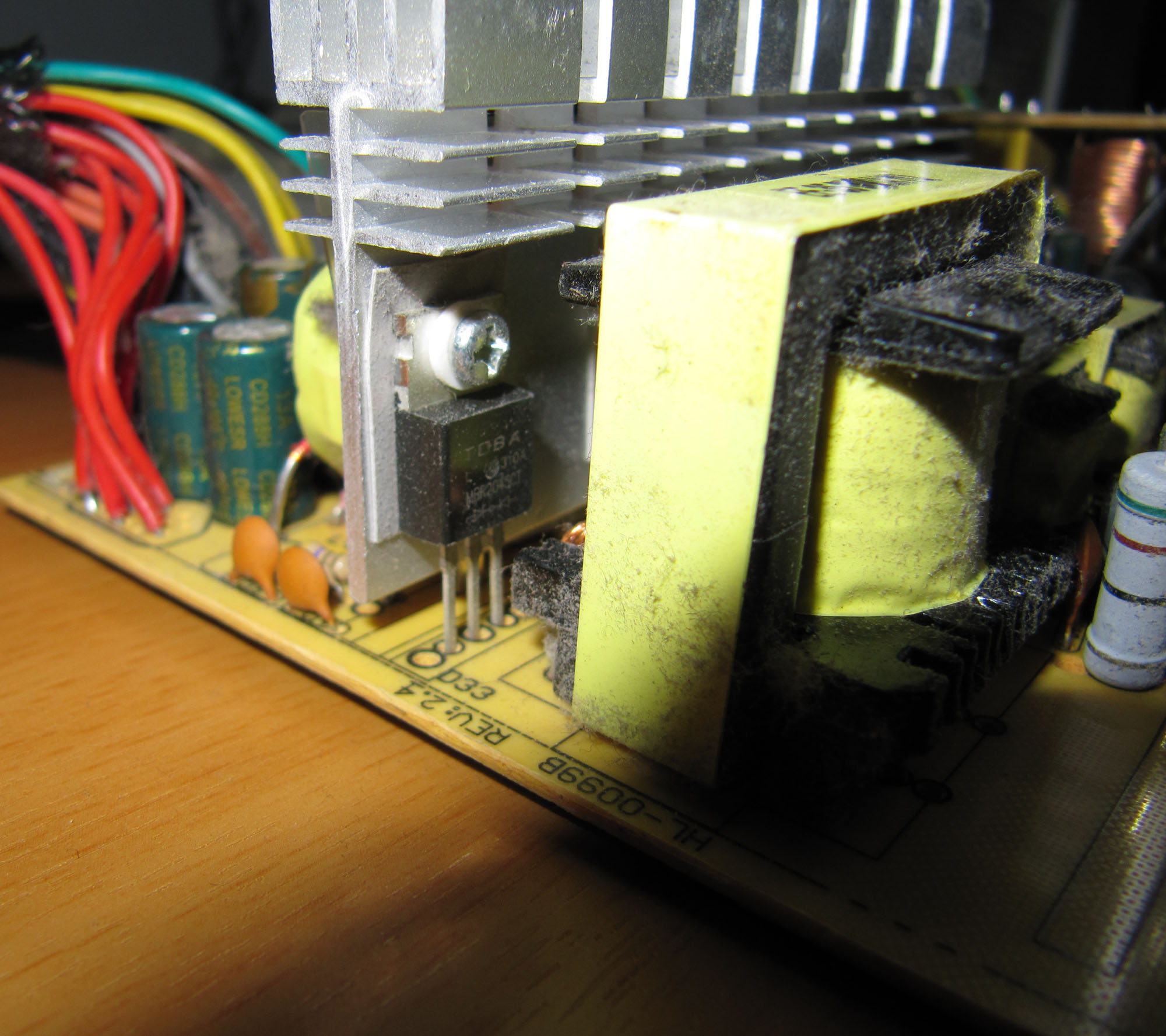

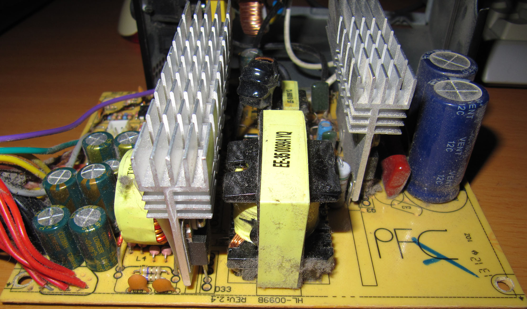

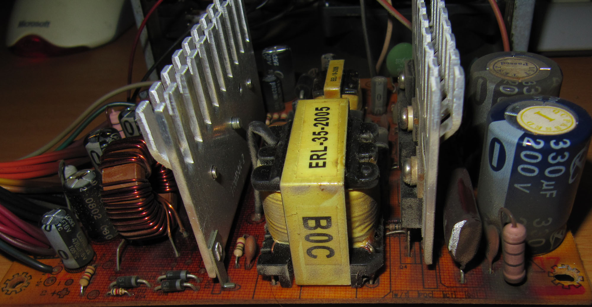

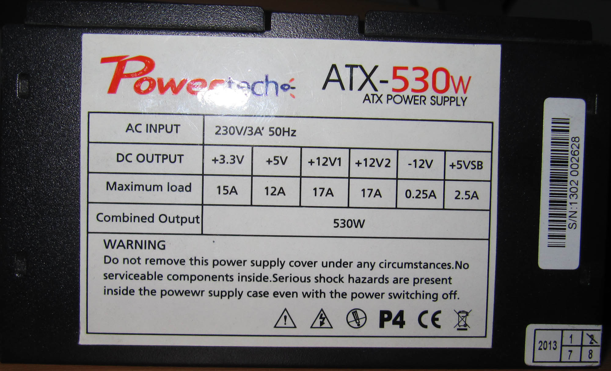

Ok, here is what i found.
The feedback coil (i think that's what it's called) consist of 7 windings with 2 layers of tape isolating it from the secondary. (that plus the wire insulation of course)
The secondary coil consist of 2 wires with 18 windings each, both wires are connected in parallel.
The primary coil consist of 121 windings with 2 layers of tape isolating it from the secondary.
And that's it for that transformer, it seems to be a bit unsafe by the way it's built.
I may keep the core for future use.

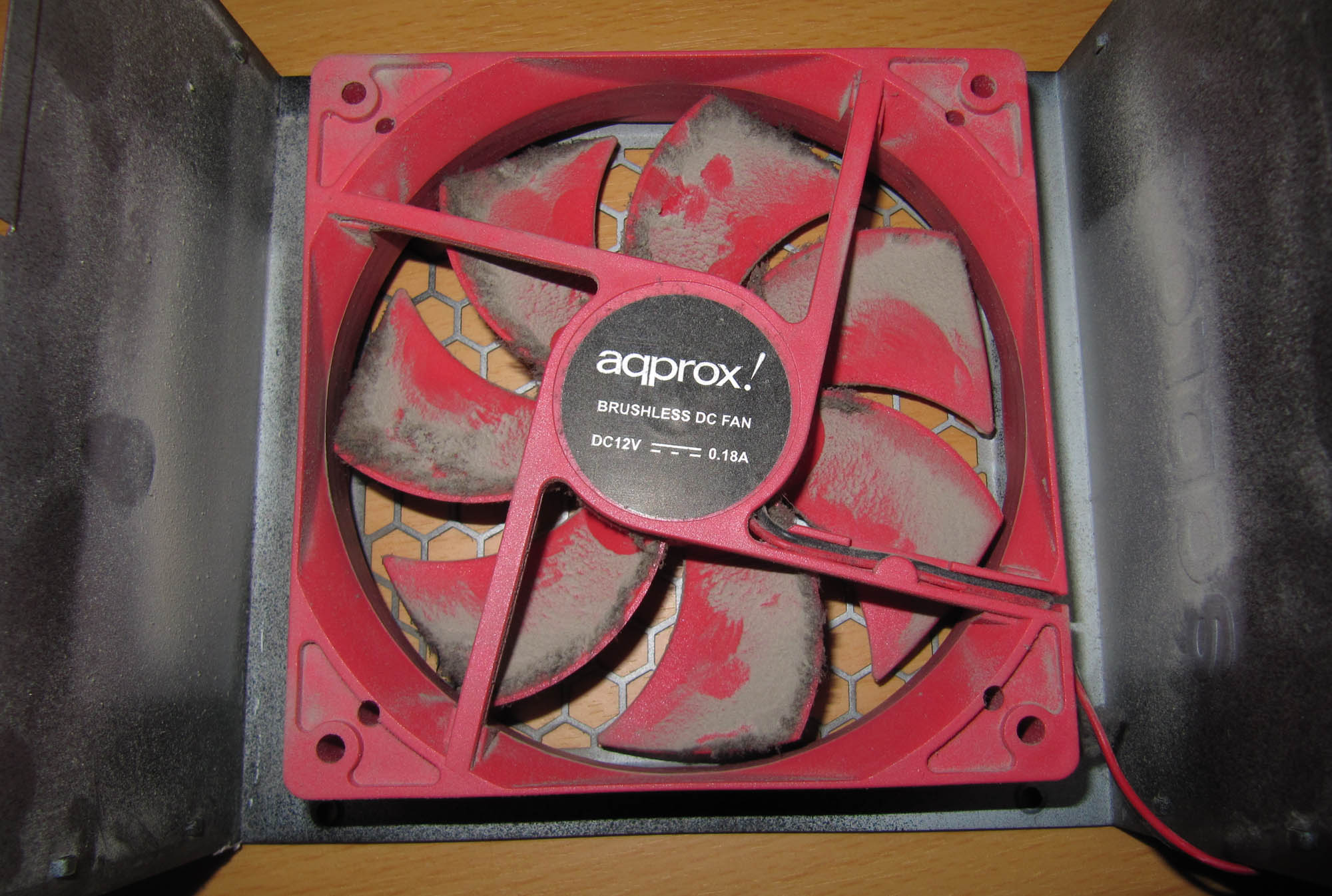

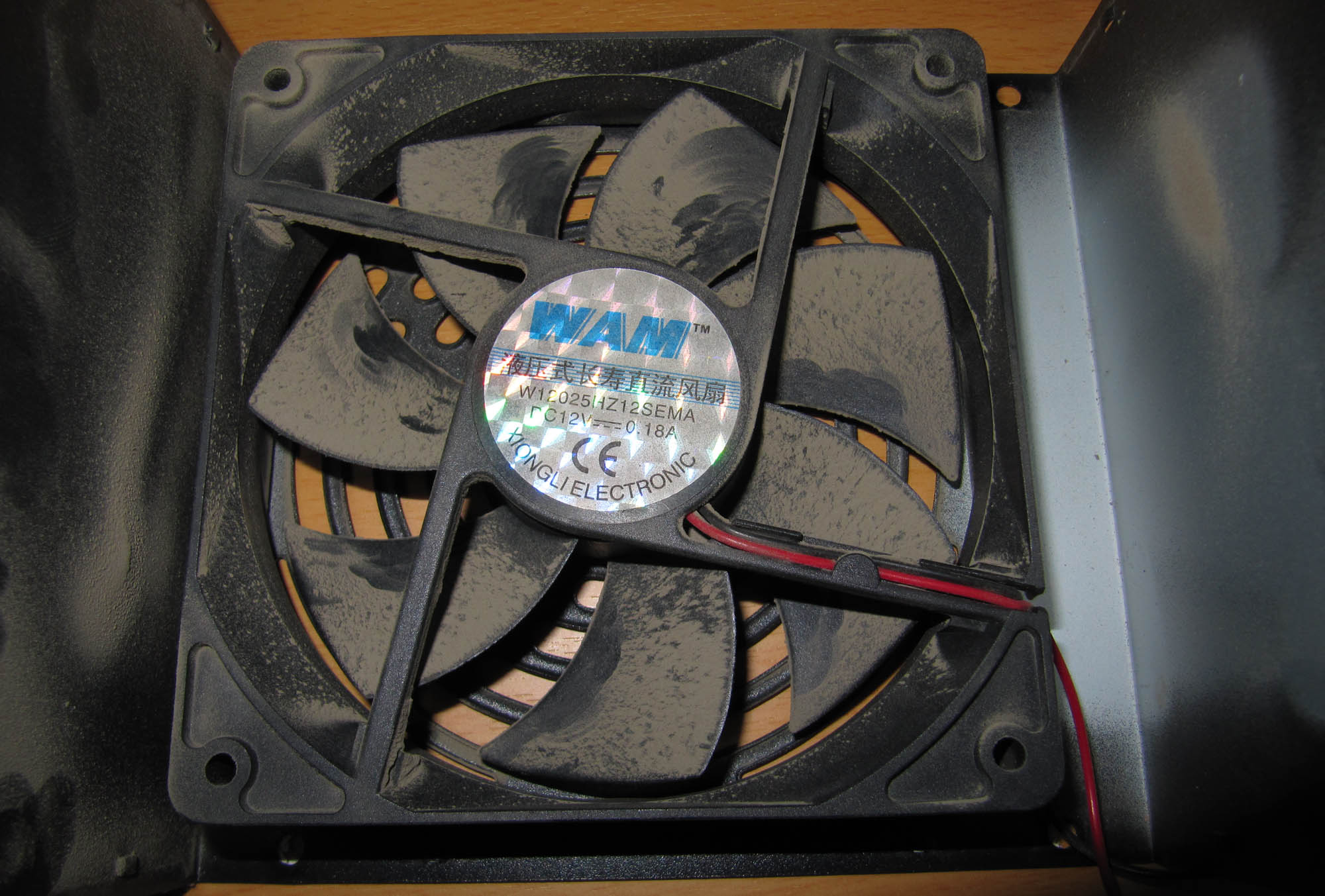

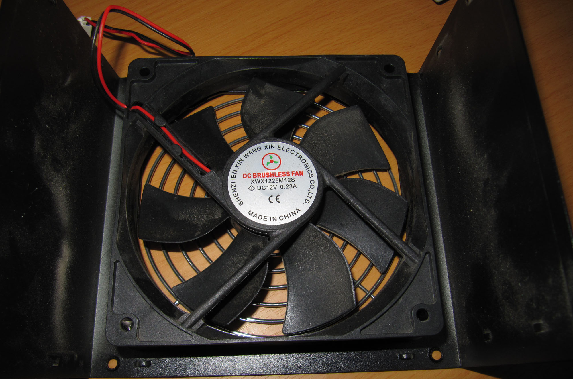

 (and not that many great ones, either). The 120 mm fan is probably the best one. And that's probably only after you lubricate it properly.
