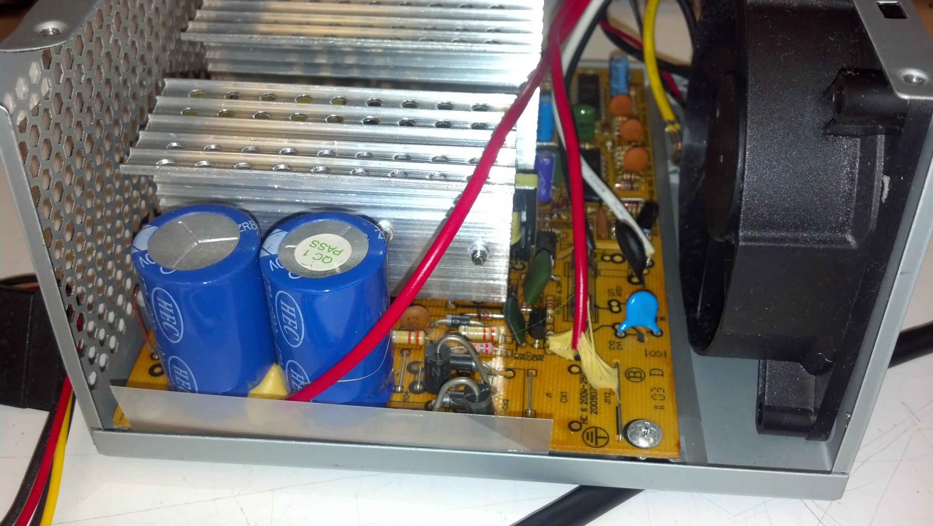

    Another thing to look at is the half-bridge coupling cap -- that dipped red one. It is much smaller than it should be for 400W rating. Usually it is a few uF at 630V. The size dictates the maximum primary current (well, the dI/dt, but with a fixed inductance and on time, fixes the maximum current.)

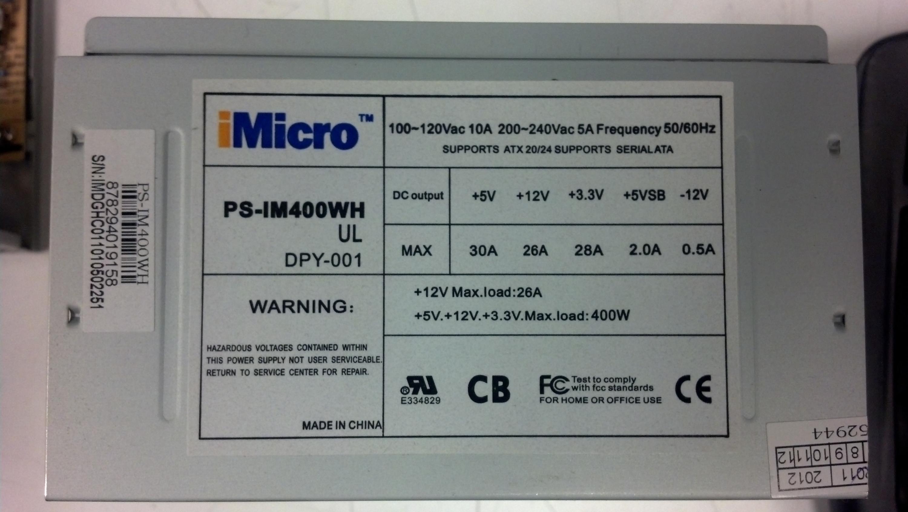

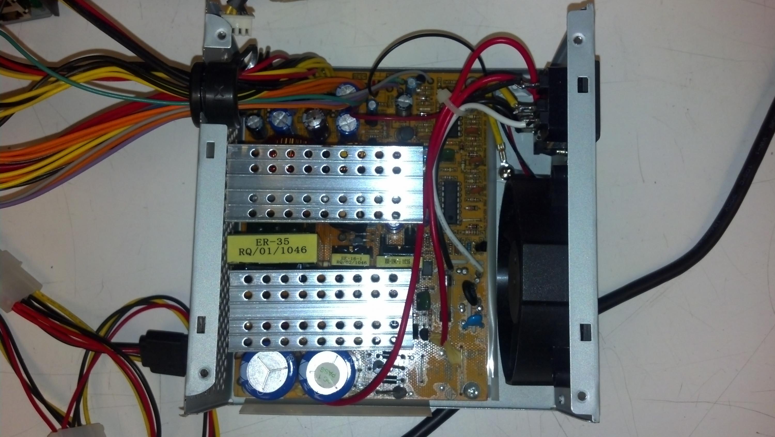

      This thing was $10, bought by a friend of mine Even though it isn't seized, the fan will not spin at all...This thing was manufactured in February, 2011. Can't believe shit like this is still being made!

        Re: the gutless, bloated, and fried power supply hall of shame
        Yuck, even the fuse lacks a socket. Talk about saving 4 cents on every PSU they churn out... The exact opposite of HongKongFlyApartCompany is ChineseThrowawayCompany I suppose. I wonder if they even have wheelie bins over there, let alone recycling...
        If it's not seized, the IC on the fan's PCB is probably fried. Generally, the windings are the last to go open on a PC fan, unless someone put line voltage to it or something equally ridiculous.
