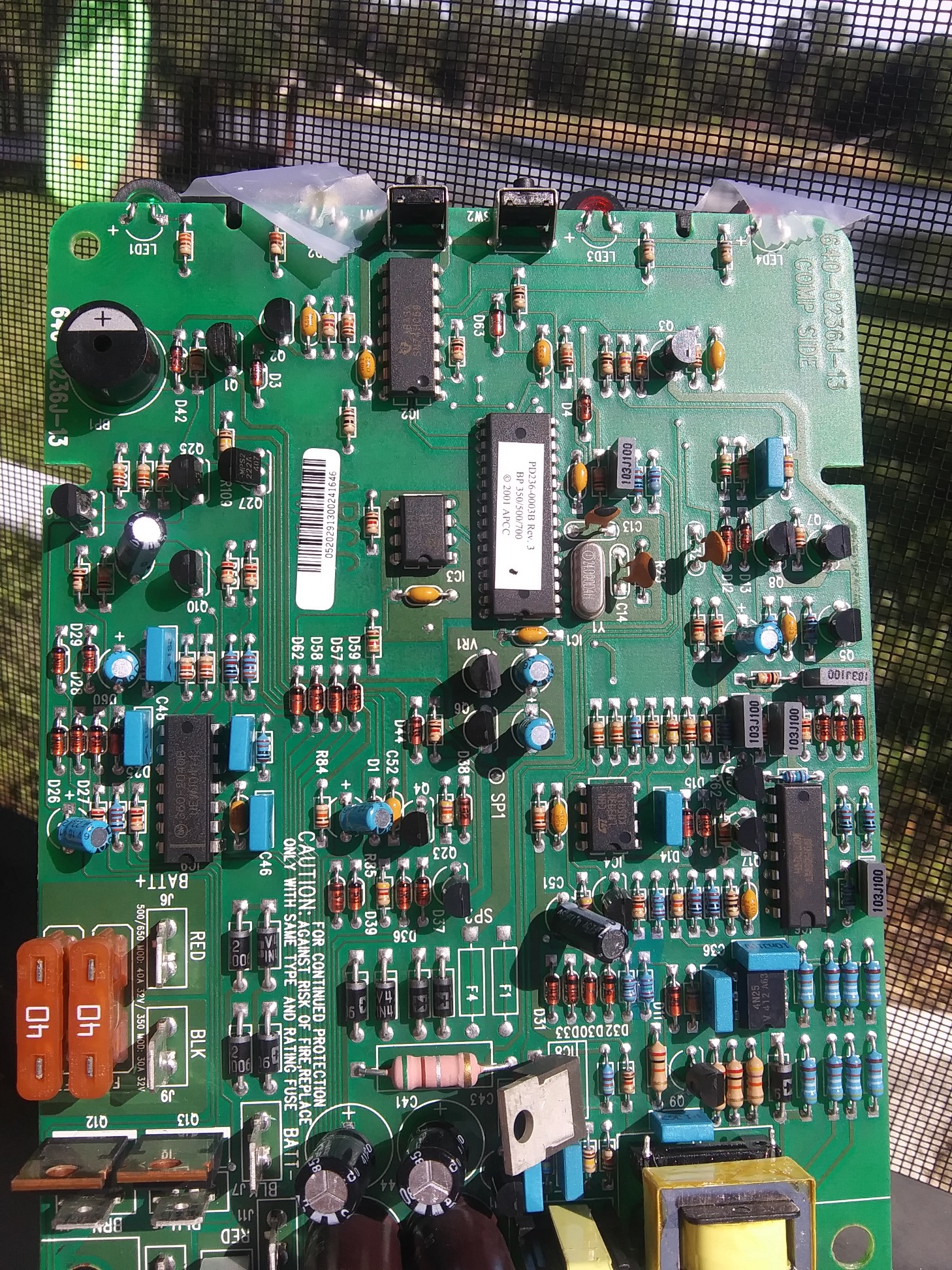

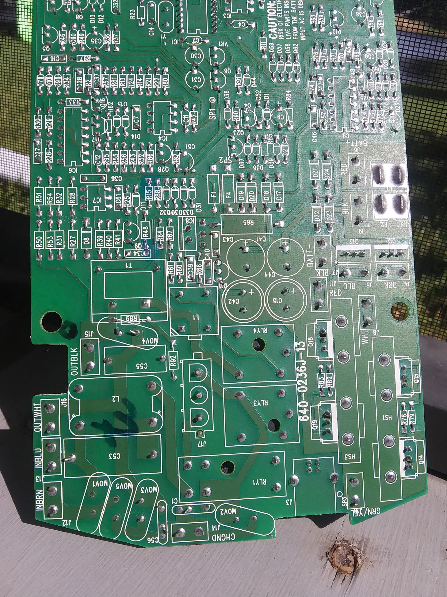

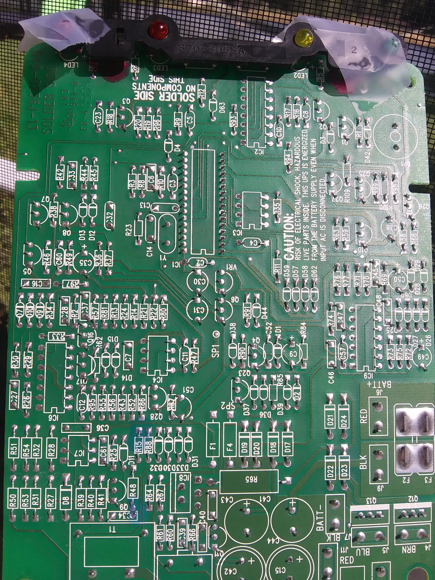

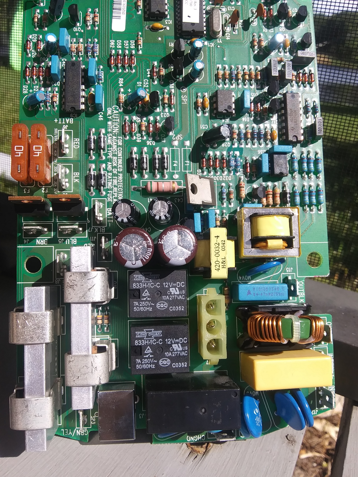

      The pictures are below. I tried to get the best resolution I could.
      From left to right..
      #1. Top Left of the board
      #2. Top Right
      #3. Bottom side of #1
      #4. Bottom side of #2

        Here is the problem I am working on with this UPS. Sometimes, only for a second or 2, the 'bad battery' light flash and it will beep. I have tried different batteries, and it still does it. I have tried a brand new battery, and it still does it. It may show the fault once every 5 minutes, sometimes more frequently, sometimes less frequently. It does this when something is plugged into it, and when nothing is plugged into it. When the UPS is running I am getting a good voltage at the battery, 13.69 volts. When the new battery is unplugged from the UPS, it reads 13.7 volts. The new battery has charged for 24 hours.

                      Chips On The Board
                      APC BackUPS LS-500 / Model BP500UC / Board number: 640-0236J-13
                      Below are the ICs on the board. I looked up each one and I listed what I found about them.
                      Which ones might be part of the circuit that triggers the 'Replace Battery' alert? I am thinking it is one or both of the 'LMxxx' chips maybe?
                      BIG CHIP
                      The largest chip has a white APC sticker
                      on top of it listing it is for a 350/500/700
                      unit, along with a version number. So I am not
                      sure what that is. Maybe ROM?
                      360-2040B
                      UEWJ0414
                      What is this?
                      93LC46B
                      EEPROM
                      SN74HC595N
                      8-bit, serial in, parallel out shift register
                      Is this for the USB connection?
                      LM393N
                      Two independent voltage comparators
                      LM324AN
                      Four independent operational amplifiers (op amp)
                      4N25
                      Single channel phototransistor coupler

                              BTW: on your second picture there are 2 relays and 2 brown capacitors. The top brown capacitor looks to me bad.

                                And thank you for noting that cap. I just looked closely at it, and it is has a slight depression across part of the top. It almost looks like something pushed into it because the metal on the top appears to have a small scratch or depression in the metal like something sharp pushed it in. It might even have a tiny hole in it, but I am not positive. I will certainly test that one further to see how it looks. It is a KMG Cap, ie. Nippon Chemi-Con

                                    For me, I'd ESR the sh*t out of them caps and replace them. I've had a run in with my small SMT a few years back, it turned itself off all the time.
                                    https://www.badcaps.net/forum/showthread.php?t=66277
                                    I'd change the two brown caps, the 2 black caps next to it and C51 and retest.
