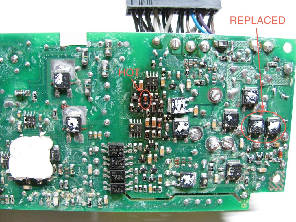

        Success! Maybe.
        The PHD101NQ O3LT'S arrived yesterday, and today I soldered a couple of them into the 12V circuit. Voila! All of the output voltages look good. I left the PS powered up for a few minutes, and nothing popped or smoked, so maybe it's good.
        I keep saying "maybe" because I'm troubled by the burning around the 3.3V circuit. I mentioned this in an earlier post, and I think it's the same part of the board that Toast referred to in post #38.
        Violating my usual safety concerns, I powered up the PS with the case off, and took some readings with an infrared thermometer. The diode circled in the photo (which was taken before the MOSFET's were replaced) read a temperature of over 220F after the board was on for about 2 minutes. Some of the other components in that area are also warm, but that may be just conduction from the diode. I'm not 100% sure that the diode is the heart of the inferno, but it looks that way. None of the other components on the board were anywhere near this hot.
        I have no clue what would cause this diode to be so hot, or what function it performs. I don't want to button up this PS and call it good without knowing more about this potential failure point.
        Anybody have any ideas or suggestions?

          I'm going to look at it again. I don't know where/how that diode fits into the picture, but the one next door looks to be in an identical circuit. I just have to see what it does.
          What are your 3.3v MOSFETS? The 3 units I have here use ST D100NH03.

            [EDIT: 220°F - 105°C is extremely hot for that diode or anything in that area. Something is seriously wrong. Tracing this circuit out is the only way.]

              The 3.3V MOSFET's are PHD101NQ 03LT, same as the 12V ones. They seemed OK when I tested them before, but I'll check them again.

                Keep an eye on those outputs for rising temps under no load. I had the 12v pair go for no apparent reason under -no- load. Supply just shut down and I found one of them had shorted.

                          I replaced the 2 bad FETs and tried to test the supply and no go.
                          The same FET on the far right just shorted again with no heat, smoke or sound just gone.

                            The hot diode area is the cause, or at least part of the issue. Could be the PWM chip next to it. I have not touched this since my last post as it became too involved in tracking down the root problem.
                            Mine also did the same as yours in blowing the FET. The diode area got hot and that was it. It was on a current limited mains supply and it still popped. That gets expensive quickly after the 2nd one.
                            I am recommending anyone with the Celetronix units that fail to go to another brand (AcBel or Delta). These are over-engineered and overly complicated when it comes to repairs.

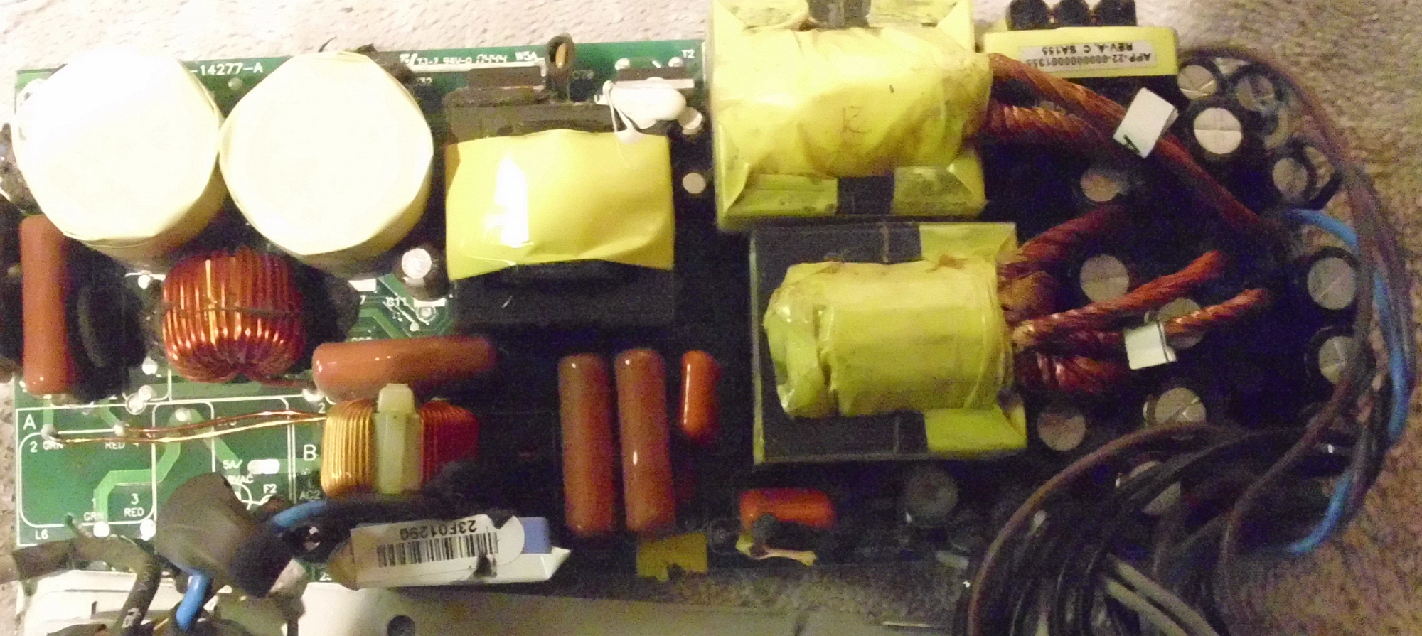

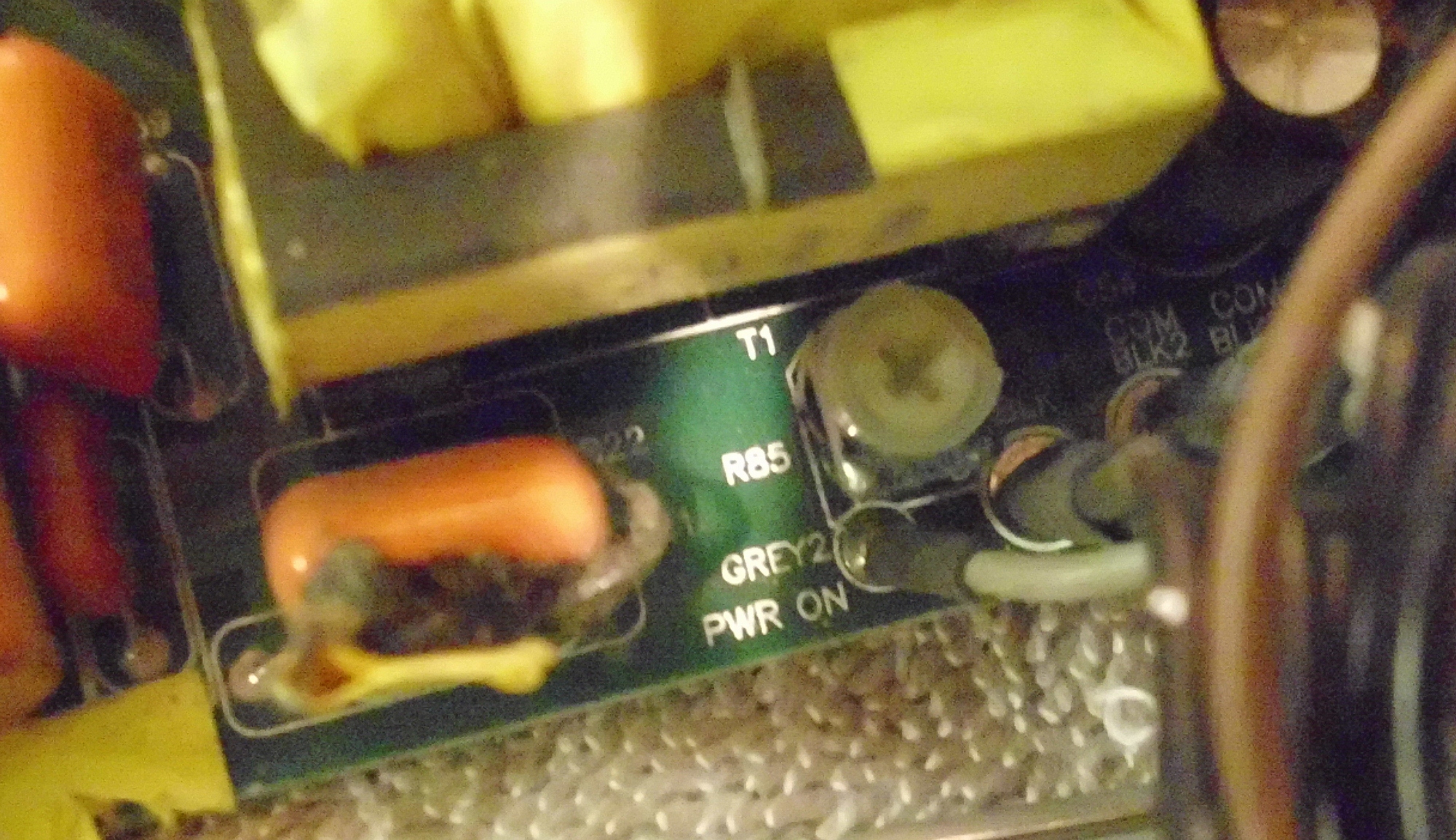

                                    This looks to be the same power supply ,and the MOV is open.
                                    After I repair the open MOV, How can I turn this supply on to test on the bench?
                                    It is probably in here somewhere,I just can't find it.
                                    Whatever I do, I consider it a success, if in the end I am breathing, seeing, feeling and hearing!

                                      The same as you would any other PSU.
                                      Connect that wire in Pic #2 to the negative of the PSU output. I typically use a 47Ω resistor. Gives me a safety margin if something is FUBAR'd.
                                      If the MOV is open, then the fuse might have popped, I would think...?
                                      The MOVs are either Blue or Tan.
                                      Or, do you mean the NTC Thermistor which is either Black or Green and shrink wrapped?
