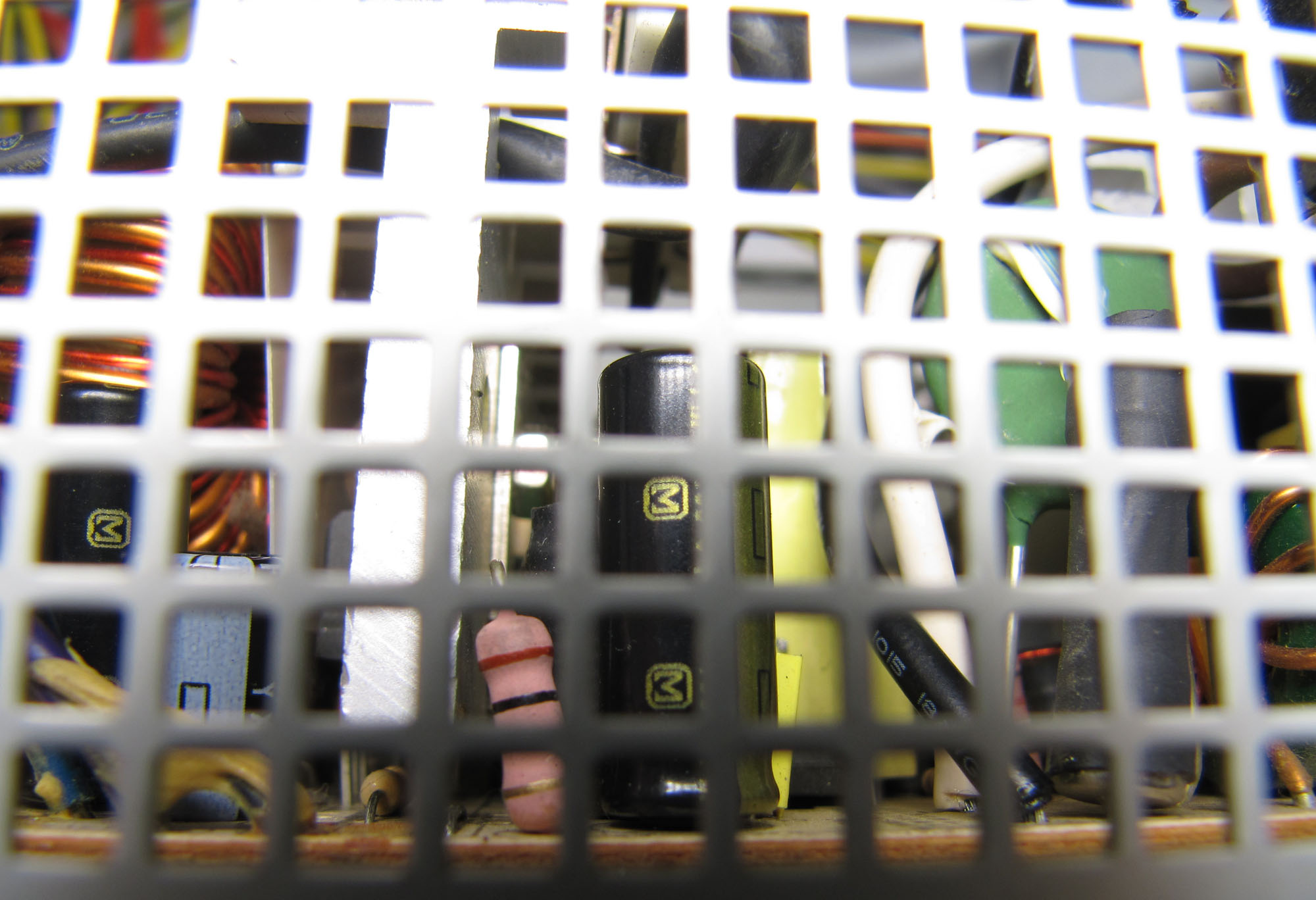

                            Recap complete and successful. My pc is now running with antec truepower 2.0 380.
                            List of caps changed:
                            1x10uF 50V Fuhjyyu --> 1x10uF 50V rubycon YXF
                            1x1uF 50V Koshin --> 1x1uF 50V rubycon YXF
                            1x22uF 16V Fuhjyyu --> 1x22uF 25V Panasonic FC
                            1x22uF 50V Koshin --> 1x22uF 50V rubycon YXF
                            1x100uF 25V Fuhjyyu --> 1x100uF 25V rubycon YXF
                            2x1000uF 10V bulged Fuhjyyu --> 2x1000uF 10V Panasonic FM
                            1x220uF 16V Koshin --> 1x220uF 16V rubycon YXF
                            1x470uF 25V Fuhjyyu --> 1x470uF 25V Panasonic FM
                            2x3300uF 16V Fuhjyyu --> 2x3300uF 16V Panasonic FM
                            4x4700uF 10V Fuhjyyu --> 4x3300uF 6.3V Panasonic FK
                            not replaced caps:
                            1x220uF 400VDC Hitachi HP2
                            fan controller board: 1x16V CB06 Fuhjyyu
                            Voltages are in specs but the psu still runs hot...
                            Now running idle with pc case open, fan runs at 1000rpm, 5.10V
                            When running 3DMark05, it runs at ~1120, ~5.7V, case open too.
                            • i4004

                                          We had no luck modding the fan controller. We added resistors in parallel with the thermal sensors but no change was observed. When added a very small one, the psu did not start at all (overheat protection was enabled).
                                          After many tries, I decided just do the 7V mod, as seen in photo.
                                          Recap photos also available...
                                          Volts measured when connected to my main pc, athlon XP 2200+ 1GB DDR 600MHZ, ATI 4650 AGP, 2xIDE 7200 and 2xDVDROM/RW:
                                          V-------------------------Idle---------------3DMark05
                                          5vsb--PCoff:5.06-5.08-5.03-5.05--------5.03-5.05
                                          12V----------------------12.16-12.18-----12.14-12.16
                                          12VB*-------------------12.21-12.23-----12.21-12.24
                                          5V------------------------5.06-5.09--------5.06-5.08
                                          3.3V---------------------3.35-3.37--------3.35-3.36
                                          *mobo connector
                                          One last concern I have about this power supply is that its voltage outputs are constantly going up and down, at very small steps of course, but I have seen more stable outputs in psus..
                                          For example, the +5V line (when pc idle) goes like this at my cheap polymeter lcd screen: 5.06 -> 5.08 -> 5.09 -> 5.06 -> 5.07 -> 5.09 -> 5.06 -> 5.09 -> 5.07 -> 5.08 -> 5.09 etc
                                          Values change in less than a second.
                                          Is it due to the active pfc maybe? Is it safe and good?
                                          I really need to finish working on that antec...
