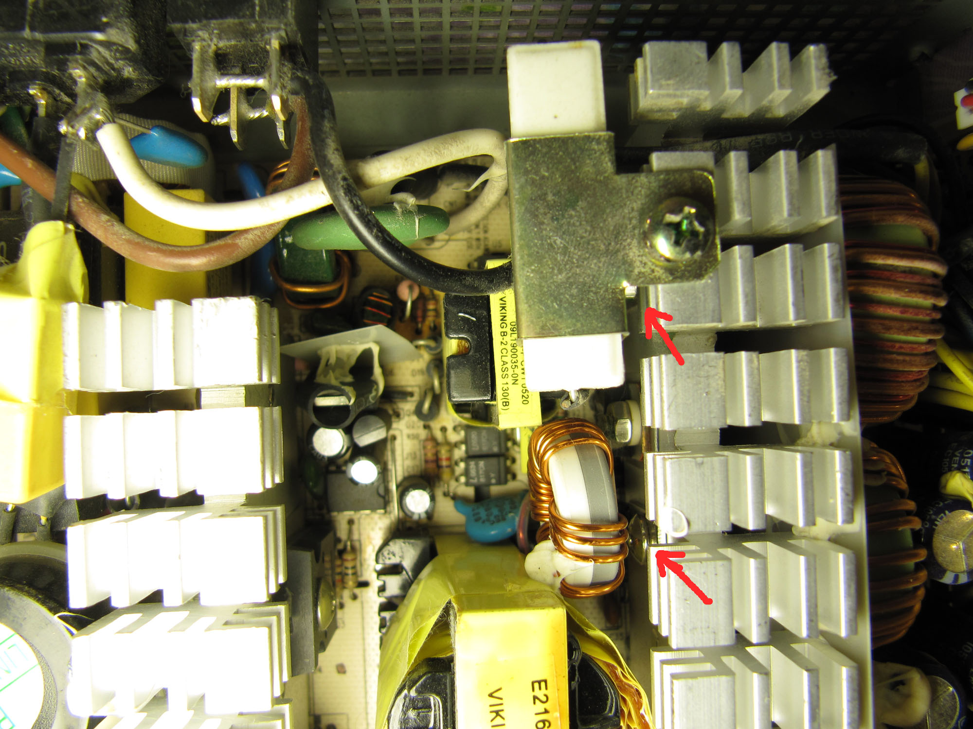

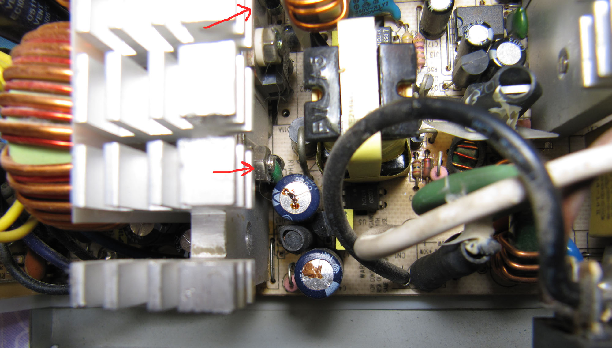

                Somewhere I have heard that if combined, 12V and 5V can result in 7V which I can connect directly to the fan, or 12V and 3.33 for 8.67V. How can this happen?
                Originally posted by etnietering
                The sensor is most likely bolted to one of the heatsinks, with 2 wires coming out of it. Most of the ones I've seen are little green blobs. This is a thermistor, a resistor who's resistance depends on the temperature. Depending on the particulars of your system, you should be able to put a resistor either in series or parallel with this to change the aggressiveness of the fan controller. I remember there being a discussion about that someplace on this forum a while back. Lots of people here can help you with the math if need be.
                There are 2 green bulbs on the heatsinks as marked at the photos. The problem is they are soldered directly to the board, no wires, so it would be difficult for me to mod it..

                  Re: Need help with Antec TruePower2.0 380W
                  Doesn't work like that. Not even close.
                  No such thing as 'combining voltages'.
                  What you would get are sparks, smoke, and maybe fire.

                          • i4004
                            • Oct 2006
                            • 2029
                            #33
                            as pom said, search google
                            http://www.procooling.com/index.php?...ticles&disp=54
                            >It is thermally controlled and usually it spins at 1100 - 1250 rpm which results in psu running really hot inside.
                            at which voltage?
                            if for example it's doing 7v already, then you gain nothing by using 7v "from molex".
                            also, why do you have to buy a fan at rs if it has such a ridiculous price?
                            nobody in greece carries fans? i find that hard to believe.
                            usually pc shops(and webshops) have fans.
                            offcourse, cheapest will also be worst quality, but 20eur is just silly...
                            btw. how did you figure out psu is overheating? you're aware that human perception of "hot" would happen on even as low as 40°c, and that's not really hot at all.

                            • goodpsusearch
                              • Oct 2009
                              • 2850
                              • Greece
                              #34
                              Originally posted by i4004
                              at which voltage?
                              4-5V
                              measured it with thermometer?
                              It Is indeed overheating. The proof is the board discoloration at more than one spots (and it is visible from both sides) and the resistor that got out it's coating from heat (see photos at first posts).
                              One more proof is that if I disconnect and open it immediately, the heatsinks are so hot that it's impossible to touch, they could cause burn if you touch them for more than a sec.
                              • Krankshaft
                                • Jan 2007
                                • 2328
                                #35
                                Those char marks near the standby transformer are the result of the BAD CAPS not overheating.
