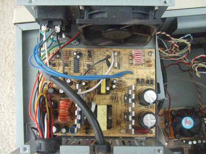

    Found this old computer free on the side of the road. This thing has all the cheapest off brand manufacturer stuff on it. Soyo motherboard with Mteq chipset, unknown manufacturer sound card, unknown manufacturer modem, S3 video card, O.K. Data ram, and it had this power supply in it. About the most gutless wonder I have ever seen in my life. The UL number leads to Real Power enterprises. Tiniest transformer I have ever seen. But what is the purpose of that second smaller transformer?

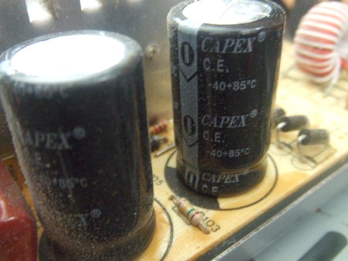

    Almost no input filter except for a coil and 2 tiny y caps. Input caps are 220uf 200v Capex brand.

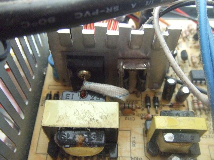

    The primary switchers are 2 sanyo 2sc4161's, 400v, 7A, 14A pulse.
    Secondary heatsink. The 5v is regulated by that 30A, 45v schottky you see there, while the 12v is handled by 2 FR30's, good for 3A each. The 12v on this is rated at 10A.
    Secondary filtering is taken care of by capex and some CEC international's.

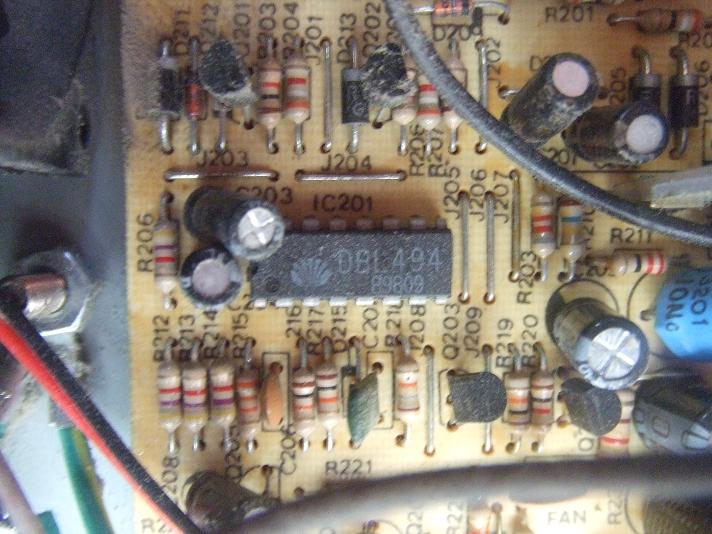

    Daewoo dbl494
    I don't think there is any protections what-so-ever on this thing.

    the smaller transformer is for base drive to the choppers.
    and yes thats about as gutless as you can get in an at.

      The smaller transformer is for current sensing too.
      I have seen the "Capex" brand of electrolytic capacitor in a cheap small B&W TV and radio - any more information on this capacitor brand?

        Its not such a bad power supply ......... it doesn't have a two transistor "fire hazzard" 5vsb circuit.

          I think it might just use some salvaged parts and caps to make this a little better. One big step up will be replacing the transformer with the old 33 transformer from my yuelin. Replace those two diodes with something like a 20A, 45v schottky from a sunpro, some X and Y caps laying around, 4A, 400v bridge rectifier, maybe some 470uf primaries and replace the secondaries. Use it to bring my old biostar-quantex board back to life.
