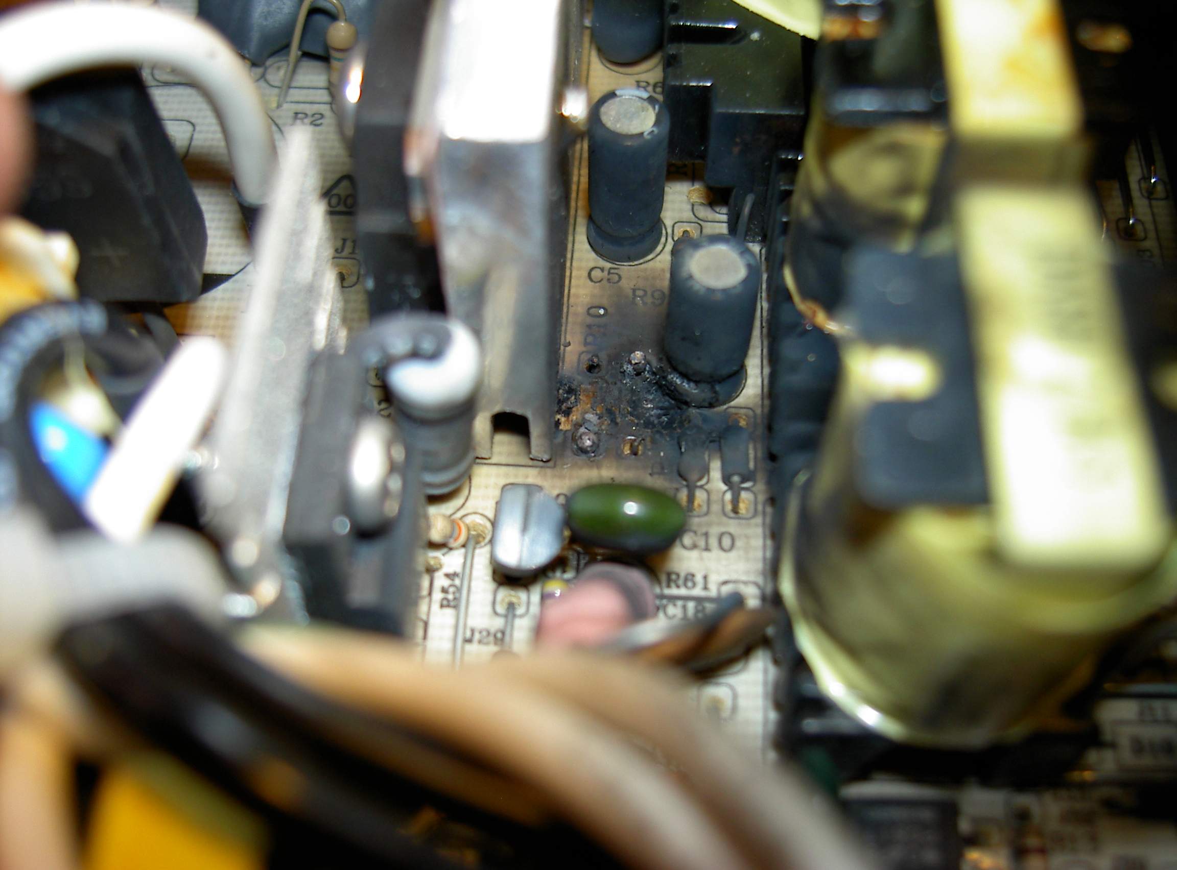

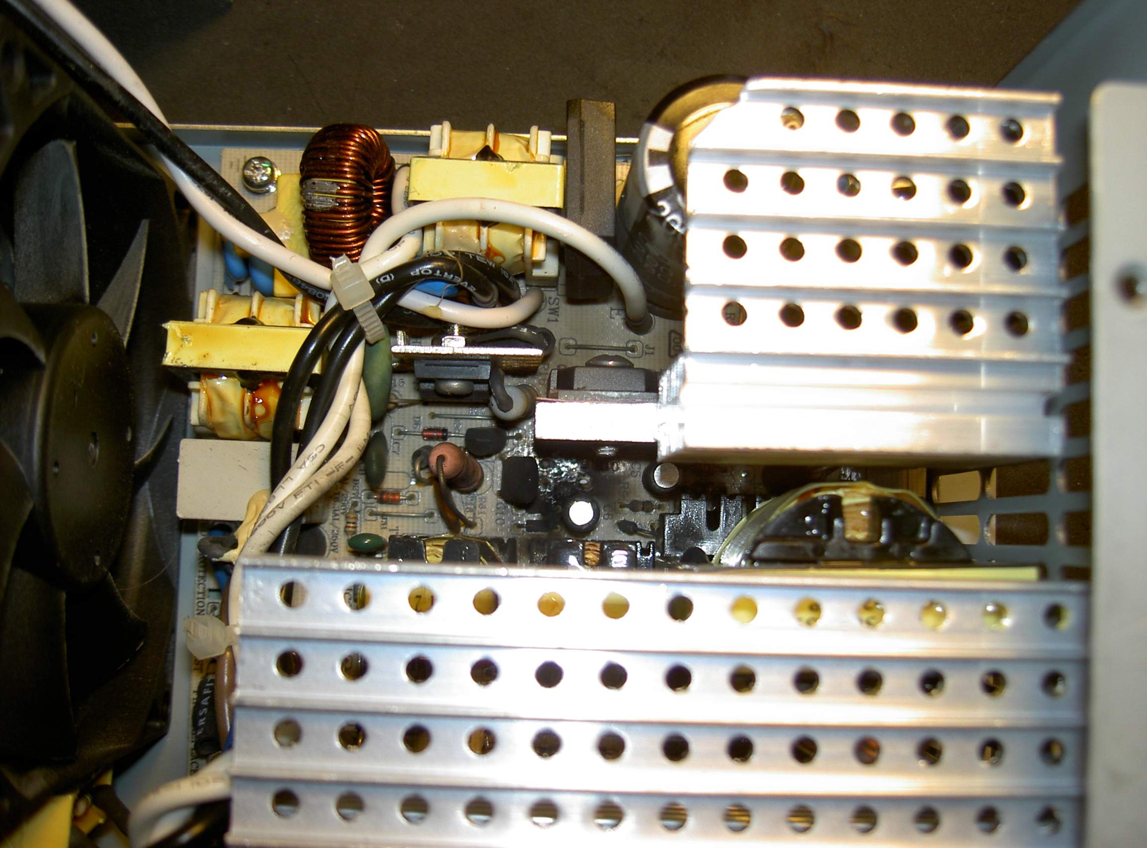

            Just as a follow up the PSU exploded a few weeks ago, I'm sure it was not due to my caps though... But man, the bang was so loud I lifted a meter of my chair!
            I have a windowed case and actually saw sparks and flames come out of the underside of the PSU!
            Upon inspection two resisitors where completley blown away, the only thing left was two solder pads on the circuit board and allot of black blow resistor stuff on the close by transformers ;-)
            The thing that amazed me was that the smaller heatsink of the two was over 100°C hot, I could feel the heat so I wet my finger and touched it brefily and there was the nice cooking sound ;-) Put my tempsensor on and it showed 90, 95, 99 and then HHH ;-)
            Mind you this was after I had managed to take the PSU out of the computer and cover off it which took around 5-10 minutes...
            Gotta love them computer parts! Fortunantley nothing bar the PSU got damaged and my computer is up and running totally stable again... Funny thing to note is that it was very stable right up to this explosion of my PSU...

              bet the mosfets on the primary side caused the flameout.seen many cheap psu where they run too hot and die like that.with near 400v and some big filter caps behind it when the choppers go the cases sometimes explode leaving only the metal mounting tab.

                  kc8, I noticed when I looked at the pic last night that the apparent source-point of the frying was right by the corner of the switch device heatsink. OTOH, it looks like the MOSFET or transistor at that end of the heatsink is intact. I was wondering whether an MOV fried due to one of the I/P lytics shorting, but that should blow the fuse. My best guess from the pic is that a MOSFET/transistor failed, causing either a snubber resistor or a gate drive (base drive) resistor to blow up. Electronic "autopsies" can be an interesting mental exercise.

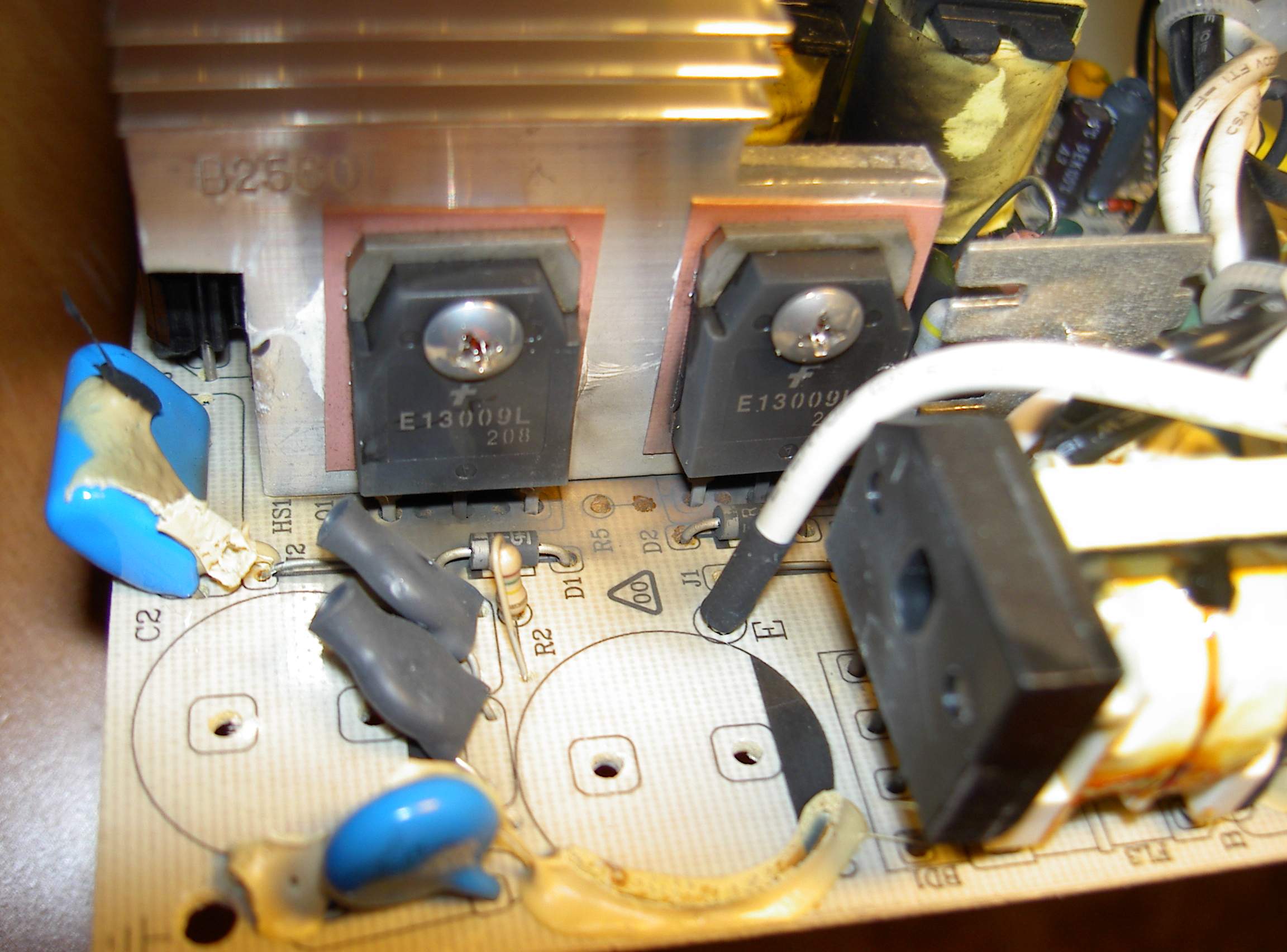

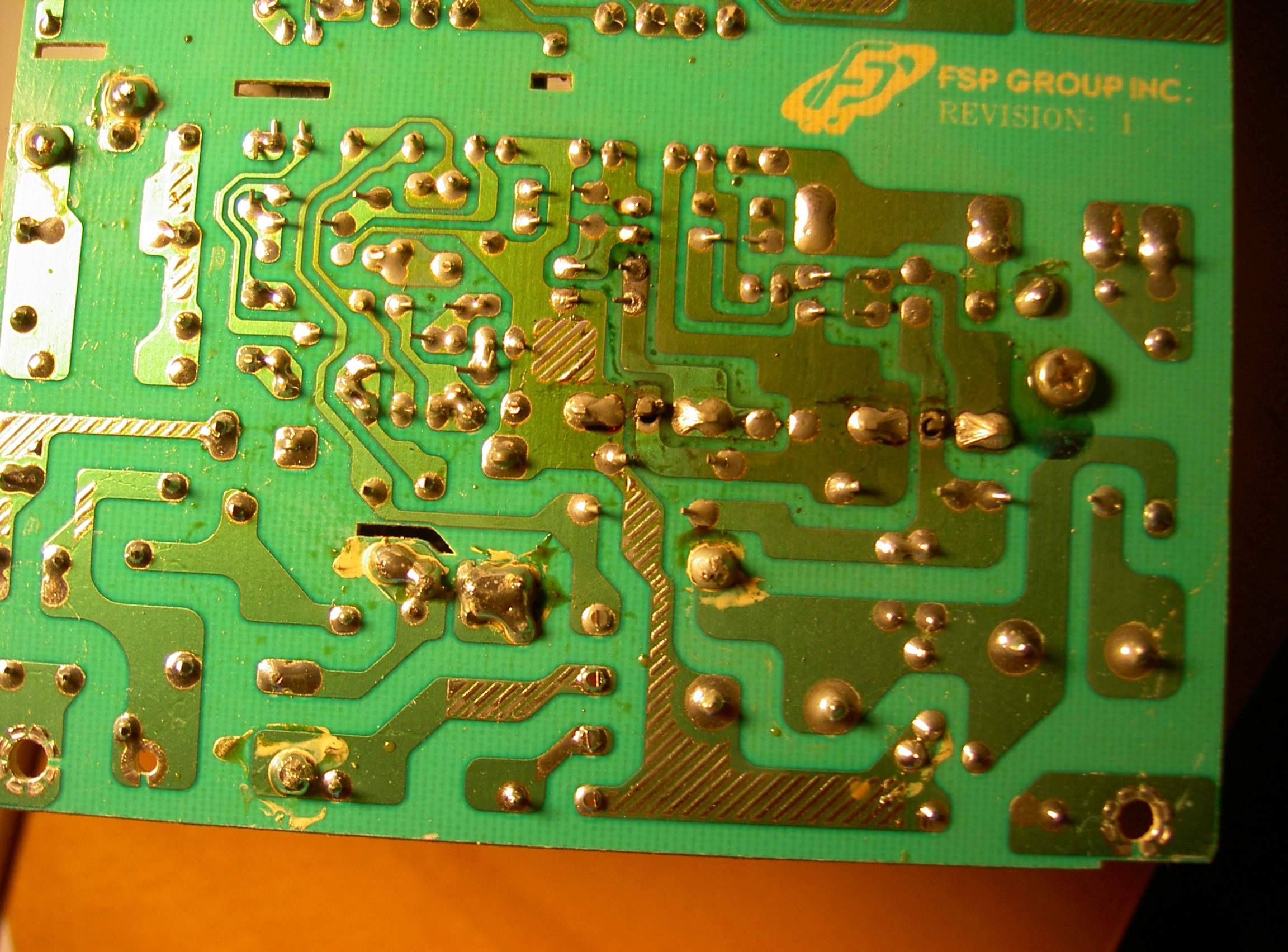

                    Just out of pure curiosity I desoldered the two main caps and saw that the two transistors connected to the heatsink where also burned...
                    A look on the underside of the PCB revealed that their "collector" pin was not soldered to the PCB anymore, probably the root cause of the problem...
                    A look right above this point also revels what was seen in the first pic I posted; the solder joint for R10 has actually melted!
                    So to recap; poor capacitors _and_ poor solder joints, guess I will not be buying Nexus anymore

                      The switch devices are transistors, a variant of a TO-220-package series created by Motorola in the late 70s. It's very likely that the device got so hot that solder at the center lead reflowed and dripped out; the same might have happed with the resistor. Looks like the resistor was the source of the smoke and flames, probably a base drive resistor. I'll bet your PWM chip is zorched.

                        This Nexus seems to be Fortron (FSP Group) OEM according to the PCB...

                          Were any transformers blown? In the first photo, a couple of the transformers appeared to have a hole.
