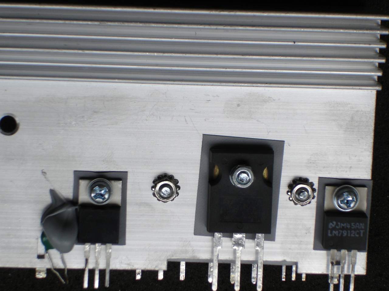

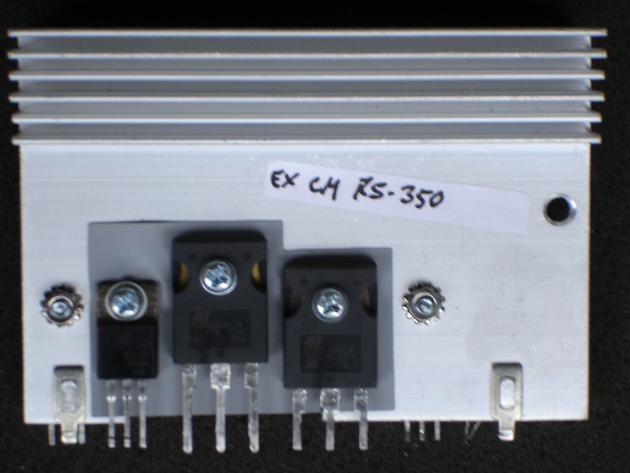

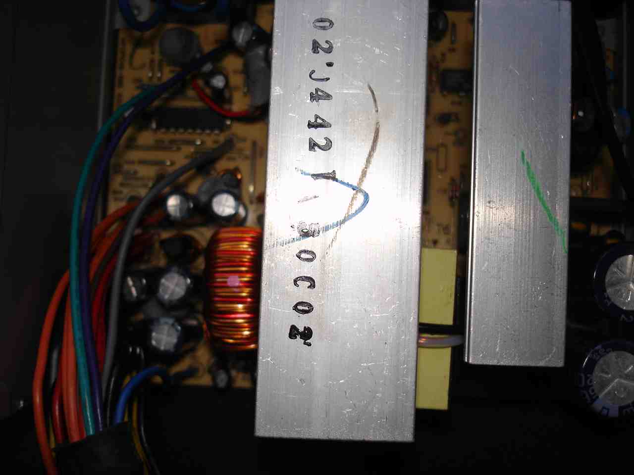

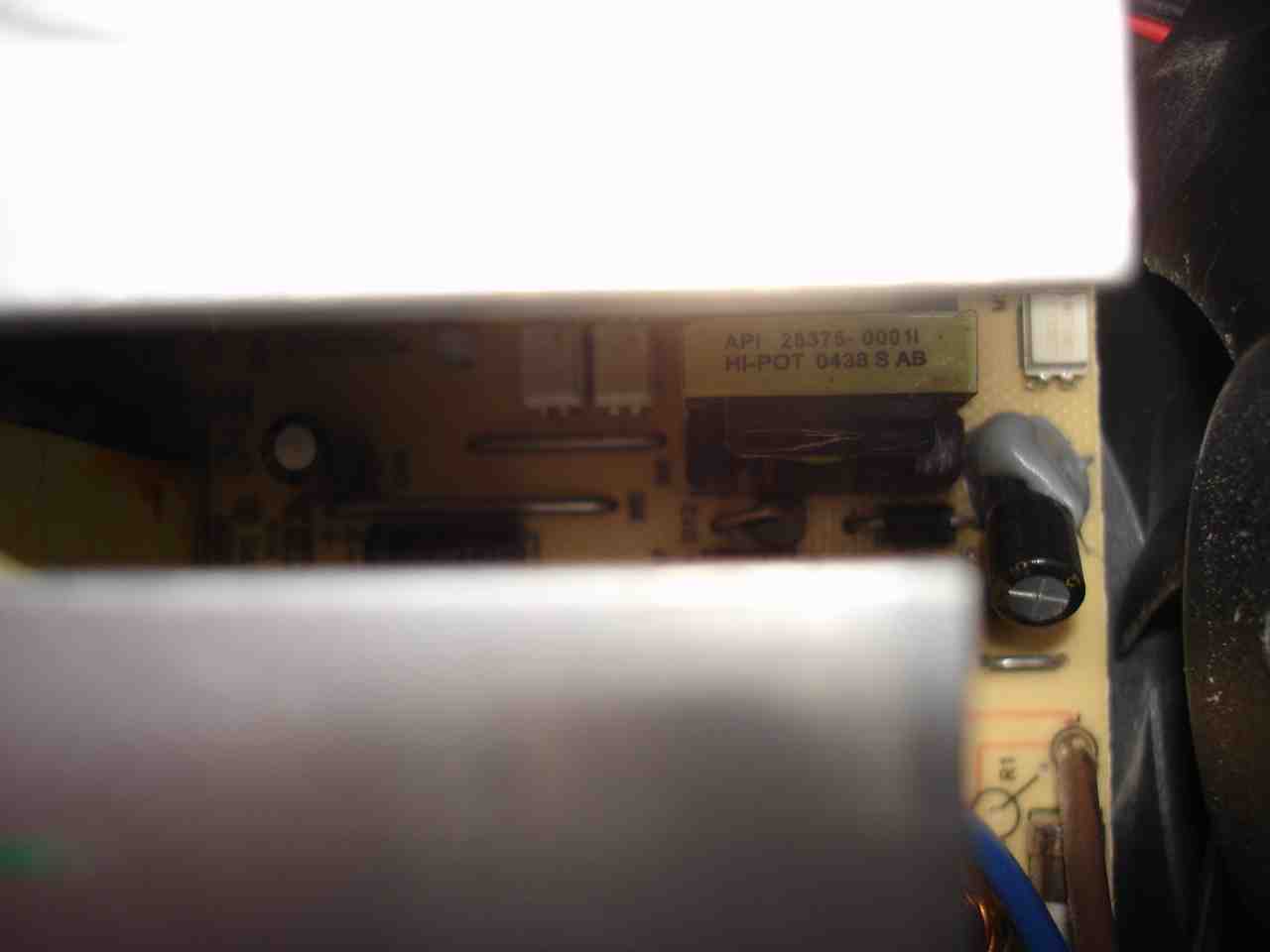

              Hope I've removed the correct components - does this heatsink contain the secondary rectifiers ?
              If not, guess I've provided some amusement
              On pic labelled EX CM RS-350, the components left to right are marked:
              1. ON B20100 CQ344 AKA
              2. ST STPS3045CW CC1CR VW MRC 423
              3. ST STPS3045CW CC070 VW MRC 424
              On other pic, L to R are:
              1. F D0420 FDP 7030BL
              2. ST STPS3045CW CC070 VW MRC 424
              3. N (National Semiconductor logo ?) JM45AN LM7912CT
              If I'm on the right track, what do I test, and how ?

                Dual Schottky's are essentially 2 high speed diodes (typically) in a cathode-to-cathode configuration at the center leg, the anodes being the outer 2 legs. You should read (about) the same from outer legs to center on all -3- of the *3045 devices in both directions. Black to center, red to outer(s) should be low. Reverse the leads and it should show open. The B20100 device values will be different, but should still give the same indications.
                A zero or very low reading in both directions indicates a shorted unit. Same the other way with a infinity reading indicating an open unit.
                B20100 - 20A/100v dual Schottky in a TO-220 package (datasheets only show D2PAK which has the tab and center leg chopped off to make it a surface mount)
                https://cdn.badcaps-static.com/pdfs/...739ff38292.pdf
                STPS3045CW - 30A/45v dual Schottky's.
                FDP7030BL - MOSFET
                LM7912CT - -12v regulator

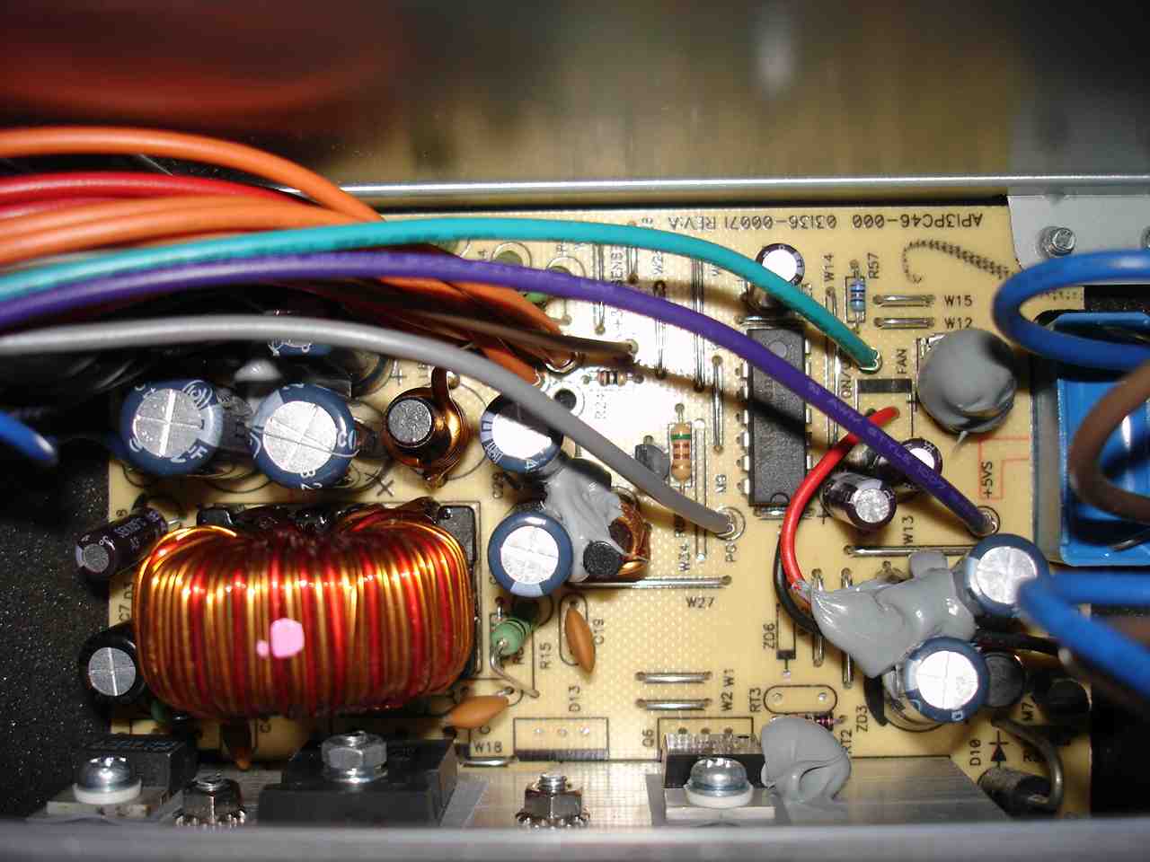

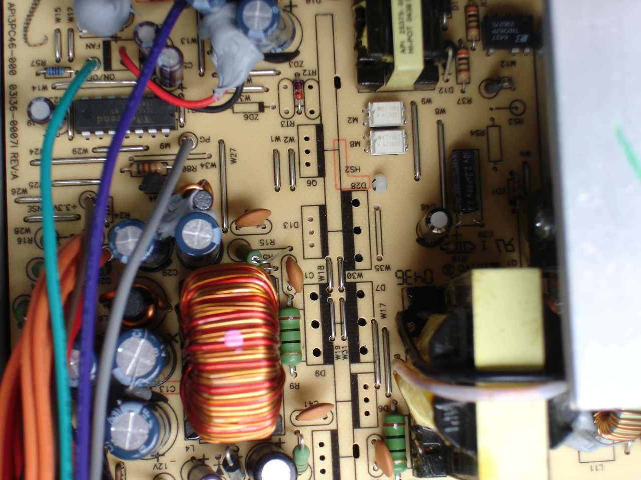

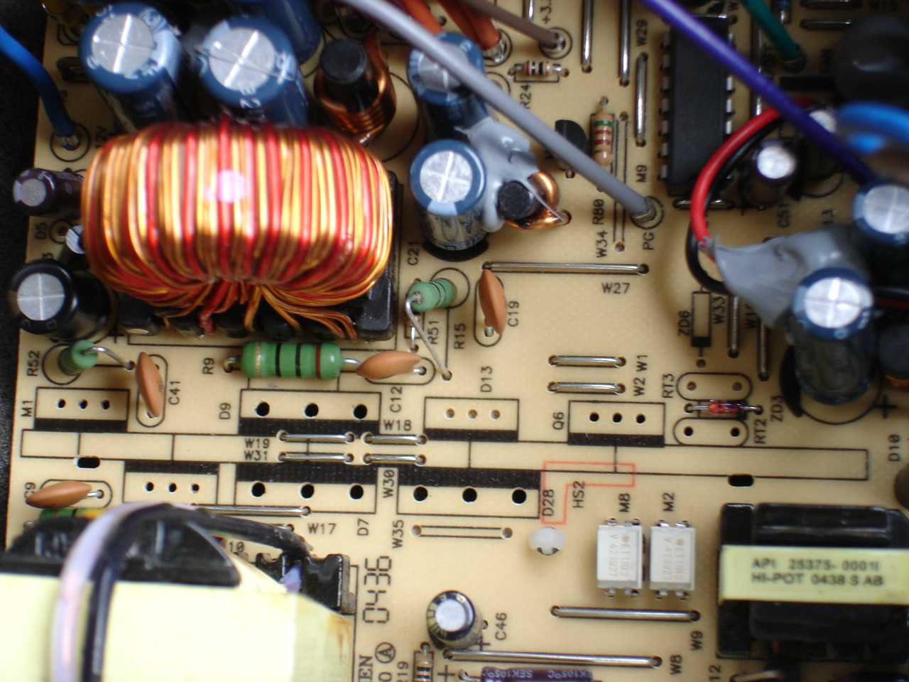

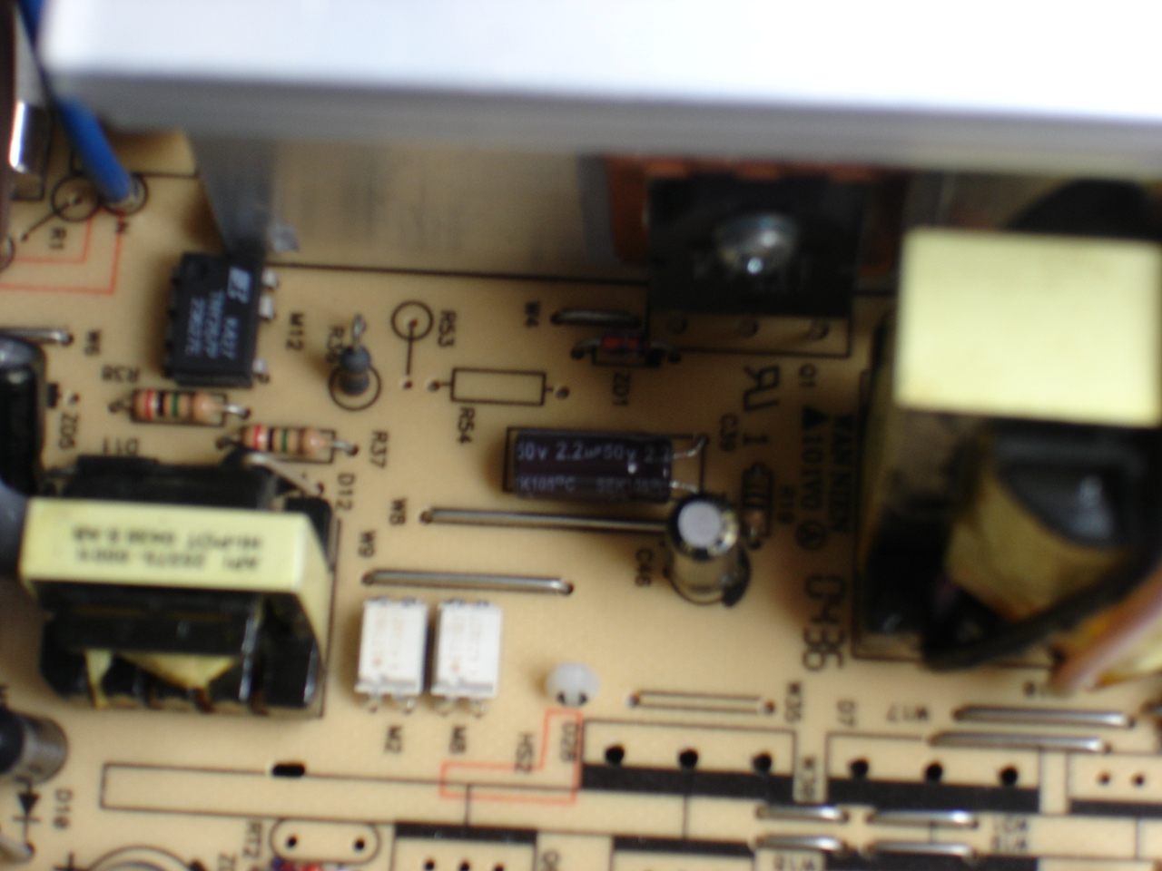

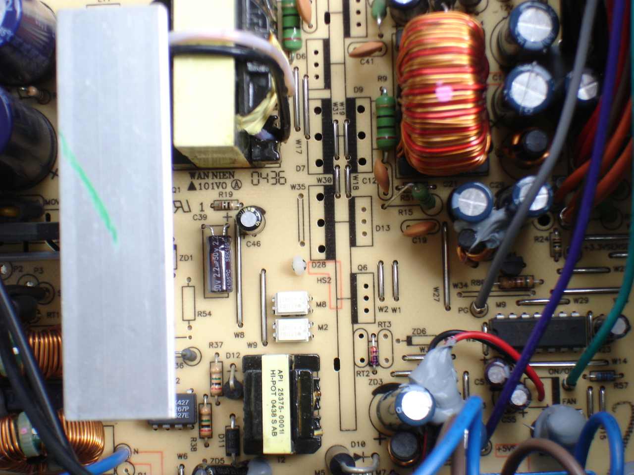

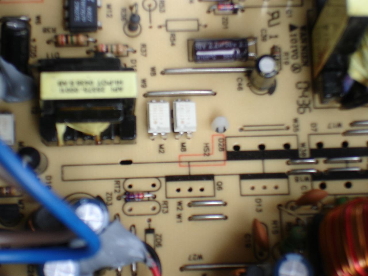

                  While you've got the heat sinks off, get some pics of the board on top. A top-down with some good light. Then a couple from some side angles. Something may jump out at one of us.

                      Re: Power supply broke

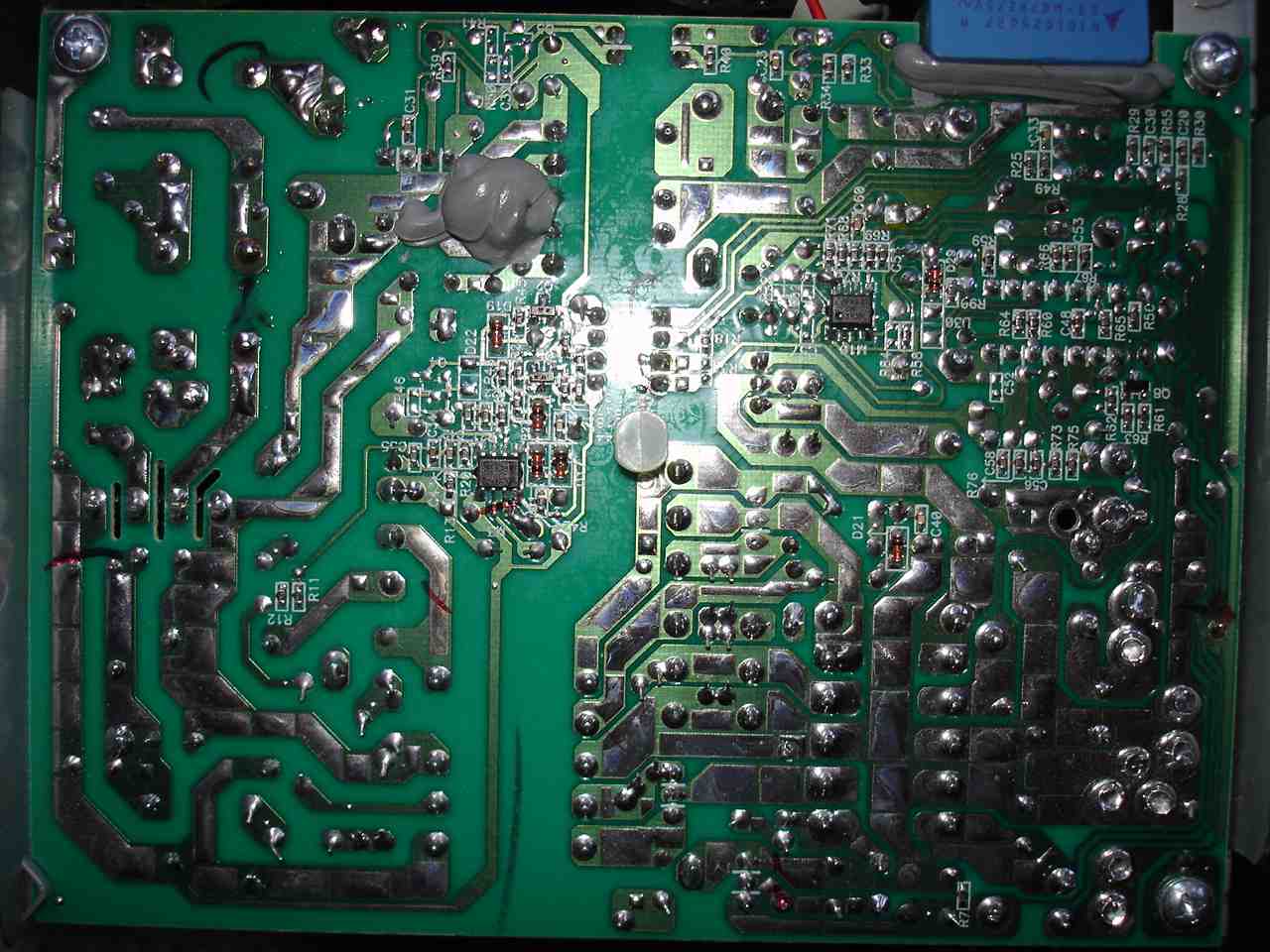

                      Have only removed one heatsink
                      Hope these fill the bill

                          Quoting from the Diode Test instructions for my Fluke 77:
                          "Forward bias: The meter displays the forward voltage drop (Vf) in volts up to 2V, and beeps briefly for one diode drop (Vf < 0.7V).
                          Reverse bias or open circuit: The meter displays 0L.
                          Short circuit: The meter emits a continuous tone."
                          I have tested the OnB20100, and the three STPS3045CW:
                          With the Red+ probe on the middle leg, there is no tone from touching the Black- probe to either the left or right leg
                          With the Black- probe on the middle leg, all give a beep when touching the Red+ probe to the left and right leg
                          For the OnB20100, the meter settles on a reading of .260, the reading is the same for both left and right legs
                          For the first STPS3045CW, the meter settles on a reading of .209, the reading is the same for both left and right legs
                          Same for the second STPS3045CW, the reading is .203
                          Same for the third STPS3045CW, the reading is .206
                          As a Go / No Go test, I assume that means all the secondary rectifiers are Go ?

                              With the meter set to Diode Test, I touched its Black- probe to the right lead of the 7030BL
                              Then touched the Red+ probe to the 7030BL's left lead
                              Then changed the Red+ probe to the 7030BL's centre lead, meter gives a continuous beep and reads .000
                              If I repeat the procedure with the probes the other way around, when I change the Black- probe to the 7030BL's centre lead, meter gives a single beep and reads .537
                              Could this mean the 7030BL is the culprit ?

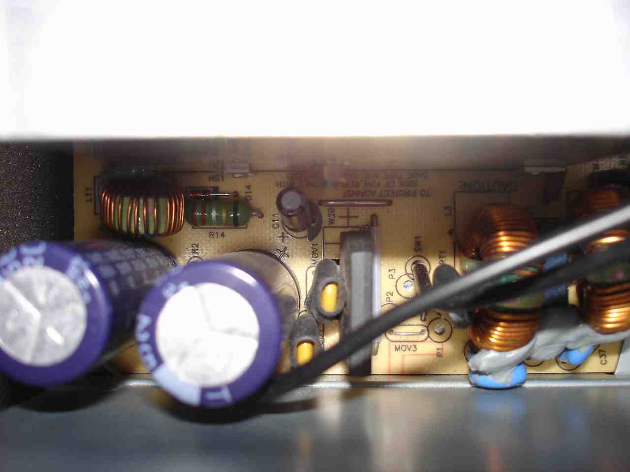

                                Check the device(s) on the other heatsink. That's the hot side so make sure those 2 big mains caps are at zero volts before you go working there.
                                Just because the caps -look- good, does not mean they are.
                                Do you have a supply of caps to work with?
                                What brand are the output caps?
                                Do you have an ESR meter? Capacitance meter?

                                    Okay. That reading is 2 ohms? That doesn't sound correct by the test procedure link. It says the "meter reading should go high". 2 ohms doesn't sound high. Did you mean to type 2,000 ohms?
                                    >>The output caps are Teapo (560uf, 200V)<<
                                    No, the OUTPUT caps. The ones down where all the wires come out. Those 200v caps are the MAINS caps.
                                    Again -
                                    Now you tell us you have an ESR meter...
                                    Should have used that First on ALL those OUTPUT caps. Check everyone that has the score marks "X" or "+" on the top.
                                    Readings of caps of 1000uF and up should be very low - 20 milliohms or .02 ohms or less. I don't have any experience with that meter. I think you can test them without removing them. Check the instructions.
