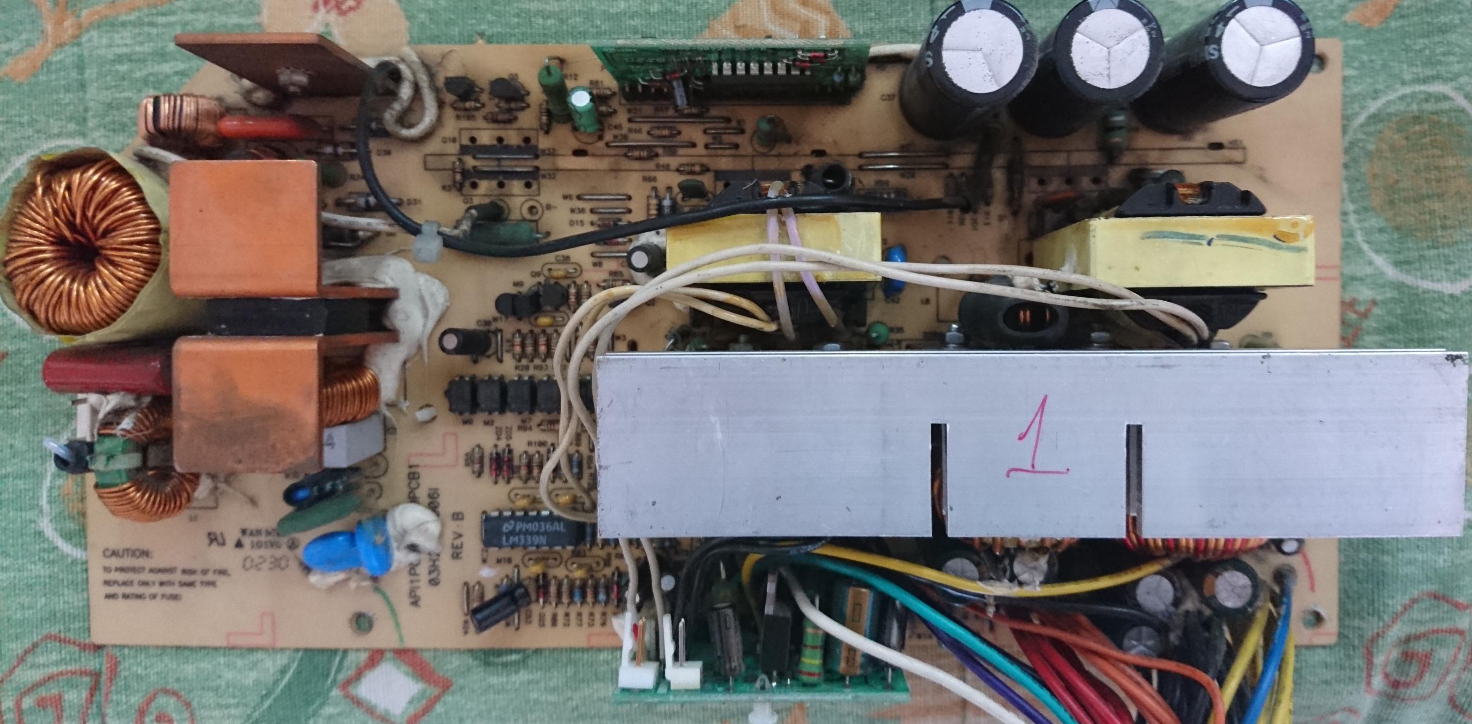

    so maybe it is shutting down from it thinking it is a over / under voltage condition?
    I don't know but when I try to turn it on the only thing powered is the motherboard and the video card

      Don’t try the PSU in your computer. Just force it on manually. If the diodes and fets aren’t shorted on that heat sink, that switching them won’t make a difference. Change C43.

            I inverted the diodes with the heatsink and they work on the other power supply, now I change the only two capacitors that I had no substitute and let you know let's cross our fingers

              nothing to do, same story, now I'm trying to reverse the transformers because I'm really getting angry

                Hmm... I did figure that switching the diodes on the heat sink won't help. So that capacitor didn't help either. As long as the transformer windings measure low resistance on both sides (primary and secondary), things are good.
                There is still a possibility, that one of the Mosfet's like Q1 or Q4 isn't switching. For that you need to check the Mosfet and the whole gate drive circuit. Could be a gate resistor gone high or open, or no output on the gate drive IC. No Vcc to the Gate Drive IC... etc. Problem is, that you have to be really careful working on the primary mains circuitry.

                  Ok now I'm reversing the transformers, I have already dismantled them, I understand which are q1 and q4 and I can control them, I have not understood what are the other components you say, if you make me understand with the map I sent you I would be grateful

                    I inverted the transformers and that's not the problem, on the one hand I'm happy because I think it's the only component that I wouldn't have found to replace it ... ok I await your instructions

                      The daughter card does more than fan control. There is a WT7515, this ic monitors the output voltages, (12,5,3.3) and provides protection as well as a power good signal to the motherboard.

                        O.k. lets make it easy. Try switching heat sink 1, same way you did with heat sink 2 from the good PSU to the bad PSU.
                        Look at your picture number 4, there is a green vertical circuit board and next to it is a small capacitor, change both.
                        I cant see under heat sink 1, where the transformers are. The same area is covered on the bottom picture.

                                          Guys then I'll update you, we managed to get it turned on, I didn't change the daughter card I only inverted the heatsink with the mosfets and replaced that small capacitor that Caps told me and now they both work ... Thanks for everything and for your patience! !! I have to repair a common atx, can I write to you here if I have problems or have to open another thread?
