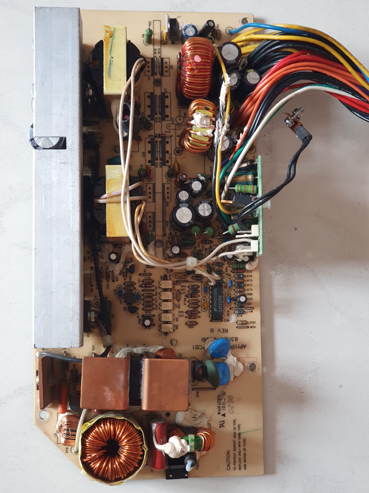

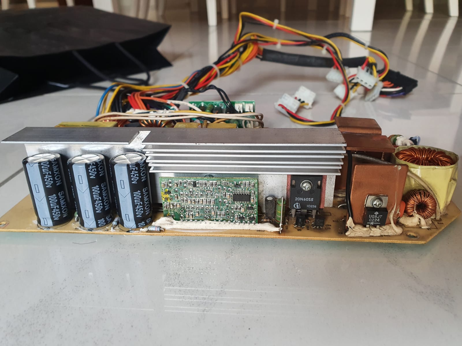

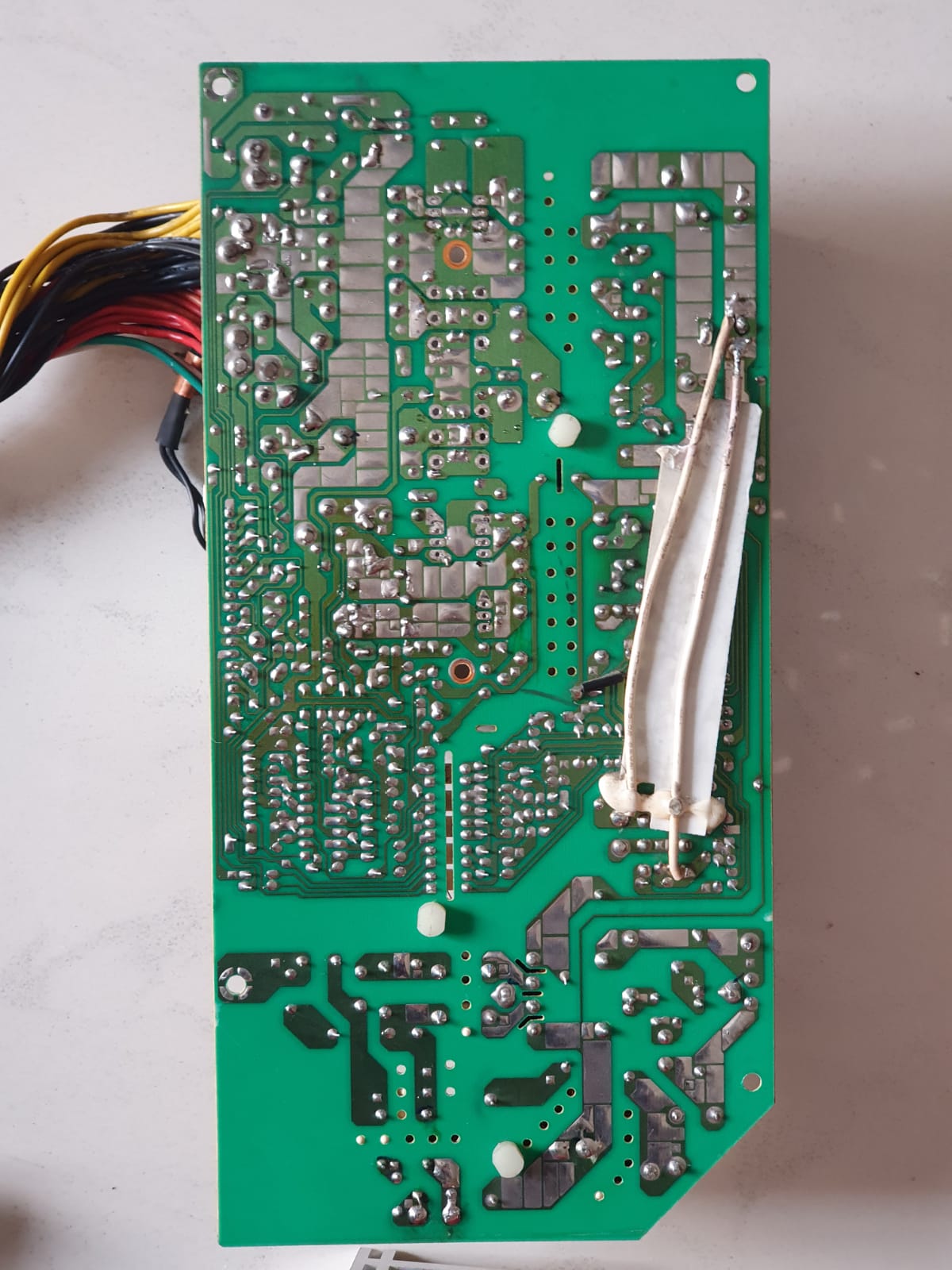

    How about you post some straight shot, high resolution picture of the PSU front and back. Also tell us which capacitors you have replaced.

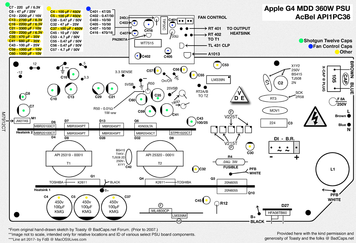

        Meanwhile, I have attached the map with the components, the replaced capacitors are highlighted in yellow, later I will let you have the photos, unfortunately the capacitors in the photos will not look good because of the tangle of wires, so from the map you will understand better

          here you are served

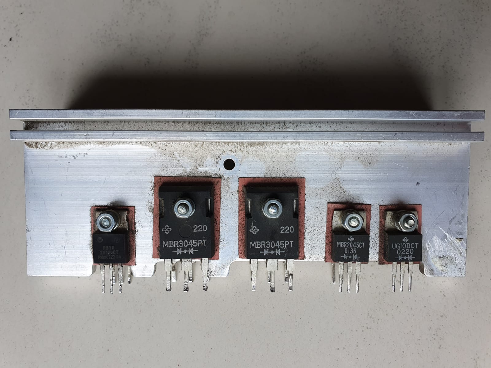

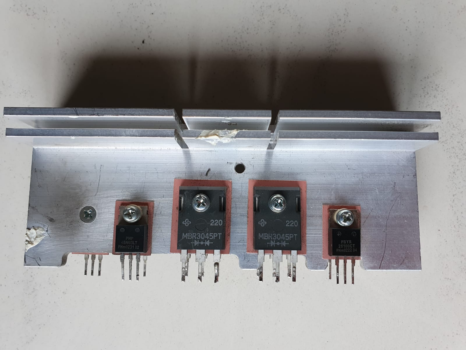

                                  O.k. That means the PFC on the Primary boosting the voltage is working. Is the blue wire -12V there? Basically you have it narrowed down that one of these 3 voltage rails is bad. Check the diodes for 5v, 3.3v and 12v, maybe one is shorted?
                                  You can check the transformers input and output winding's. If they measure an open (OL) than it is bad.

                                    have patience, these are tests that I have never done on the power supplies, what are the diodes? those on the heathsink? and if you can also tell me how I have to try the transformers, I have no idea there are so many feet and I don't know how to do it and how to set up the multimeter ... sorry and thanks for your patience, maybe after this I will be able to repair all the power supply

                                        I have a short on the red wire, the yellow one and the orange one mark me a value but the multimeter does not sound
