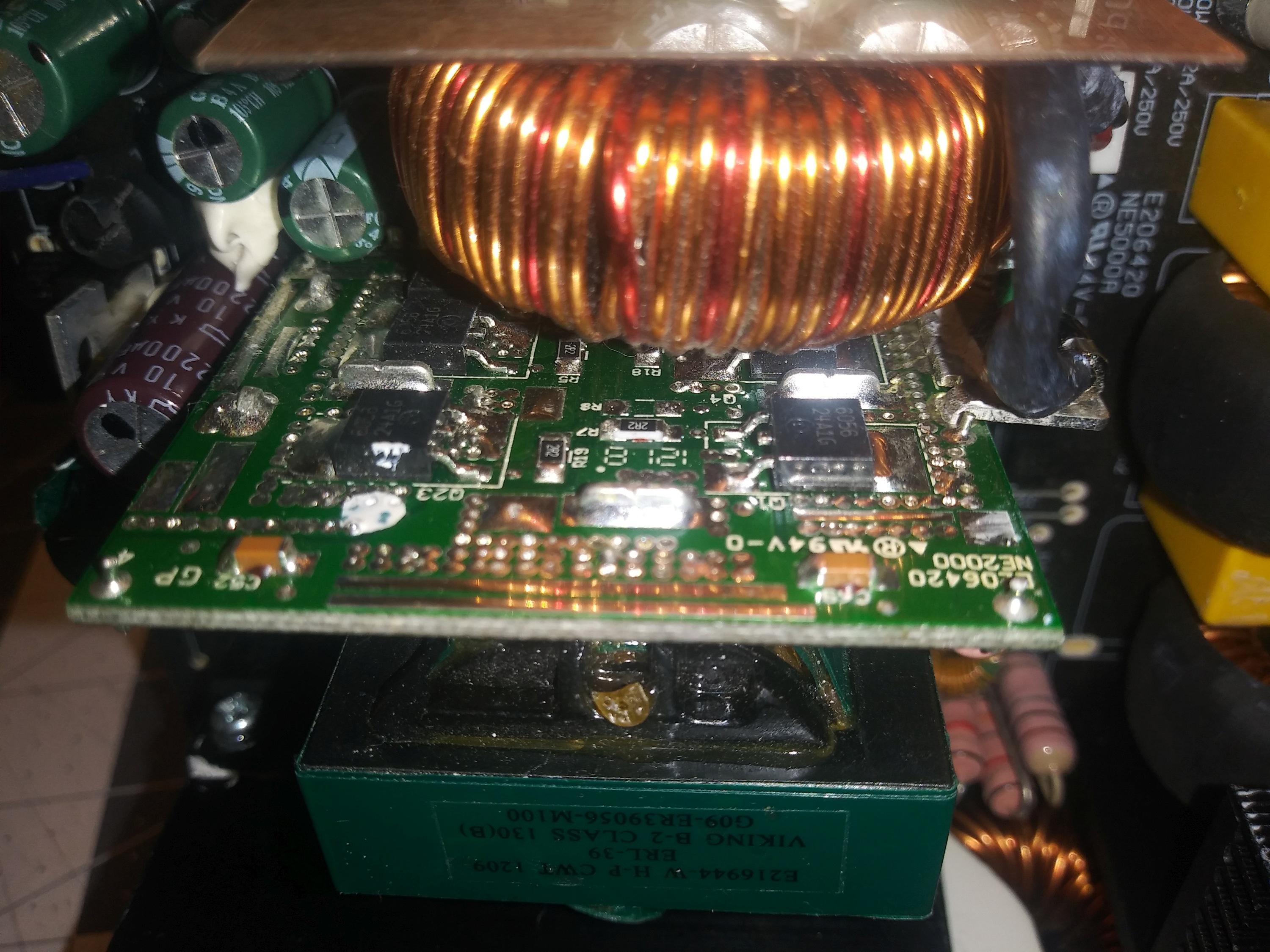

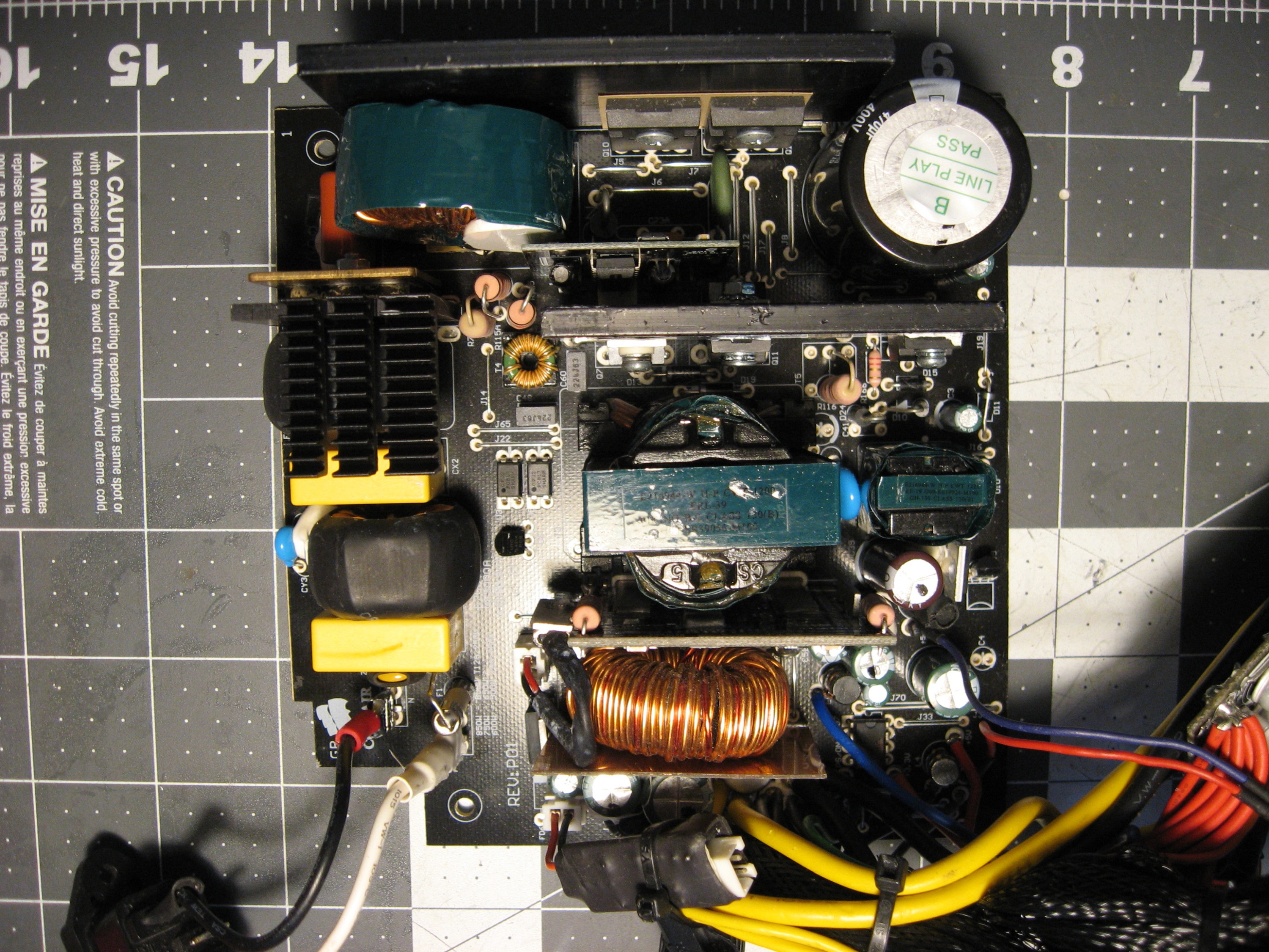

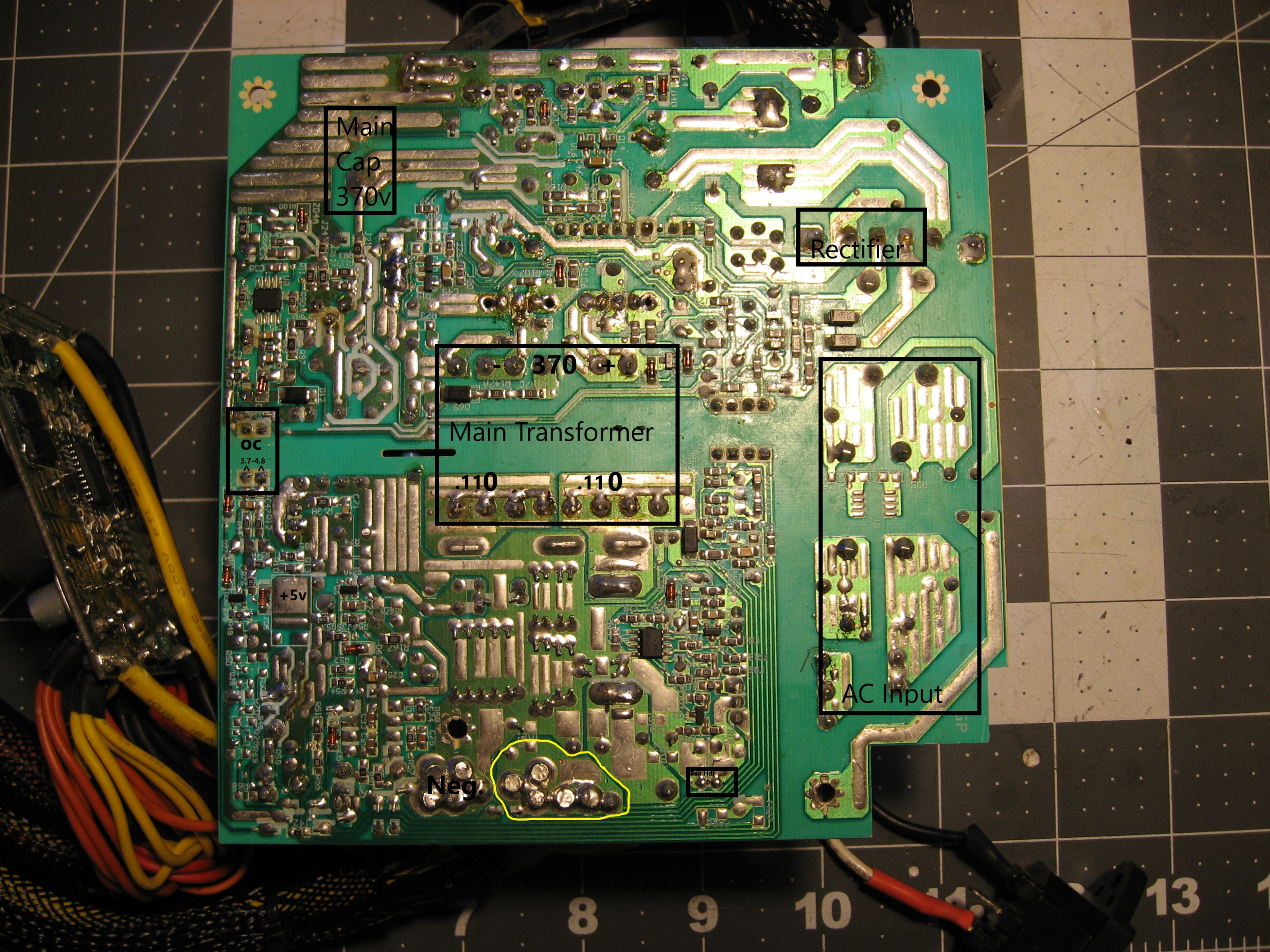

    Had this thing laying around for a bit so I thought I would drag it out under the current global circumstances and see if I can repair it. I have recorded my readings on the image below indicating basic layout and some voltage readings. I am not an EE but I know NOT to mess with the large cap.
    EDIT: Cathode is top terminal of Main Cap.
    All votlages taken on secondary side were to ground or "neg" in the image.
    Essentially the primary side is charging to 370ish. I do have 5v on pin 11.
    Grounding pin 4 (green) while small fan and two SATA drives are connected for a load while probing.
    Visually I cant see anything that looks out of the ordinary. The empty holes on the primary side were sucked out inspecting they are n/c by design.
    Anyone have any ideas where I might look given this information? I have not looked at the small vertical board (image below).

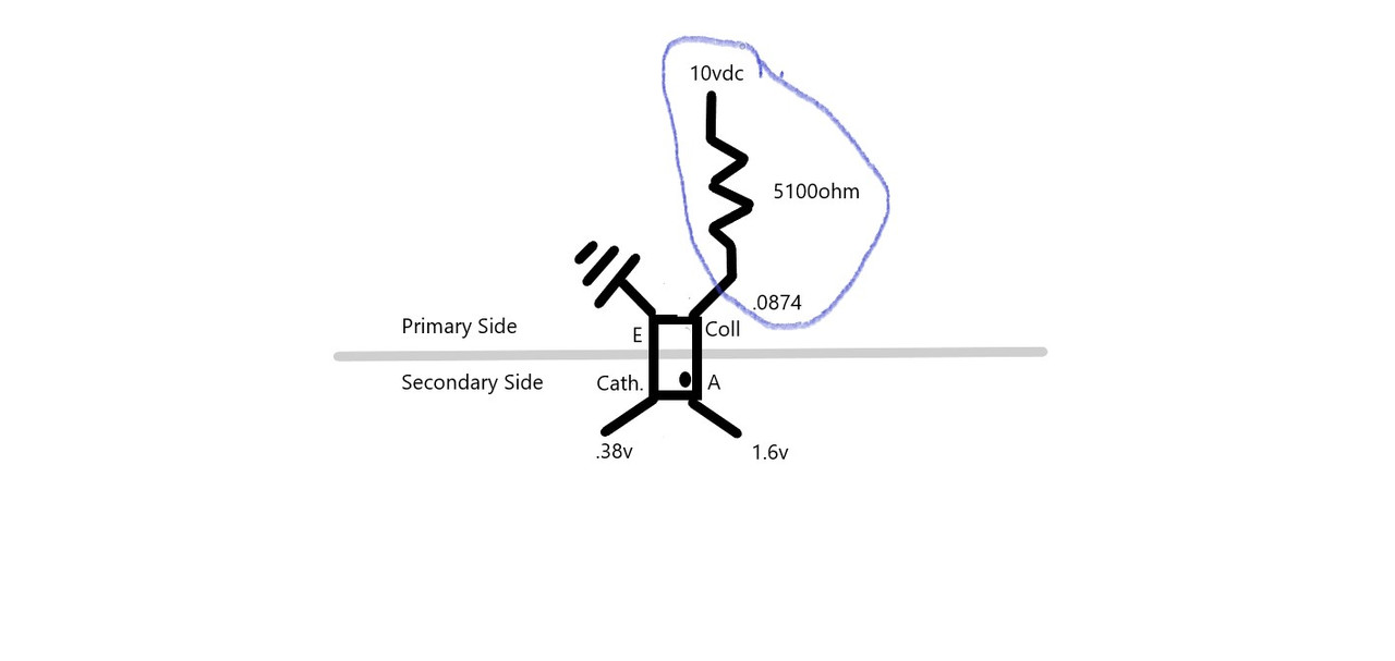

    • ShortCircuited
      • Jan 2020
      • 101
      Re: Corsair GS800 Power Supply Problem
      This diagram suggests the secondary side is not sending a signal to the primary to provide power to the transformer for 12 volts?
      Anode-Cathode drop is 1.08v according to DMM.

        To start off, I’d check if any of them secondary voltage rails is shorted. Also check the main filter capacitor for 380VDC.

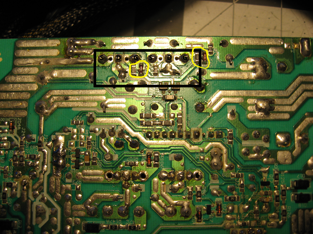

                    Thanks for the suggestion. These two FETs you mentioned are Q10 and Q15 and are 6R190E6s (TO247 package) for which I cannot find the datasheet so I am consulting a C6 datasheet.
                    The drains are jumping around erratically between 138 and 172ish according to my DMM (UT61E) on both FETs.
                    The glass diodes (D37 and D40)s (circled yellow) are both 5.6ohm. Why are D37 and D40 (circled yellow) in parallel with a 4.7ohm resistor? What good are the diodes if they are essentially shorted?
                    I believe I have the pinout correctly labeled on he two FETs-

                      Those are likely in the gate drive circuit, they are used to modify the turn on and turn off of the fets during operation. that is normal. Those might be the pfc mosfets, The one (or two) I refered to are (Q11?) the ones that drive the transformer.
                      Those type of meters (UT61E) being lower cost, will be confused by the 20~40khz high frequency signal that is on the pfc mosfets.
                      Remember the pfc boost circuit is working. The raw dc voltage on the main capacitor would be 160vdc, but the pfc is boosting it to 380vdc.

                        There are a pair of 20N60S1s (TO220) physically closer to the main transformer and are labeled Q11 and Q7. You have schematic?
                        380V
                        I do have a DSO138, but I can't find it useful for anything. I dont think it can handle the voltage to be of any use here. EDIT: 50v 200khz max.
