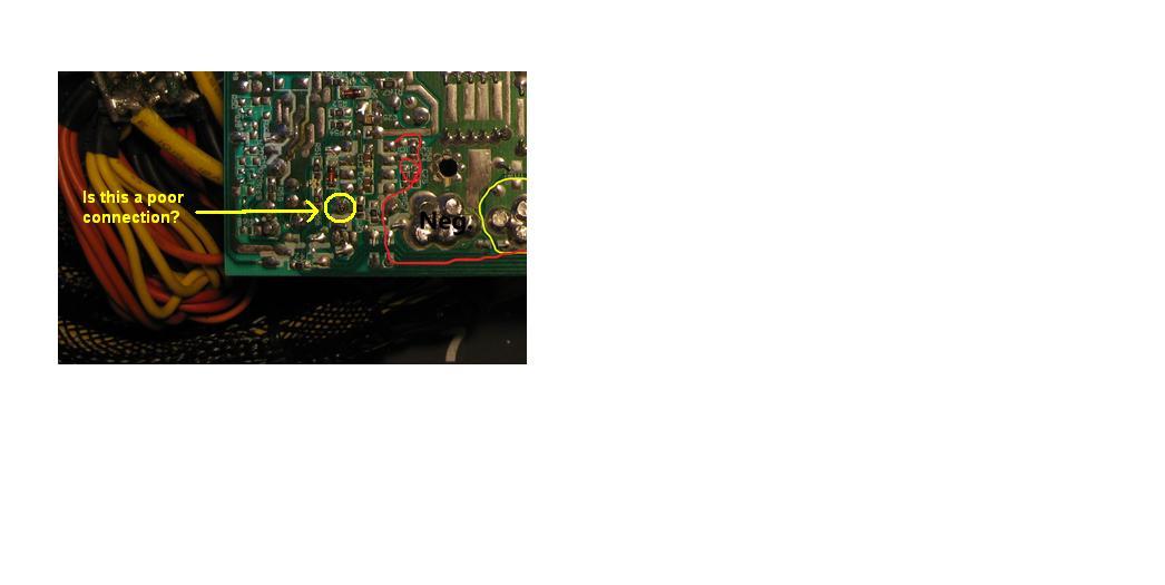

      Check why the PSONB is always high, check the circuit from the power supply on line, it should change when that line is open or grounded.
      Also it is possible that the +5v is a bit high also, it is almost 6v (I see you changed it to 5V)
      I circled a point that did not look good in the picture but it might just be because it is a picture.

        Thanks...maybe I can desolder PSONB and see if it powers off?
        Probably the light...I flood it with LEDs for traces and photos.
        Any idea how/why the voltage drop of that cap and resistor in parallel drop by 14v?

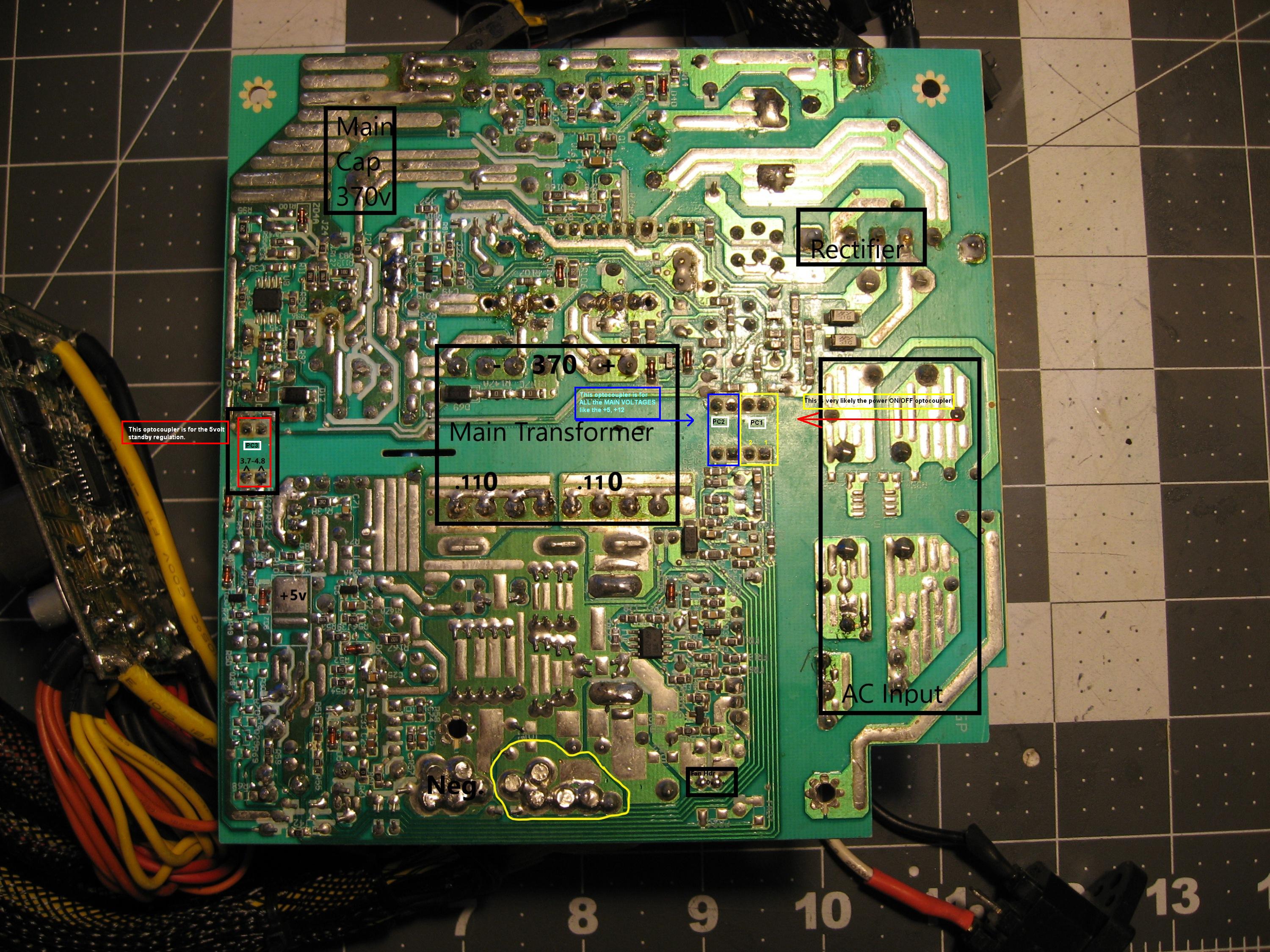

                    It has three optos. One of the two optos closest to the main transformer is making a weird buzzing noise that elevates significantly when checking voltage on the secondary side of the opto. The adjacent opto does is not affected by a voltage check and does not buzz. I changed the one closest to the transformer and the buzzing is the same with the new opto. I also desoldered the two terminals (secondary side) to this buzzing opto and it was still on.
                    EDIT: Briefly desoldered both OCs closest to the main transformer (secondary side only) and it is still running.
                    • R_J
                      • Jun 2012
                      • 9515
                      #70
                      Re: Corsair GS800 Power Supply Problem
                      The one optocoupler by itself is likely for feedback regulation for the standby 5v. The other two, the closest one to the transformer is for regulation for the main +12,+5 etc. The one next to it, should be for turning the power supply on and off. The fault might not be with the optocoupler but could be either on the secondary side, not controlling the opto, or on the primary side, not switching the primary on and off.
                      You do not want to disconnect the feedback optocouplers, without the feedback (and regulation) the power supply could cause the secondary voltages to very high and cause damage.
                      When you open or ground the power ON pin, the voltage on the (on/off) optocoupler (led side) should change.

                          If you remove the feedback by removing the optocouplers you risk BLOWING UP THE POWER SUPPLY!
                          The voltage on one of the pins of PC1 should change when the power supply is switched on and off (by grounding the wire) I will guess that either pin 1 or pin 2 of pc1 is connected to 5 volts and the other pin will be controlled by a transistor, and when that other pin is taken low, the optocoupler led will light.
                          So trace back pins 1&2 of PC1 and see what they are connected to, I can't make out the traces in that area from the picture.

                              I could'nt make out the designations from the picture so I made my own. So U3 must control the power supply on/off, but it looks like it is controlled by the wt7502 if it only connects to it's pin3.
                              If you still have the wt7502 removed, if you ground the pin3 trace does the power supply turn off?
                                      just ground out the jumper going to pin2 of the opto, that will turn ON the internal led (the 220Ω) on pin1 is the current limiter from the +5v for the opto.
                                      At some point the wt7502 does control this line.
                                      The way I think it worksis:
                                      When first pluged in, the main power supply turns on for a second and outputs the +12v, +5v & +3.3v, IF they are correct, then PGI goes high and FPOB goes low turning off the main supply, When PSONB goes low, FPOB goes high turning ON the main power supply again. Or I could be wrong.
