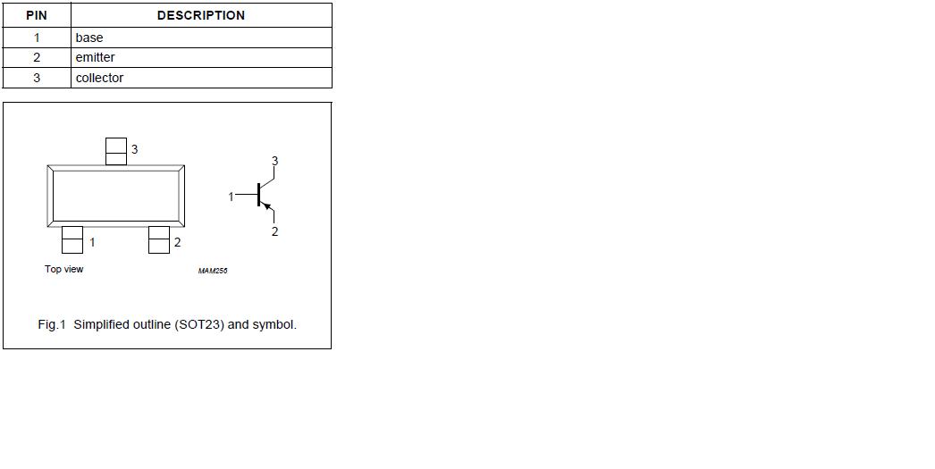

                The ZD is a PBSs5350t, here is the pinout. I suspect the transistor is shorted emitter to collector, that would explain why the ps won't turn off.

                    They won't work, "these" are N channel mosfets, you need a PNP transistor

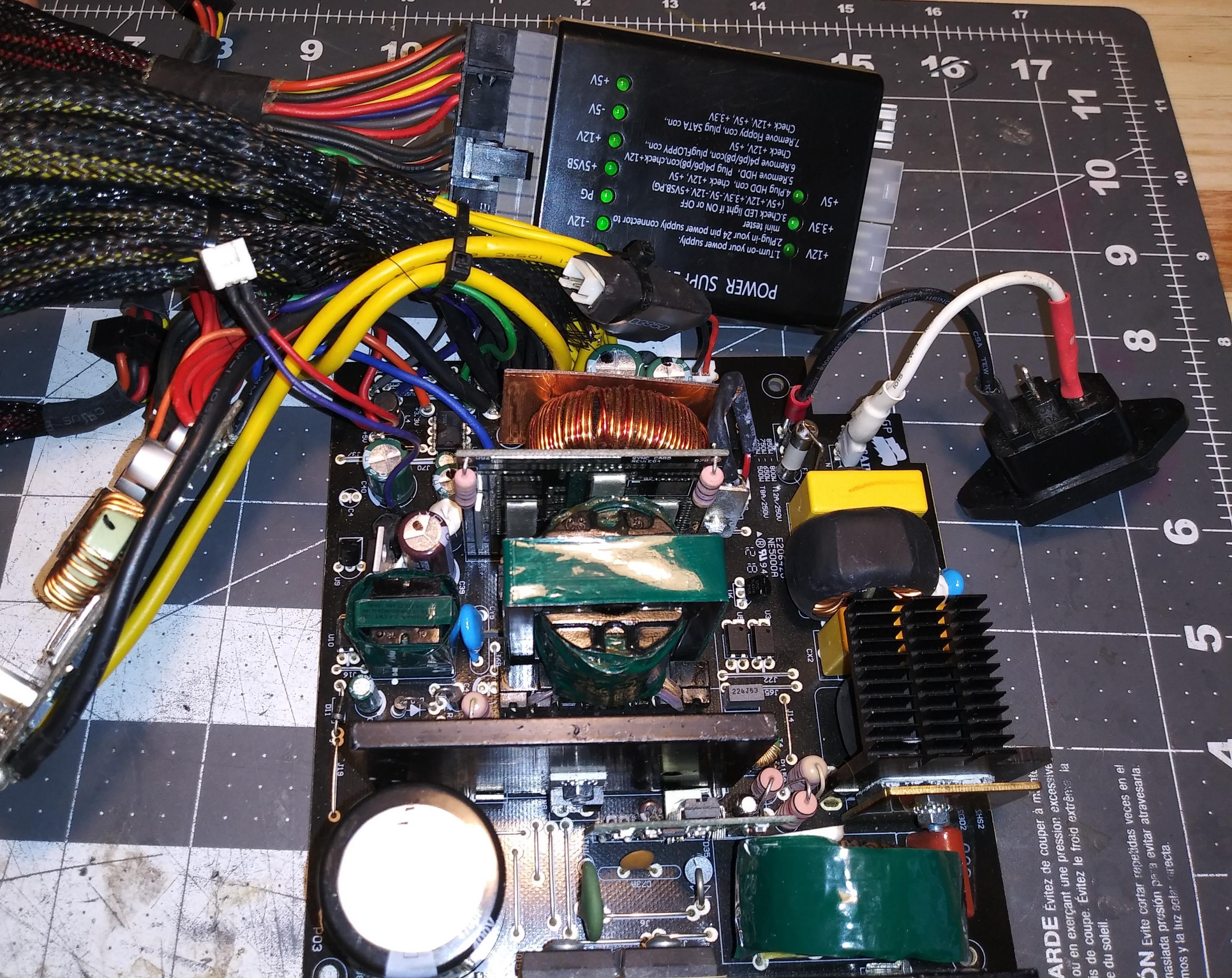

                                Catching up (almost a year)...Power supply was constant power-on state. We found Q12 (primary side PNP transistor shorted collector to emitter out-of-circuit and possible (actual) cause for constant on state. Replaced w/ PBSs5350t as R_J stated to me repeatedly-THANK YOU! No longer constant on when replaced. PSU now only gives +5vsb. Main cap is 160vdc.

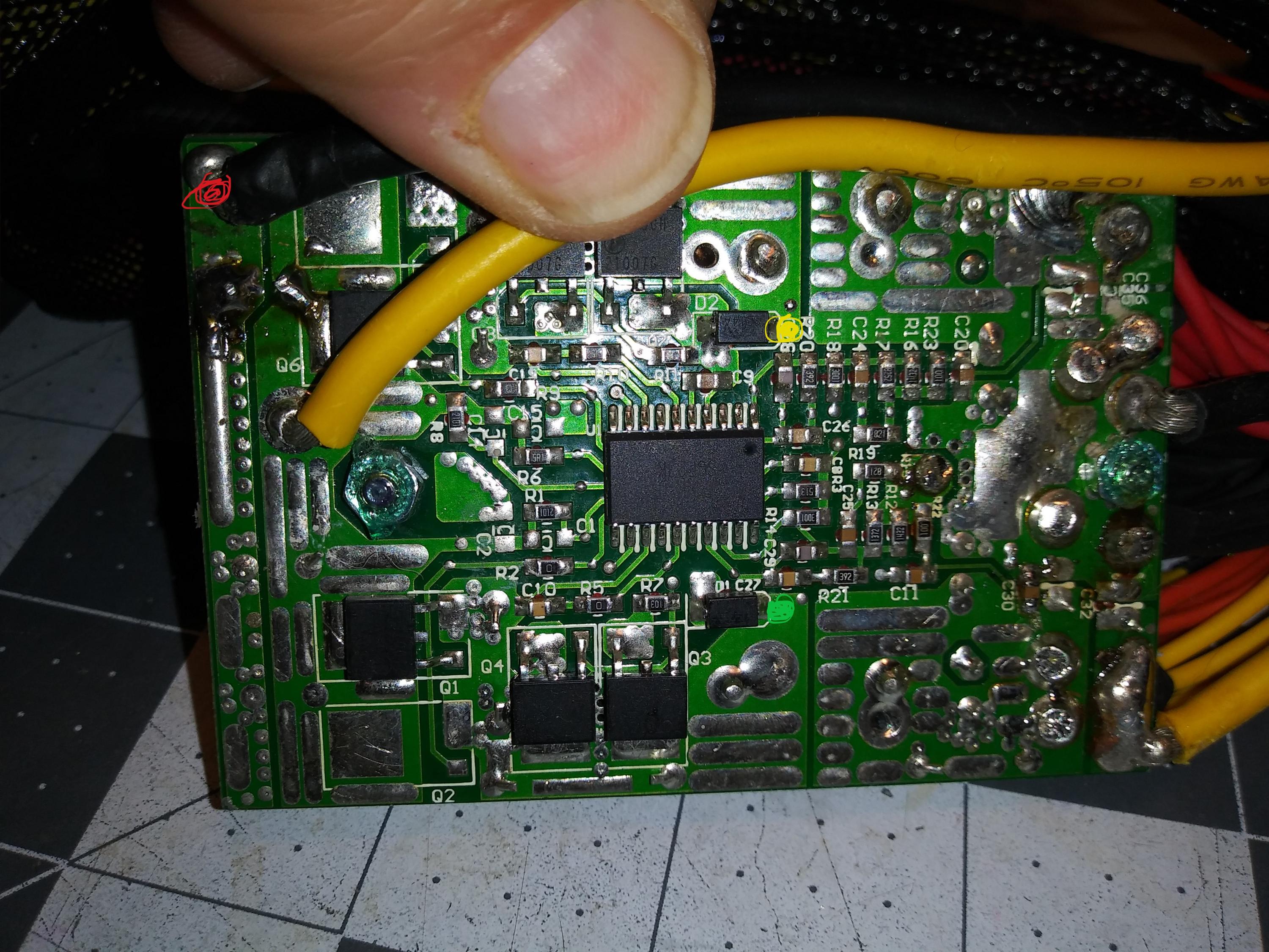

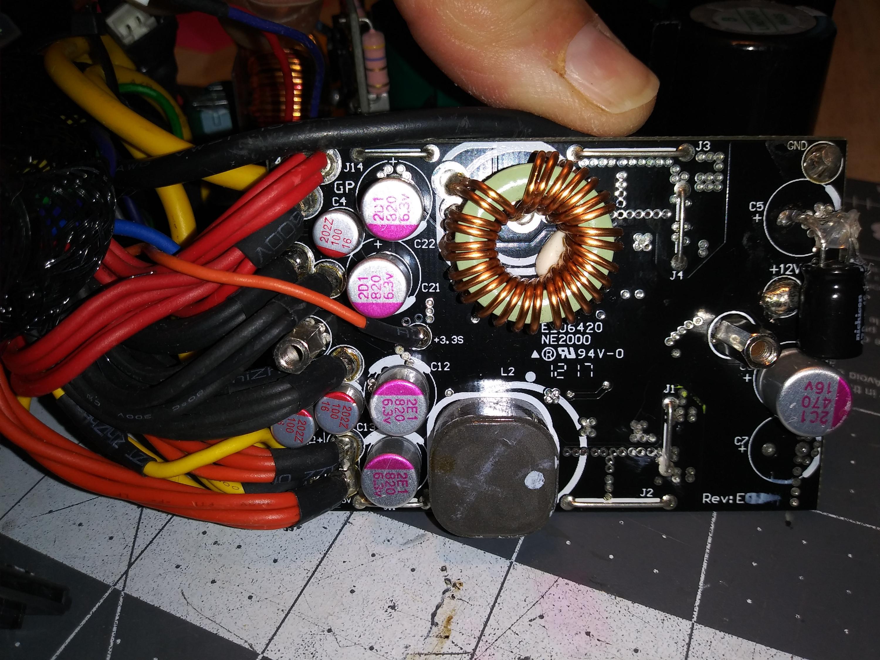

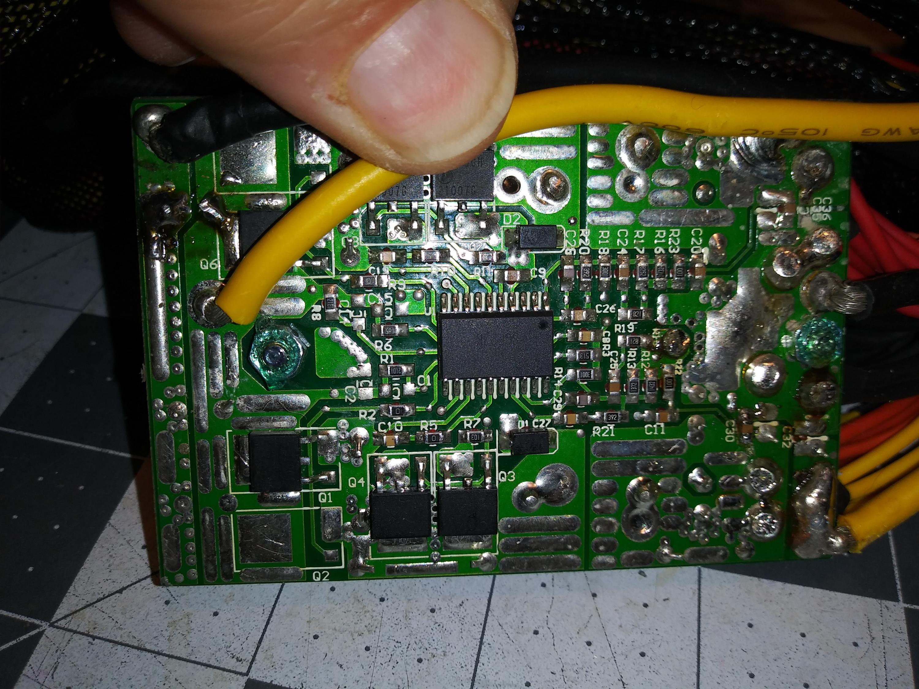

                                  When I plug in this power supply tester I have 15ohm on +5v rail. If I simply jump green-ground at 24-pin for power on signal this short is not present. Verified PS tester works on another known good PS.
                                  Pulled the only +5v signal from this daughter board to the main PCB which runs from this daughter board and the 15 ohm short remains. Will dig around on the daughter board.
                                  • ShortCircuited
                                    • Jan 2020
                                    • 101
                                    #97
                                    Re: Corsair GS800 Power Supply Problem

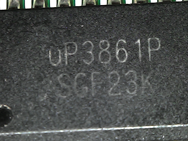

                                    Applied 12v to daughter board and it drew 300mah (PS set to 800mah). U1/uP3861P did get warm. Any ideas on testing this 20-pin to confirm? Thanks for any help. PS tester makes a very interesting high frequency noise/squeal not made when connected to other power supplies.
                                    Anyone know where would I find these uP3861P? OrderNo. uP3861PSAF SOP-20L
                                    • R_J
                                      Without the ic driving UG & LG the vcc current should be around 5~10ma @12v. Check that the mosfets are not shorted. As for a source, likely China

                                        In-circuit PH1 (8) is grounded (15 ohm) to daughter board ground.
                                        Pin PH1 (8) to PGND (10) is 15 ohm in-circuit
                                        Pin PH1 (8) to GND (4) 15 ohm in-circuit.
                                        I'm no EE...just an unhealthy obsession with fixing "stuff." This appear problematic? Maybe LG1 or UG1 shorted as you suggested?
                                        Pic shows PHL circuit. Sure seems the short is in this region.
                                        Looks like alibaba is only source. Emailed mouser and digikey for availability.
                                        Q 6, 7 and 8 are identical. Probing Q7 and Q8 in-circuit from D to S is 15 ohm. surrounding CCs are not showing short in-circuit.
                                        Pulled D2 short remains. Diode good.

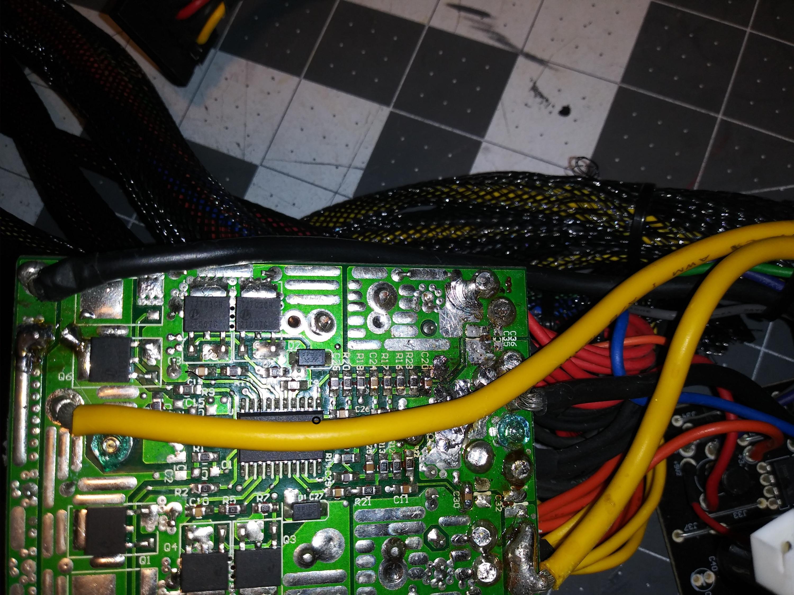

                                          Pulled Q6, Q7 and Q8 15 ohm short remains. D/S diodes checked out OK out-of-circuit.
                                          Pulled U1 short remains. UGH
                                          red dot to green dot is 128ohm in image below. This is the same for the 3.3v, and 12v rail to ground, but 15ohm to the +5v rail and open circuit when power supply tester is removed.
                                          red dot to yellow dot is 15ohm in image below.
