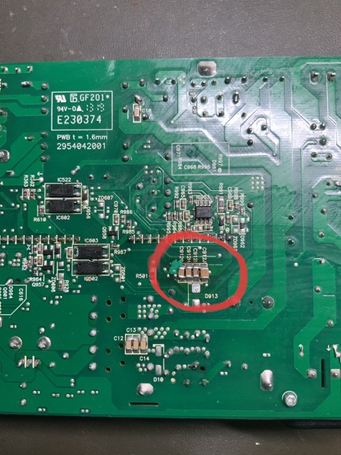

    No, I did change the 1207A PWM and the comperator on the primary side on the little daughter board. Same result. The PWM isn't getting hot. It doesn't make any sense to me. There is another comperator on the backside of the main board, it also is on the primary. Haven't checked around there yet.

      Trace that line connected to the 51K resistor, something is drawing way too much current. If it was'nt the ncp1207a then it could be the DAP6A, it is a similar pwm ic.

          They both need to have the HV voltage at least around 50vdc so the startup cell can produce the vcc voltage.
          For the 1207a PWM, I get 1.5V on Vcc and 17.5V on the HV pin.
          On the DAP6A are 1.3V on the Vcc and 6.5V the HV pin.
          The voltage on the HV pins are being loaded down by something, if it's not the ic it must be something else.

            Yesteraday I went for why these big resistors heat up. Went to the 1207A PWM, checked again the path between it and the Mosfet it drives and nothing to be found. So I took the Mosfet out, no change. Took the new 1207A out and there was no more current draw on that 51k resistor. So removing the PWM does stop the current draw on the resistor. Put that 1207A back in circuit and voila, the resistor gets hot again. Haven't checked the DAP6A side yet, it functions the same way.
            O.k. so lets say there is a problem with one of these PWM's, something is telling them both to not power up. An error on one side, should affect the other side of the PSU. I don't think that only a 2/3rds of that PSU runs, while the other 3rd doesn't on this PSU.

              The datasheet say's the ic will not operate with a vcc below 9 volts

                I measured that 51k three different times and each time it measured 51k. Correct me if I am wrong, but lets say the resistor changes resistance under load (value going higher) it just would drop the output voltage but should not getting hot to the touch.
                Earlier I had the 1207A out and before I replaced it with a new one, I had full power on both sides of the 51k resistor. I proceeded to check the DAP6A and it still loaded it's 240kOhm resistor down to 6.5V! Now why would that be, unless something is telling BOTH pwm's to shut down.
                To recap: the 380v goes through the 51k resistor to the 1207A. The 380V go through a different 240kOhm resistor to the DAP6A.

                  The ic's must be getting told to be turned off.
                  I re-check the math and 7ma through a 51k would result in a 357 volt drop (2.64 watts).
                  The dap6 must also be turned off and drawing about 1.5ma
                  It looks like both ic's can be turned off via pin2 (FB pin) So I guess pin 2 must be low on both ic's and could be controlled by a transistor somewhere, and something else could be telling that transistor to turn both ic's off

                    Yeah, that's what I am thinking, it's a feedback problem and the FB pins are low on both. I have to trace these FB pins where they go next. I was going to do that in my post 21, but anyway... gonna do it in a bit.

                      no dice. the fb pins go to these rectangular opto couplers on the back.

                        That makes sense, but could there also be a transistor connected to them? the only way the optocouplers would shut down the two pwm ic's is if their leds were turned on and the photocel part would then be low resistance. If the led side has no voltage, the photocel side should read open.
                        What is the number on the optocoupler? Are they EL1018?
                        Which opto connects to which pwm ic?
                        It does look like the opto, ic602 could control the opto, IC603

                                      All in a nutshell, the Delta TDPS-138AF power supply for the Avaya IP500 is fixed!
                                      It's a pretty complicated power supply with 3 negative and 2 positive voltage rails. After a while of poking at it, something was dragging the Vin to the PWMs down. I had to remove quite a few things that were on that voltage line, but the short never went away. After removing all the more sensitive IC's and the little daughter board, I fed that voltage trace power with my lab PSU, cranked it to 12V and 1A, put some IPA on the board and watched, but no bubbles? Came to find out that the problem is on the back side of the board, in 4 parallel SMD 11uF caps (the C912 group). One of them had an almost short. Put a used 12uF SMD cap in from a junker board, reassembled the PSU and Bingo! Works like a charm! :-D Frustrating little thing, but it was a doable repair without a schematic again.
                                      Using this 91% IPA and feeding power trick, never gets old.

                                        Could I trouble you to show on the board where the problem was

                                          Lucky you, the owner didn't pick it up yet. Here ya go!
