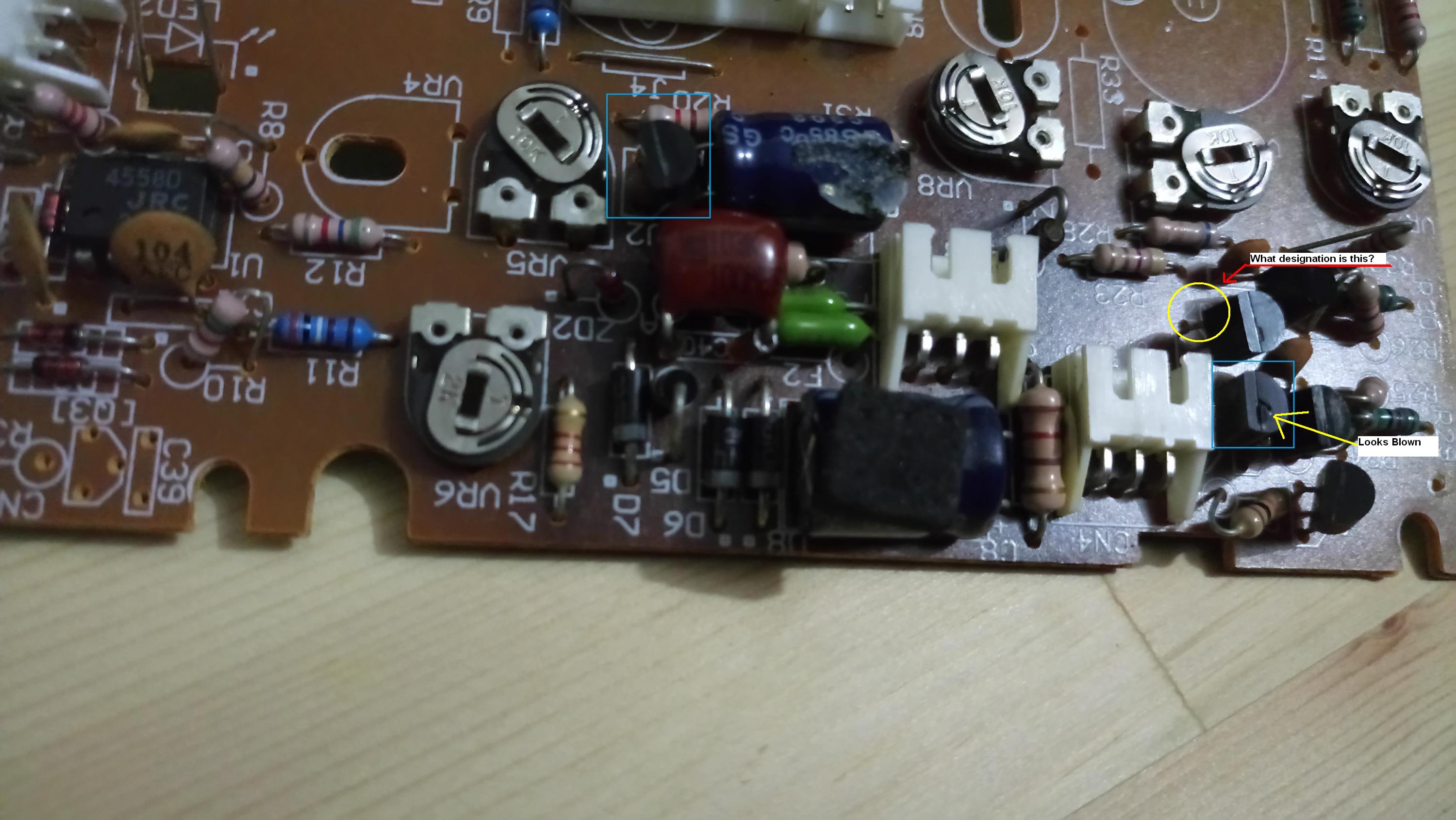

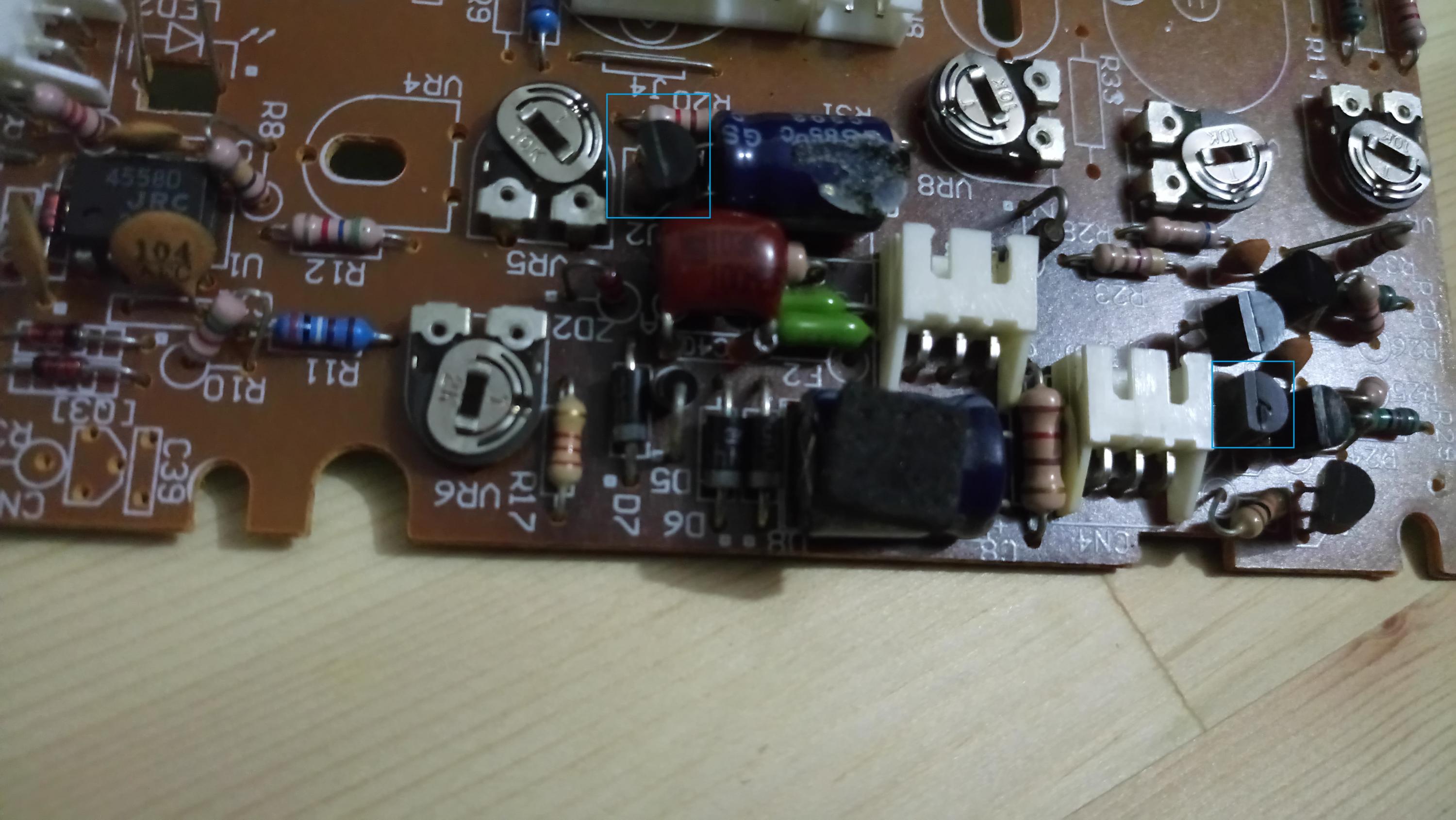

        looks like there is a bad transistor next where VR8 is written on the board?
        • R_J
          • Jun 2012
          • 9535
          Re: Manson NP-9613
          The transistor next to CN4 also looks bad, compare that transistor to Q7 and you can see Q7 has the spot along the molding line which is normal but the transistor next to it looks like it is damaged at that point

            Re: Manson NP-9613
            VR8, which transistor ?
            Do you mean U2 ? that's TL431

              Re: Manson NP-9613
              I can spot CN4, but which one is Q7 ?
              I saw it, it's blown isn't ? after zoom ...

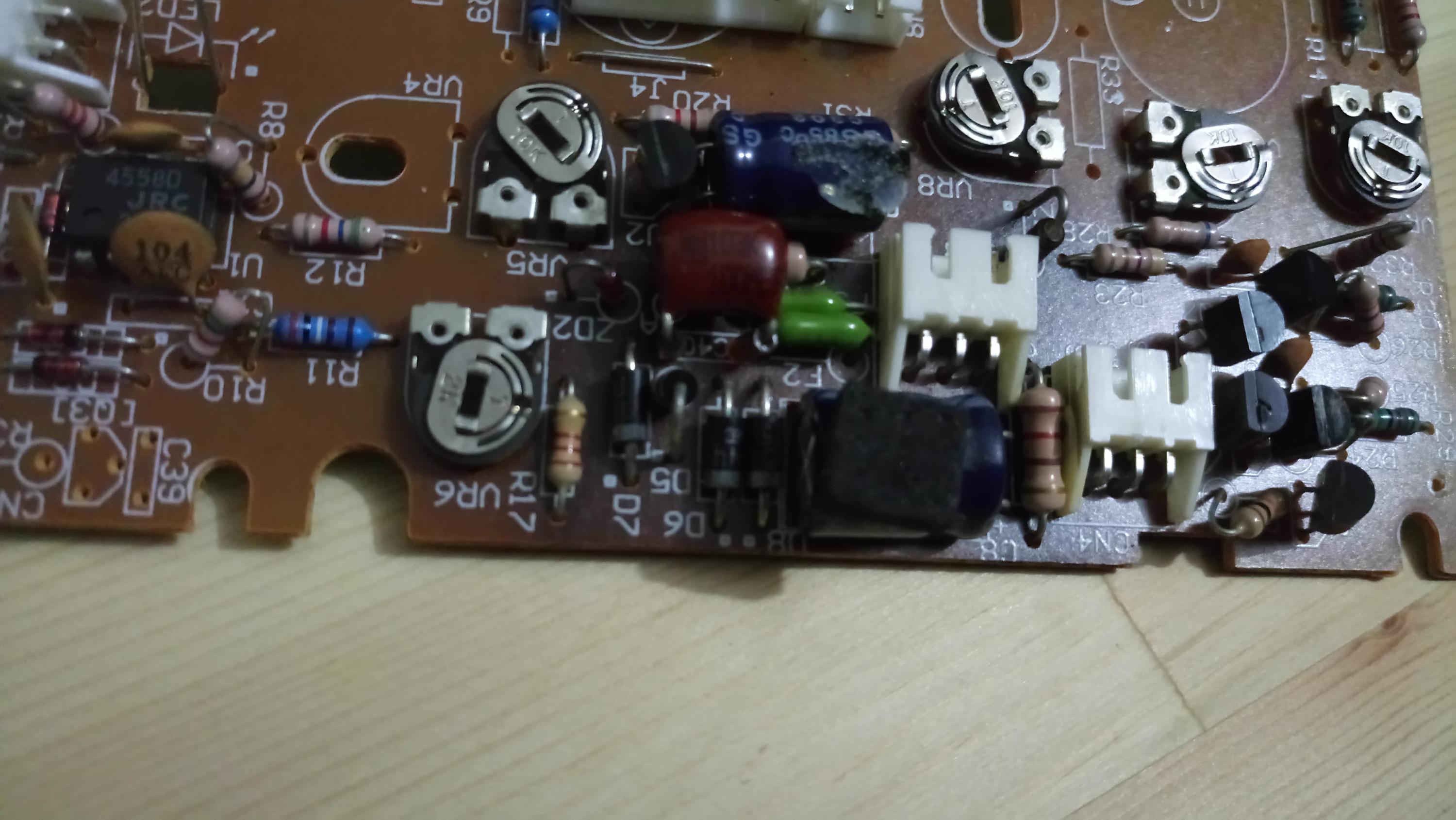

              • bianchi77
                • Jun 2016
                • 1121
                Re: Manson NP-9613
                Have a look on photo please, are these, do you guys mean ?
                I'll check, and return to you guys...thanks

                • CapLeaker
                  Leaking Member
                  • Dec 2014
                  • 8146
                  Re: Manson NP-9613
                  Right under that cap. You are on the left of it.

                    Re: Manson NP-9613
                    I can't get it, the one on the blue box I'd made ?

                      Re: Manson NP-9613
                      I've replaced both 2N3904 and TL431, no luck, yet,

                          Is that not Q7 marked on the board? so the transistor next to CN4 beside Q7
                          • bianchi77
                            • Jun 2016
                            • 1121
                            Re: Manson NP-9613
                            I have replaced both on the blue box, no luck yet ?

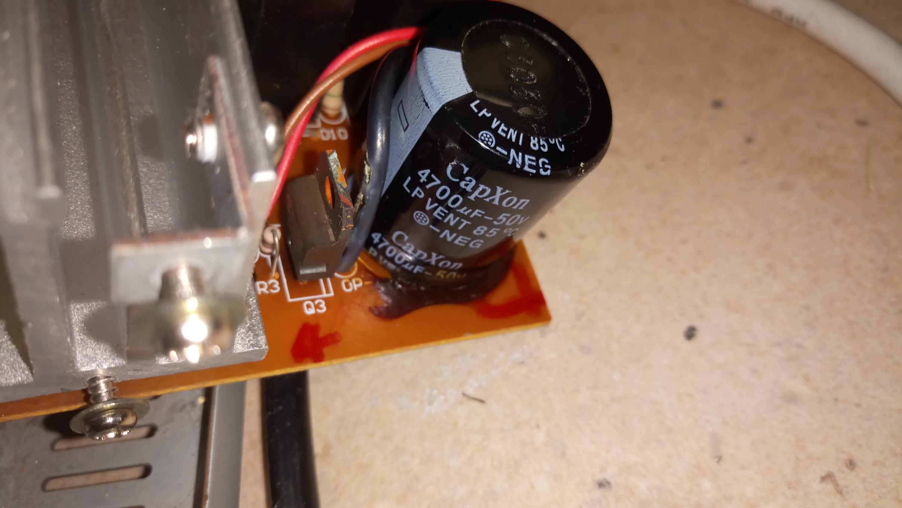

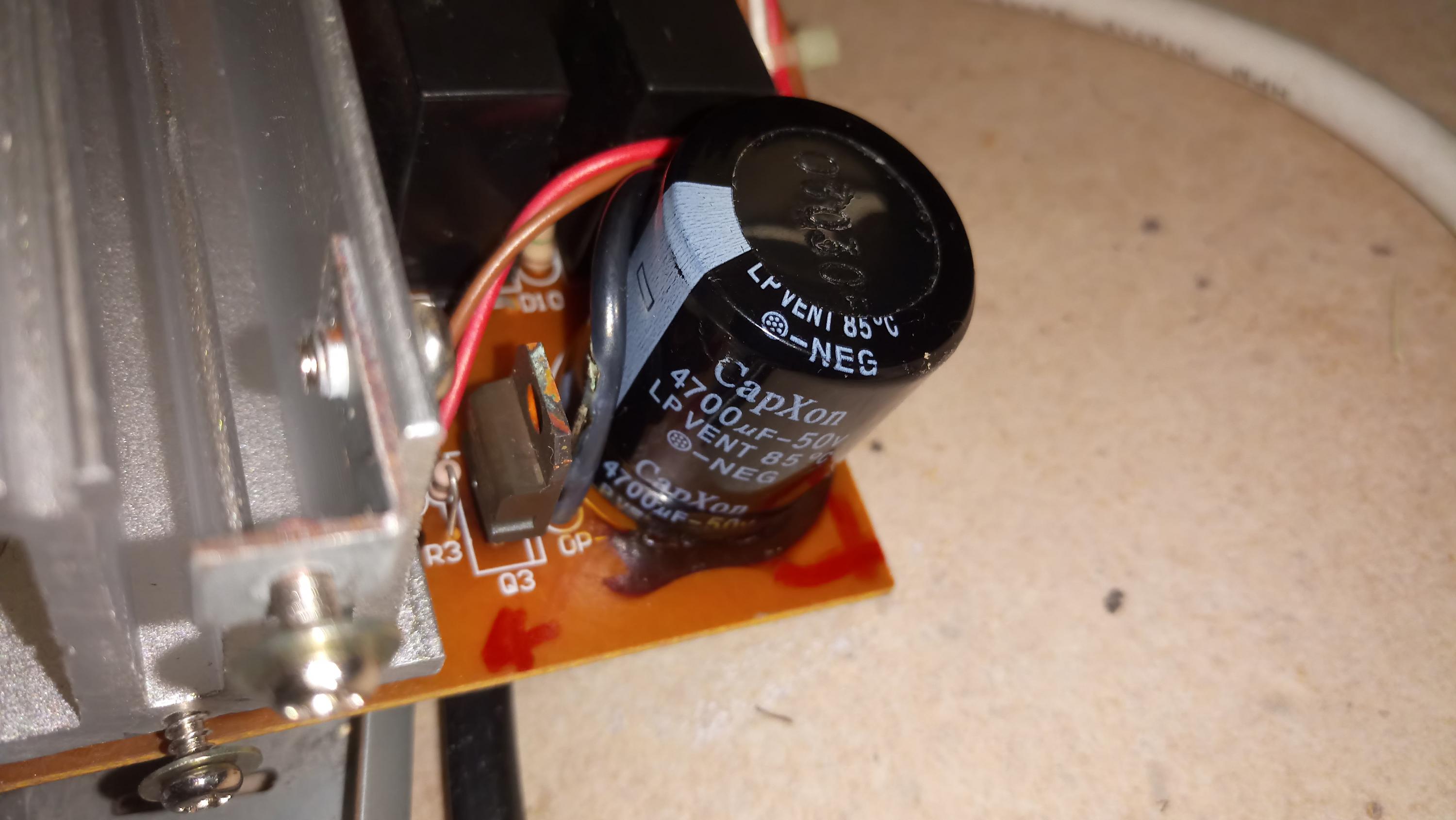

                              Could it be this one is the cause ? When I tested ESR=1.5 Ohm Caps = 5400uF, suppose to be 4700uF

                                  I highly doubt that a 4700uf cap measures 5400uF at 1.5 Ohm ESR. Here is something off with your measuring equipment. IF that 4700uF cap really has 1.5 Ohm ESR, then it would be no good and it would have less capacitance, not more. A good large uF value cap should have something like 0.015uF ESR. An opamp could be at fault too, but right now I think a schematic would be nice.
                                  I also think, that you are focused on the relay turning the power off and the relay is not supposed to click. I think that is wrong and the relay is supposed to click, but the PSU is not delivering power for higher voltages. You can go to any of these CV CC PSU's and they will click not only once if you go from Zero Volts to 30V.
                                  Could it be the relay? Yes, we know it clicks, so it does get voltage and the coil is good. So how could it be still bad then? If the contacts inside the relay are burnt off. Take the relay out and test all the contacts on the relay powered up and no power, cording to the spec sheet.

                                      Was the transistor and ic shorted? If they were, check the components that connect to them, if they are indeed bad, someting connected to the also is bad
                                      Was the Zener diode you replaced marked on the board ZD2? and connected to the U2 tl431
                                      Was the zener a 5.6v by chance, if it was, is there a resistor marked R19 (750Ω) connected between ZD2 anode and C9 negative?
