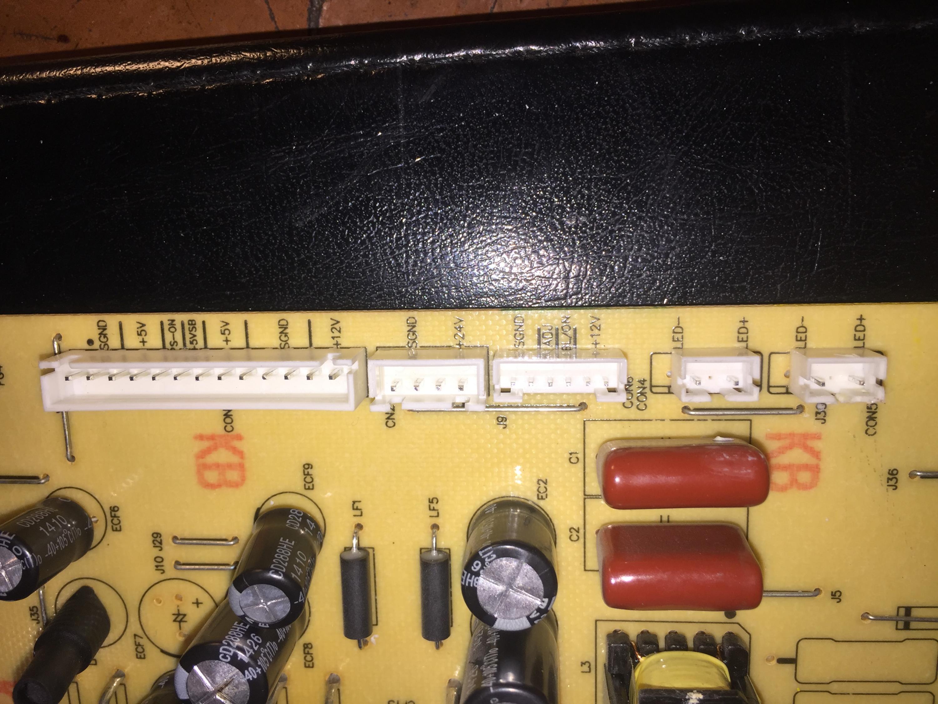

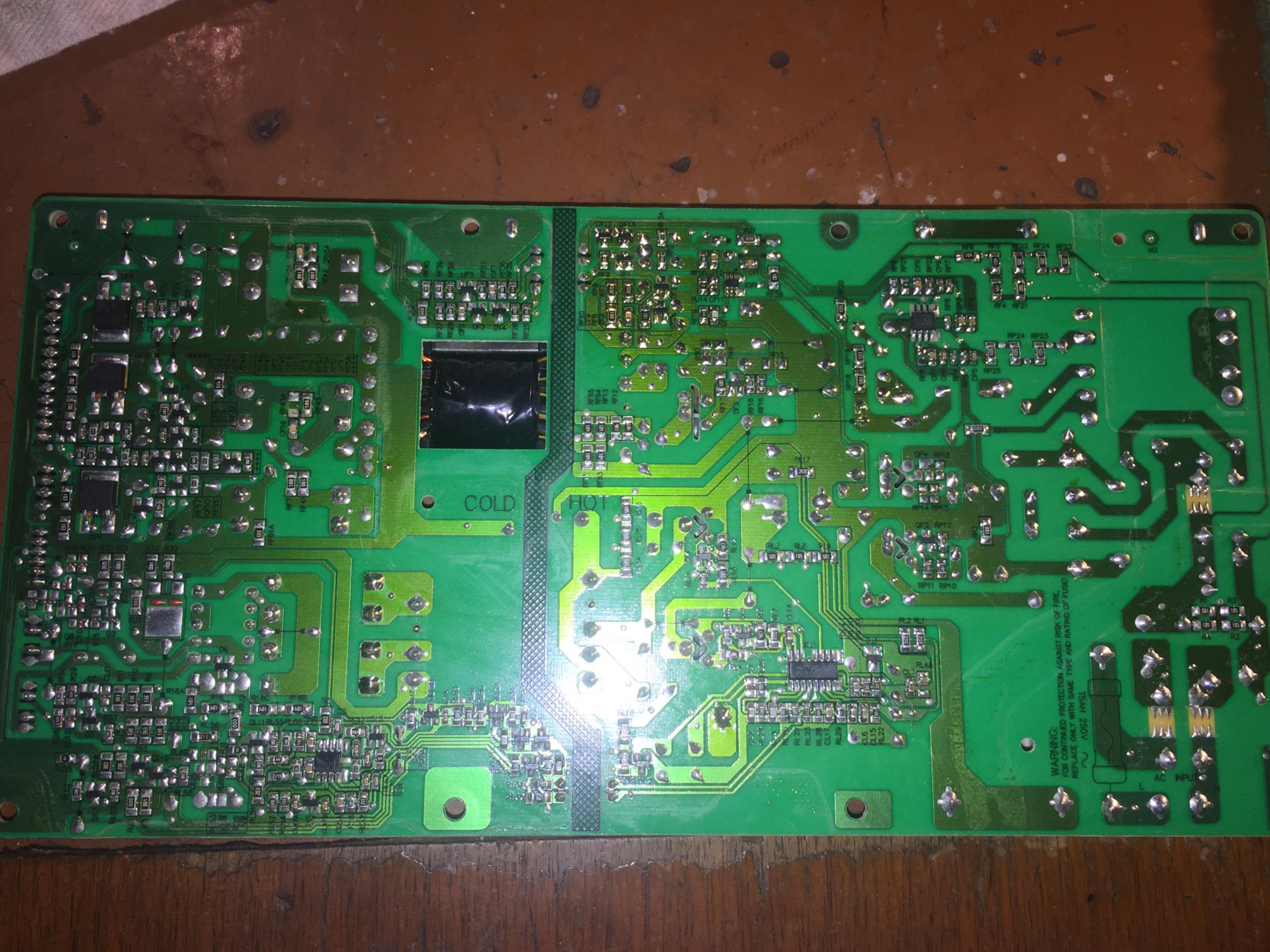

    Howdy All, I have a power board from a Sharp LC-60LE644U TV, the model # is MHC-TF60SP1A...when testing the board output voltage all is well until I reach the LED outputs, on which I am getting nothing with both with the LED's unplugged and plugged in...can anyone tell me what parts on the power board need to be replaced in order to restore power to those LED outputs? Any and all info will be greatly appreciated!
    Re: Power Board MHC180-TF60SP1A from Sharp lc-60le644u TV

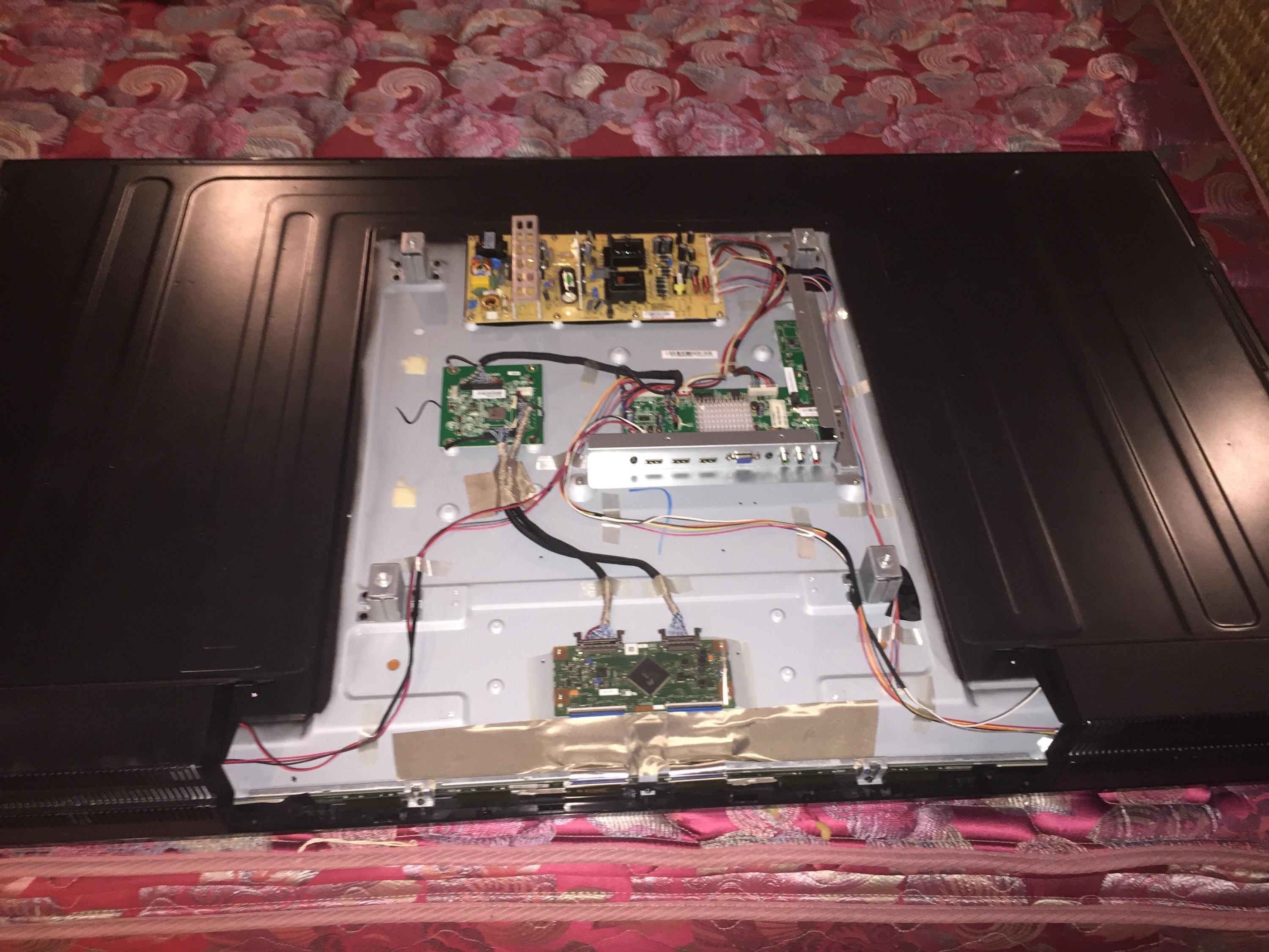

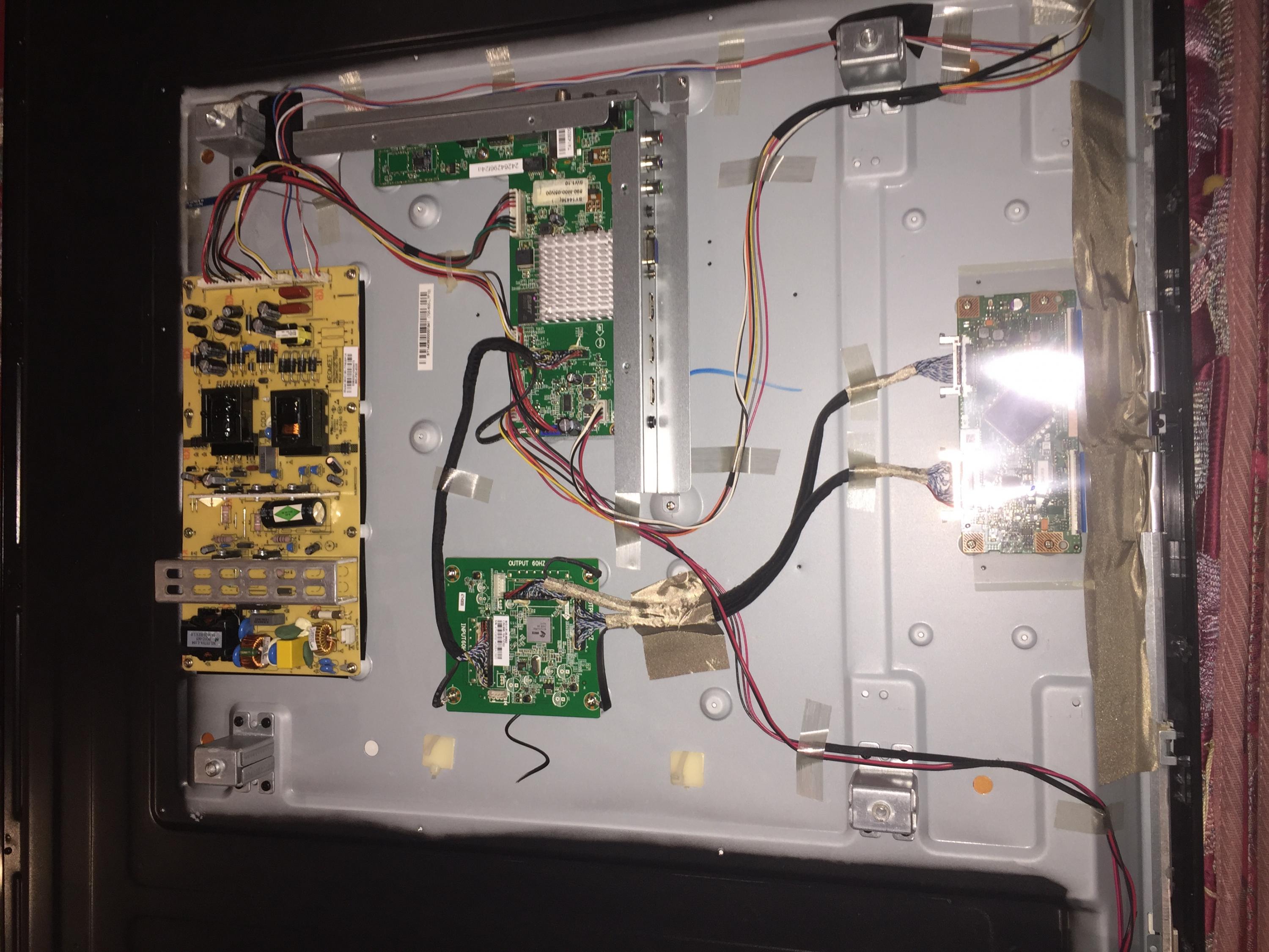

    Please upload good clear pictures of the board and also the pictures of the whole backside of the TV showing all the boards.

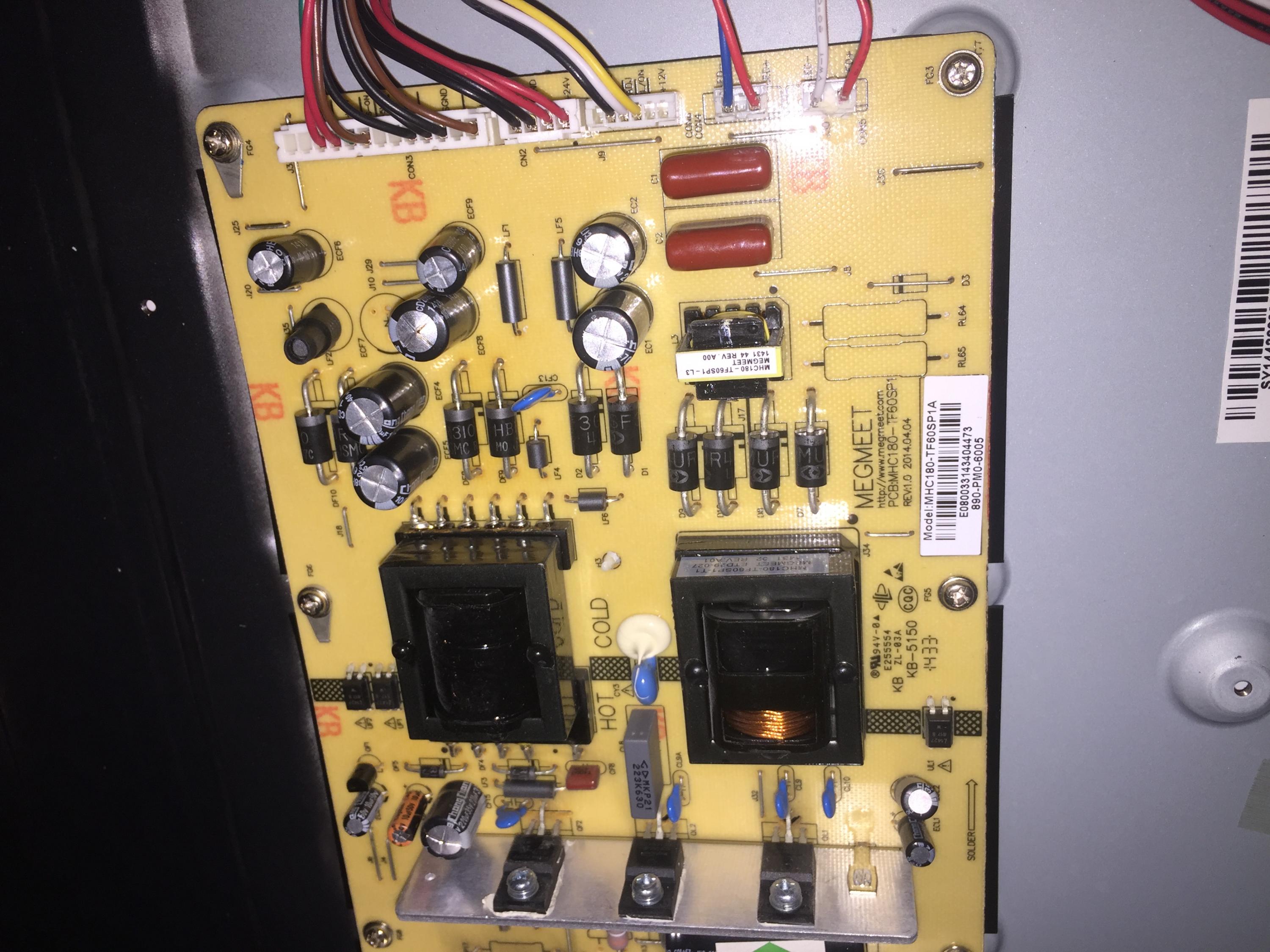

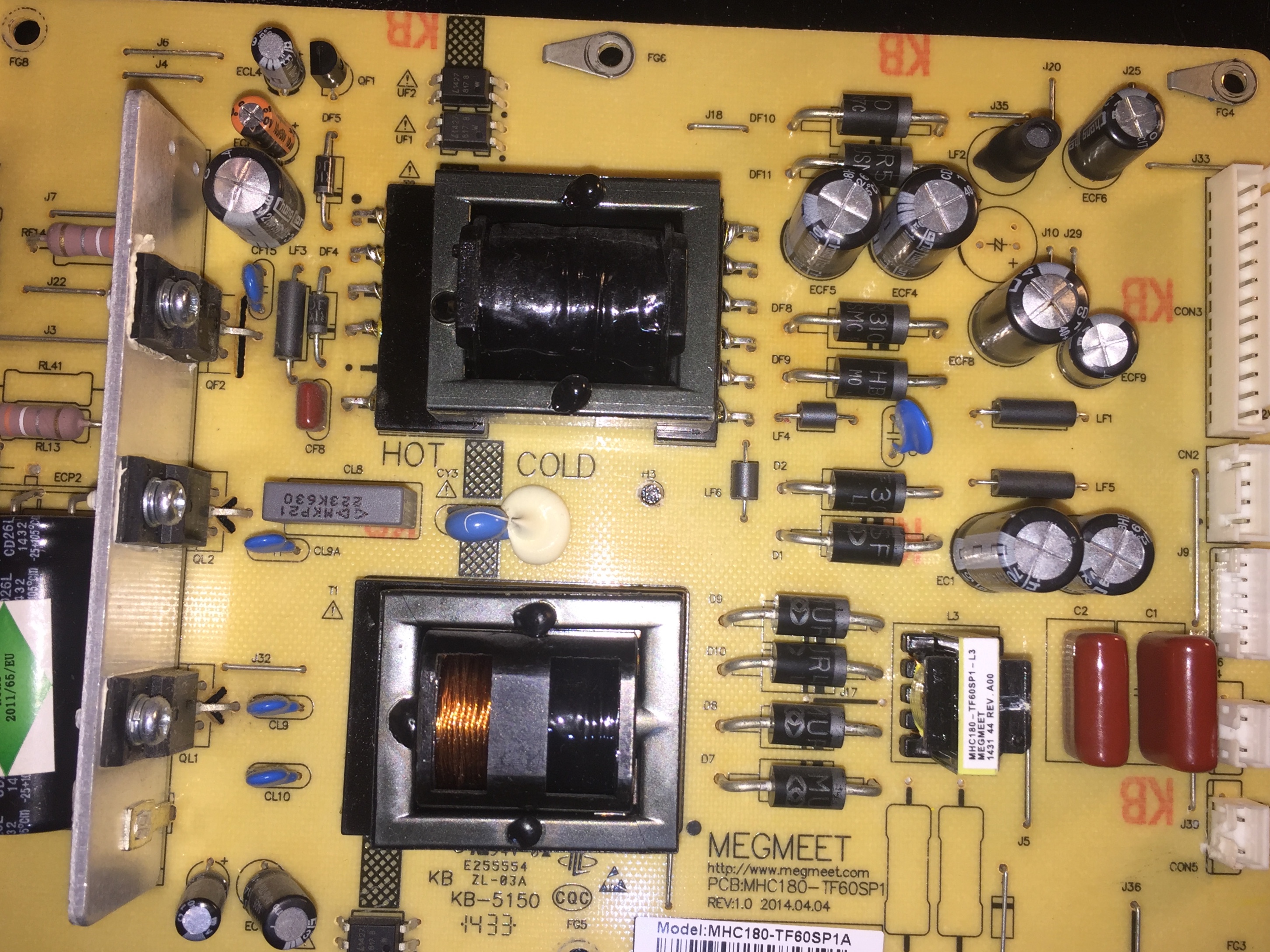

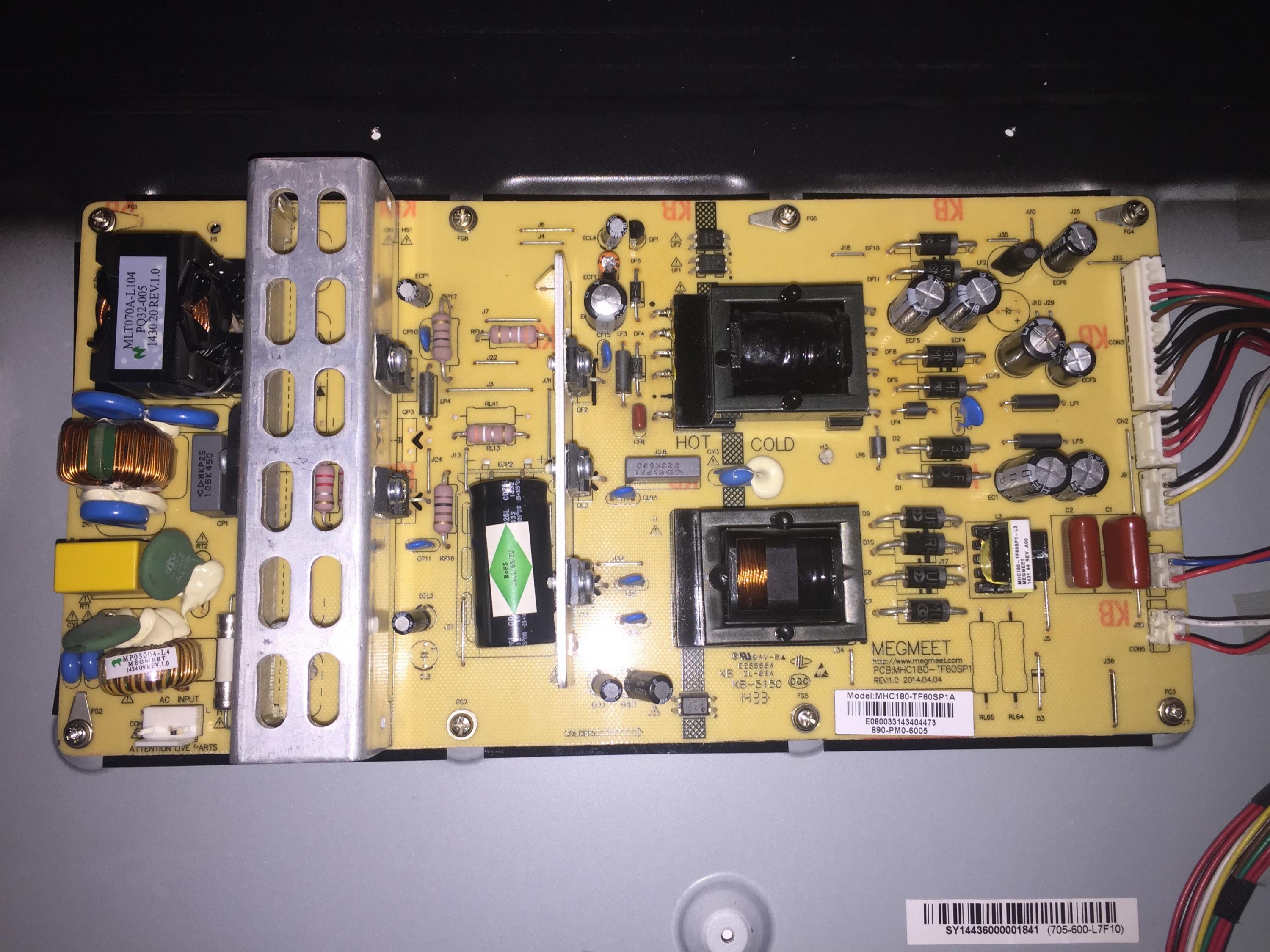

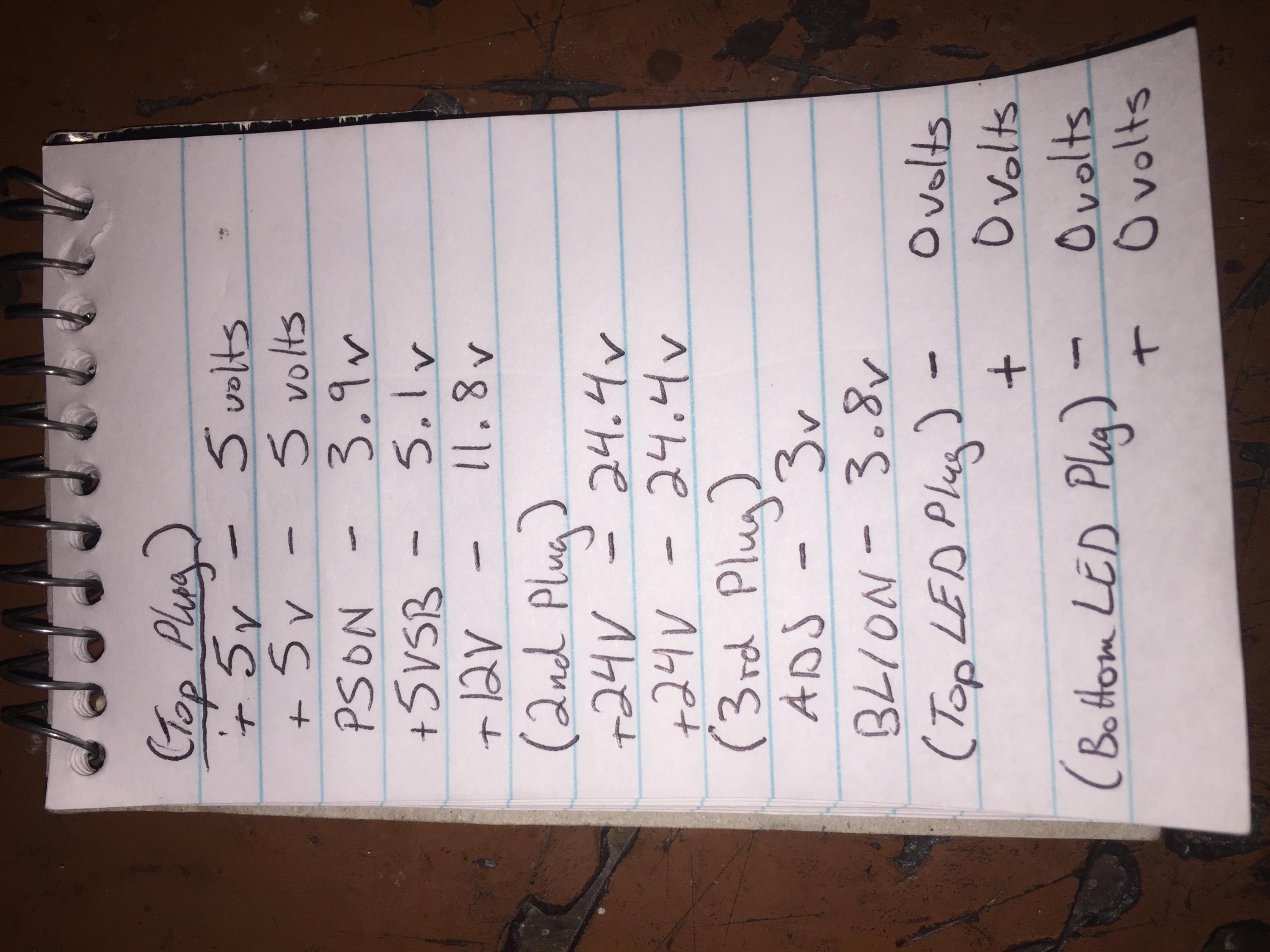

      The statement that I made that read, "when testing the board output voltage all is well", was referring the the output voltages the power board was producing on each plug. Here are pics of the backside of the TV and closeups of the power board that is not producing any voltage on the LED output plugs... Included in the pics is a list of the output voltages that were present. I just skipped over and didn't record and info on the ground portion of the plugs, or the portion of the plugs that did not have a wire present. Please let me know if any other info is needed...much much appreciated!
        1) You do have all correct Control Voltages (PS-ON, ADJ (Dim), and BL-ON).
        2) Are the LED Voltages tested at the connectors done Black meter probe on the chassis?
        3) You do have bad cap ECF8 with domed top: https://www.badcaps.net/forum/attach...1&d=1569893900
        4) Check the DC Voltage between each Cathode of D7, 8, 9, 10 with ref. to chassis GND.

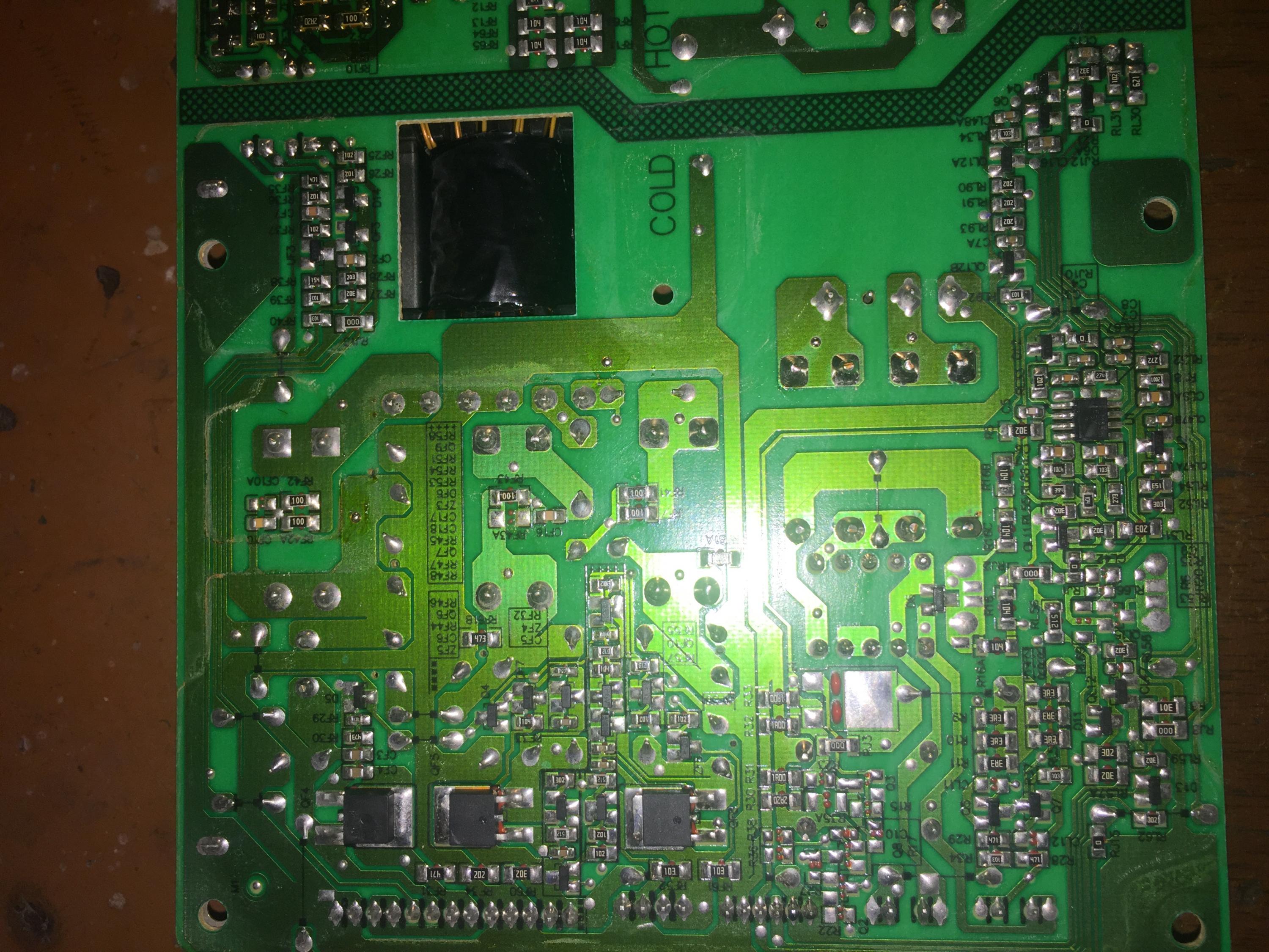

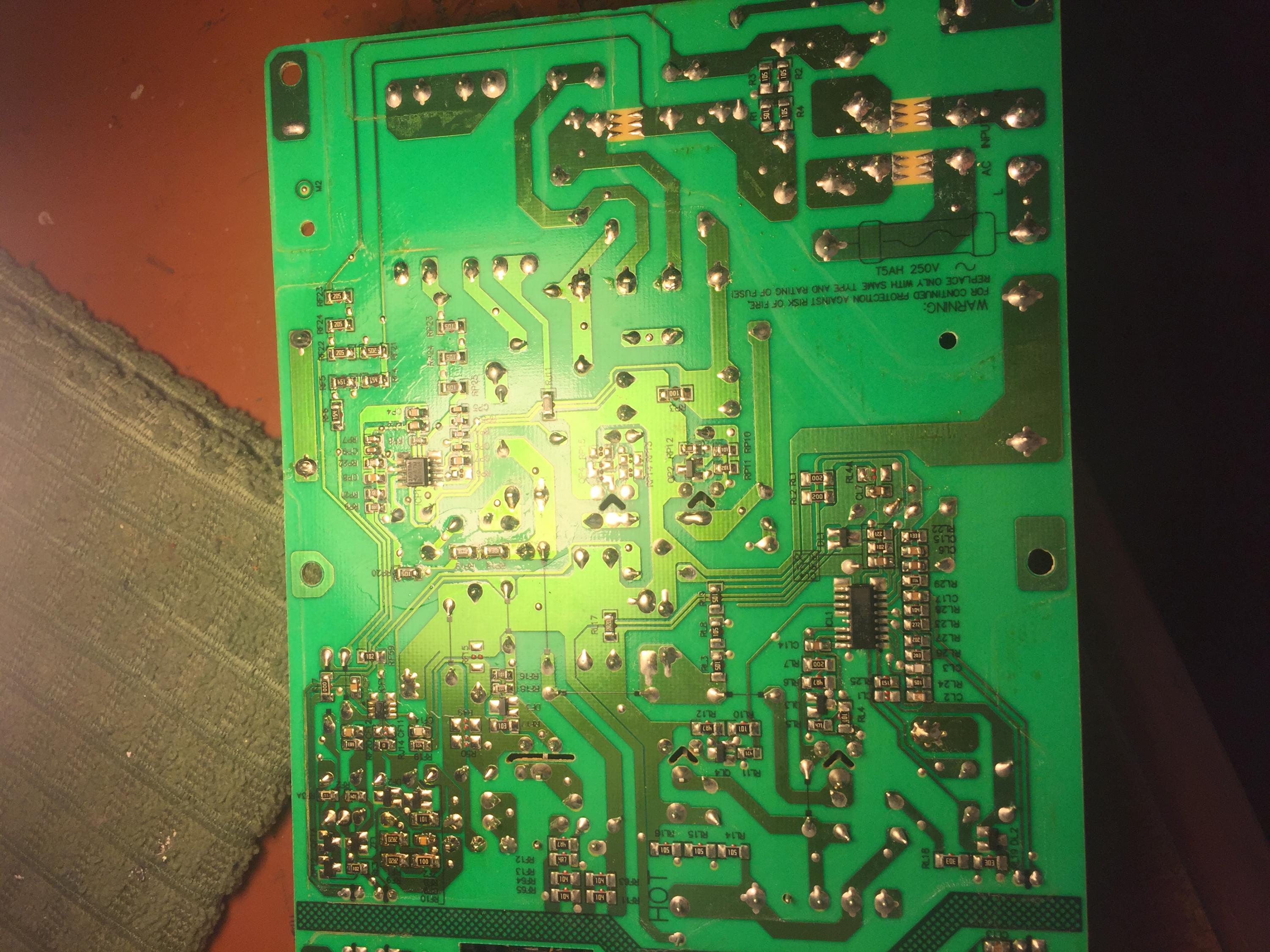

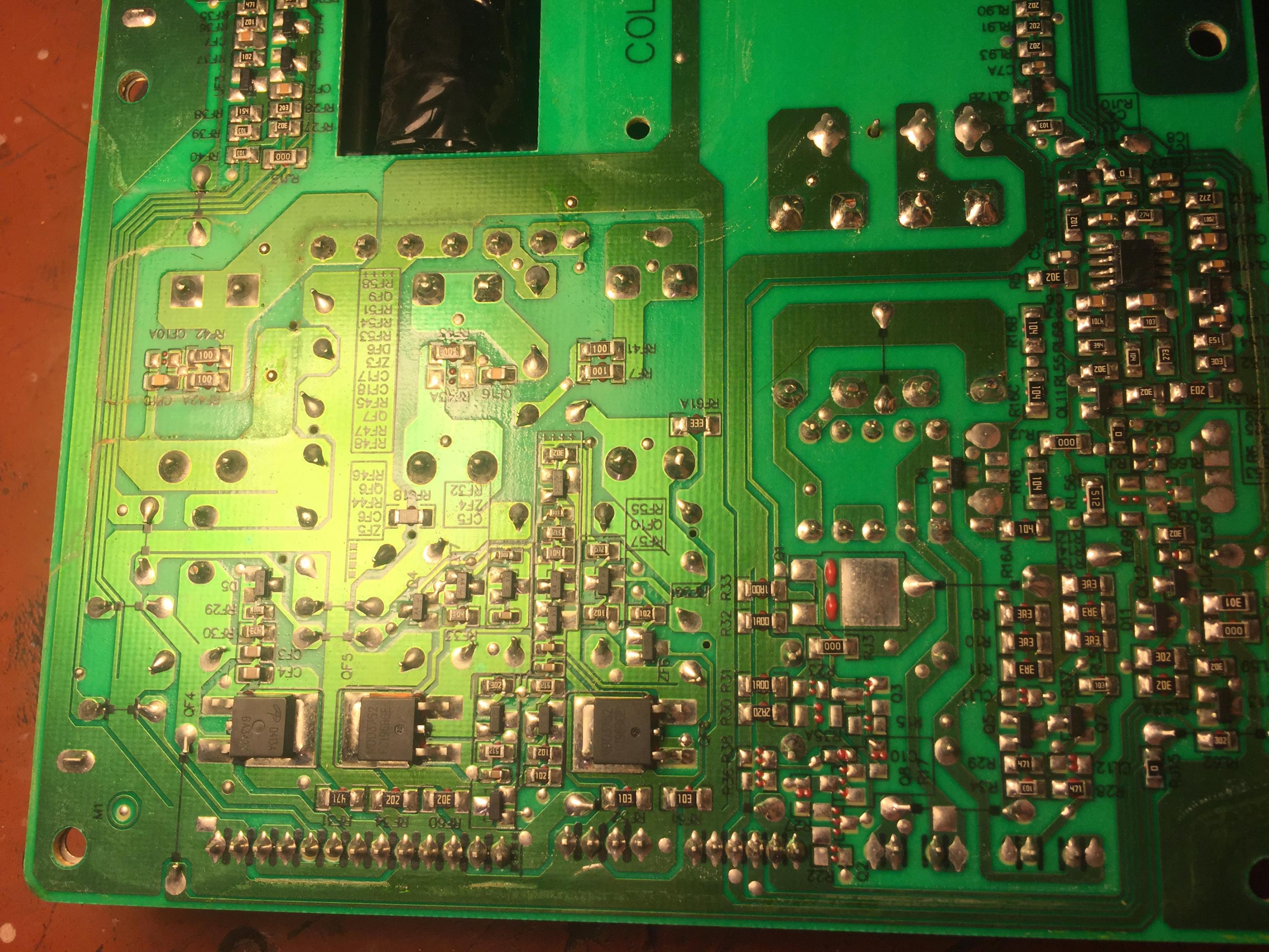

        5) I need good clear straight shots of the whole bottom side of the board after you remove the black shield. https://www.shopjimmy.com/sharp-nqp8...pply-unit.htm#

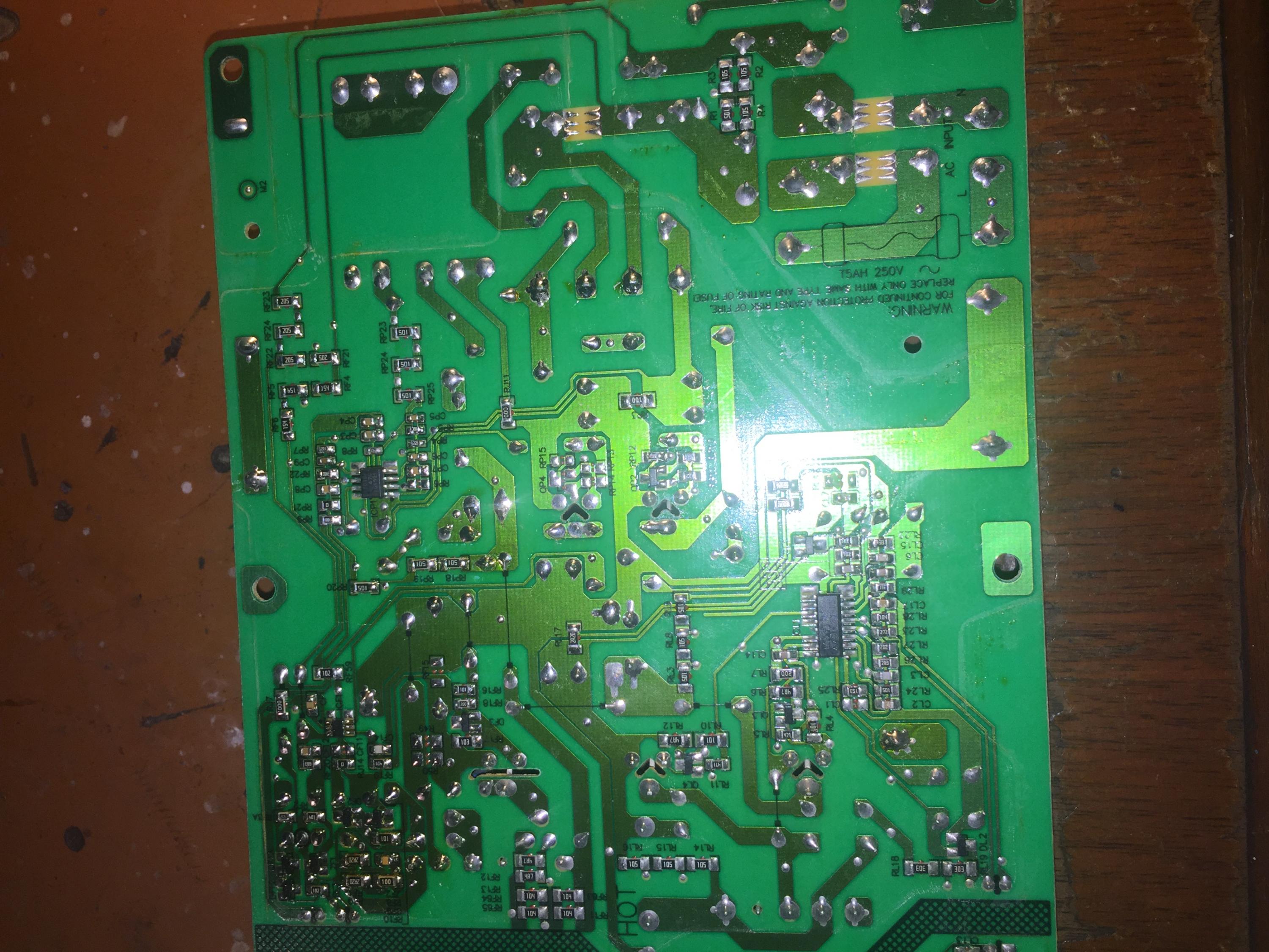

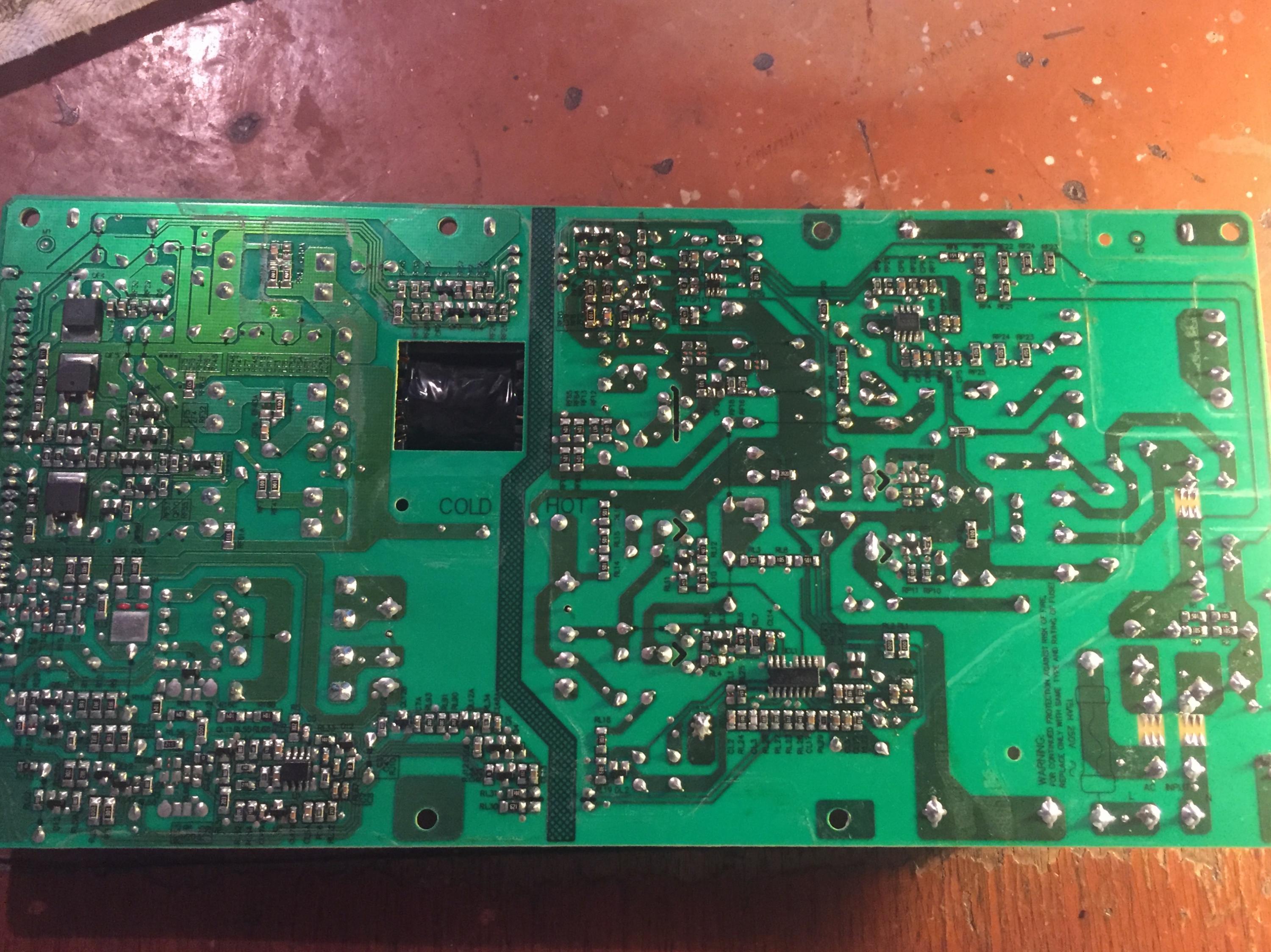

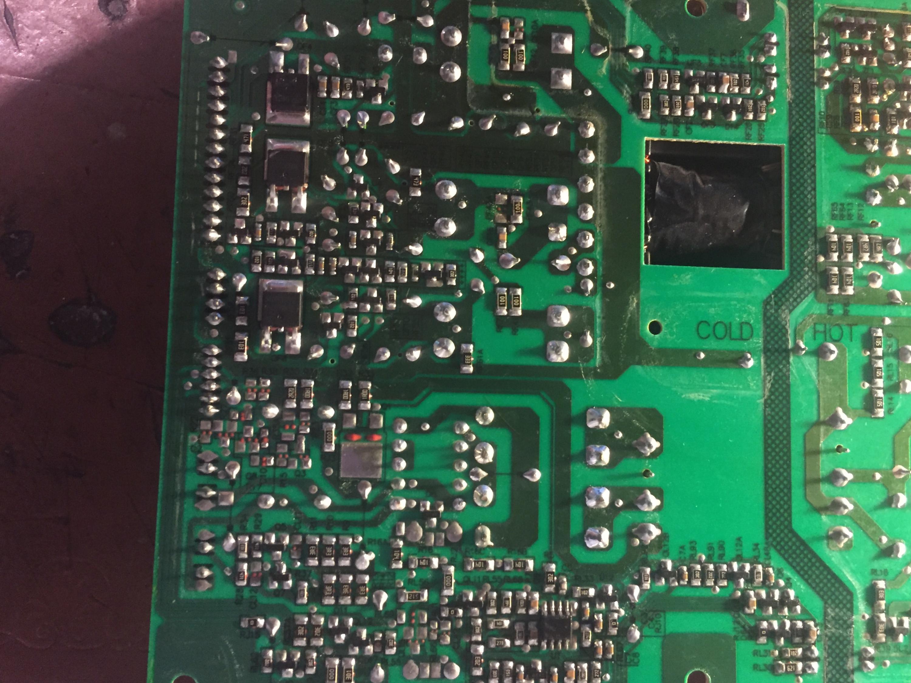

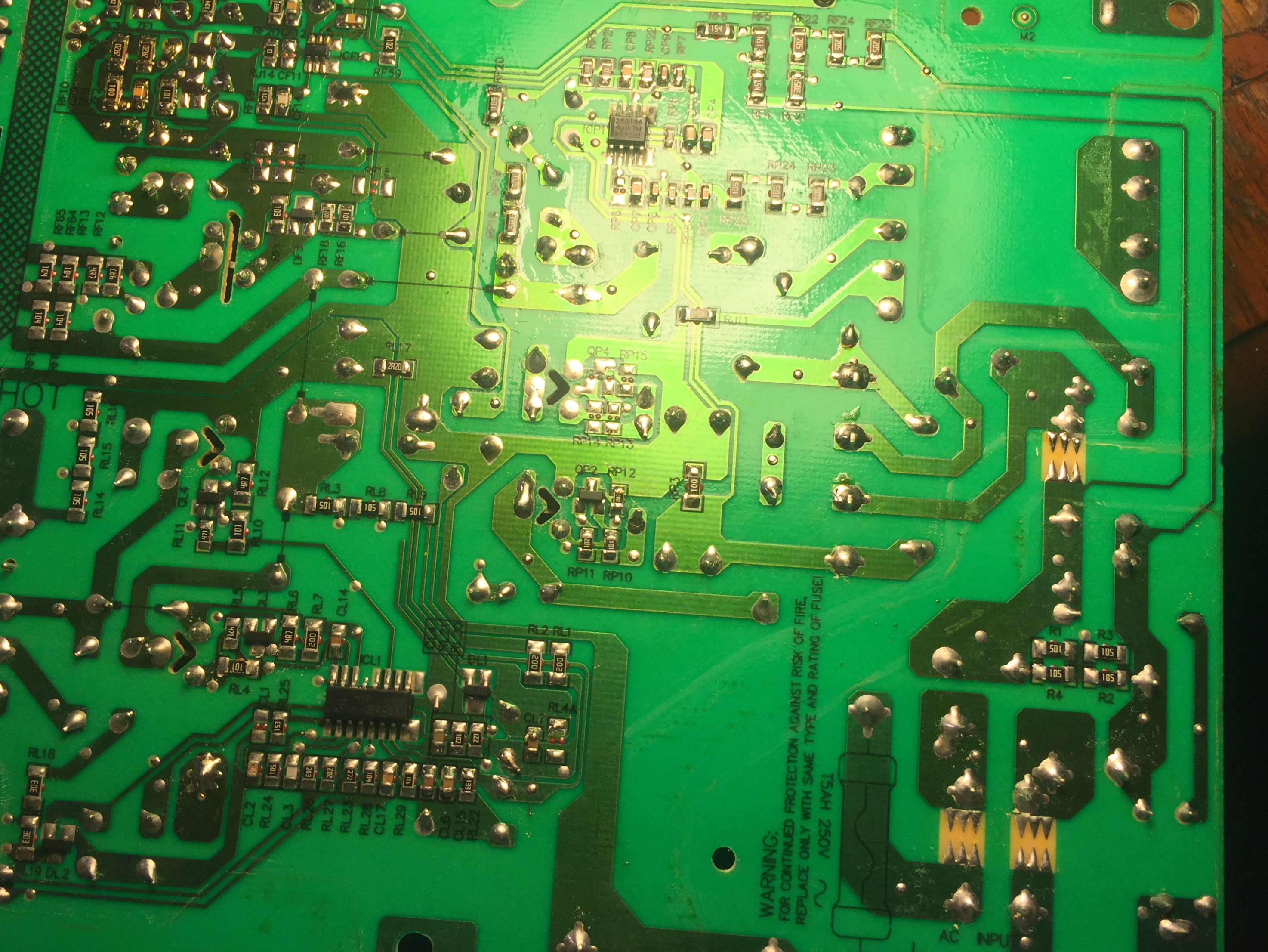

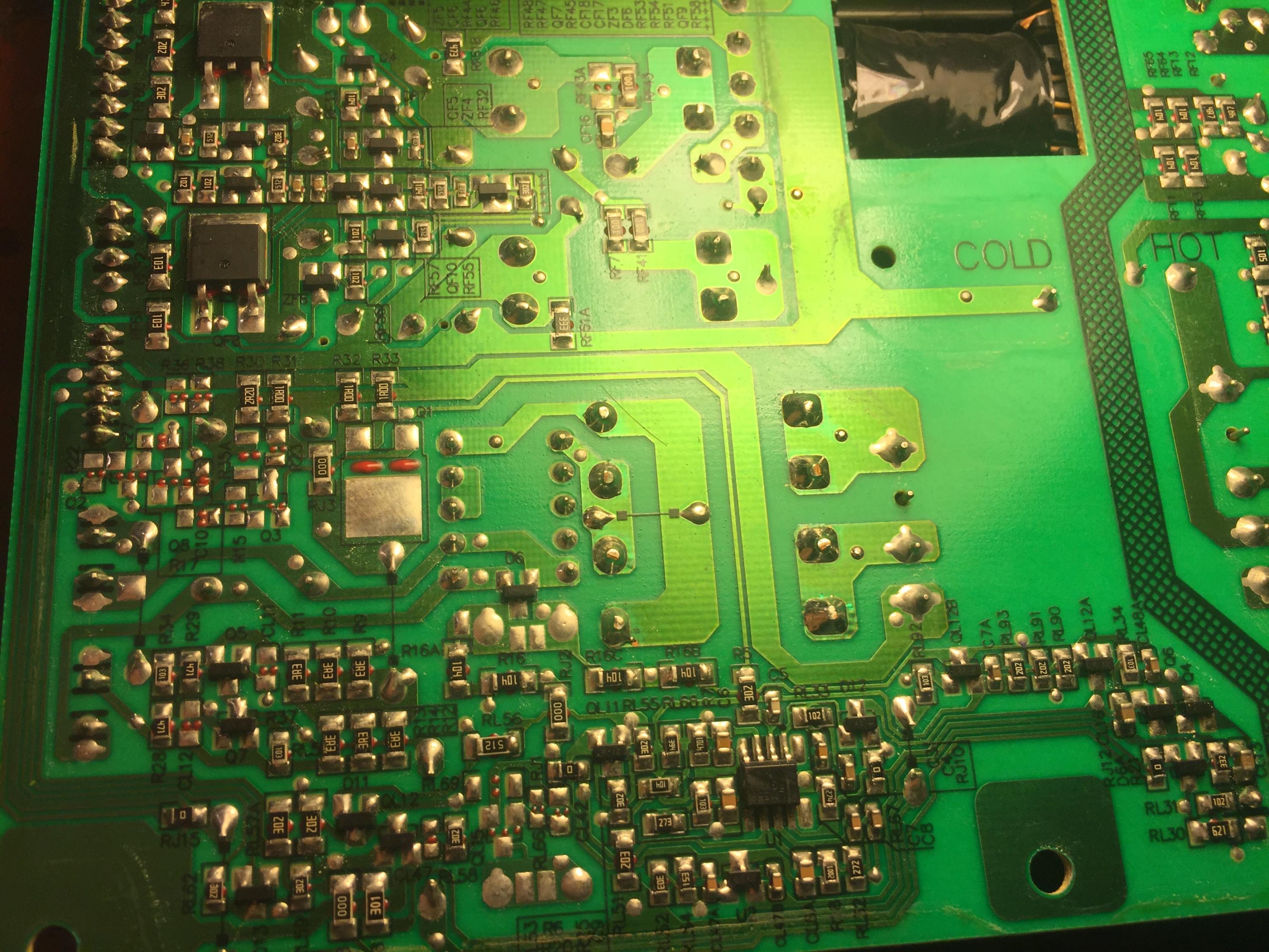

          5.Attached are several pics of the underside of the board, some are with a flash, some without, some with a lamp overhead, some without. Let me know if you need closer shots, or if I need to redo anything.
            CF15 on the primary side looks swollen. At 5 years old, if those output caps are not good brands I'd consider replacing the ones that are not obviously bad.
                          Knowing the manufacturer and series of the original caps could be helpful in determining what the closest replacements from a good vendor/series would be.
                          From his photos I could make out the bulged caps being Chong, CD288HE series.
