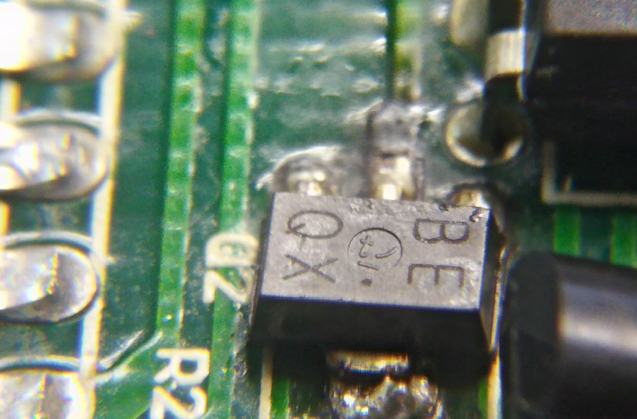

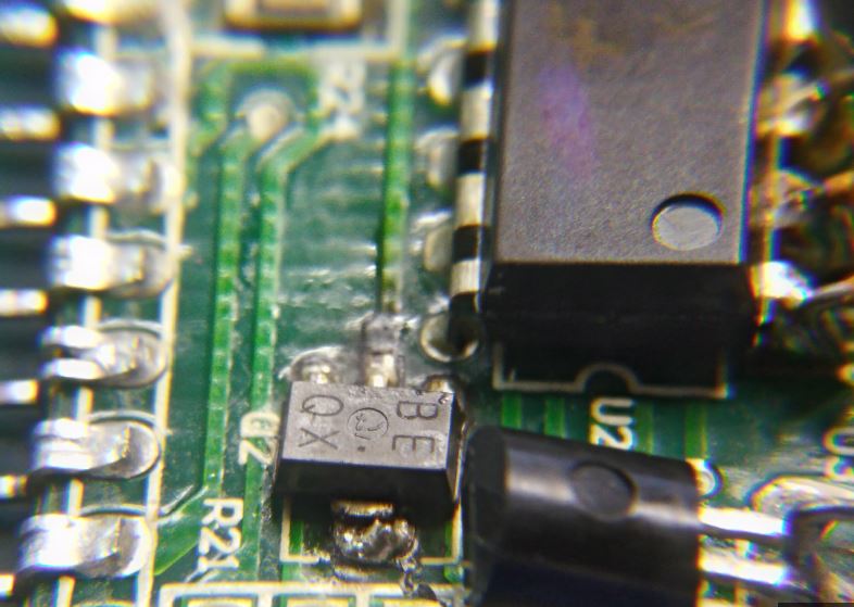

    Hi All,
    Please help identify this component. It has a body marking of BE and QX. In the middle of the component, there is a writing that looks like LOGO. Please see picture below.
    • 31283
    Re: Please help identify component, repairing NSX PSU, PSA-6700p
    maybe BCX55

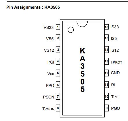

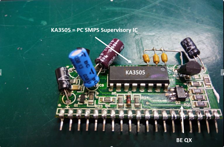

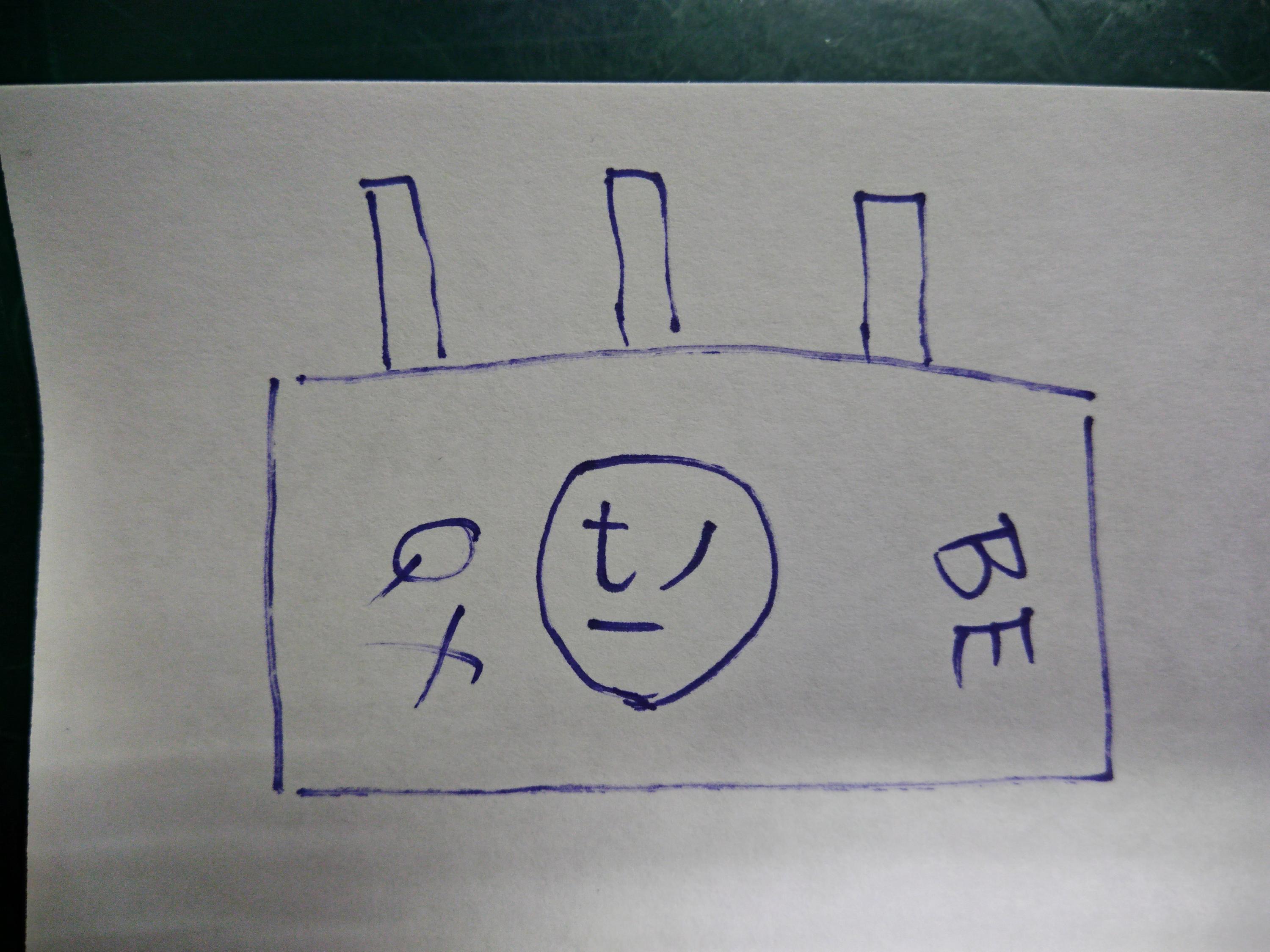

      Hello again,
      Here is the drawing, with the suspected Japanese marking. Accroding to the semicon tester that I used, it is a PNP silicon BJT. The packaging is SOT-89
      It is installed with KA3505 -PC SMPS Supervisory IC.
