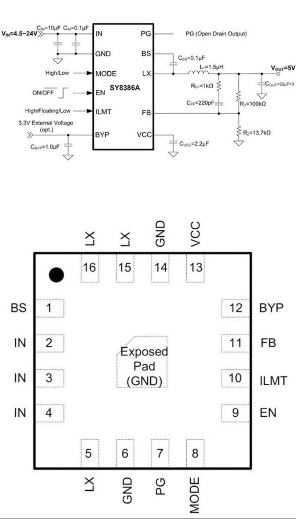

    da0p5mmb6c0 identify component - chip marking QrDBC
    please help me identify this component from hp laptop mobo. chip marking is QrDBC. Thank you
  • mon2
    • Dec 2019
    • 14250
    Just found this amazing item on AliExpress. Check it out! US $12.00 20% Off | 5pieces SY8386CRHC SY8386C (QrAZB QrATD Qr...) QFN-20
    https://a.aliexpress.com/_mMXiXwy
    but the listing shows as qfn20 while your pic is qfn16. Do ask the vendor on the # of pins.

      Just found this amazing item on AliExpress. Check it out! US $4.47 6% Off | New Original SY8386CRHC SY8386C Print QrFGC QrBFC qr https://a.aliexpress.com/_mNSld5S

        hi mon2, can i have datasheet for it?
        • mon2
          • Dec 2019
          • 14250
          Unable to locate the datasheet.

            Refer to Quanta OP5D schematic.

              mcplslg123, yes i refer to that schematic , but doesnt match, on that schematic is a 20pins ic, which mine was 16pins only, the pu1151

                See if the attached helps. The pinout appears to align with your PCB pads.
