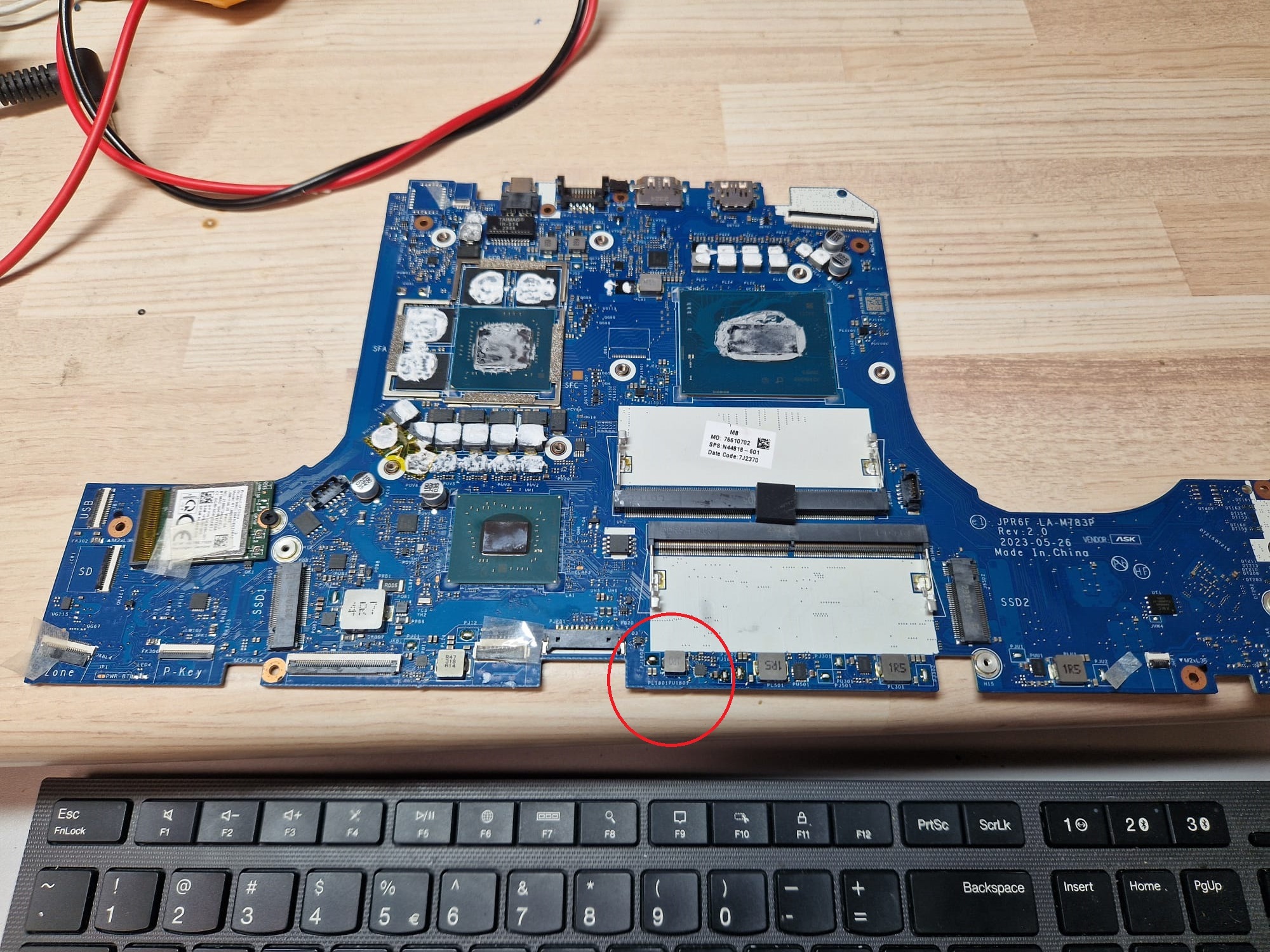

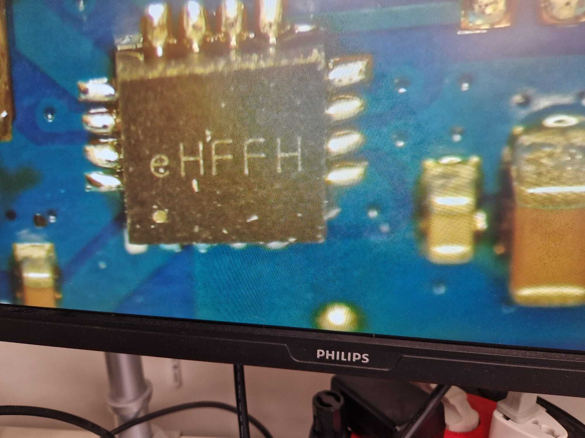

    Dear BadCaps colleagues,
    I'm working on a HP Omen 16-WF0894ND. Won't turn on. Battery is charging and 3 and 5V rails are present.
    However, I located PU1801 that's only outputting 0.37v as soon as the power button is pressed. Weird voltage imo, although there's no short after the coil. Chip aint getting hot either. Since no diagram is available, I can't really determine what this rail is for, but I assume it might be a PCH PWR rail. Please help me to identify:
    Chip marking eHFFH
    Board model: LA-M783P
    Please also see pictures attached.

      It`s a Silergy chip. https://www.badcaps.net/forum/troubl...and-datasheets

        SY8386R
