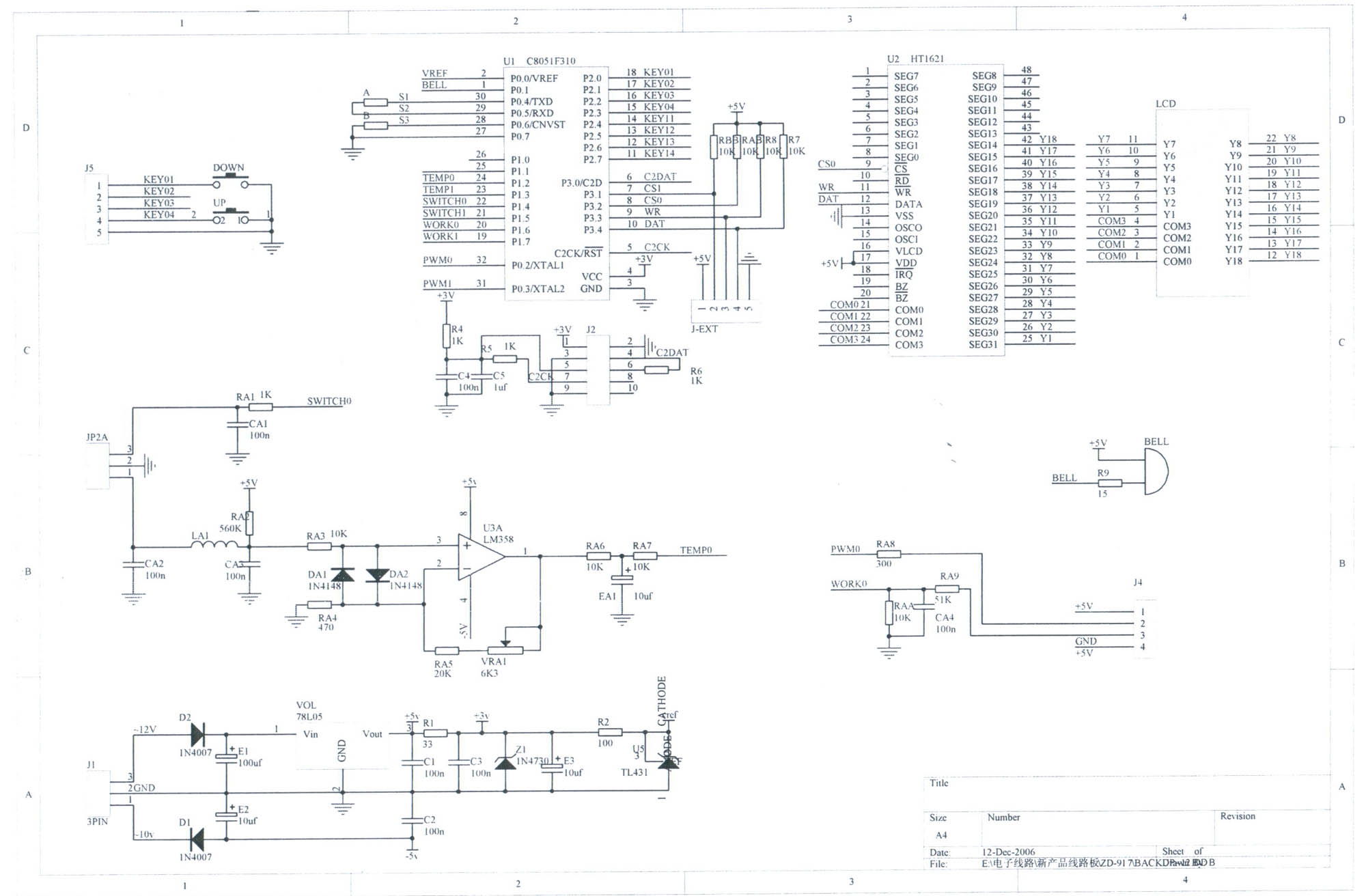

    the main chip contains software,
    they do sell entire boards though.

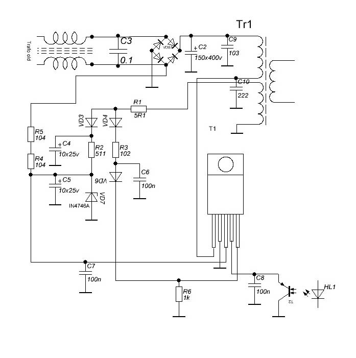

        I did some searching and the ZD-1565 power supply used Fairchild FSCQ1265RT. I am not sure about ZD-1565 (V2).
        It's weird- even the smallest FSCQ0565 is rated 60W output, and the 1265 170W.

          Can't say for sure it's the problem, but I have seen a similar one of those Fairchild integrated switchers fail apparently by itself with power cycling symptoms before, in a network switch PSU...

            did you get the correct schematic diagram of the zd-1565 (v2)?

                The switching power supply regulator ic has probably has gone bad and needs to be replaced it is a little hard to get to power supply board because you have to take the metal cover off the switching power supply board
                If you have not done this type of repair before you will a step by step instructions on how to do this procedure

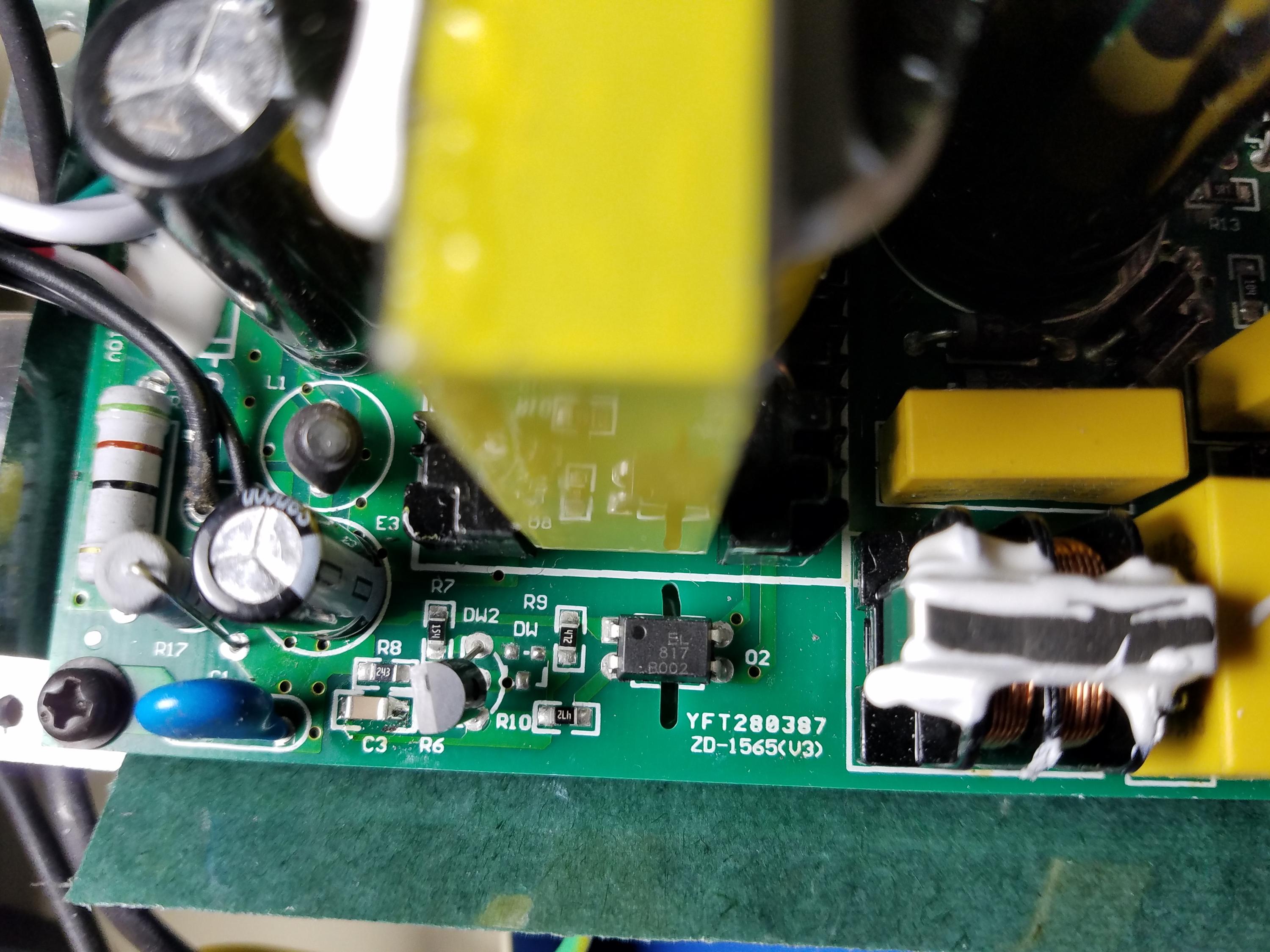

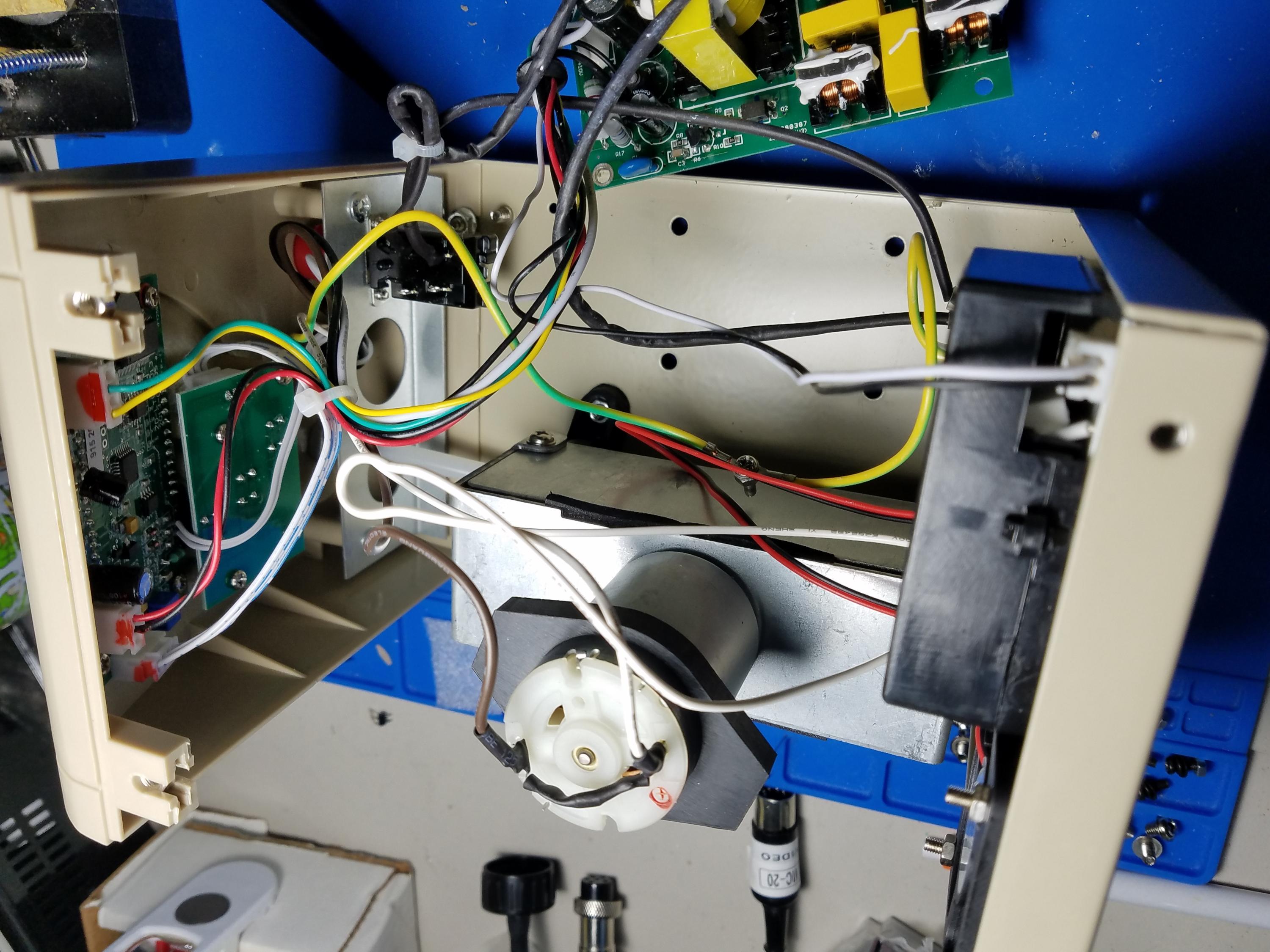

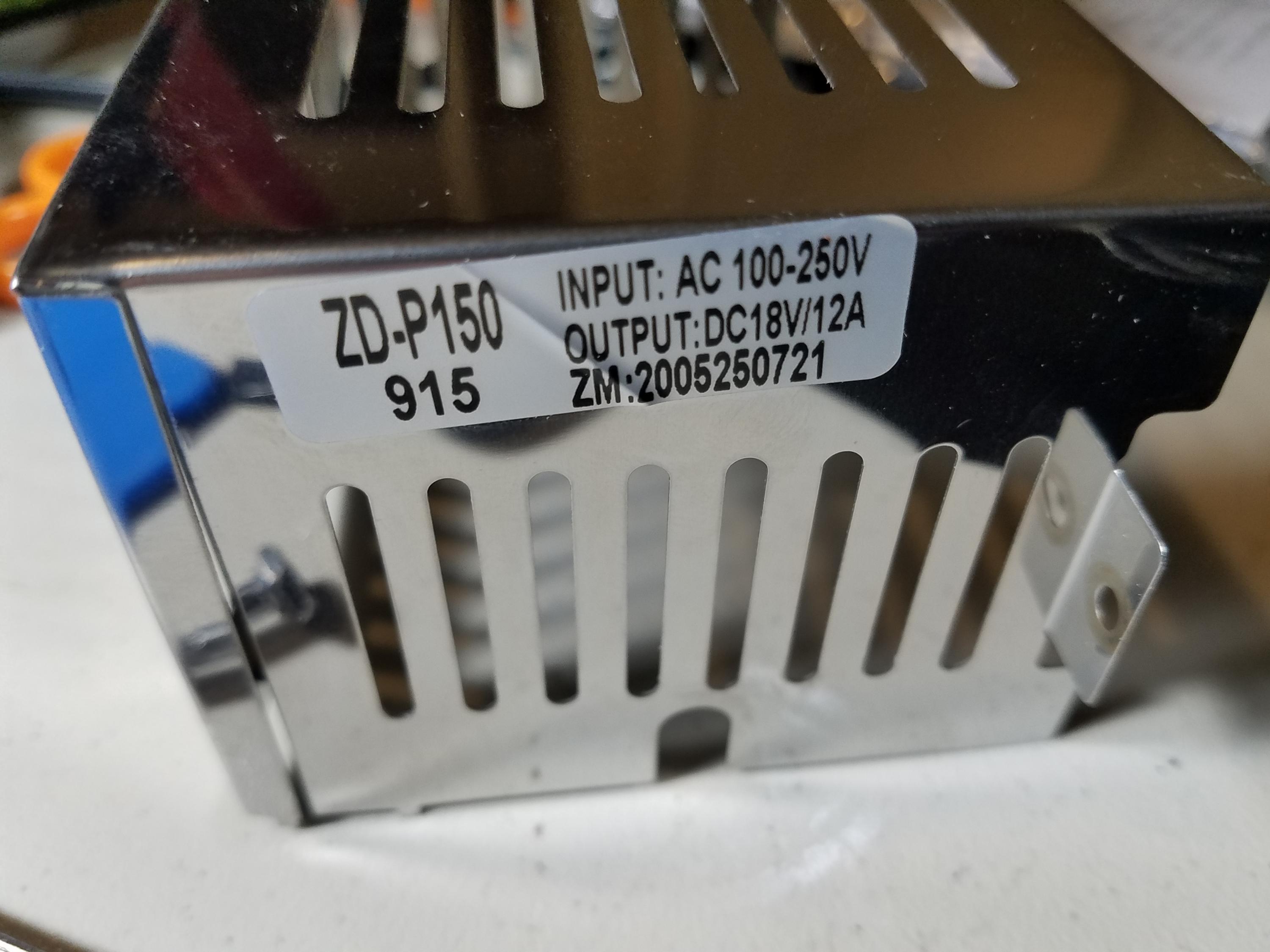

                    Re: 18VDC PSU has dropped to 10v - ZD-915 desoldering station

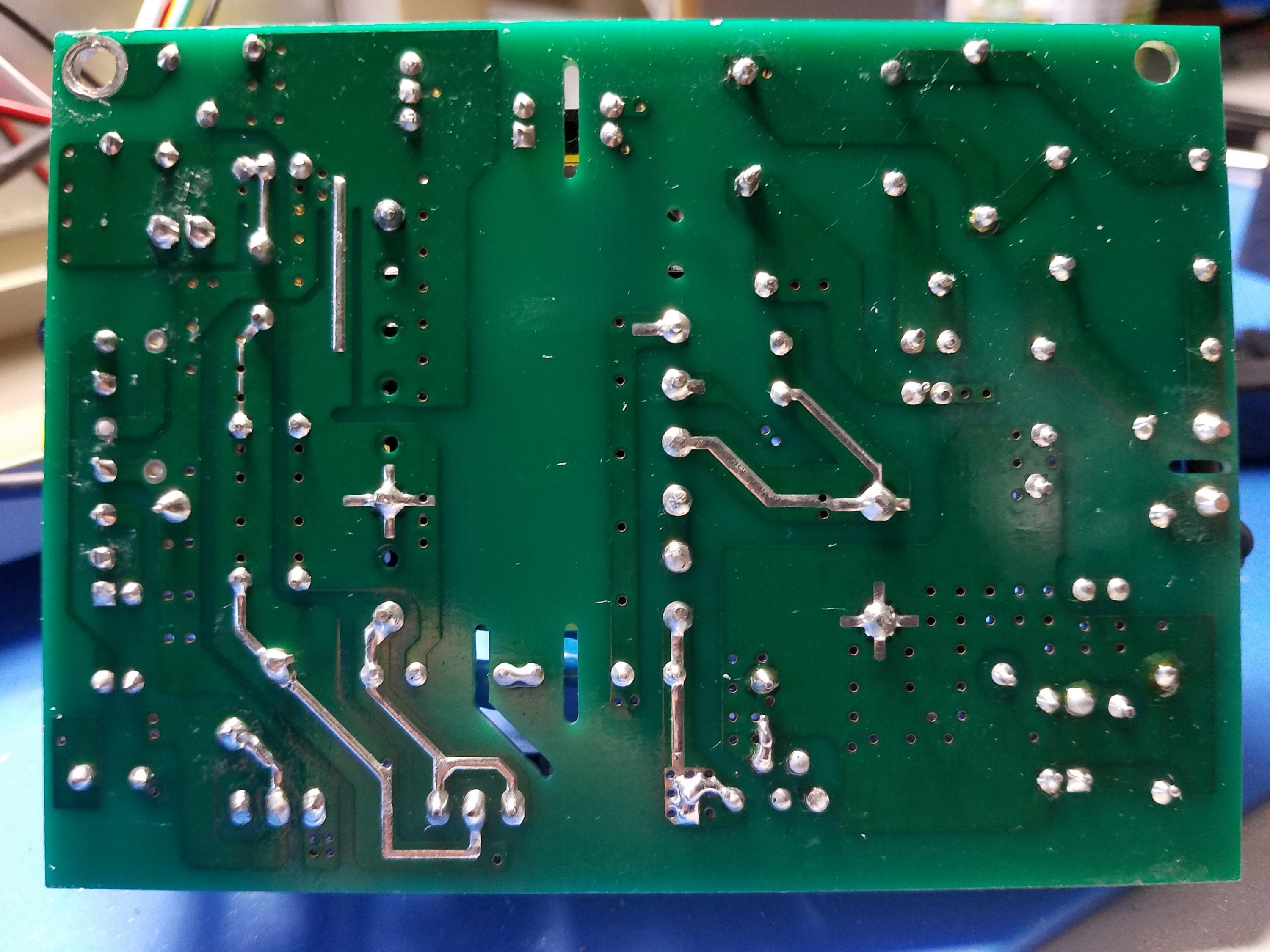

                    Please take and post photos.
                    That it died with a 'pop' implies something in the primary side blew up. If you look carefully you should be able to spot the damage.
                    -David VanHorn

                      #30
                      Or you can pm me about repairing it for you if you can not get the vendor to help you
                      I have repair several of these switching power supply for this tool because I about 7 of them
                      By any chance did you buy this unit from MPJA website if you did that item is out of stock right now and when they are out of stock on this item it takes months for it to in stock again
                      I got it from a vendor on Ebay from Kentucky (clearing house for China AliExpress vendor perhaps...). I dug into a little bit and took it apart yesterday evening but didn't really want to completely dig in until I heard from vendor. But I definitely will try the reflowing solder and other troubleshooting in a day or so and report back. If I have no luck I'll definitely PM :-) I'll post some pictures I took last night but it was more for determining if I could get another power supply etc... - the shots are not too descriptive.

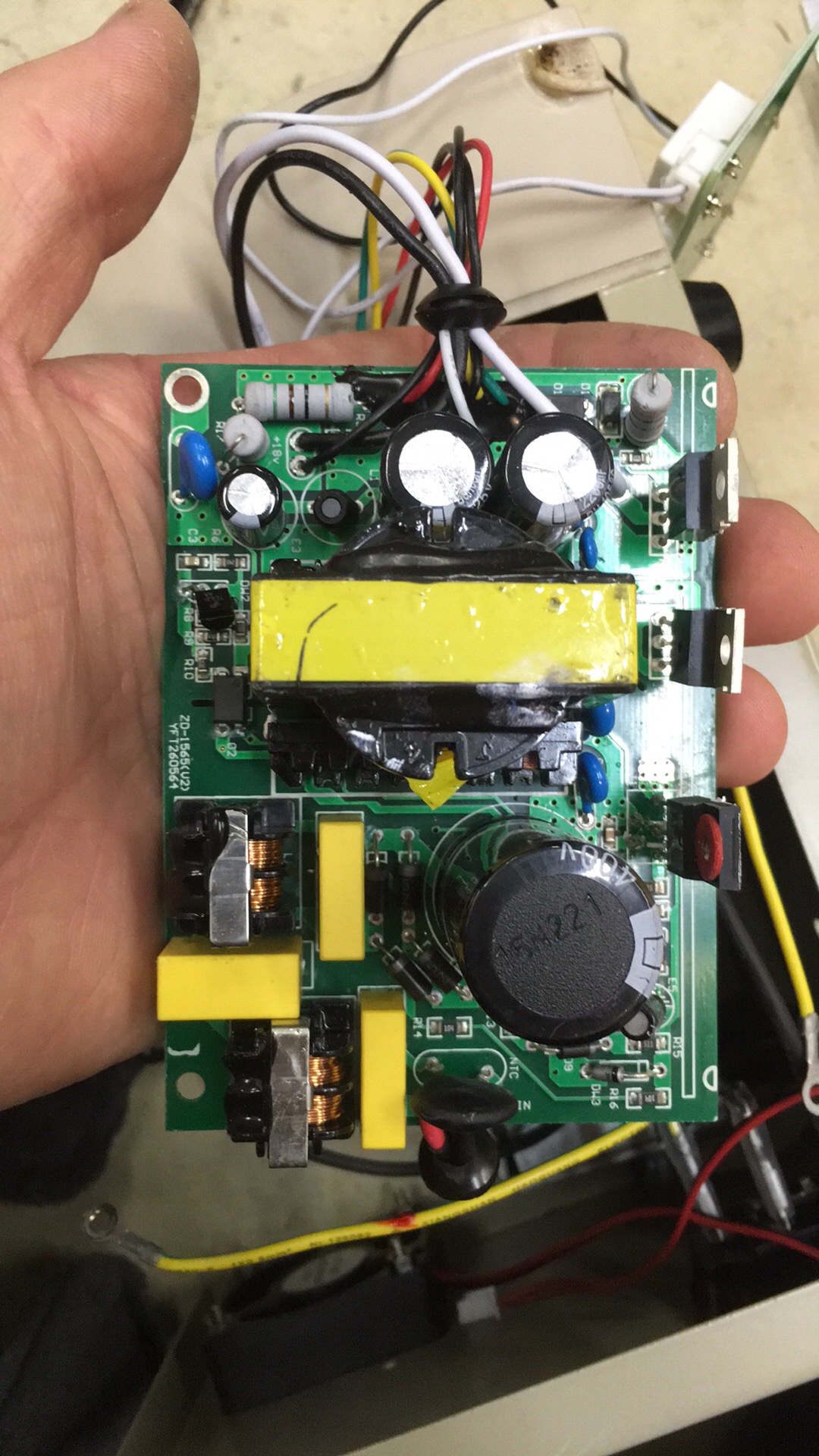

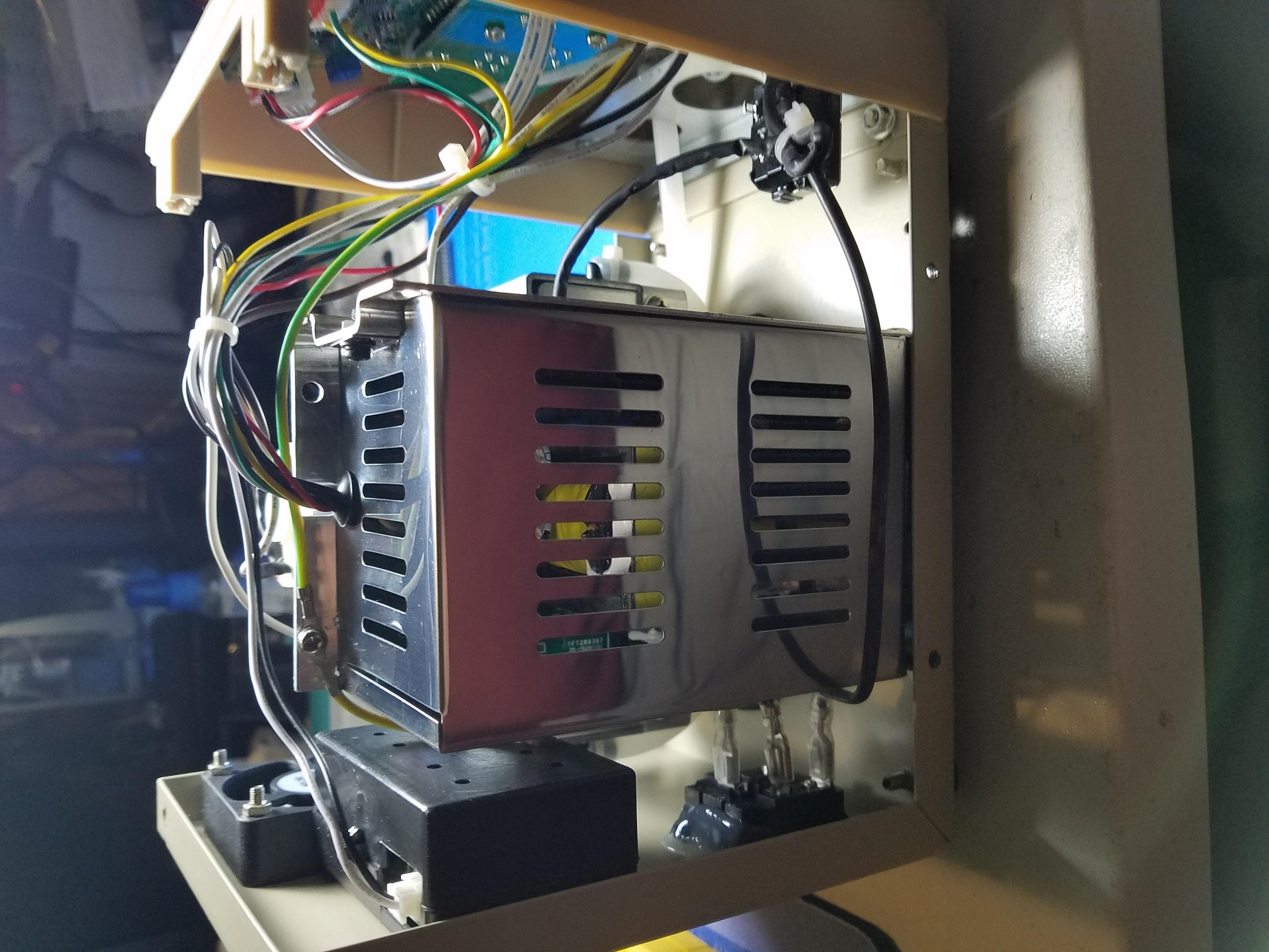

                        #31
                        I'm a newbie with electronics (I fix Commodore stuff but thats about it) but to me it sounded like a fuse almost and then I read above about these power supplies possibly having a thermal fuse... in the transformer perhaps ? so maybe...

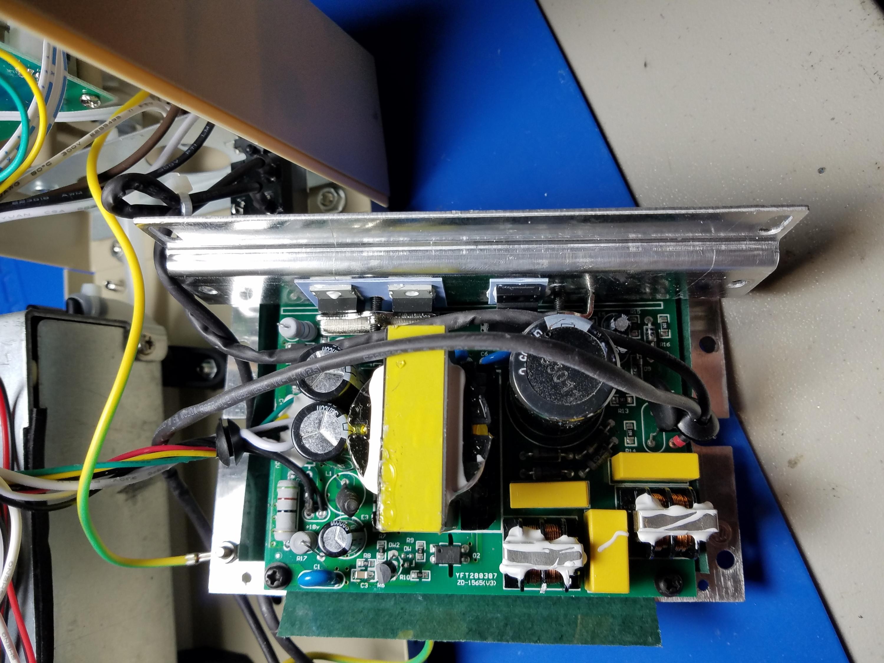

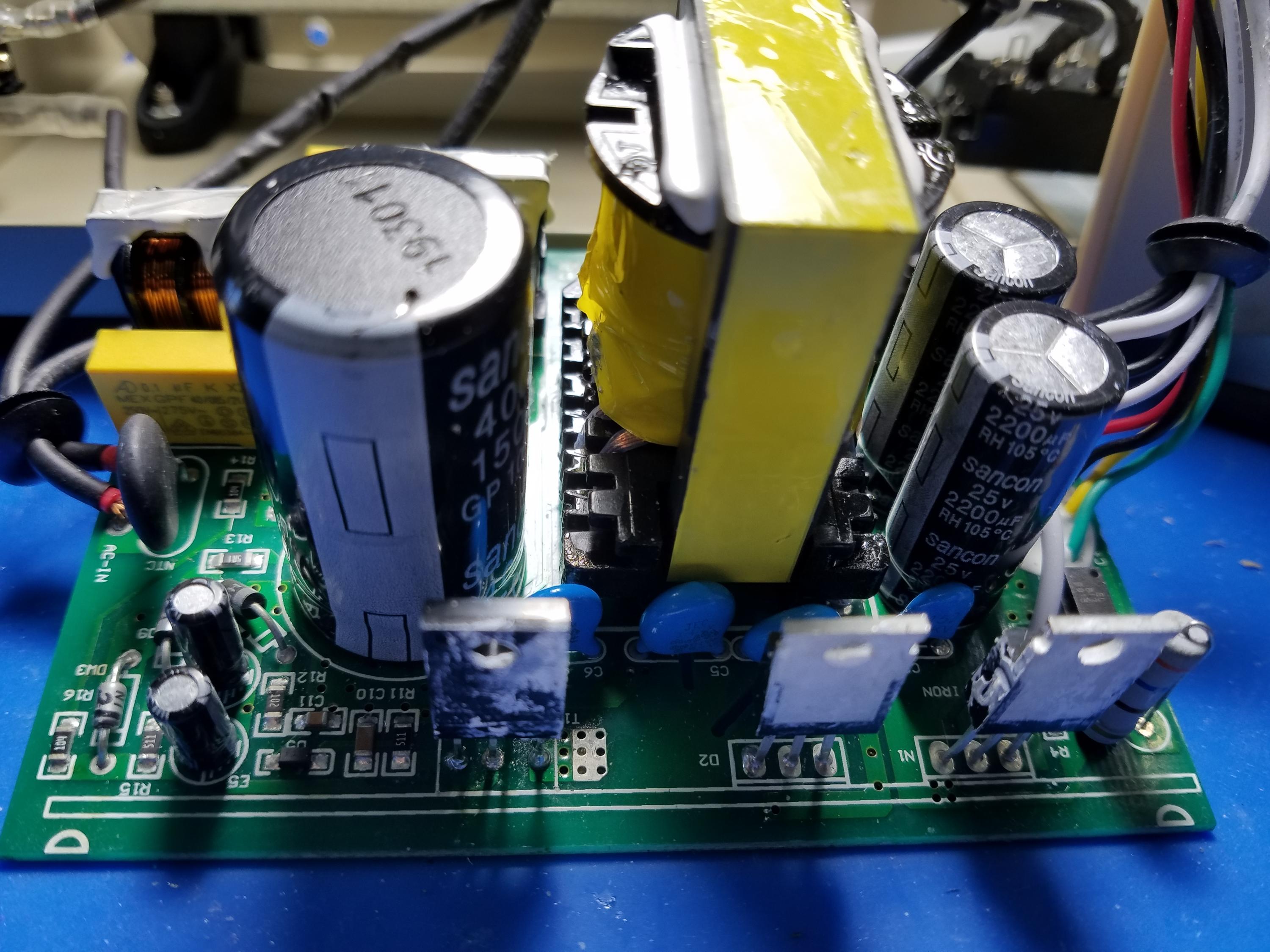

                                #35
                                Your photos show a switching power supply. These do not typically have thermal fuses in the transformer.
                                In any case, a fuse that blows audibly will be from over-current, not over-temperature, anyway. Thermal fuses do not typically make a noise.
                                Probably the controller IC has blown up. See attached image from an earlier poster with another one of these stations. The package with the red washer on it next to the primary capacitor. If you look carefully you may find a hole in it.

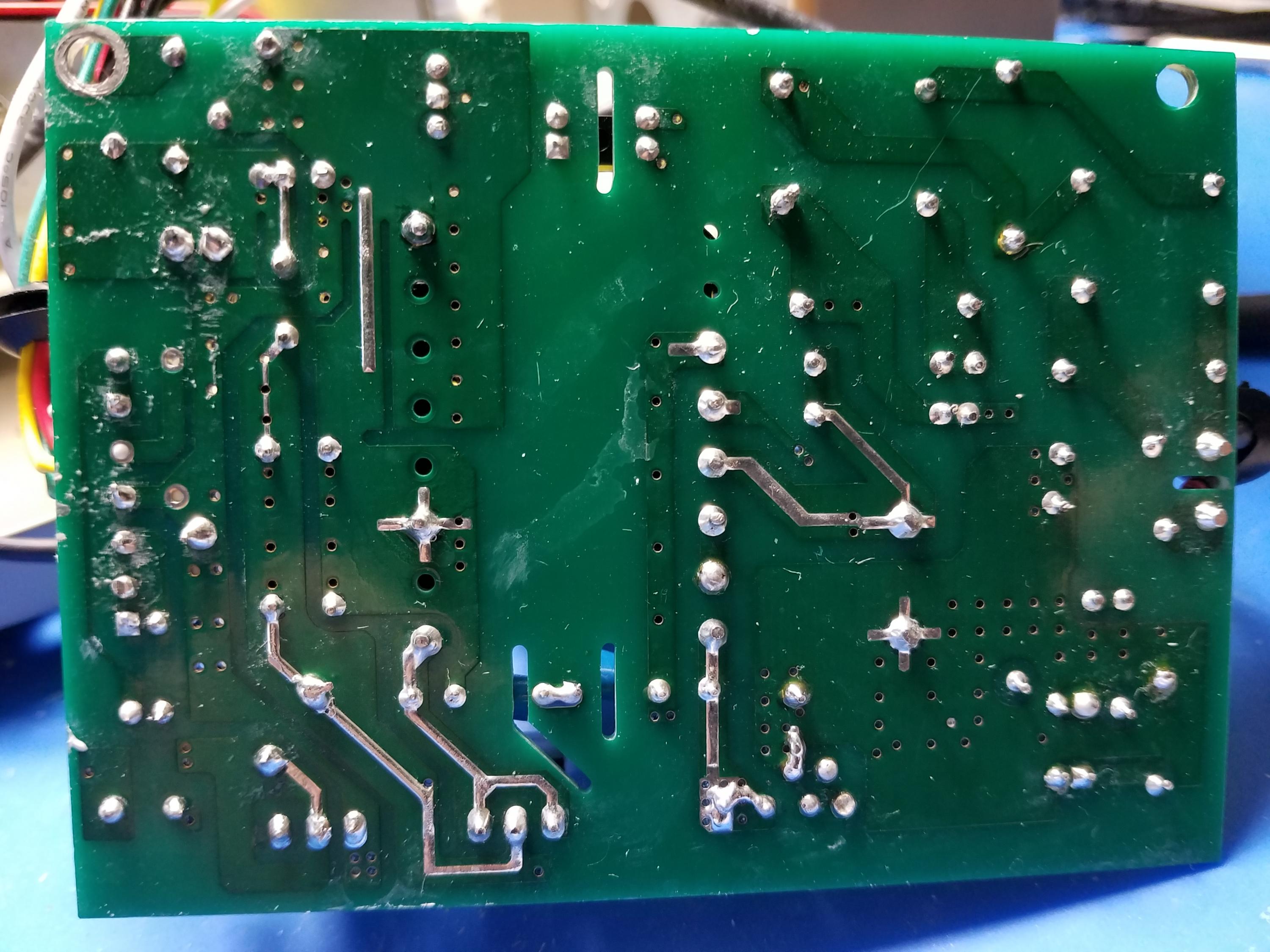

                                  #36

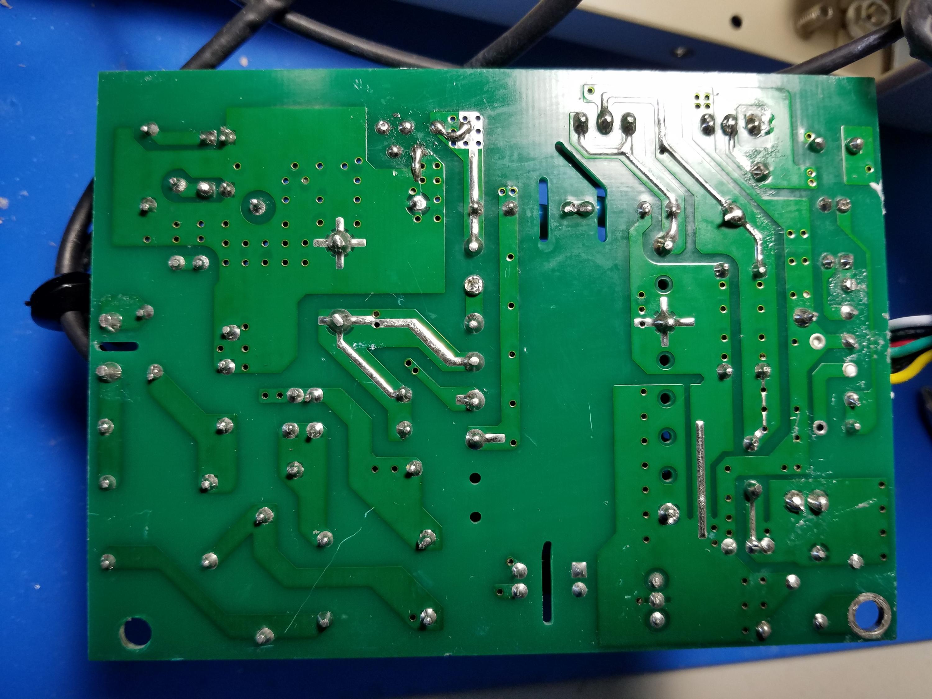

                                  You should also show us good clear straight shots of the whole bottom side of the board.

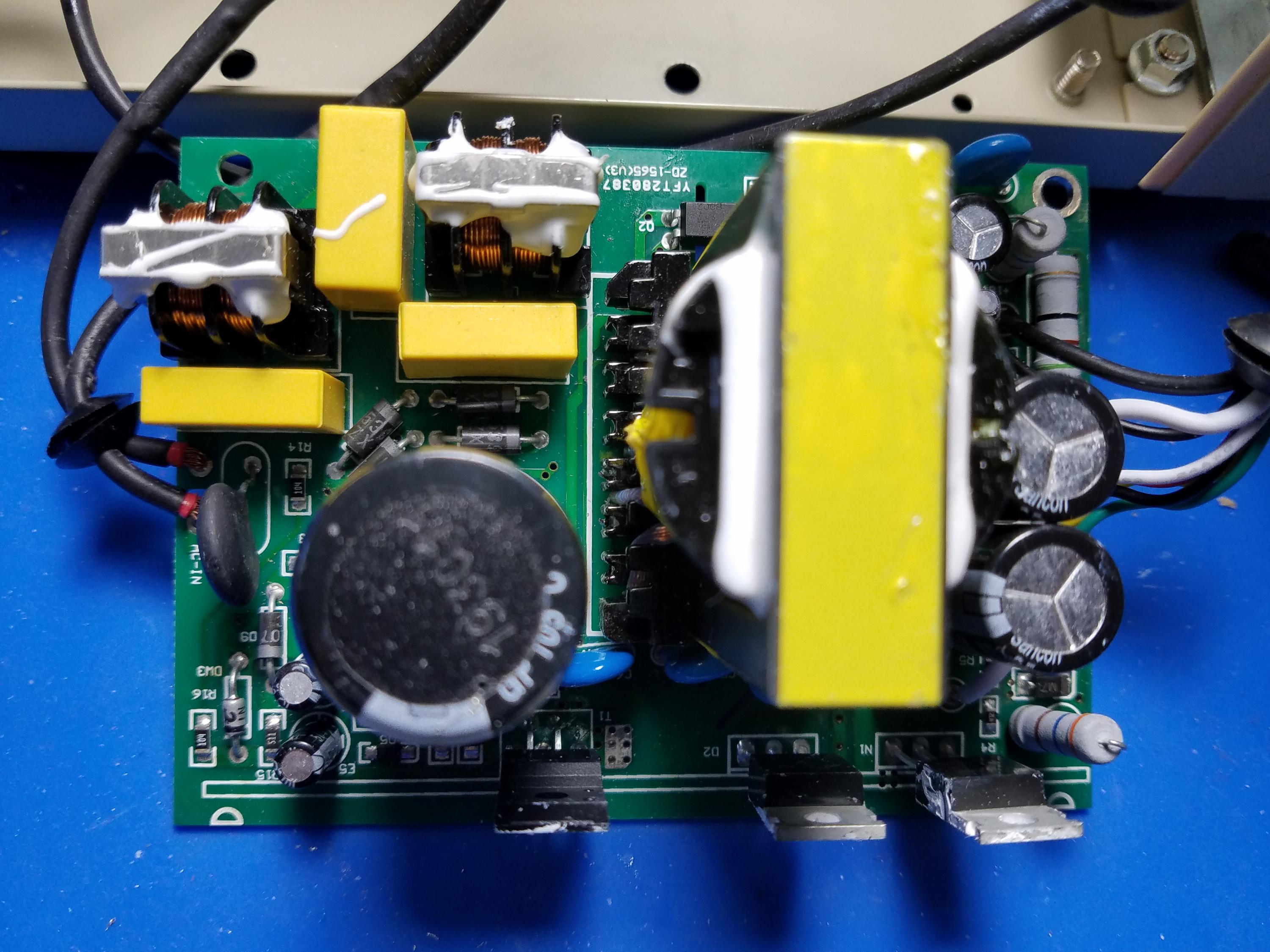

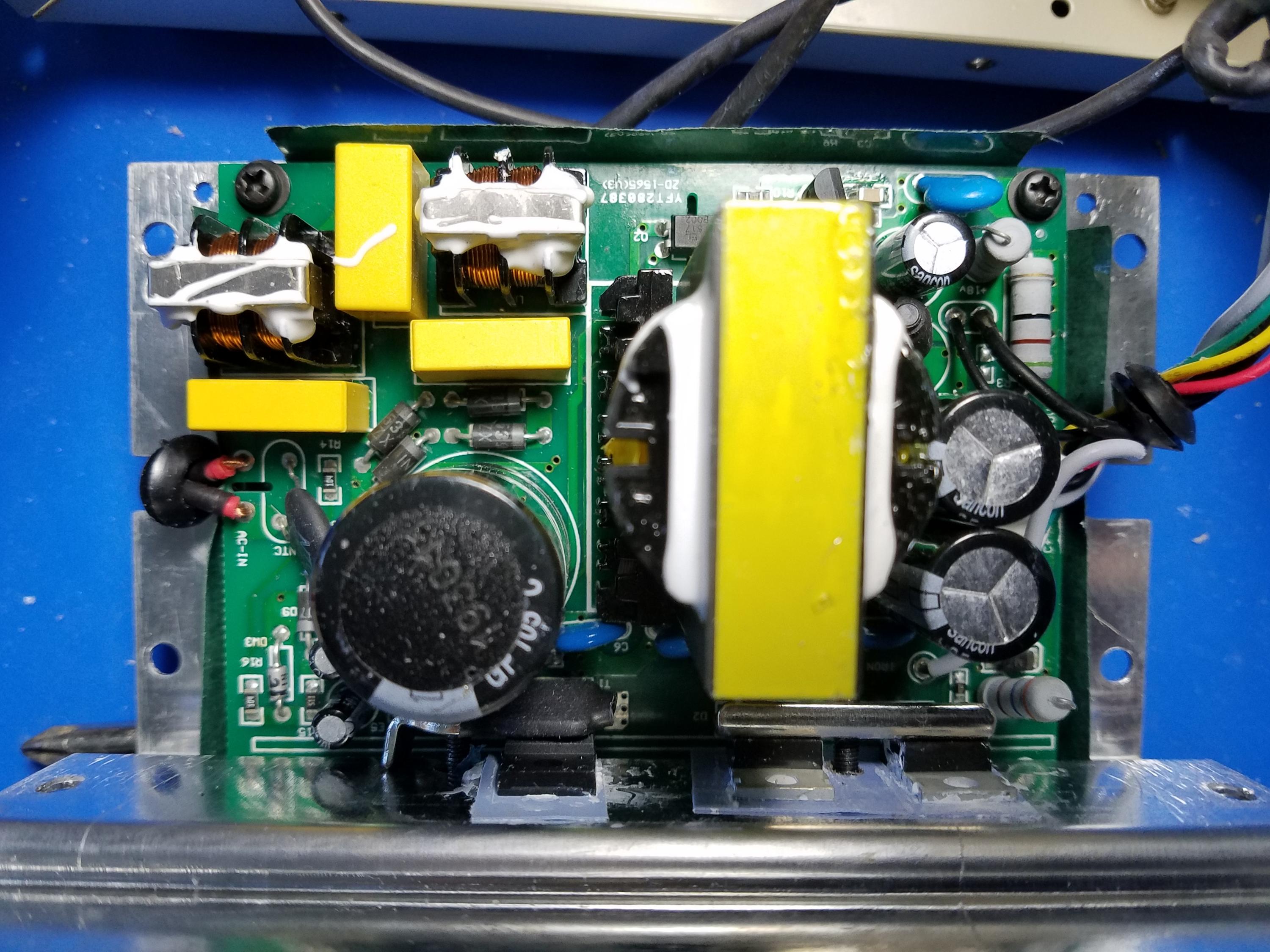

                                    #37
                                    more pictures as requested :-)
                                    main board has 110vac coming in and 164v dc at transformer primary and also at T1 transistor. Nothing at all coming out of the secondary. did not see an obvious F1 thermal fuse - maybe its internal to the transformer... (edit: just read above post - these don't have any - thanks!) also no voltage going out to secondary boards (LCD and controls) no 5v or 18v at the connectors. Reflowed all the dubious solder joints, no joy.

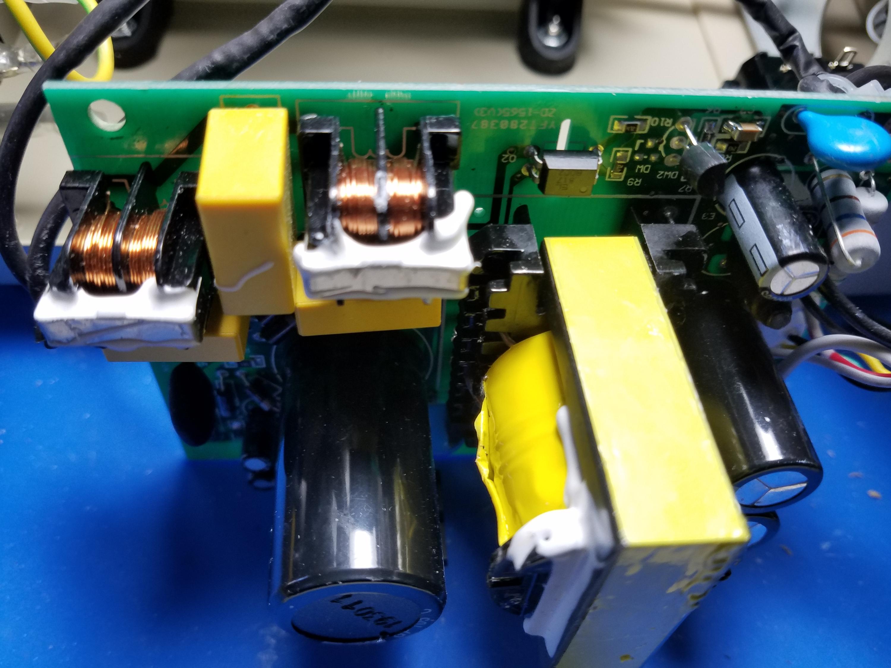

                                      #38
                                      better view of circuit board after reflowing. Power supply board is ZD-1565 (V3) but appears very similar to V2
                                        • Jul 2011
                                        • 6062
                                        #39
                                        The problem look like you do not have your soldering hot enough to make good looking joints because some of them look like crap at least with the photo that you posted

                                          #40
                                          Forgot to mention - the CQ1565R T1 is measuring 164v across most of the pins (not sure that is correct - the same voltage that is at the primary transformer side on the bottom of the board. There is no evidence of burning/splitting etc...
