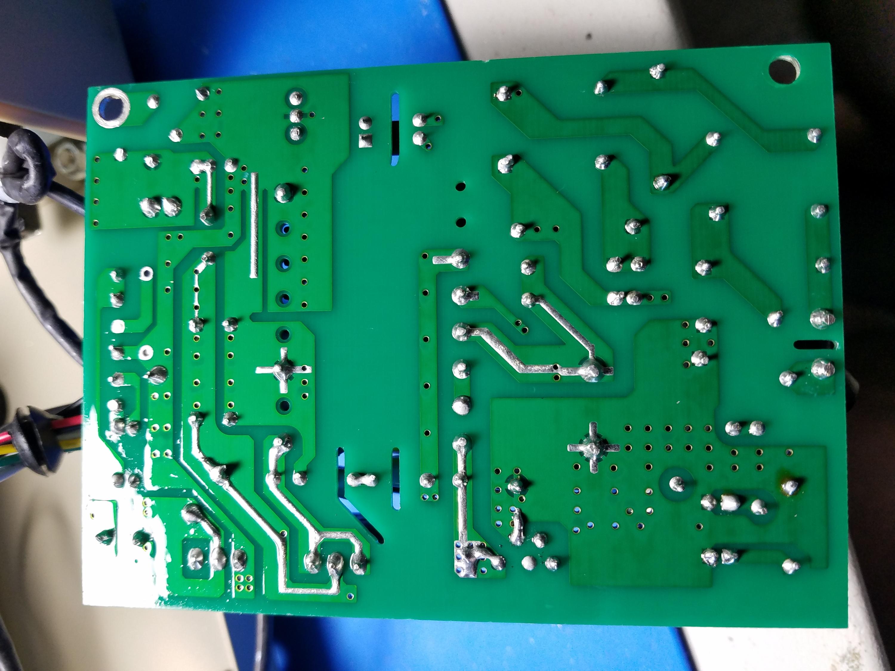

    Originally posted by sam_sam_sam
    The problem look like you do not have your soldering hot enough to make good looking joints because some of them look like crap at least with the photo that you posted
    Good tip! they did come pretty crappy looking to start with (those were the top pictures) - I'll crank it up and reflow again - cant hurt... They also let a lot of flux on the board which I have now cleaned up for the most part ... unfortunately it didn't help...
      Not in this model it the one that has transformer that has several winding on it with a small board with a bridge rectifier and some capacitors and a triac ( but this version has it own issues )
      I am wondering if you have version one when they first come it with the switching power supply version
      There is a way tell which version you have the first version ( if you have this version this nothing but problems) when you power it on with the trigger button pushed does the pump start right away or does it wait until it has finished booting I had one of this version and I modified the switching power supply to work off of a battery but I will not go into in this post but I do have a post about it
      If you have the revised version it wait until it is finished booting before you can run the vacuum pump
      This version is a lot better and it holds up very well under heavy use
      There is a solution to this type of switching power supply but have do some modified of this switching power supply board and it not easy to do but can be done
      If I remember correctly the trigger on mine does not work until it finishes booting. The board says rev 3. maybe they broke something from the improved version 2 :-)

                  Re: 18VDC PSU has dropped to 10v - ZD-915 desoldering station
                  When you get the “ FSCQ1265RT ” and installed it use a incandescent light bulb in series with the with fuse remove when powering it up after installing the new part the light bulb should at least a 100 watt and should only dim once the capacitors get charged if it real bright and does not dim ( you have another issue )
                  ( This is with out the gun not hooked up )
                  If the light bulb is only dim then hook up the gun and you might have to use a 200 watt bulb instead of the 100 watt for this test you should see the temperature climb if so then push the trigger button and you should hear the pump running now the light bulb might very bright which would be fine at this point ( one note if it happens to turn off and reboot use a 300 watt bulb or use 3 100 watt bulbs in parallel and do the same test again )
                  If everything goes well with this test then reinstall the fuse and then put power again and see if everything is ok again
                  Now if I were doing this repair I would replace all the capacitors except the main filtering capacitor
                  and should be good to go again
                  However if this ic chip failure happens again in a very short time period then you have some type of issue that need to be investigated further
                  One other note if you have the tube that the solder goes through to the collection tube and you can not clear it take a 1/16” dill bit and carefully remove the build up until you can put the cleaning wire through the the tube again
                  This problem happens because of to much flux sucked up the tube ( if your filter gets very dirty looking peal off the first layer of it and reuse it again this helps to keep the flux built up to a minimum )
                  One final note be sure to remove the shipping bolts if it has any before powering the new unit if you did not remove it from the first unit that you have you need to remove them as well if it has them
                  If your tip becomes uneven and you can not suck up very little solder then if you have a dermal tool with a cutoff disk take the tip and remove the part that has made it uneven and make the the tip flat again and should be good to go again this happens because using the tip to straighten the component leads which should be avoided if you do not want to resurface the tip all the time ( normally you do not use the side of cutoff disk this way however it is the easiest way to resurface the tip to make it flat again just be careful not to use to much pressure on the disk to break it let the tool do the work light pressure works best )
                  I find that if you set the temperature at 775* F and you do not leave the tip on the board for more than a second or so this works for me the best most of the time however if you see that the circuit traces ( or that the board is turning brown or black) are being lifted then drop the temperature 100* F for this board and once you are done with this board then set the temperature back to the 775* F
                  I hope this helps
