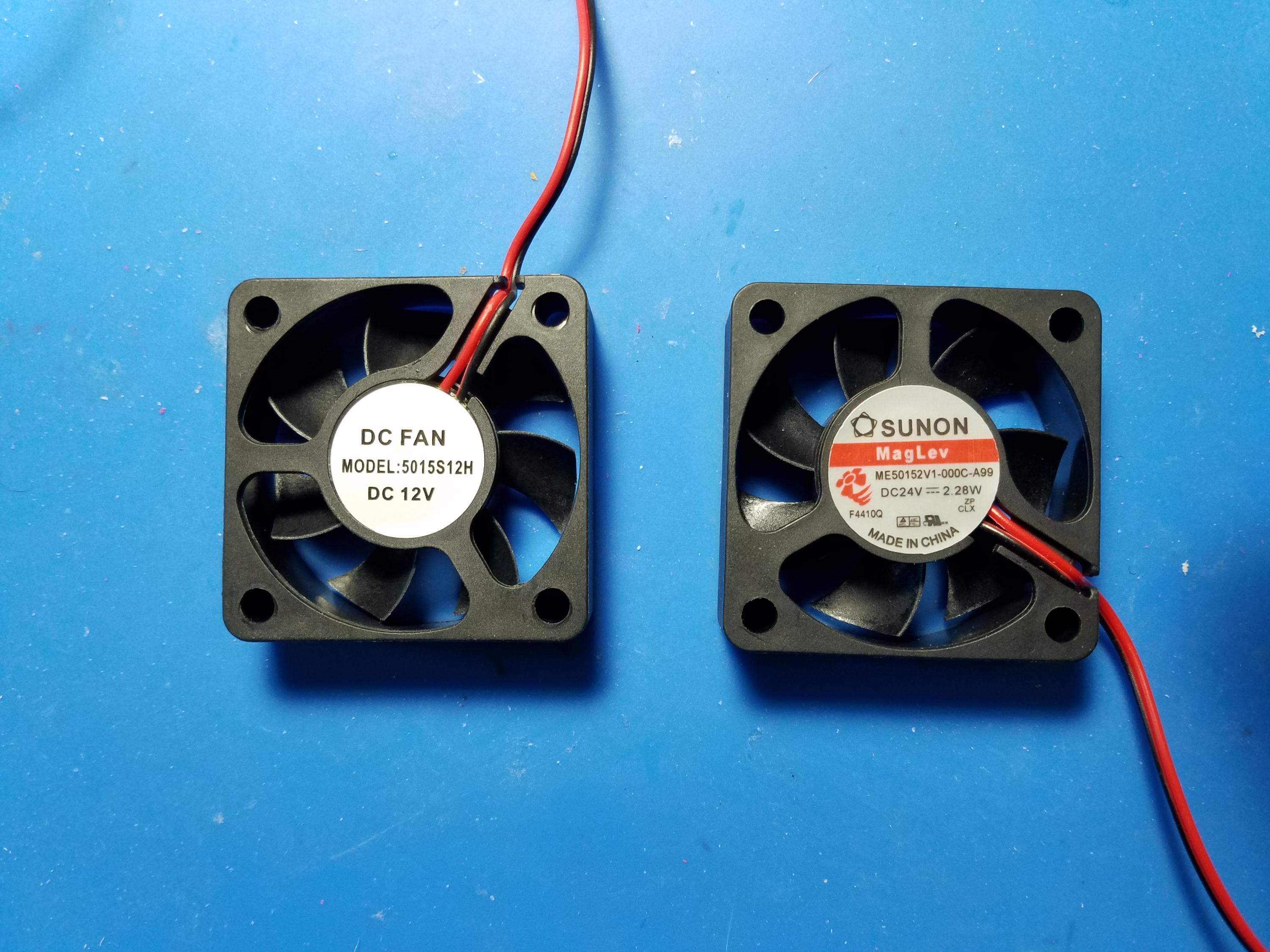

      it isnt 18v to the fan, because it goes through a couple of wirewound resistors.
      the fan is shit though. i replaced mine with a sunon maglev fan and a 9v buck convertor
      Right you are! Actually, I measured at the fan connector after the resistors and it does still read 18v going to the fan. So I decided to replace the 12v fan with a Suncom 24v ME50152V1 which draws 2.8w. The unit is much quieter and holds temperature better (less peaks and overuns in temperature listed on the lcd screen). My guess is that the loud whining 12v fan was inconsistent in voltage/amperage draw due to running above spec and was causing instability issues in temperature This is the fan I got: (sh*t fan on left, good one on right) probably some bean counter decided to reduce costs on the fan.

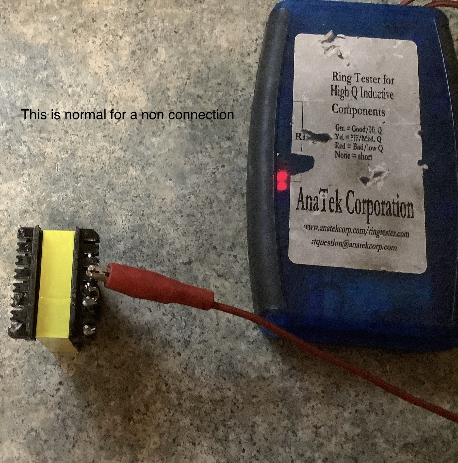

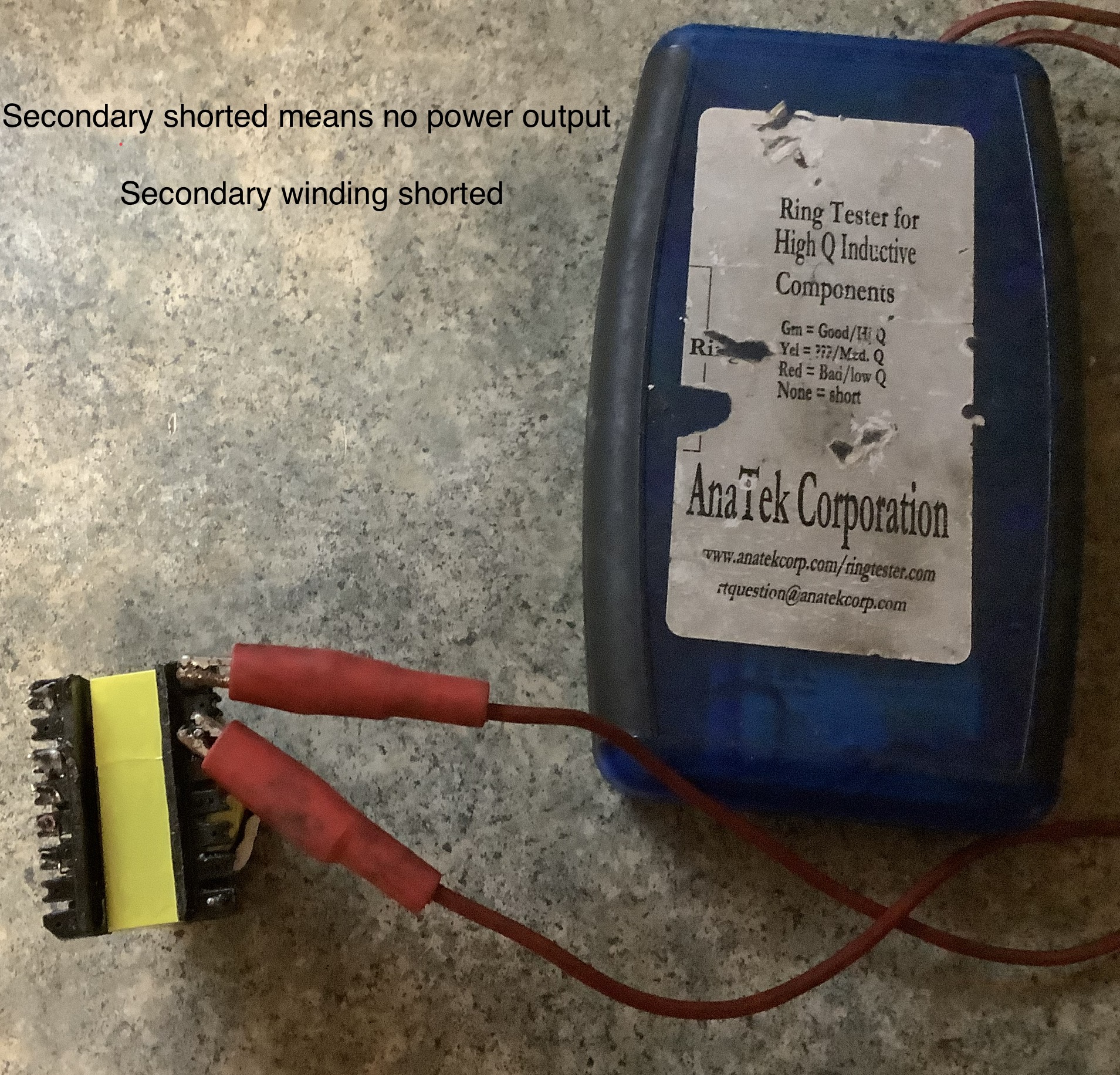

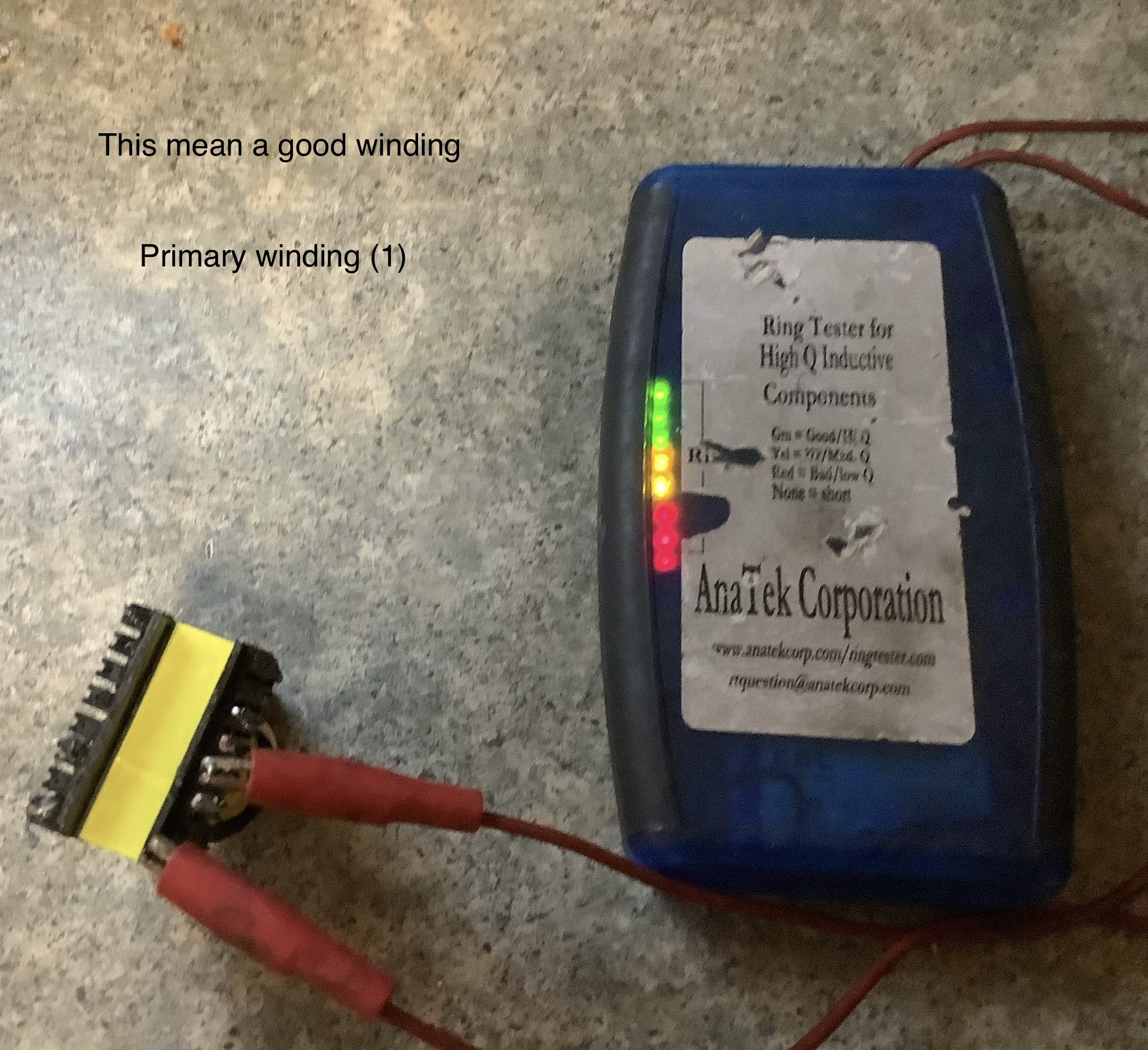

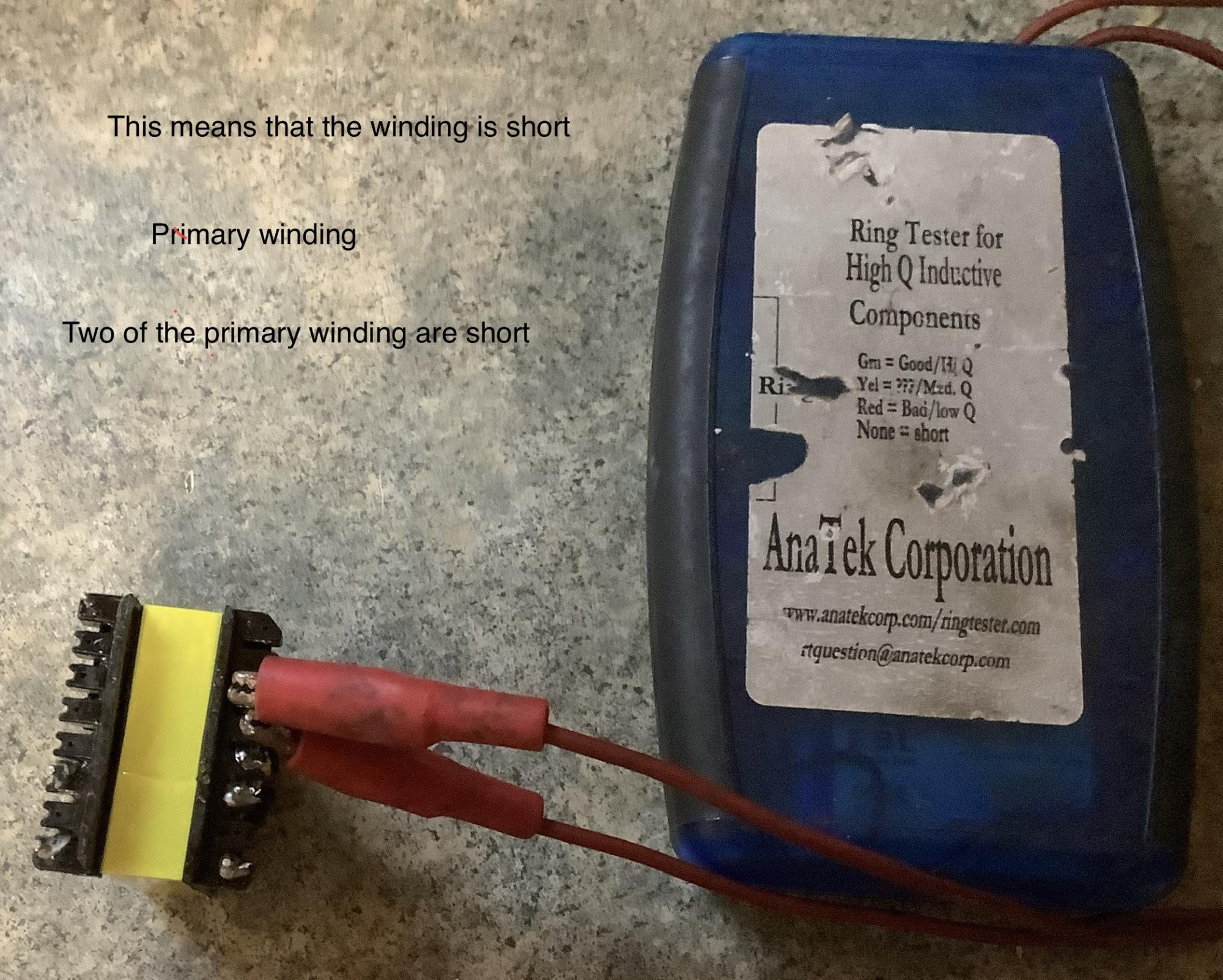

        Well I have some answers to the question about why this Desoldering station did not work correctly
        Yea I know that this is a old post but he reached out to me about trying to repair it and this is what I found out
        Two of the winding are shorted so it has seen better days

                        I have modify one of my Desoldering stations with a 24 volt fan instead of the 12 volt fan that is in it I will see how well this works very soon I also have another one that the fan has also gotten noise so I need to replace it before it starts squeaks real loudly

                                  I know this is an old thread but how do you determine the windings are shorted when at least one shows good on the ring test?
                                  If any winding is shorted, it should affect all windings and none should have high rings, as far as I know.
                                  Or is there a special case where this can happen? Would be interesting to know!
