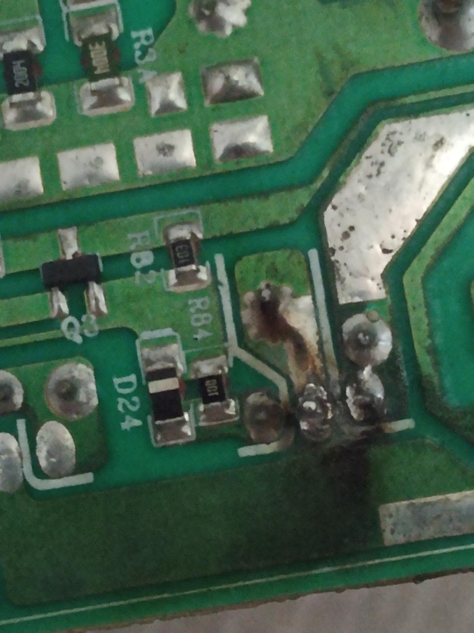

    Hi All
    Need help to identify a shorted diode on PSU Hexa 500W.
    Don't know what rating to replace with.
    Shorted diode is D24.
    D24 is located just under the long heat sink (indicated by arrow).
    there is a familiar looking diode at D25
    Main Fuse is also blown.
    Any help is appreciated. Thanks

    Did you remove it and test it off the board? It is connected in parallel with the resistor R84 (I cannot cleary see the print on the body, but more likely to be a 10 Ohms resistor).
    BTW, that diode/resistor network is for Gate discharge which is connected to Gate of the MOSFET, you should check and see if the MOSFET is OK or not.
    Since the main fuse is blown, you need to check all the power semiconductor devices for shorts.
