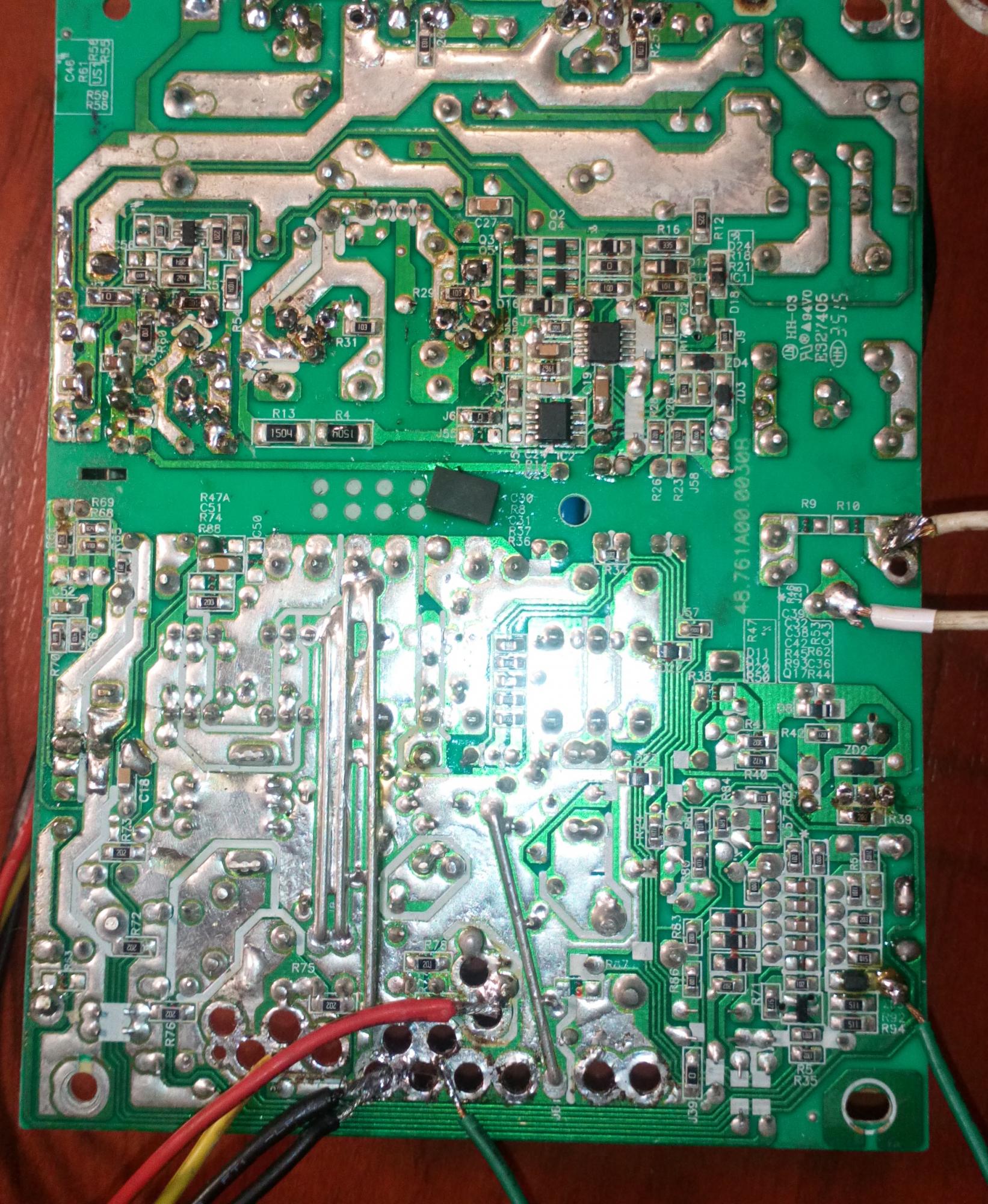

      Thank you so much for you answer, I am attaching the pic of the back of the PCB to see if you can see the problem, I did some resoldering to the ones that looks suspicious. I know it doesn't look good in the "burn" zone but most of the brownish stuff is resin. The quality of the soldering isn't that good for a brand like NZXT.
      1) The fuse is OK, at least the AC powers goes trough it.
      2) When I "turned" the PSU using the paper clip method and connecting a disk it doesn't show anything in the reading. So NO +5vsb.
      3) The big capacitor show some reading about 240v so I guess that's ok.
      I had to desolder the main 3.3, 5, and 12v cables since it's impossible to manipulate correcly, checked for short circuits and everything is OK (no voltage neither hehe).
      Thanks again for your time.

        Can you please tell us what is going on with the soldering joints around R28 and R29 or R30
        From the photo it looks like bad soldering joints or is it the way the light is hitting it

          That said, it looks like transistor Q11 and associated components around it are responsible for generating 5VSB, so that's where you should start. Pull out Q11 and check it. Also check R1 for open-circuit and all the diodes in that area for short-circuit. Unfortunately, the controller for the 5VSB is that tine SOT-23-6 -packaged IC. See if you can get a part number off of that for us.
          By the way, I still can't see what has burned from that bottom-view picture. But now that I look back on the other pictures you uploaded, it looks like it's something from the 5VSB circuit. So that could well explain it why there is no 5VSB.
          Of course, first verify the voltages that I asked for on the main capacitor. Again, you should be looking for either 160-170V DC or 320-340V DC, depending on what part of the world you live.

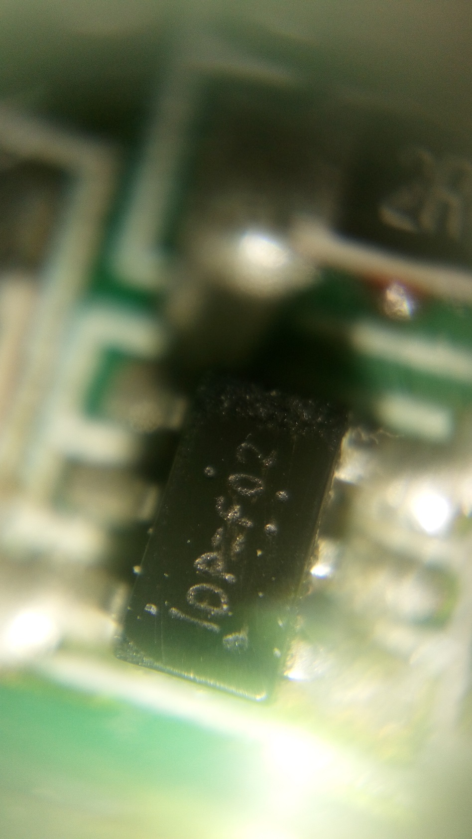

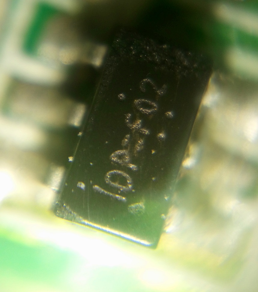

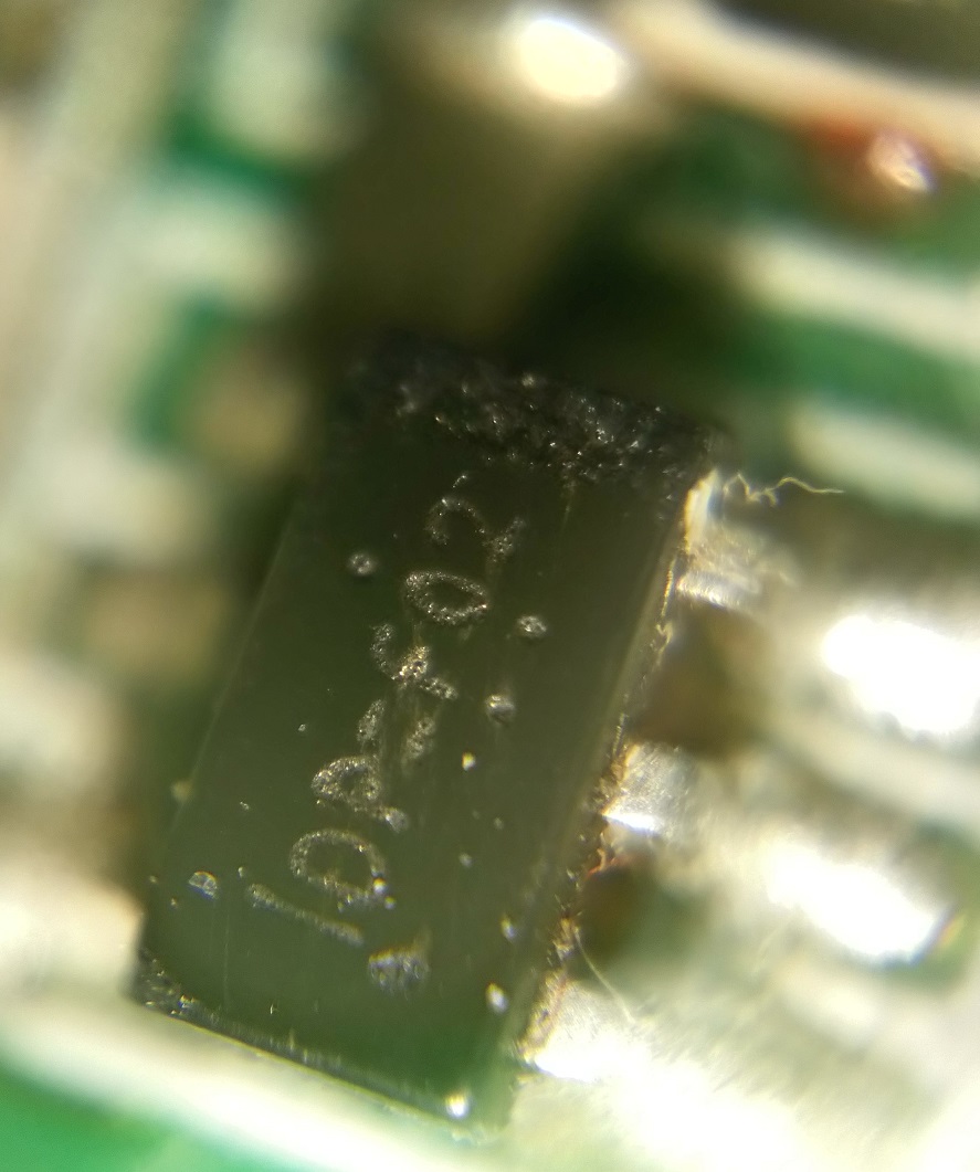

              No. The CM6803 is more than likely your PWM + APFC controller for the main PS.
              Like I said, see if you can get any part number for that 6-pin SMD IC on the upper left corner of the PCB in this picture (just a little NW of SMD resistors R13 and R4):
              https://www.badcaps.net/forum/attach...3&d=1555194594
              I think that should be your 5VSB IC.

                Thanks for the lesson. This is a hard one to get a photo. I improvised some lens with my cellphone camera. It seems like l DP F02 ?

                  Sorry for the double post, but it looks like IDP F02 it's not exactly the part number, but the fabrication date or something. More info here:
                  http://lcd-television-repair.com/new..._Power_IC.html
                  http://tel-spb.ru/repair/pwm-sot26
                  Following the descriptions in the links above it might be this one, but i'm not so sure: R7731A https://cdn.badcaps-static.com/pdfs/...723a3baac5.pdf
                  • R_J
                    • Jun 2012
                    • 9592
                    Re: NZXT 700w Hale82 v2 (Repair Help)
                    That looks correct, I think there is a resistor R1, between the standby transformer and one end of R13 (B+), see if is open

                      Confirmed, that looks correct to me as well.
                      Try to see if there is any voltage between pin Vdd and Gnd on that R7731A chip. If yes, let us know what value you get. If no, there should be at least one (but most likely two) series resistors going between the Vdd pin and the +320V DC bus on the primary. See if either of these are open or high value. Because such resistors tend to have very high resistance, it's advisable you check them out of circuit. R_J mentioned resistor R13 (which is also in series with R4)... but I'm not sure if either of those would be the "startup" resistors for the R7731A IC. Unfortunately, with small SMD parts in circuits like these, it gets a bit difficult to see how things are connected, so that's all the info I can give you right now. That said, could also post another picture or two of the area surround the R7731A IC?
