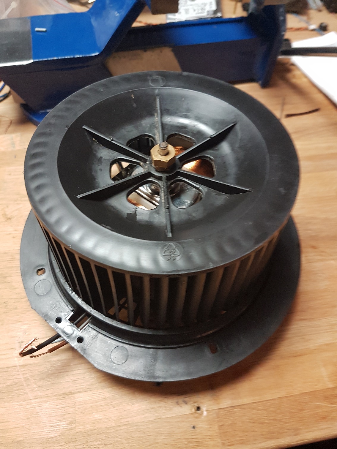

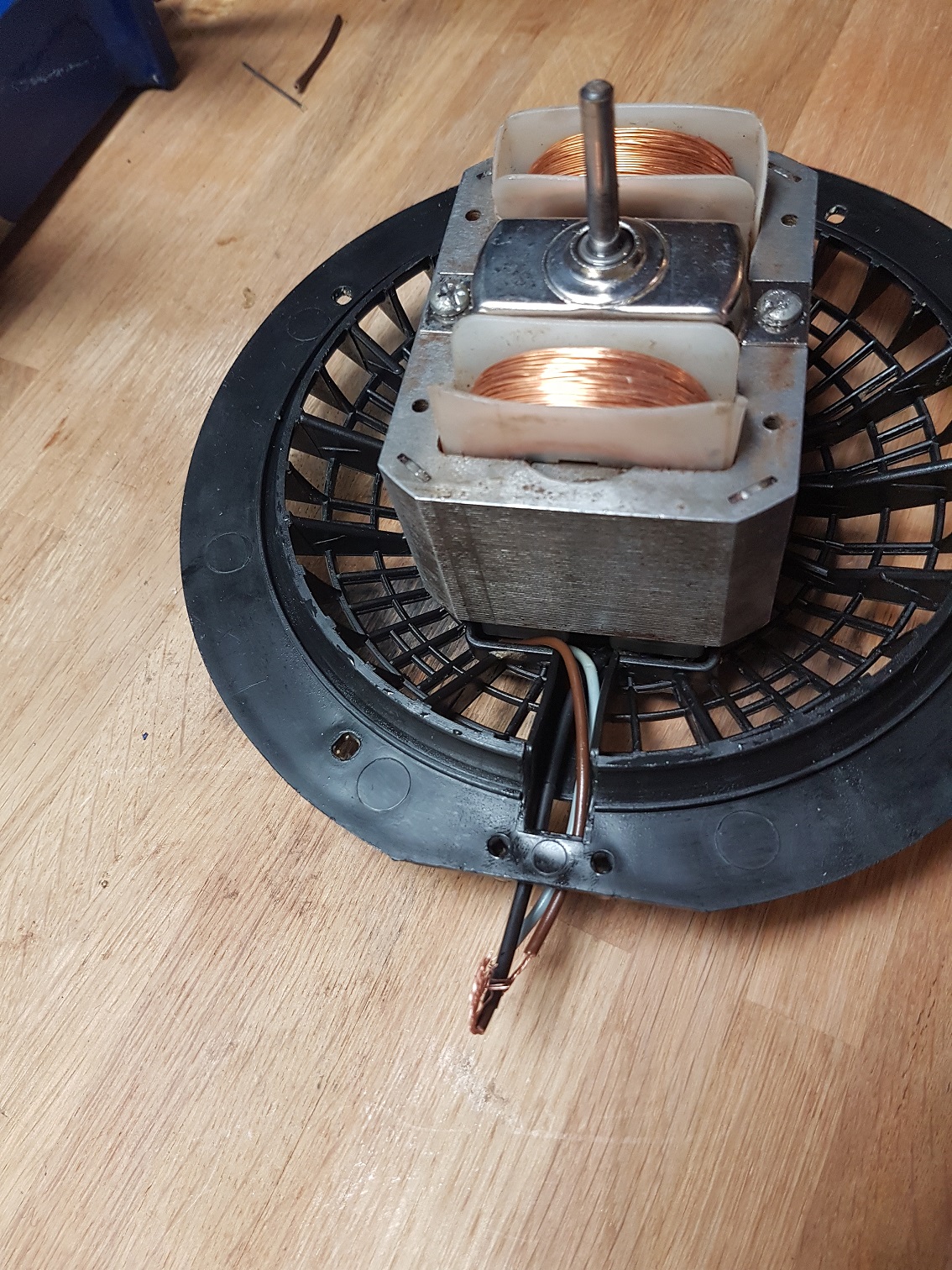

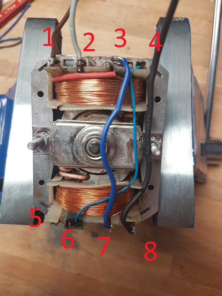

    Hi there, hope it's the right forum section.
    I have a what i believe a wall fan that is 230v 150w
    Could some one tell me what the brown, grey and black wire are.
    #3 had burned out so I patched it, hence the red shrink tube.
    I measured
    1-2 @ 10 Ohm
    5-6 @ 5 Ohm
    6-8 @ 14.5 Ohm
    7-8 @ 9.8 Ohm
    Are these reading ok? is it safe to plug in?
    I have no idea why it was discontinued in use other than the #3 burned out.

    Re: Need alittle help with a fan transformer
    Without seeing the rest of the fan, Is there a speed select switch? was there a capacitor connected to the motor? How do you know it is 250 volt 150 watt? is there a lablel on it?
    My guess would be it is a 2 speed fan, black is common, grey and brown are high and low speed selection. so connect a/c between black and grey are one speed or connect black and brown for the other speed.

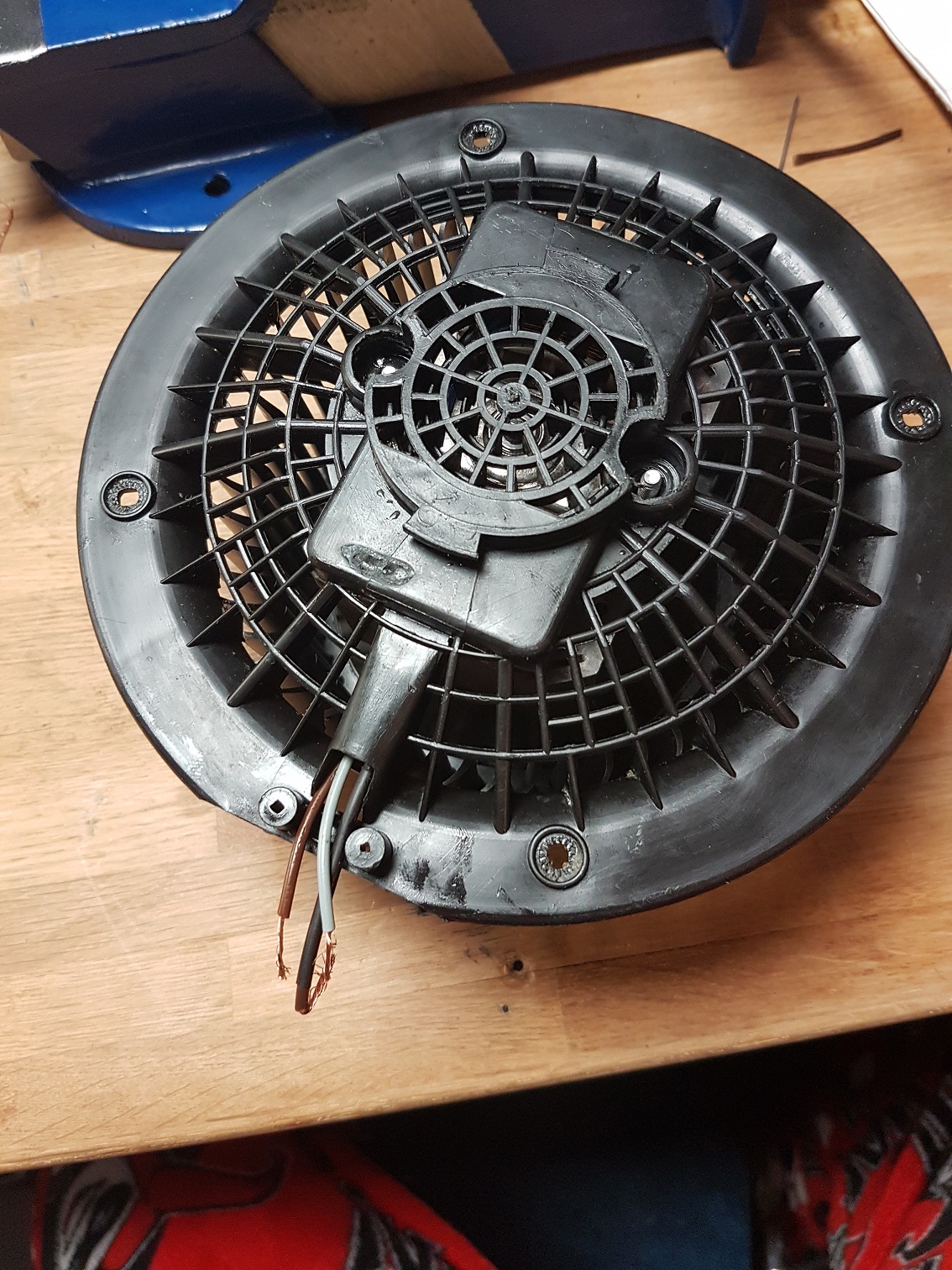

              I assembled it, doesn't seem there has been any capacitor, atleast no room for
              it on the inside.
              It's really hard to read on it.
              ΓIMΓ Sd 180595D
              MOD.K40 RP 0863 CL B
              230v ~ 50Hz 150W
              That's what I believe is written there.
                Well if the leads came out of the fan like that I would guess 2 speed fan.
                  +1, it is 2 speed shaded pole motor.
                          Well I just tried plugging it in, first brown and black then grey and black, and no luck
                          did not get any action from it :/

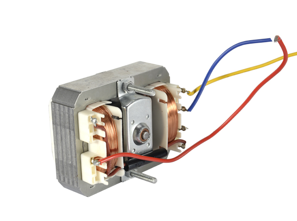

                            The closest motor I found was this from http://www.zhaolimotor.com/en/product-show-833.html
                            YJ84 is one type
                            Does it look like there may have been a wire on pin 5? It could be a 3 speed motor

                              It does not look like there was a wire in pin #5.
                              Also I noticed that the grey and brown are completely isolated.
                              I can only measure between pin #1 and #2.
                              Pin #1 or #2 cannot be measured between #3 to #8
                                May be the thermal protection fuse has blown, so the owner just discard the unit?
                                • playman
                                  • Jan 2011
                                  • 252
                                  Well as I said earlier the #3 pin/wire was burned out, had to resolder it.
                                  where might that fuse be hiding?
                                  only place that I can see that could hold a fuse would be the #6 but I can measure from the #5 pin and #4 fine.
                                    Thermal fuse is usually buried under the winding wrapping.
                                    Good motor will have thermal protection, otherwise you can have problems like these:
                                    https://cdn.badcaps-static.com/pdfs/...912857388f.pdf
                                    • playman
                                      • Jan 2011
                                      • 252
                                      Ah that might explain things, then it's off to the recycling.
                                      Thank you very much for the help.
