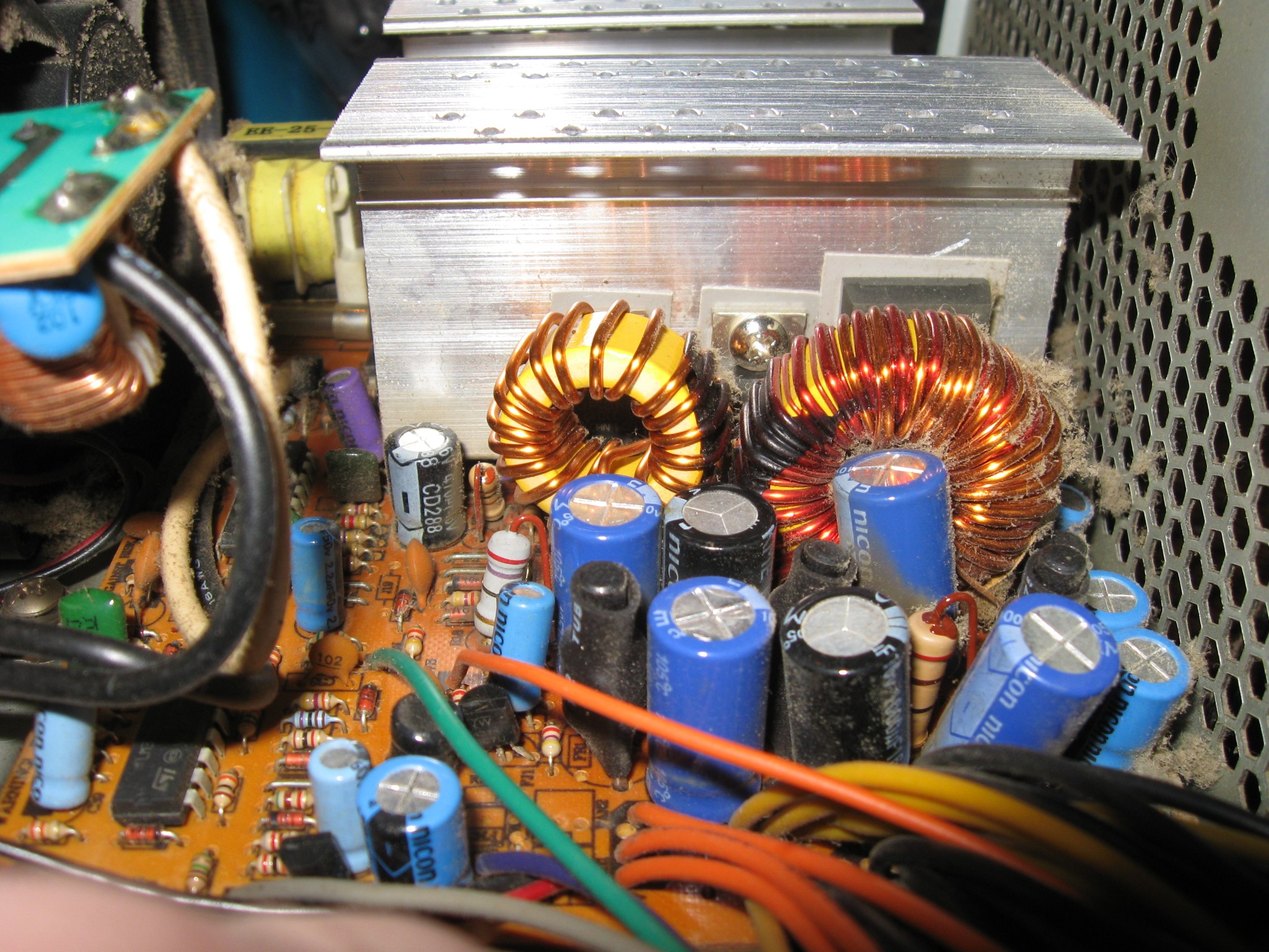

                    Disassembled, and I was very very pleased to see that the Macron I posted above uses two 40A TO-247 schottkys for the 12V. SWEET!

                      Another "Delux" power supply. Must have been a more expensive computer case because it has enough components in it to to save it from the "hall of shame" thread.
                      Fan going out, vibrating the whole case. Replaced it.
                      1000uF 10v capacitor on 5v swollen, probably due to heavy 5v load and bad fan.
                      Replaced both with 1500uF 6.3v Nichicon caps, replaced the 12v caps with 1500uf 16v as well as a precaution.
                            And that large 27 Ohm resistor next to it . (It's dissipating nearly 1W of power - not good.) Try to change it for something that will dissipate 0.5W or less and the new caps will be very happy .

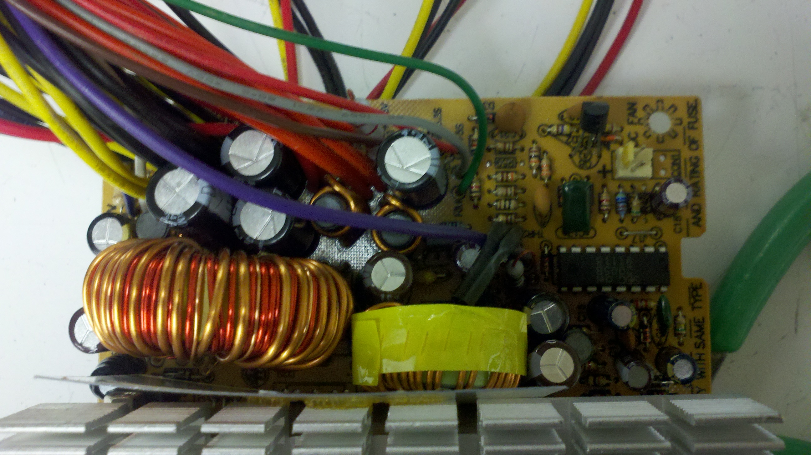

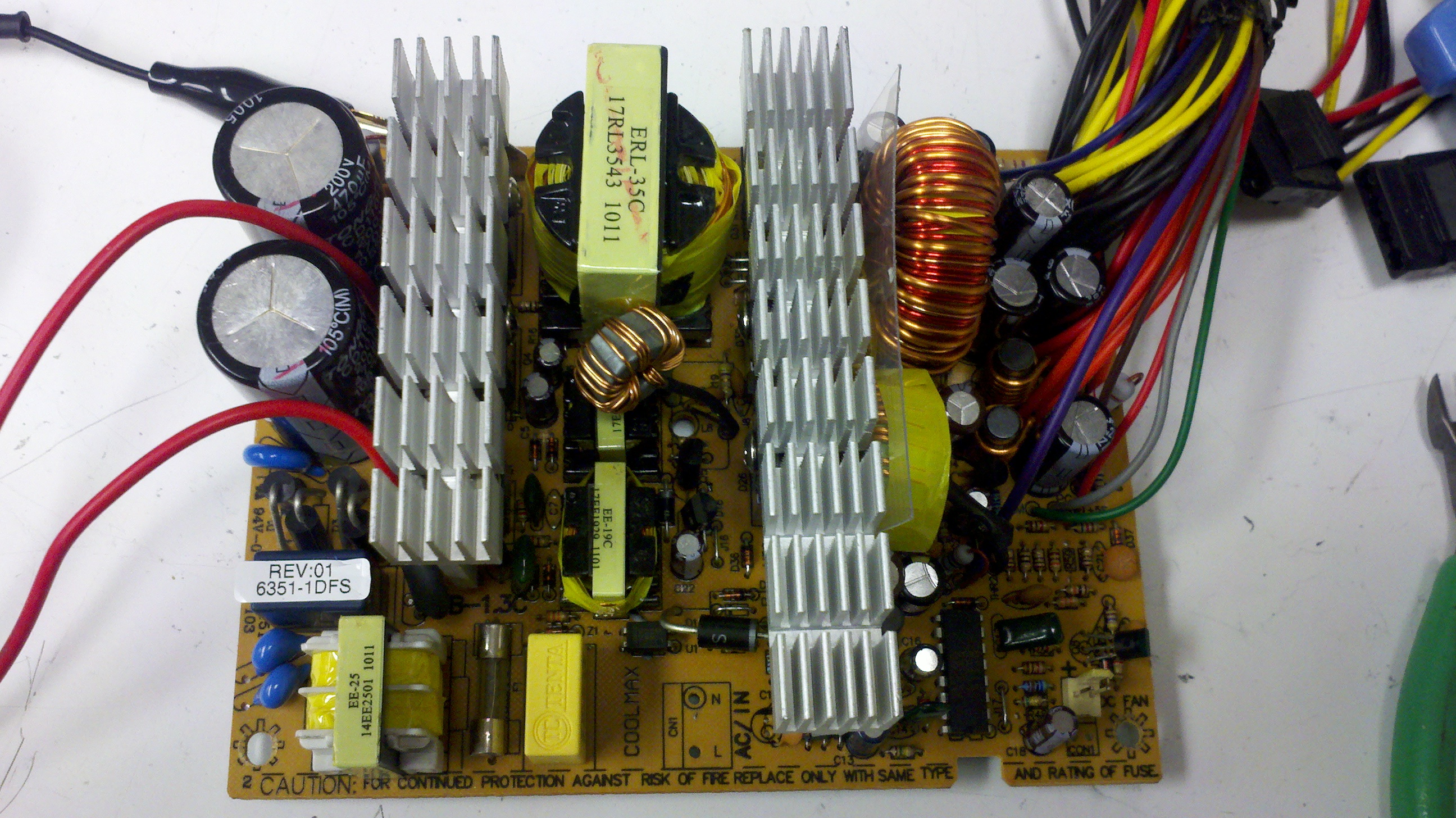

                                It's crazy how much Coolmax overrates their units, and they're super overpriced! This one was in a customers' Pentium D system. Looks like the typical 350W Sun Pro. On this one though, I'm impressed with the size of the main toroid I fixed it up nice for the customer, and I believe it will last quite a long time.
                                Those Tongjia caps were actually 470uF! I was shocked I replaced the standard ceramic "Y caps" with certified ones, added an X cap, and added two MOV's. It has TO-247 13009's for the switchers, nice heatsink.
                                Naturally, I recapped the entire thing. Besides the input, all the caps were Ricon. Sun Pro not giving a shit, the 5VSB minimum load resistor (22Ω) was physically touching the 470uF Ricon cap (I replaced the resistor with a smaller one), and it got completely toasted! It read 40Ω ESR!!! Can't imagine the ripple the board was getting, since it was the cap after the PI coil.
                                The LY fan spins well, and had plenty of grease in the bearing. 30A schottky for 5V and 3.3V. 12V had two 16A ultra fasts in parallel.
                                The voltage selector switch was giving a lot of tension on the input caps, and was touching the primary heatsink, so I just jumpered it and left the switch on the back, I don't trust the customer to not switch it to 230V
                                Redid a lot of the soldering, a lot of big blobs and joints starting to go cold.

                                  #1716
                                  I'd say about 350W would be it's max. It looks decent with the upgrades, though.
                                    Thanks!! Now that I think about it, maybe 300W since the fan likes to spin so slow, and the thermistor is inside the 3.3V toroid which I'm guessing doesn't get as hot as the main toroid or the secondary heatsink. I think the main reason the PCB got so dark, is because the fan spins slow and this thing was absolutely packed with dust. It was disgusting, actually.

                                      #1718
                                      Yeah, Sun Pro always seem to put the thermistor in the 3.3v toroid coil. It's a bad idea, since it means that the fan is regulated based on 3.3V load (which it won't have a lot of in most modern PCs). What's more of a problem, though, is that they sometimes, don't use enough glue, and the thermistor comes out of the coil and just sticks up. Then, the fan never comes out of idle.

                                        #1719
                                        That's what would have happened in this case because there was no glue holding it in there, but the minimum load resistor on the 5VSB ironically got so hot that it melted to the heatshrink of the thermistors wire and held it in place

                                          #1720
                                          Ah, yes, I can see the damage to the wires in the pictures now.
