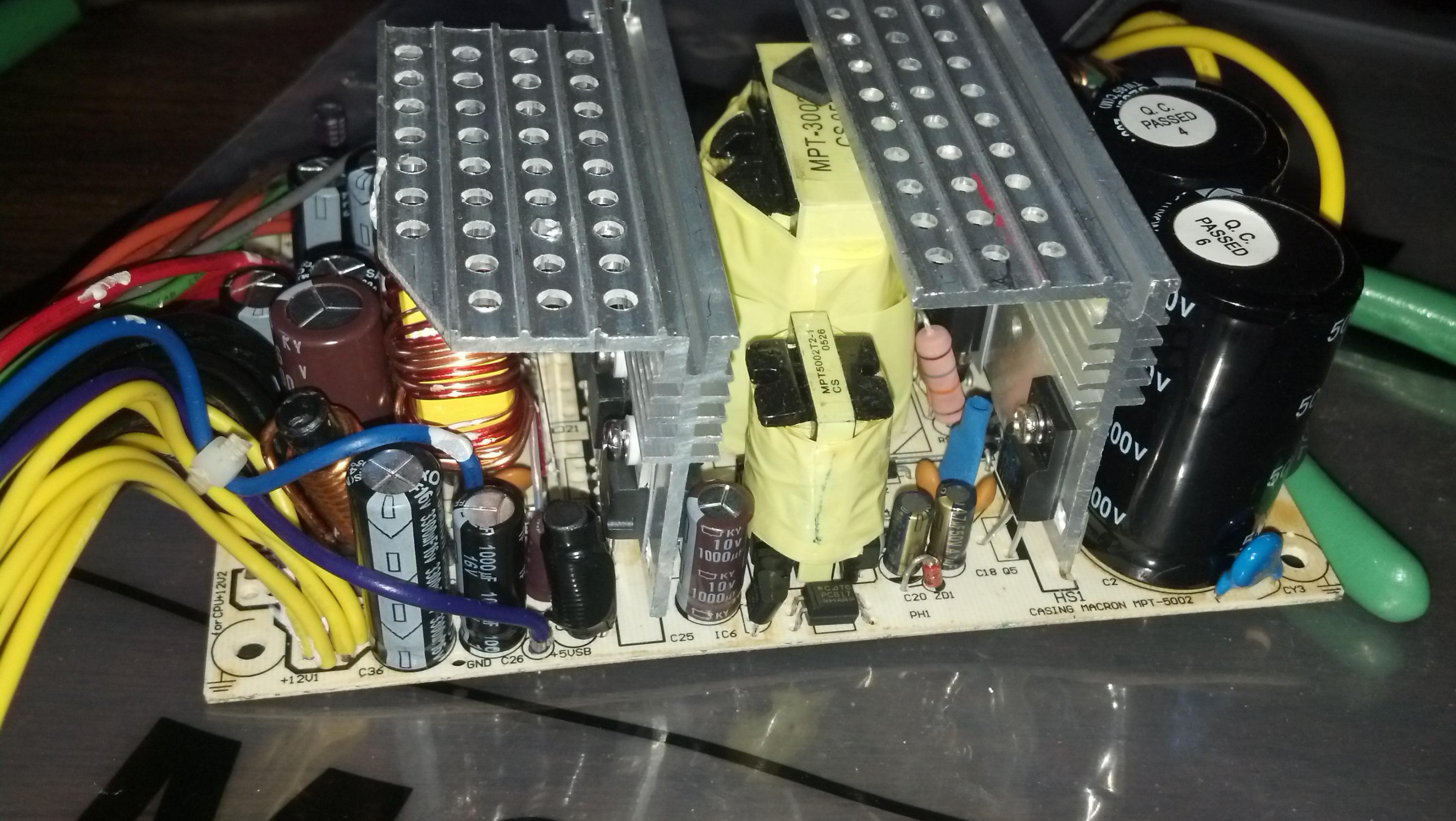

My friend said he'd give me $40 for a reliable 300W PSU, so I grabbed this Pixxo out of the bin at work and recapped it. Can't figure out the OEM. It had Asia X capacitors, replaced them with good parts but I used 680uF Fhy on the primary. Sorry I didn't snap a pic but this PSU implements the Viper22A. I think this will work well for him. Double forward with 14A FET's, 30A on the minor rails and what looks like two 12V rails with OCP, each schottky at 20A. has a really quiet fan. Also, I added that wimpy heatsink to the bridge rectifier, just because it was lying around

 12V @ 0.13A. But it's well oiled and surprisingly quiet, so I left it. I too thought 680uF on the input was a little generous but they only read 570uF so I assumed they were exaggerated 560's
