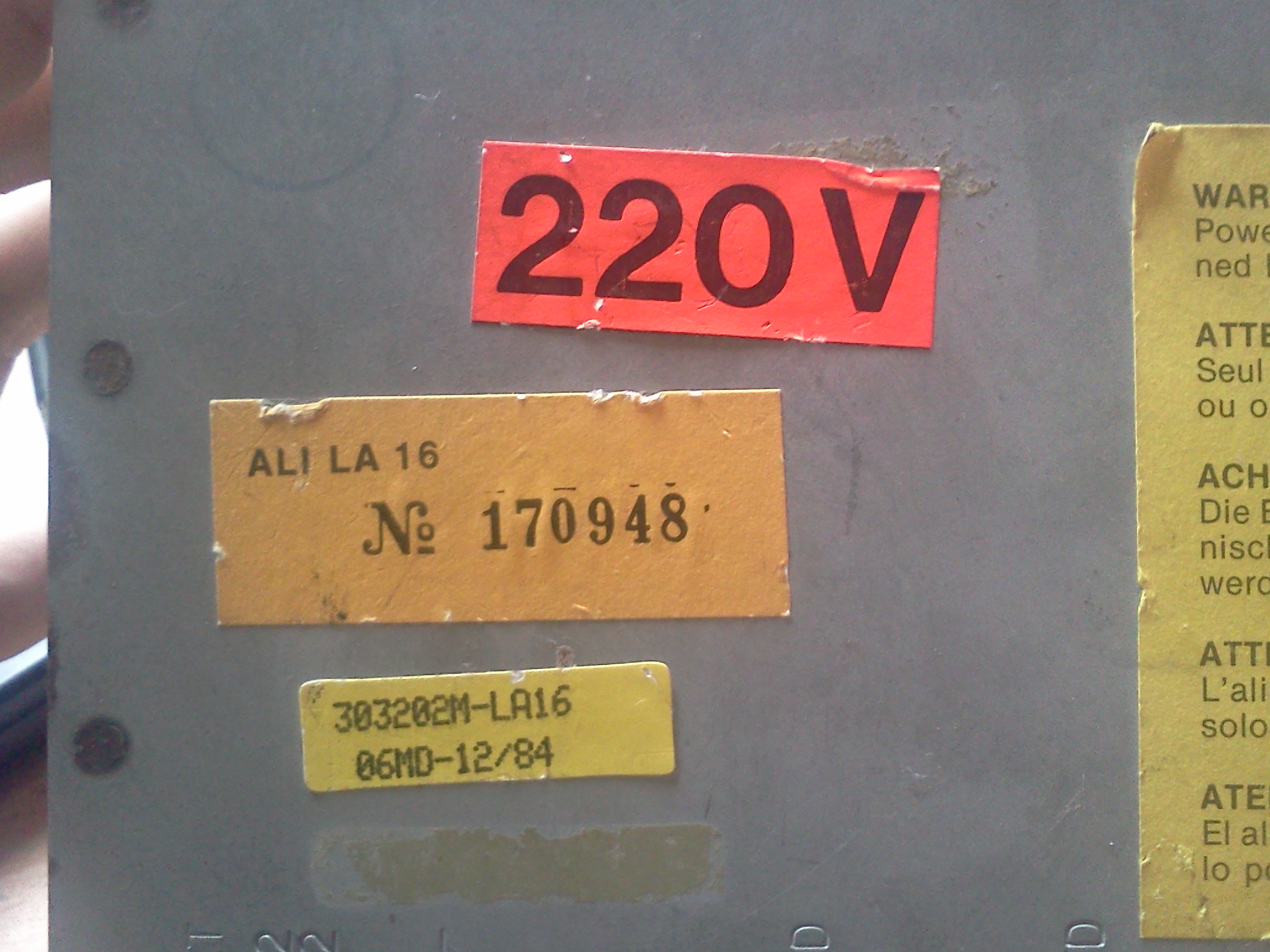

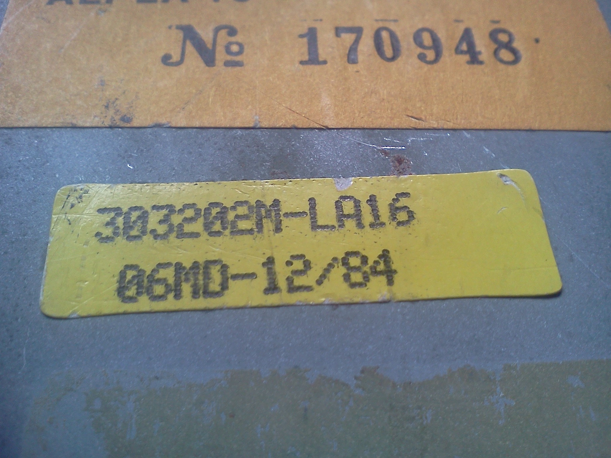

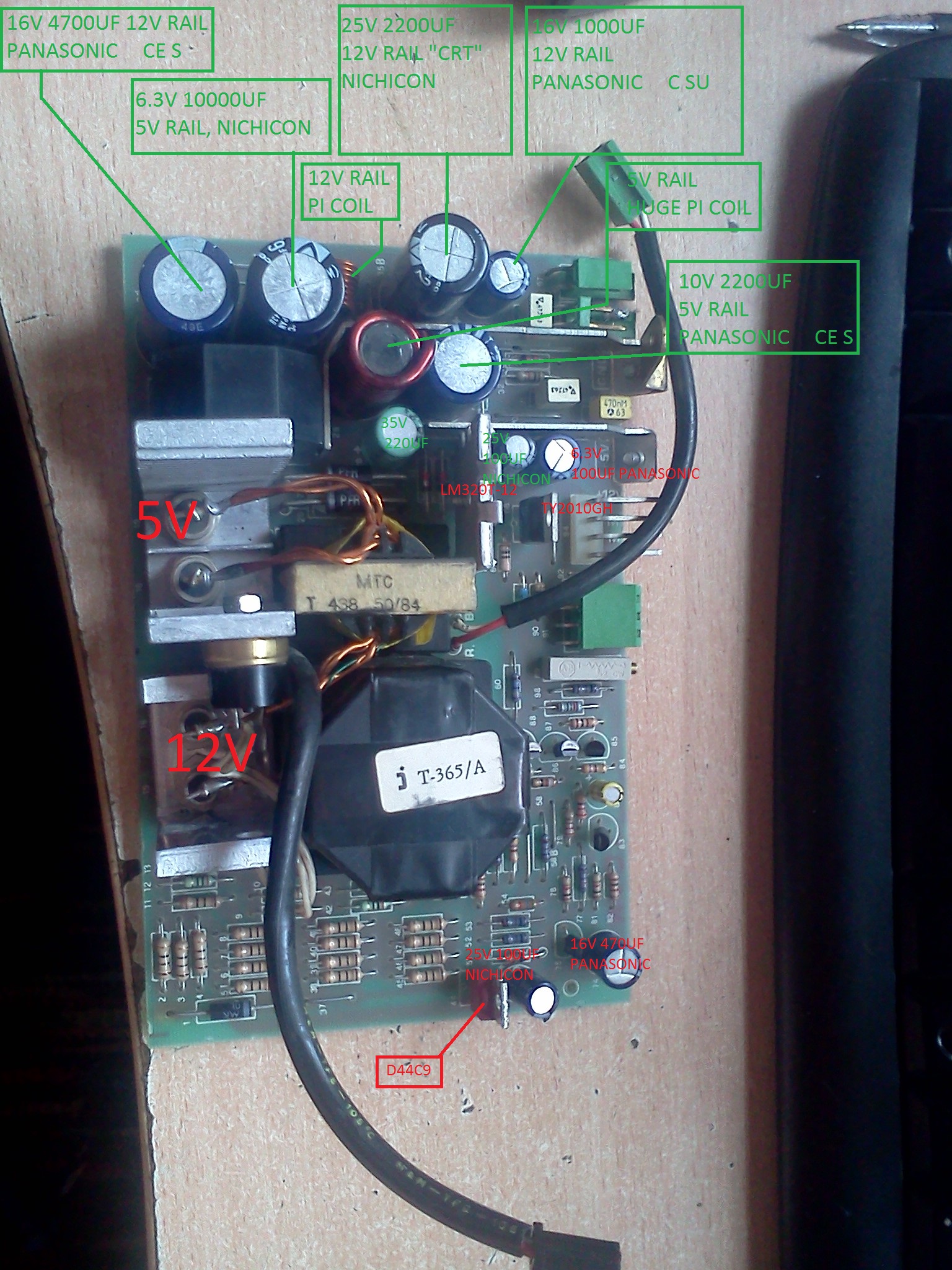

                              The guy I got it from said that if he remembers correctly then this is an Olivetti Intel 286 power supply. I have NO idea how much it is rated for, but the 12v rail was able to drive a Sony car stereo so that's a start, I guess... The 5v rail is crazy however, has a total of 12200uf of filtering on it and the 5v filter coil is just massive, about 10 AWG or so. Input caps are Panasonic200v 680uf. Should I scrap it for parts or keep it?

                                DJd, that P/S is nearly 29 years old. Unless you do hobby projects (or have friends who do) or can donate it to a school/university, it's ready for the recycler or a museum. Even if those electrolytic caps are in good shape despite their age, technologically they are ancient. Nichicon's oldest and least great low impedance series, the PS series (or PM series) should be better than the output caps on that P/S.
                                The DO-3 or DO-4 stud rectifiers should be OK, but the package style is hardly used anymore. You'd have to custom fabricate heatsinks to be able to use them.
                                If the input caps are still OK, they could be usable, assuming they have standard snap-in leads. But modern series will use the same size package for 1000uF-1500uF, if not higher.
                                I'd be worried about the X caps and Y caps, though you could probably test them for leakage if you have access to a 200-400VDC source.
                                So, as for parting it out, the input rectifiers might be worth keeping, as might lower current output rectifiers. The inlets and switch should be OK. If the switch device(s) is an MJE13007, MJE13009 or equivalent, it/they may be worth keeping. If the PWM is of the SG3524 or TL494 type, it's worth keeping. ICs of the LM320, LM340, uA78xx, uA79xx LM10, LM358, LM392, LM393, LM324, LM339, TL430, or TL431 type are worth keeping.

                                    The switchers are some Motorola T436.

                                      I'm not familiar with such a part from Motorola. I''m familiar with a lot of Motorola P/N prefixes - e.g. MJE, MJ, 1N & 2N (JEDEC), MM, MTP - but "T436" doesn't fit any numbering scheme I'm familiar with.

                                        The second number on the silicon is BUS47P. That is all that is on there. I think i am going to keep some of the caps and stuff from it because I don't really have any uses for it.

                                          BUS47P is the part number. It's an NPN transistor of Mot's Switchmode II series. "P" means it's a plastic package rather that TO-3. You should be able to find a datasheet online.
