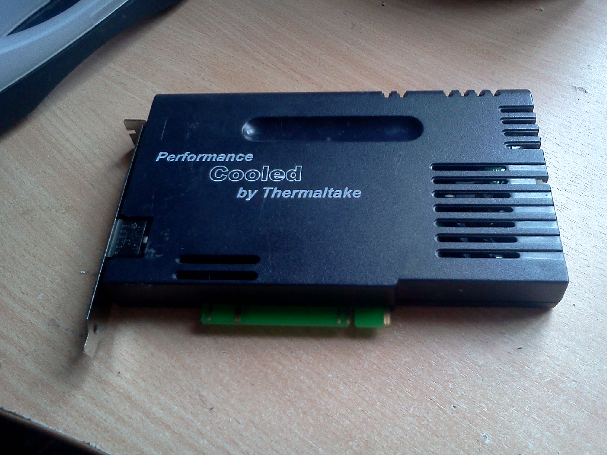

              Not an ATX power supply exactly, but i thought i'd still post it. It's a Thermaltake ActiveCool AC4GT, the power supply and controller for the AC4G peltier cooling system. It takes input from the mains and outputs probably 12v or so. Output is one molex and an 8 pin jack that looks like an 8pin pci-e or CPU power. All capacitors are Nichicon and SamXon, both high quality parts. Switchers are both SB20100. The fan is a UnitedPRO 5v 0.15a and it looks like it's powered from the pci bus 5v output, so this thing has no 5v "rail" on it. The other silicon device is a TOP249Y. Anyone have any idea what to do with it? I don't have the rest of this cooling system, only the controller card. Maybe it can be converted into a power supply to power extra cards and HDDs? If nobody has any ideas then i'm just going to part it out.
                [ATTACH]62012[/ATTACH]
                [ATTACH]62013[/ATTACH]
                [ATTACH]62014[/ATTACH]
                Nice, never seen one of those before.
                The switcher heatsink is out in the open, I hope it is grounded!
                I assume you could do some back tracking on the secondary side and get it to run as a standalone psu.

                  I tried, but it won't turn on unless it gets a command from the pc, and shorting on off pins wont help. It's an interesting piece of kit, but since it is pretty useless i just parted it out. I know a guy who has more of them, all i need to do is ask And the switchers heatsink was not grounded, they even put plastic washers between the switcher and the screw.

                    Making yourself a peltier cooler isn't an option?

                      #1350
                      Don't have a peltier, and i already have a good cooler. Plus, i don't think the card worked, at least i got nothing out of it, and i couldn't bother fixing it.
