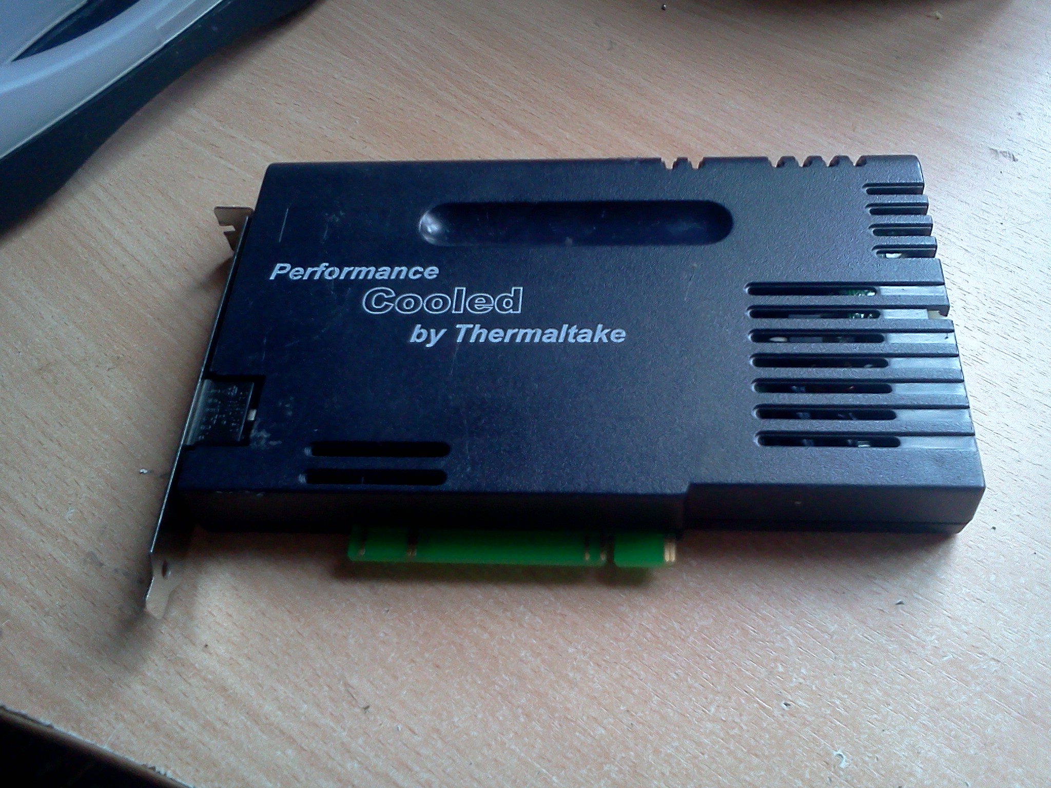

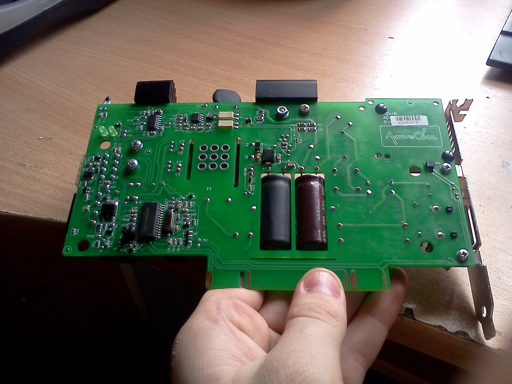

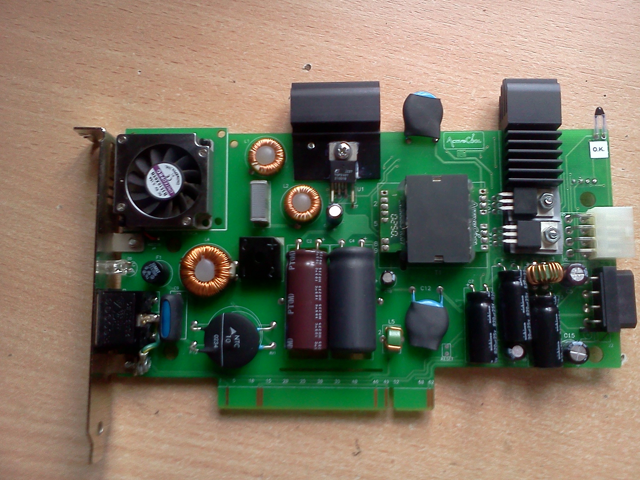

              Not an ATX power supply exactly, but i thought i'd still post it. It's a Thermaltake ActiveCool AC4GT, the power supply and controller for the AC4G peltier cooling system. It takes input from the mains and outputs probably 12v or so. Output is one molex and an 8 pin jack that looks like an 8pin pci-e or CPU power. All capacitors are Nichicon and SamXon, both high quality parts. Switchers are both SB20100. The fan is a UnitedPRO 5v 0.15a and it looks like it's powered from the pci bus 5v output, so this thing has no 5v "rail" on it. The other silicon device is a TOP249Y. Anyone have any idea what to do with it? I don't have the rest of this cooling system, only the controller card. Maybe it can be converted into a power supply to power extra cards and HDDs? If nobody has any ideas then i'm just going to part it out.
              I can put text here?!
              • ben7
                Capaholic
                • Jan 2011
                • 4059
                #1347
                Nice, never seen one of those before.
                The switcher heatsink is out in the open, I hope it is grounded!
                I assume you could do some back tracking on the secondary side and get it to run as a standalone psu.
                Muh-soggy-knee
                • DJduck
                  • Dec 2012
                  • 229
                  • Estonia
                  #1348
                  I tried, but it won't turn on unless it gets a command from the pc, and shorting on off pins wont help. It's an interesting piece of kit, but since it is pretty useless i just parted it out. I know a guy who has more of them, all i need to do is ask And the switchers heatsink was not grounded, they even put plastic washers between the switcher and the screw.

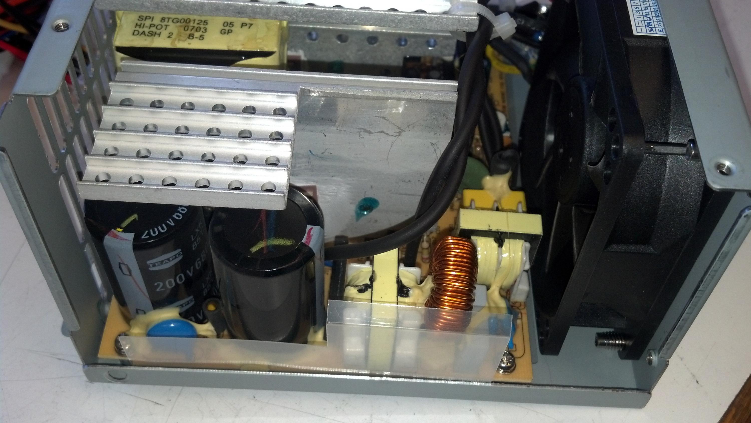

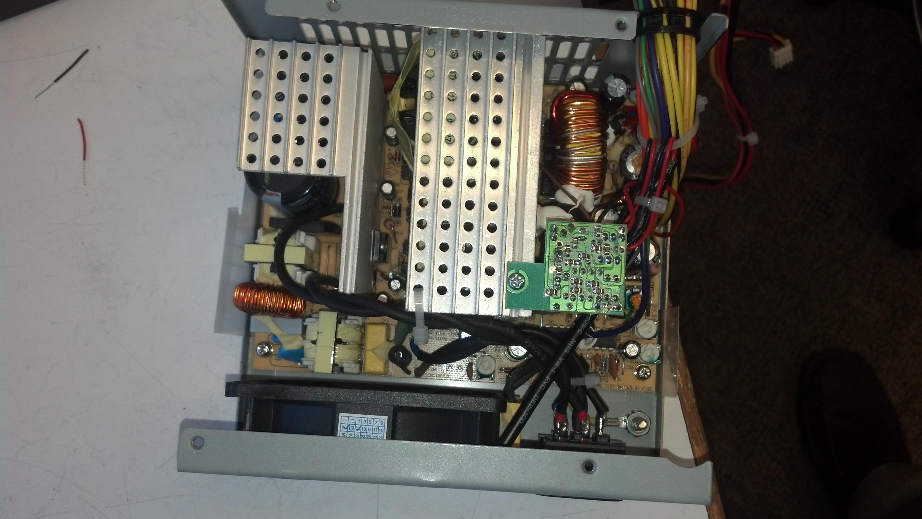

                        #1351

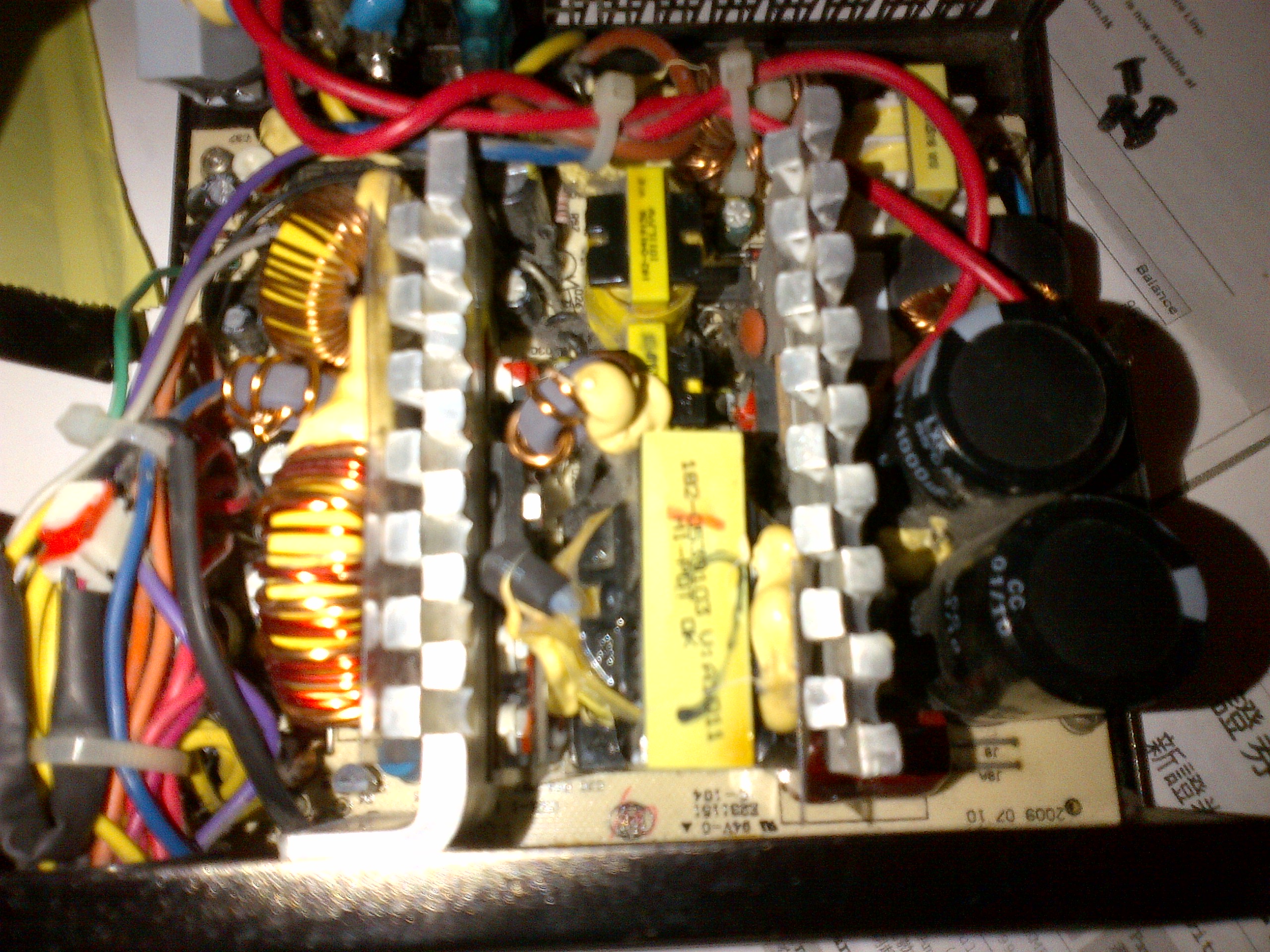

                        I picked up this Huntkey GS-LW-6550HG for about US$10. It says peak power of 550W on the label. How does it look? The capacitors on the secondary (Fcon and KSC) are hidden under those cables. I am worried that this may severely restrict the airflow from the fan onto the caps. Should I try to re-route those cables?
                        • DJduck
                          • Dec 2012
                          • 229
                          • Estonia
                          #1352
                          Not 650w. Not even 550w. I'd say 400 max.
                          • Pentium4
                            CapXon Be Gone
                            • Sep 2011
                            • 3741
                            #1353
                            It could probably do 400W with good cooling but I wouldn't want to push it past that. What are the specs on the label?
                            • mariushm
                              • May 2011
                              • 3799
                              #1354
                              Stable and good at 330w (85% efficiency there) , fails ripple and noise at 420w , blows up at more than that.
                              Review here: http://www.hardwaresecrets.com/artic...y-Review/668/1
                              So if you have a simple computer, with just one video card and a couple of hard drives, than that system's load won't be more than 200watts or so and this psu would be good. It would be then worth replacing a few capacitors.
                              For biggers systems, just no.

                                #1355
                                That's a Huntkey, which compared to the truly gutless wonders seen in the gutless PSU thread is a decent power supply. Note that Hardware Secrets test their PSUs at 45*C-50*C room temperature.... unlikely that your room temperature will always be that hot if ever. As for the wires covering the capacitors, that PSU has an 140mm fan so it shouldn't be starved of airflow that much... it looks like it would be quite a decent PSU after a recap (note that it does use 20 gauge wires to some extent). As the review says, it has two 20A parts in parallel for the +12V rail and a 40A part for the +3.3V and +5V rails (looks like it has decent inductors, coils, and x2 2200uF capacitors per rail for the three major ones)... it has a 39 size transformer as well and 1000uF x2 in the voltage doubler (or 500uF, 400V). I'm sure it could handle your computer and I'm sure it would do 425W just fine so long as you don't push it past that. Based on the review, my guess is that it would be 80% efficient or slightly higher at 70% of its "peak" load or below, which isn't bad. It's unlikely your computer will ever reach a 400W load anyway.

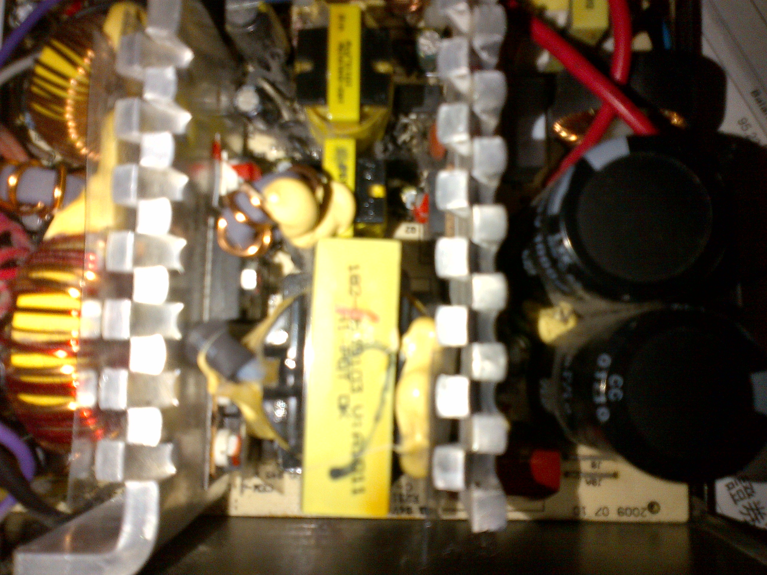

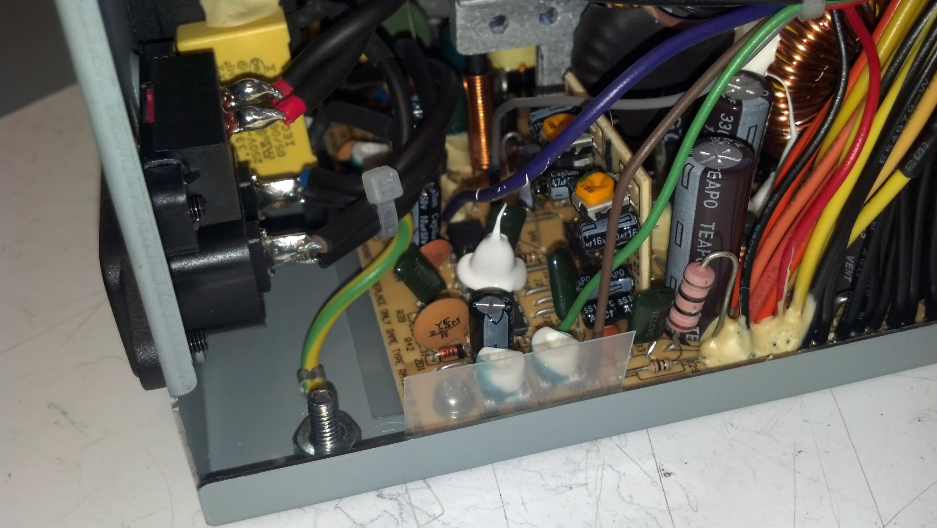

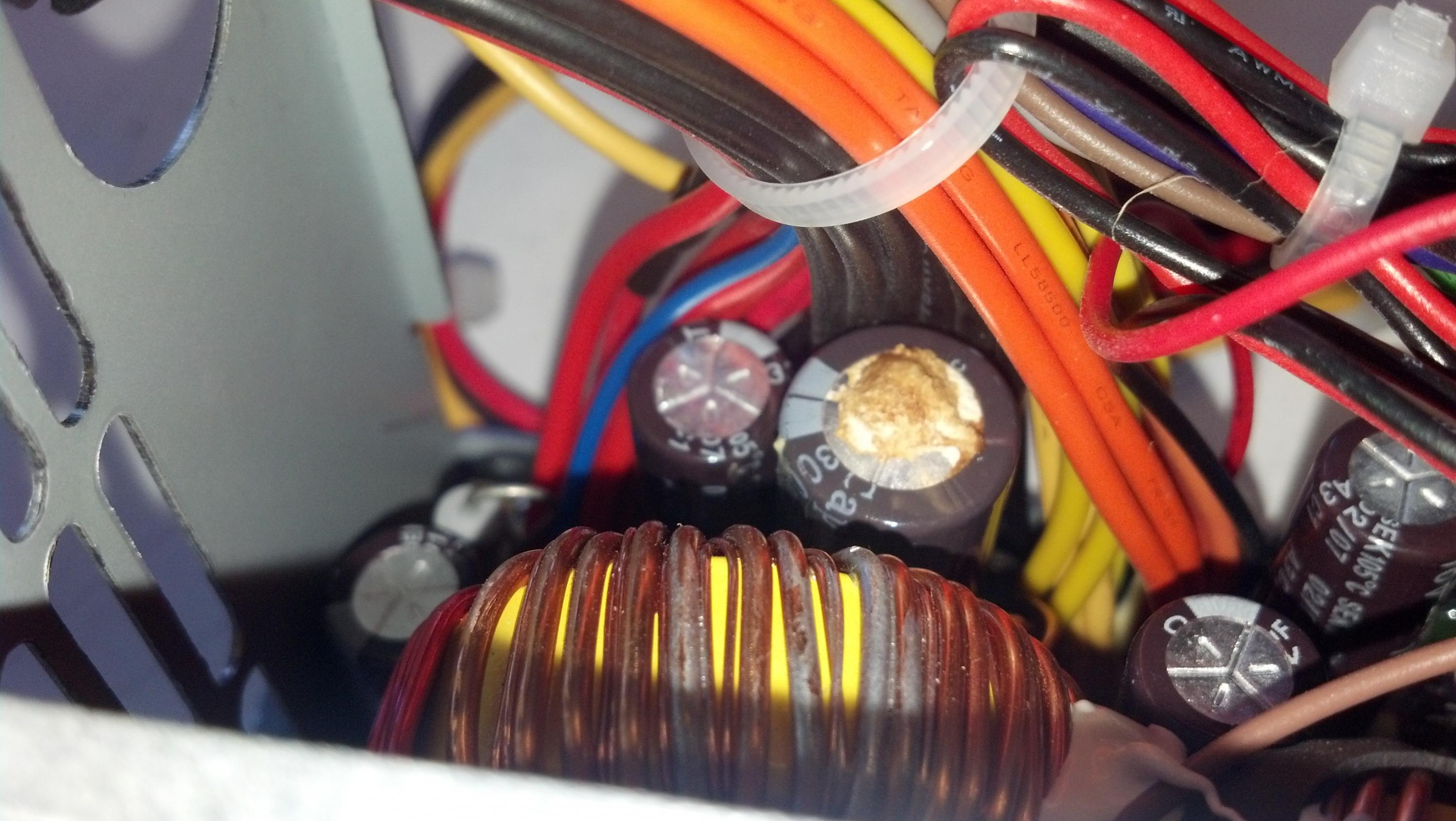

                                  #1356
                                  I really like this power supply....I think it is overbuilt considering the label and I like that
                                  Input has 3 X caps, 3 coils, 3 Y caps, 2 MOV's, GBU606 rectifier, 680uF Teapo caps
                                  13009 switchers, unfortunately I can't see the specs of the 5VSB transistor. transformer is huge for a 300W! Looks like size 39
                                  Secondary silicon has 30A schottky for the minor rails, and two 20A schottky's for the 12V, all parts made by ST. And looks like it uses DC-DC conversion? All the caps are Teapo and CapXon, as you can see that 3300uF 16V CapXon cap on the 12V is leaking a little It has a ball bearing Adda fan. Definitely going to recap this when I have some time
                                  • Wester547
                                    • Nov 2011
                                    • 1269
                                    • USA.
                                    #1357
                                    I believe I see a second toroidal coil on the secondary but there should be a third toroid to complete the mag-amp circuit, so I don't think it uses DC-DC conversion. It looks like it will be a good unit after a recap... I hope that isn't a two-transistor forward +5VSB circuit it has or that with self-oscillating feedback.

                                      #1358
                                      It's not two transistor forward, it looks like it has a little optocoupler down there
                                        #1359
                                        2-transistor uses an optocoupler too.
                                        Generally if you don't see a little ~8 pin IC next to the standby switcher, it's probably a 2-transistor circuit. More so if you see tiny signal-rated poly film caps, that's a dead giveaway as you rarely see them in supplies using a controller IC.

                                          #1360
                                          Thanks for correcting me, still have a lot to learn. I don't know what it does for 5VSB then
