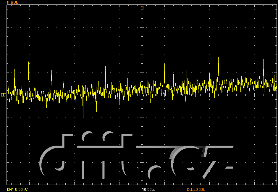

    Nothing like that. There is very mild wave-like ripple, but overall ripple is very good, as I stated. I would personally rather see 220+ uF just because of capability to withstand micro dropouts in the power network, but that's all. The talk in CM6805 datasheet seems to be legit as the PSUs results in both votlage control and ripple are very good for its price. You have to accept the fact technology is going further. I have been suspicious as well, but I checked and it works
    80 % load, +12 V
    100 % load, +12 V

          #1204
          If you only look at 10us/div you're never going to see 100Hz ripple.
          Set scope to 2ms/div (giving two or three cycles) and ideally use a line trigger.
          This is what 100/120Hz ripple on output looks like:
          Low ESR caps do not like 100/120Hz. Their ripple current ratings are typically halved at that frequency. In addition as the voltage variation is much greater over time the current through the cap (I = C dV/dt) is greater. So seeing that basically means: goodbye output caps, no matter how good or bad they are.
          I have seen plenty of SMPS fail like this, and it often takes out the output capacitors before it dies completely.

                #1207
                Originally posted by tom66
                I don't see that thing doing 450W for very long. Those heatsinks are not very big.
                The 180uF primary also means you'll likely see 100/120Hz ripple on the output near maximum loading. See it on a lot of PSUs with undersized primaries....
                It was to my knowledge that it is power supplies that use full wave rectification (half bridge, full bridge, and push pull topology) that output a ripple frequency (or switching frequency) that is double that of the mains (half wave rectification's ripple frequency is equal to that of the mains). In simple terms, this does two things: the higher switching frequency allows rectification inside the PSU to happen at a higher frequency which means more can be done, but this also means twice the ripple (much more EMI) going across the internals and out to the load/computer. The PSU in question looks to use single switch forward topology (half wave rectification, along with two switch forward and flyback topologies, though flyback is terribly inefficient to begin with) so I'm not sure that it would have this problem (it is usually 100/120Hz ripple and not 50/60Hz ripple that causes AC line drop outs, unusual noise, and voltage regulation issues, 50/60Hz noise, etc), though APFC primaries are more stressed than non-APFC primaries and the lower switching frequency does undercut what they can handle a might bit. The PSU also might be able to get away with it with having the fan rev up to a much higher speed when the load/temperature increases. Actually, this, in non-APFC PSUs, is what passive PFC is there to facilitate and almost do away with problem wise as a 50/60Hz filter/inductor. That said, good PSUs will use APFC caps whose microfarad rating is within at least 33% range to the output watts~microfarad ratio. It also looks like the main transformer in the above PSU has some good windings or transformer taps.

                  #1208
                  Originally posted by Behemot
                  It has active PFC, is that even possible to get such oscillogram with active PFC? It should inject the capacitor with pulses around 400 V, the cap should never see power grid frequency ripple.
                  It'd be great if that were the case but it's not. Ripple across that is typically 20~30Vp-p under light loading. Beyond about 50Vp-p the SMPS controller may start encountering issues with regulating the output.
                  The active PFC keeps current/voltage in a nearly resistive ratio. To do this means you'll have ripple across the main cap. No free lunch. A very good PFC controller can minimise this ripple. From what I have found, Quasi-PFC supplies, with typically 0.9-0.95 PF, can manage with smaller primary caps.

                    #1209
                    This thing managed PF of 0,97 starting with 20 % load and moved to 1 at 40 %, where it remained till the maximum load. So I think there really IS something about the CM6806+CM03X combo. As I already said, it explicitly states it has advanced driving which can work with weaker silicon and smaller input cap. Go on, check the datasheet for yourself.

                        #1211
                        Get an isolating transformer and measure the ripple if you want. You'll find there is a considerable 100/120Hz component. I highly doubt a PF of 1.0, because that's perfect, and even the best PFC frontend could only really reach 0.995~0.999 under ideal conditions. Quasi PFC is fine, too. It's a low cost solution and it's absolutely fine to have a PF of "only" 0.9. This isn't some competition to get the highest PF and you aren't paying for it, so why does it matter?

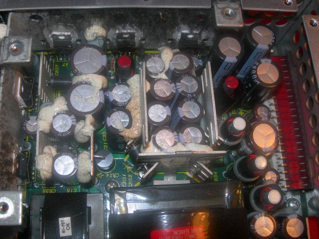

                                      #1218
                                      Then you have not seen this.
                                      HP 54501A oscilloscope power supply.
                                      All Chemicon capacitors.
                                      ~20000uF on the 3.3V digital supply.
                                      ~8000uF on the 15V CRT+fan supply.
                                      After 18 years, I had to fix a cold joint on the power connector for the -12V analog rail (it had been hand reworked), the trace was going crazy and scope was randomly resetting. That was all; all the caps were still fine.
