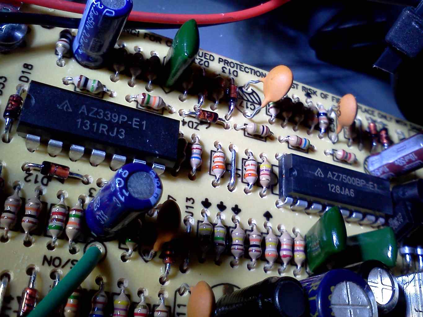

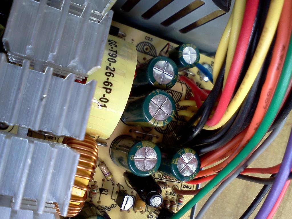

                                        Acteck/Edge Systems AFB500-P 500W
                                        Primary caps-------2x 560uf/200v
                                        5VSB Switcher-----2N60
                                        Primary Switchers --2x JME13007
                                        12V Rectifier-------Mospec F12C20
                                        5V Rectifier--------Mospec S16C45
                                        3.3V Rectifier------Mospec S10C45
                                        5VSB caps----------2x 470uf/10v
                                        12V caps-----------1000uf/16V
                                        -12V caps----------470uf/16V
                                        5V caps------------1000uf/10V
                                        3.3V caps----------2X 1000uf/10V
                                        Well there's not so much to tell about this POS except that this thing actually shutdowns and don't explode when overloaded or shorted, all caps are ChengX and sadly the market in my country is flooded by this lousy brand/type of PSUs, in fact it is the most used in generic PCs, altough not by me.
                                        It looks to me like a 180W-200W PSU but what do you think ?
                                        • Behemot
                                          • 4845
                                          • CZ
                                          #1260
                                          With some modifications it may do 350 W quite fine, 400 W max.
                                          At what power does it shut down?
