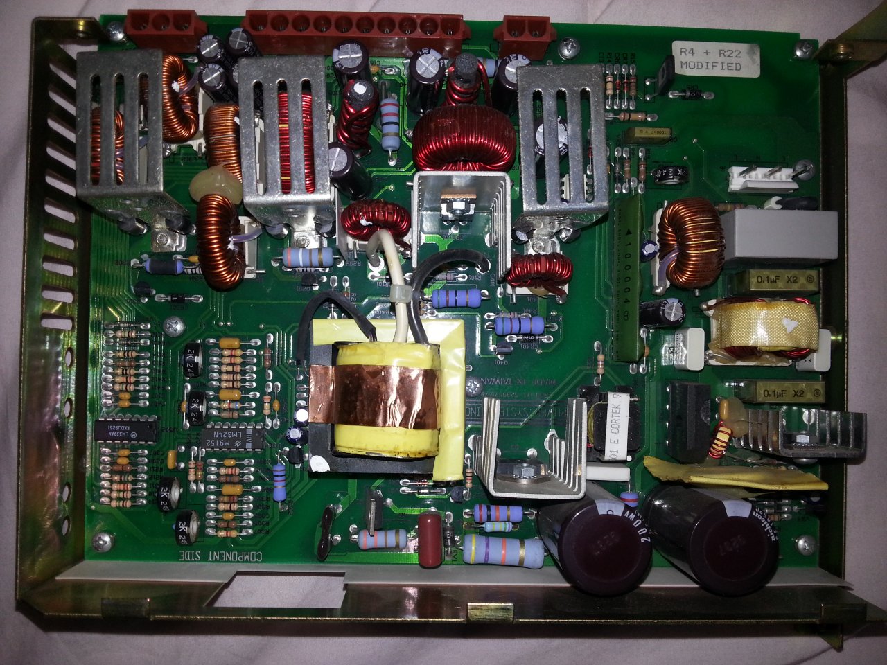

Power Systems PS-1715 from LeCroy 93xx scope
470uF 200V Nichicon GF x2 prinary side units.
820uF 6.3V Nichicon PF for soft starting.
2200uF 6.3V Nichicon PL before and after +5.2V (6A) and -5.2V (8A) output inductors.
220uF 35V Nichicon PL before and after +15V (4.5A) and -15V (4.5A) output inductors.
1000uF 25V Nichicon PF at 15V fan output.
UF5402 x2 (in common cathode configuration) each for +15V and -15V rails.
SB540 x2 (in common cathode configuration) for -5.2V rail.
20CTQ040 for +5.2V rail.
MAC228A AC adaptation TRIAC with MJE13003 driver.
MJH16006A primary switcher with BUK454-800B auxiliary switcher.
KBU6J primary rectifier.
Even the monitor section (made in Taiwan) used quality Japanese electrolytics.My first choice in quality Japanese electrolytics is Nippon Chemi-Con, which has been in business since 1931... the quality of electronics is dependent on the quality of the electrolytics.Comment

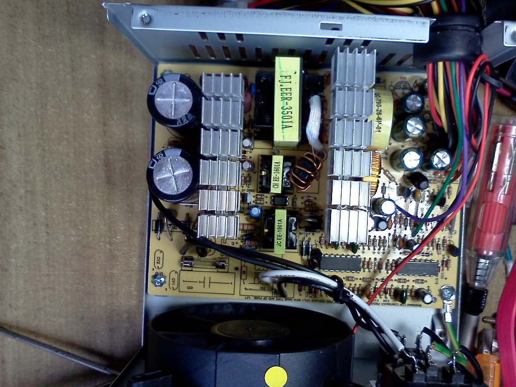

Acteck/Edge Systems AFB500-P 500W
Primary caps-------2x 560uf/200v
5VSB Switcher-----2N60
Primary Switchers --2x JME13007
12V Rectifier-------Mospec F12C20
5V Rectifier--------Mospec S16C45
3.3V Rectifier------Mospec S10C45
5VSB caps----------2x 470uf/10v
12V caps-----------1000uf/16V
-12V caps----------470uf/16V
5V caps------------1000uf/10V
3.3V caps----------2X 1000uf/10V
Well there's not so much to tell about this POS except that this thing actually shutdowns and don't explode when overloaded or shorted, all caps are ChengX and sadly the market in my country is flooded by this lousy brand/type of PSUs, in fact it is the most used in generic PCs, altough not by me.
It looks to me like a 180W-200W PSU but what do you think ?Comment
With some modifications it may do 350 W quite fine, 400 W max.
