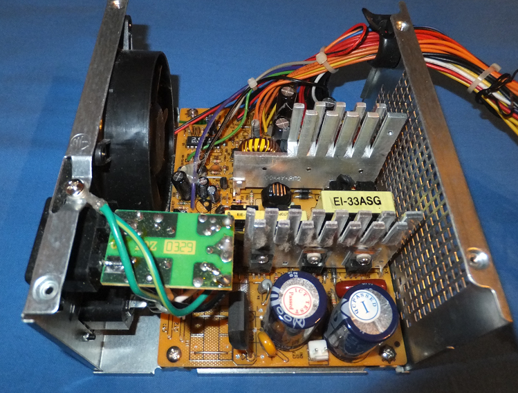

    I actually ended up getting the same PSU that kc8adu got
    https://www.badcaps.net/forum/showpo...&postcount=237 except even cheaper (it's missing the input filter line choke!). I assume the one in the picture was "taken care of..."
    I initially assumed it was actually dead (because it had been opened - it was missing its cover) when I got it intending to see if I can rootcause the problem... but no, it still seems to work! But there's no way in #### that this can do 400W. 150W maybe? Any guesses?
    This is a UC3843 design, single transistor. The 2-transistor 5VSB has a TO126 13003 transistor I think, probably this can do no more than 100mA maybe on 5VSB...
    I measured around 50mV of noise eyeballing it on my analog scope, about 12.2V and 5.2V with a small load (3W on 12V rail, 2.5W on 5V)...

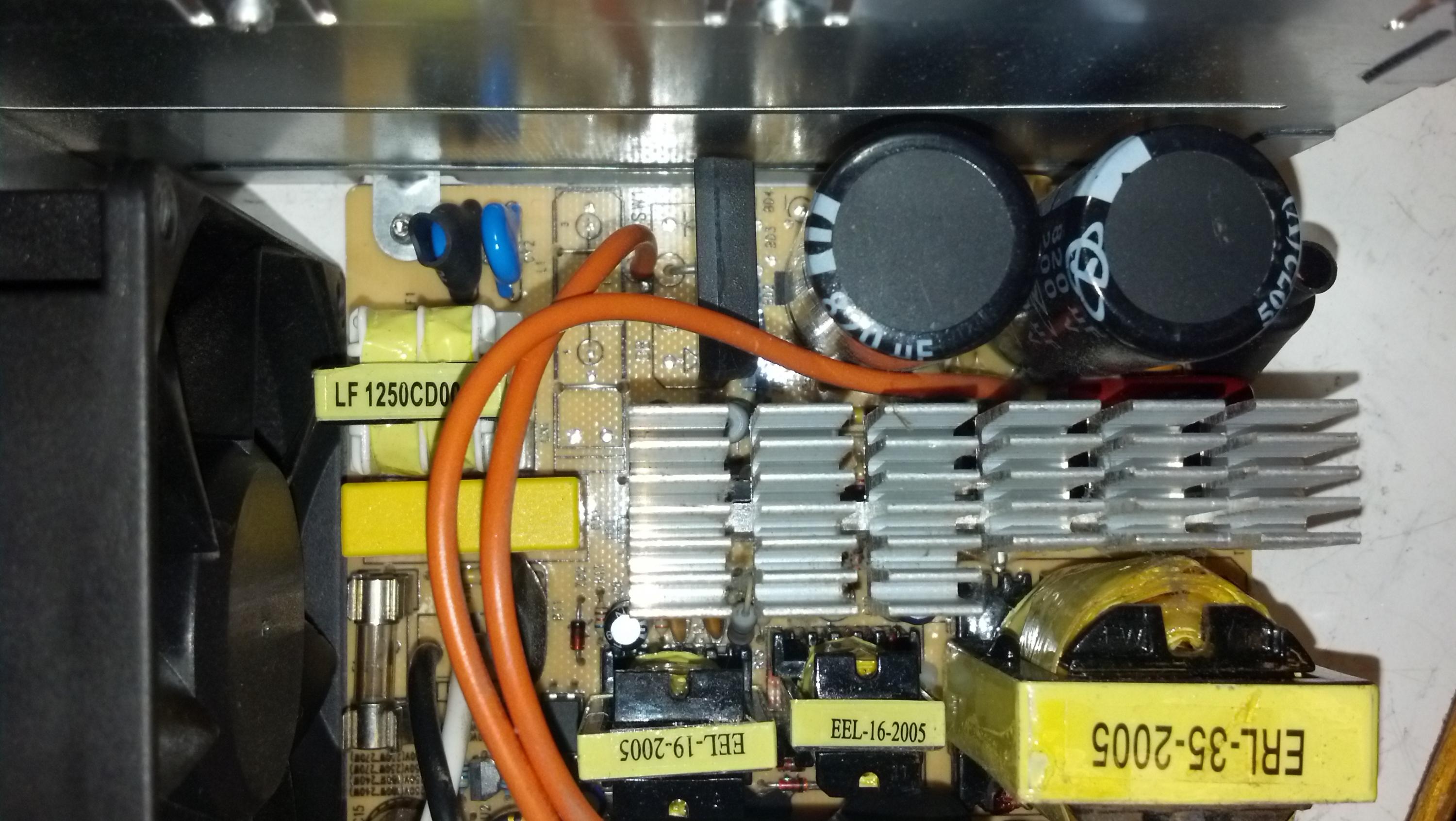

            Fake PFC coil detected? Would you mind tearing the PFC apart? I bet the blue wire is just tucked behind the tape

              Whoa! PFC 2000!!!! It must be good!!!! And I'm sure those input caps are 330, I will show proof later!
              This Allied is just like the one from the Jonny's review, although a little older. The only difference is they used YC/HEC caps instead of Asia X and the fans are sleeve bearing Sunon instead of sleeve bearing Globe Fans. I think it's worth recapping. Since the MOSFETs blew around 375W on Jonny's, what kind do you think it would need to be able to do more wattage? Although I don't know if the transformer could handle any more than that
              • Behemot
                • 4845
                • CZ
                #1107
                I can't see the PFC, show
                If the transistors didn't blow up because of something else, than whatever you will put into it, it will blow because of core saturation past 400 W. I think this can be made safe and stable for 350 W.

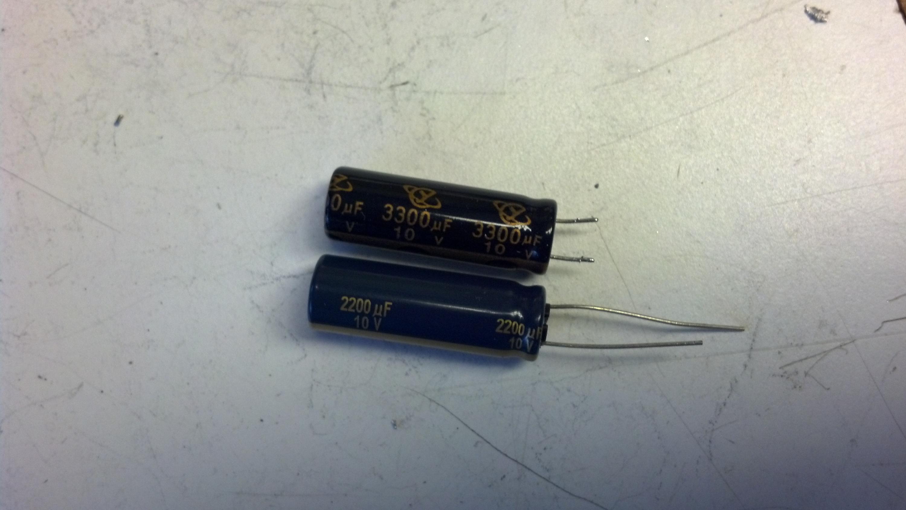

                      I can't find the datasheets and I don't have 3300uF 10V caps in this size that will fit under that secondary heatsink. You think this Panny cap matches ripple? They're the same dimensions
                      • mariushm
                        • May 2011
                        • 3799
                        #1111
                        Those YC capacitors are actually pretty good when it comes to Chinese crap capacitors.
                        If they're kept cool, the specs are quite OK. If they overheat, they puke their electrolyte.
                        Their ESR is probably below 0.15 ohm
                        • Pentium4
                          CapXon Be Gone
                          • Sep 2011
                          • 3741
                          #1112
                          That one is bulged but the only one on the secondary that wasn't bulged, which was a 3300uF 10V cap, measured 3377uF and 0.02 ESR. I was impressed. That Panasonic has the same ESR but I'm just wondering if you think that ripple will be on par with the YC
                          • Behemot
                            • 4845
                            • CZ
                            #1113
                            If I am not mistaken, ripple is voltage across ESR so if they have the same ESR, they have the same ripple

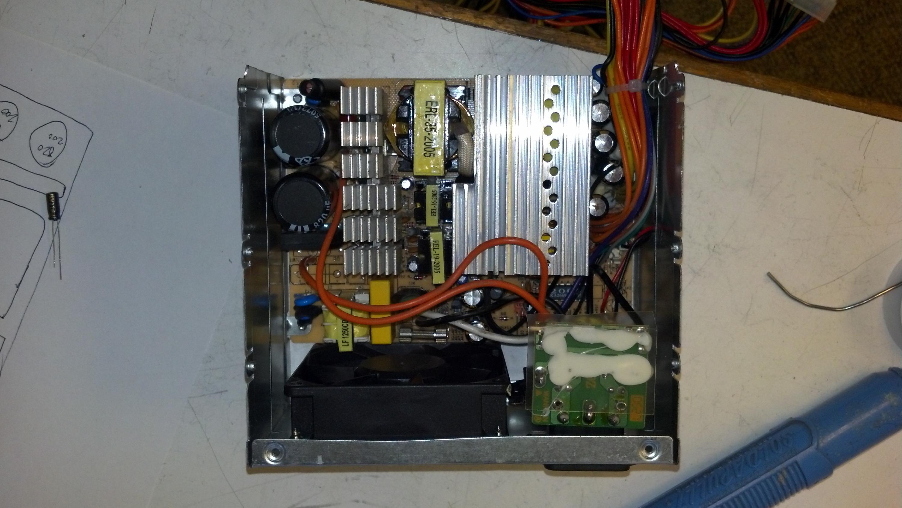

                                SON OF A BITCH! I forgot to put the plastic cover on the bottom and the thing shorted out and popped the fuse when I flipped the switch BUT it was still pulling 4W on my kill-a-watt afterwards, is it possible that it's still alive? And I just want to make sure, I have noted on the picture, on the AC in Black wire, the joint connects to the same one as the fuse, was that a mistake on my part and what caused the fuse to pop or was it the short from the leads touching the case?
                                • Behemot
                                  • 4845
                                  • CZ
                                  #1116
                                  Black is used for phase here so I guess white is neutral. But have a look, if there is daughterboard for filtration, it tends to be marked on both ends, so check if you have N going to N and L to L.
                                  Seems no major damage was done so probably it just got shorted to case. Check all the nearby transistors and diodes if they are not blown up. In my case when cap discharged to ground through case several years ago, it blown up half of the +5 V SB circuitry including wiring on transformer, so I lost my nice 500W OEM Seasonic there…
                                  Now I somehow tend to cut all those long legs in there, even if there is plastic insulation under the PCB, and the more when there isn't.
