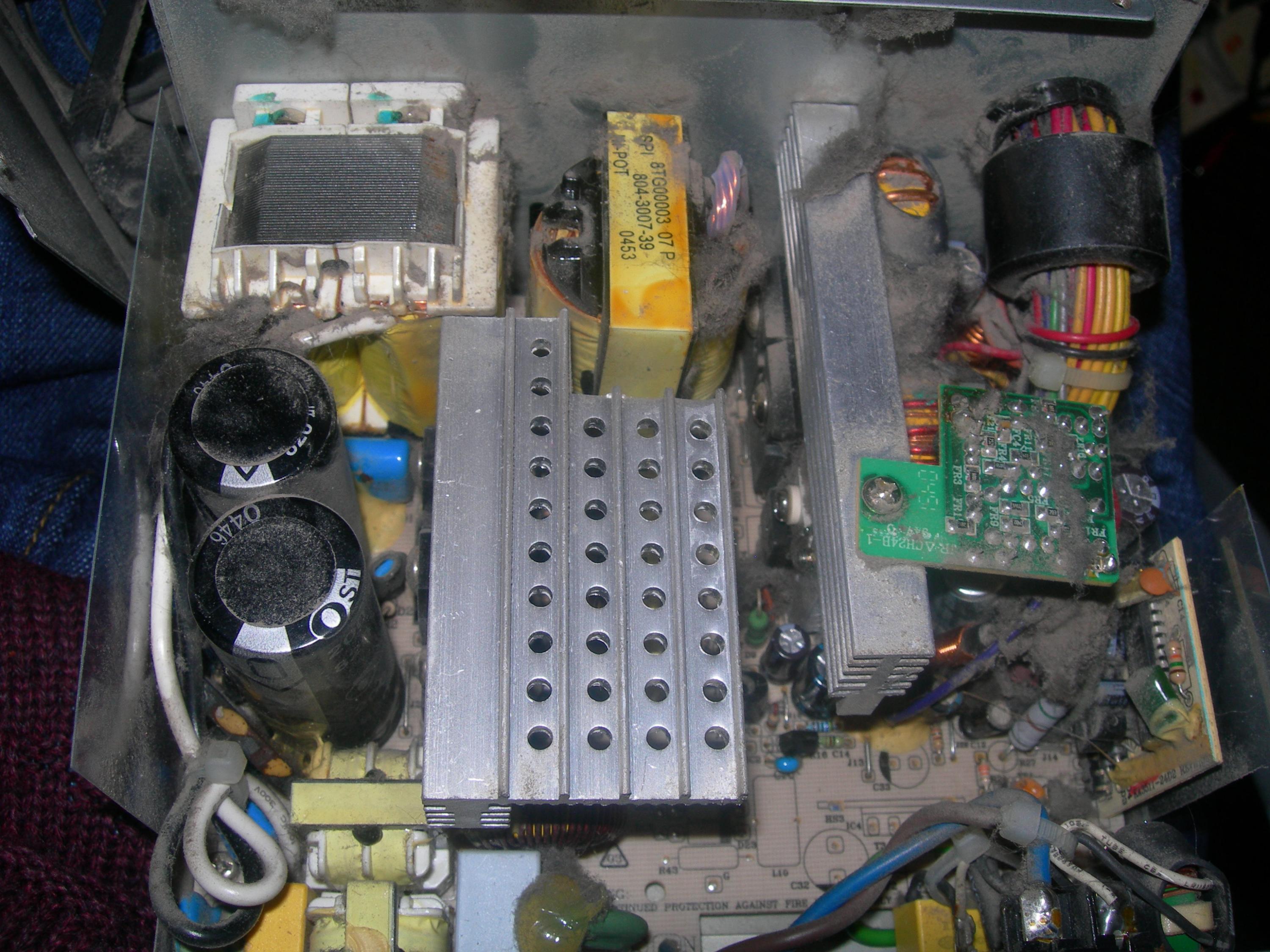

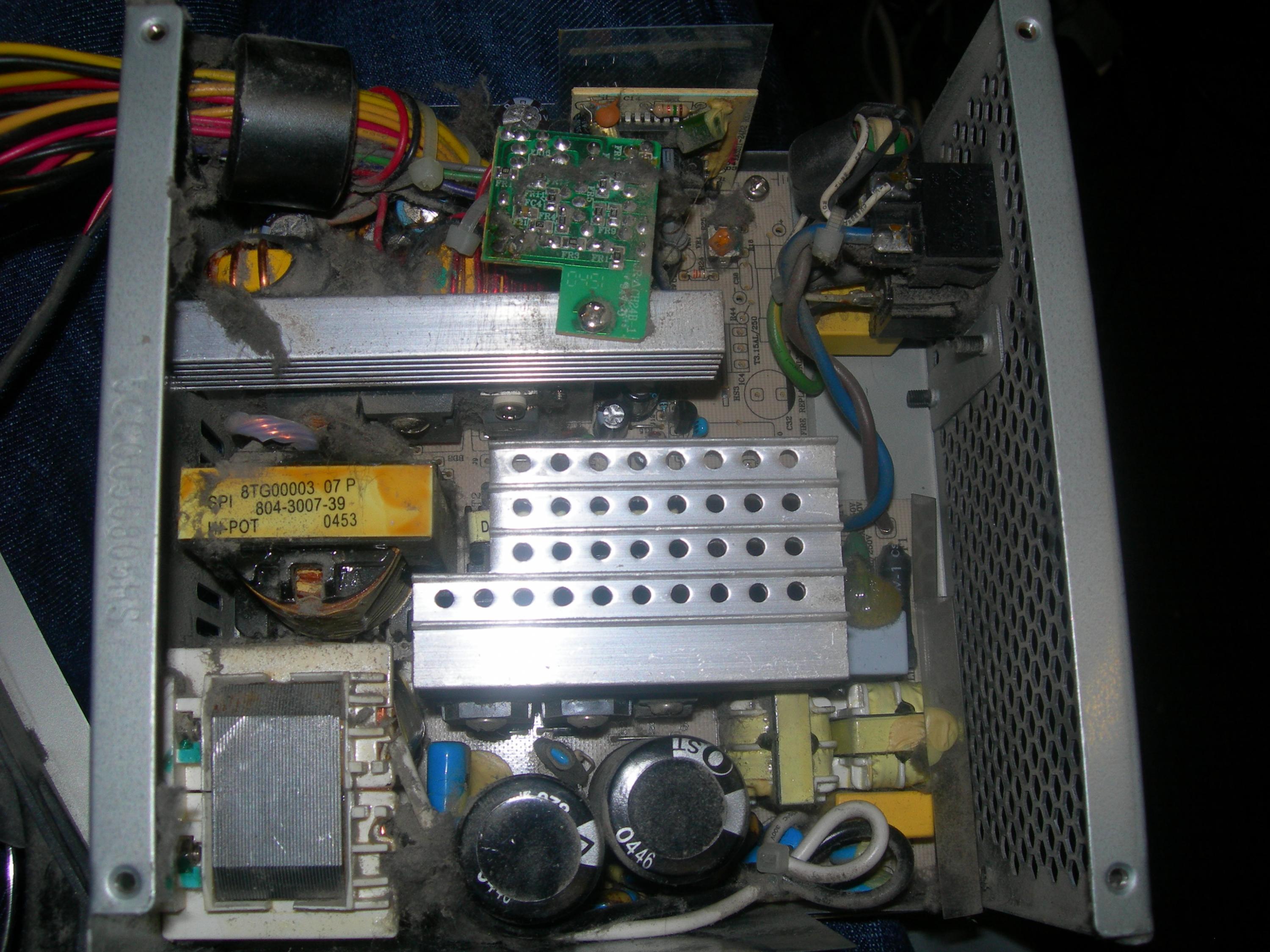

        FSP Group FORTON/SOURCE FSP350-60
        Got three PSUs today. I'll put them in separate posts.
        350W rated. 3.3V @ 28A, 5.0V @ 30A, 12V @ 19.5A, 5Vsb @ 2A.

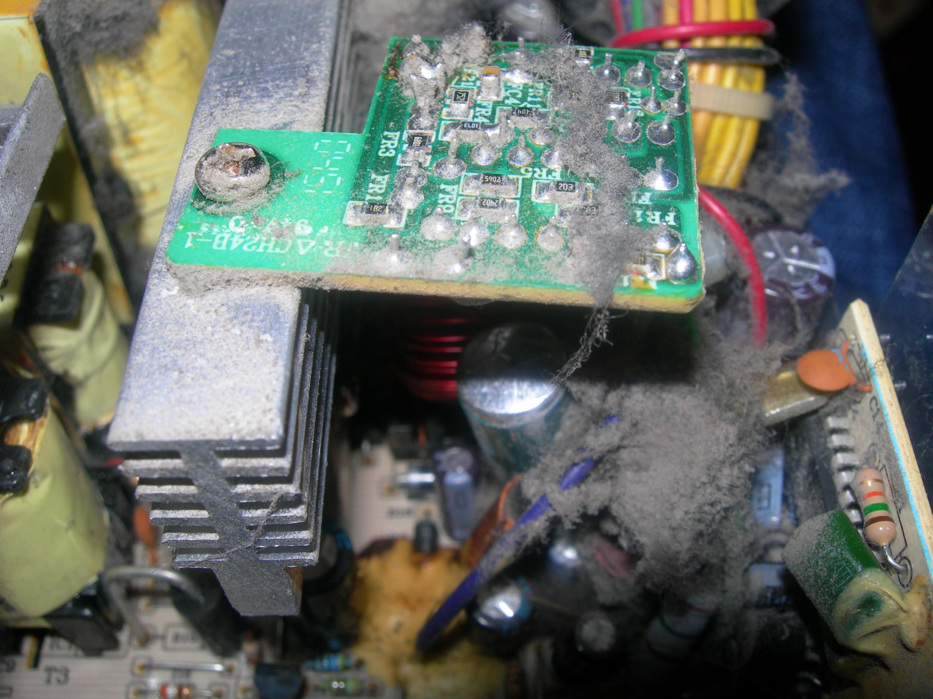

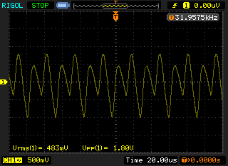

        This is a rather heavy, well built unit however it only intermittently powers up. Do you want to know why? It has one bulging Jamicon, and one bulging Teapo. When it does power up, the 12V ripple is just a tad high, at 1.8Vp-p (not a typo.) Amazingly, the 12V still measures 11.7V. The 5V ripple is fine and the 5V is a tad high at 5.22V (could be due to bad caps -- cross-loading?), but still close enough. It'll usually run for about a second, then die, or sometimes it will start and run fine after playing around with PSON enough.
        It uses passive PFC, which is not a bad idea (cheaper, lower component cost, generally higher efficiency, lower operating cost to customer), but the cap choices are quite poor -- Teapo, OST, Jamicon, etc.

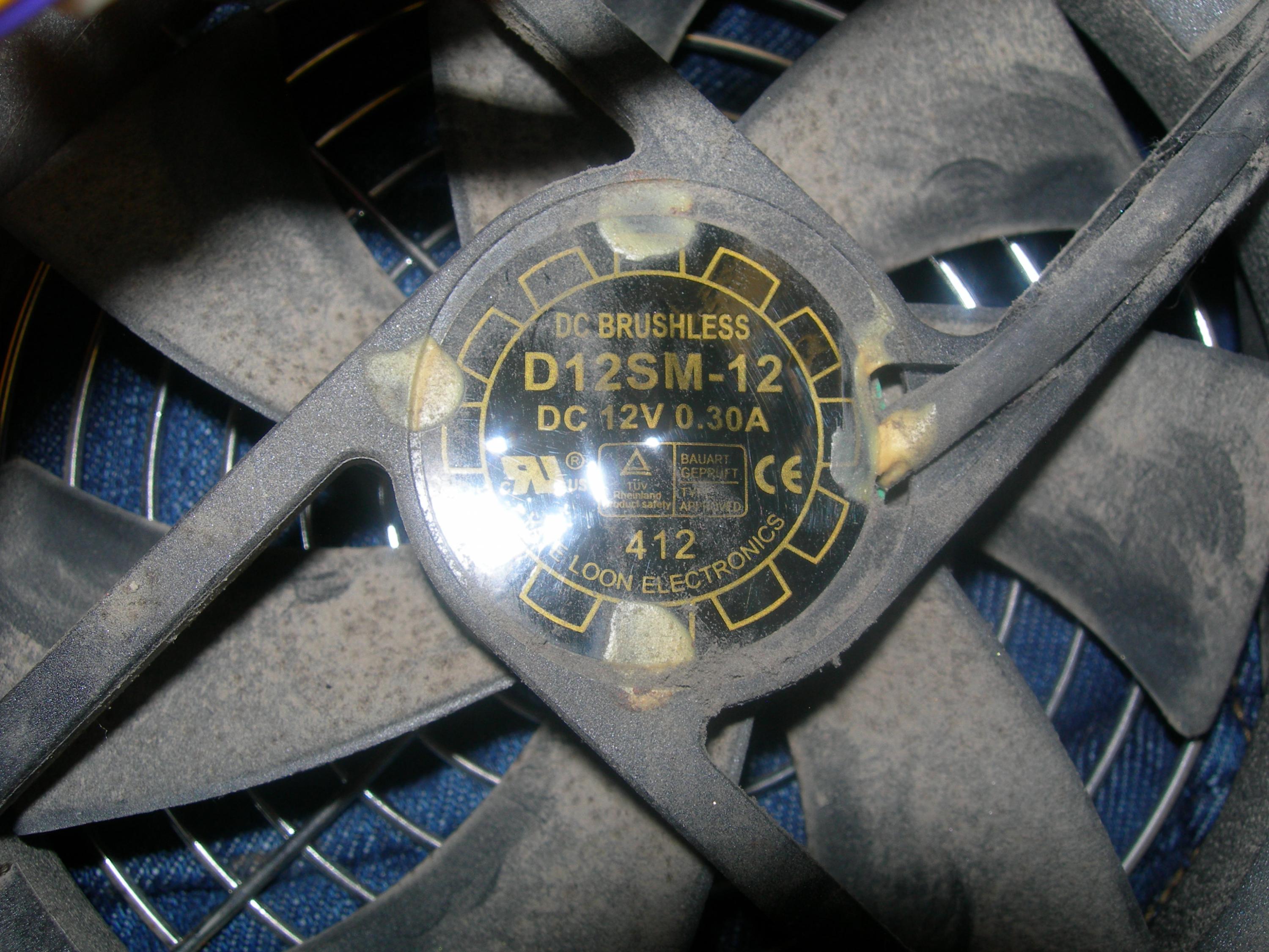

        It has a speed controlled Yate Loon fan. No idea if this is any good?
        Admittedly, I'd always somewhat considered Jamicon to be above-average general purpose caps, and OK if not abused too much, but I'm starting to regret that decision.
        First scope shot shows 12V on DC coupling, second shot is a closer look at 12V ripple, third shot is 5V startup (fine.)

          #984
          It is very common. Most - but not all - of the older versions with 80mm fan had good caps even after like 5 years when I got them. These new 12cm versions usually have bad caps after like 3-4 years and they do not start with load or even not at all. They are also more sensitive to small caps parameters. I think they are just trying to push maximum of that old platform (because it haven't really changed much for 8 years, probably more) - power and efficiency wise - so than it hase tighter mantinels and is sensitive to basically anything.
          After recap you still have pretty decent unit though.

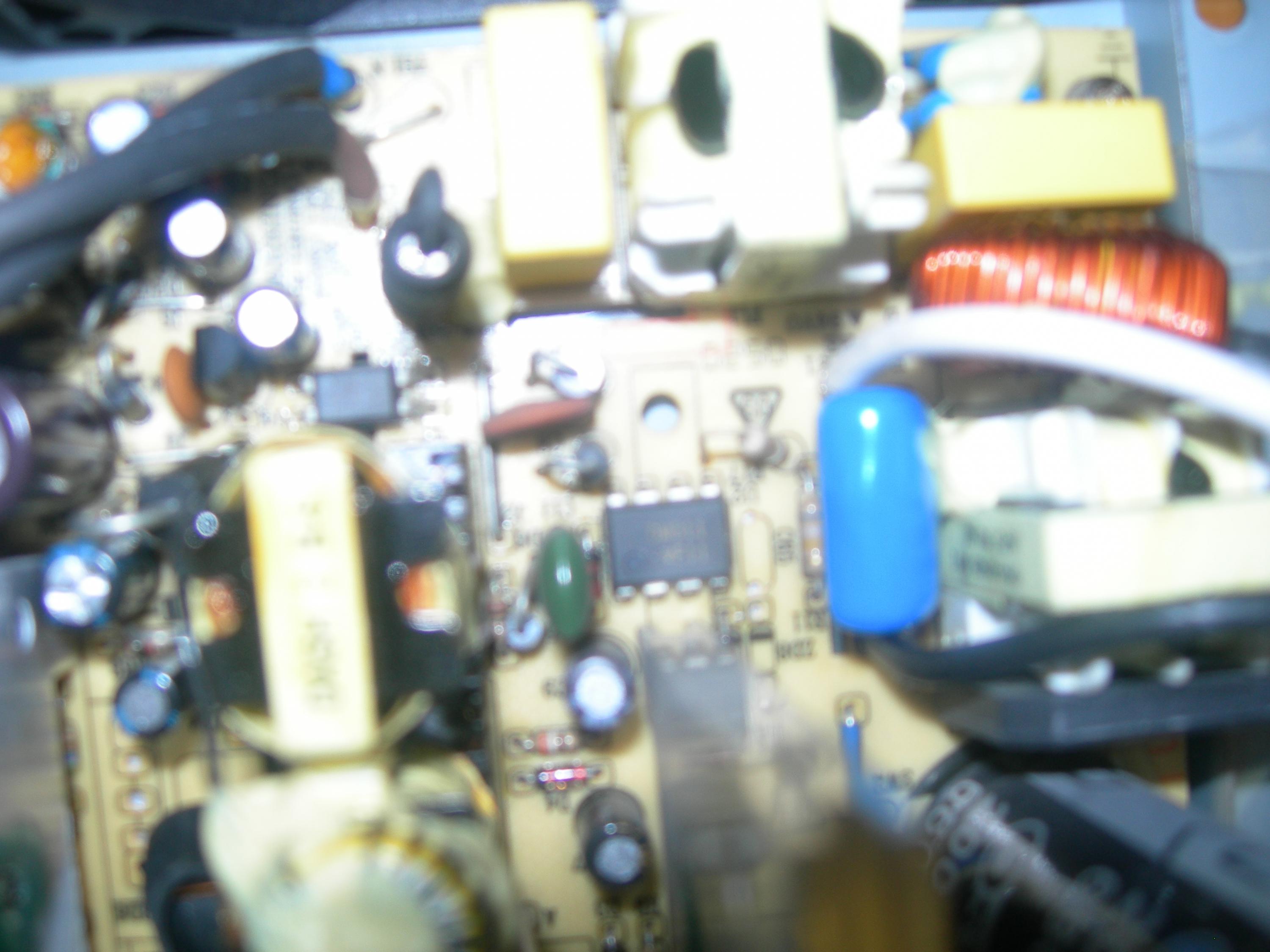

                FSP Group FSP300-60THA
                300W rated. 3.3V @ 20A, 5V @ 26A, 12V1 @ 8A, 12V2 @ 14A, 5Vsb @ 2A
                This unit appears to work perfectly, however, it is full of Teapo and one large CapXon. The primaries are OST. In general, the build quality is quite good. It is cooled using a single 80mm fan and uses passive PFC, like the other FSP PSU.
                No caps are bulging, and it does start, but I've not put it under any load yet. I don't have a sacrificial computer.
                Passive PFC inductor is bolted to the removable half of the case (on the 350W it was bolted to the non-removable half), and looks very similar to the 350W model.
                It also uses a fan speed controller but a newer updated version using an LM393 and lots of SMD. The controller in the 350W model used an LM358 and all through hole. It looks to be doing PWM speed control, a good solution.
                5th photo is supposed to show DM311 controller.
                Primaries are 680uF 200V. In the 350W model they were 820uF 200V. Note that output power in watts = ~1/2 capacitance in uF.

                  #988
                  Output power equals the capacitance directly! The two caps are in series, that means their total capacitance is 340 uF.
                  It's typical THA, THN, GLN and stuff. They got like dozen of versions, many of them OEM, but they shared more or less the same design. Than they upgraded it with 120mm fan and the rest you already know
