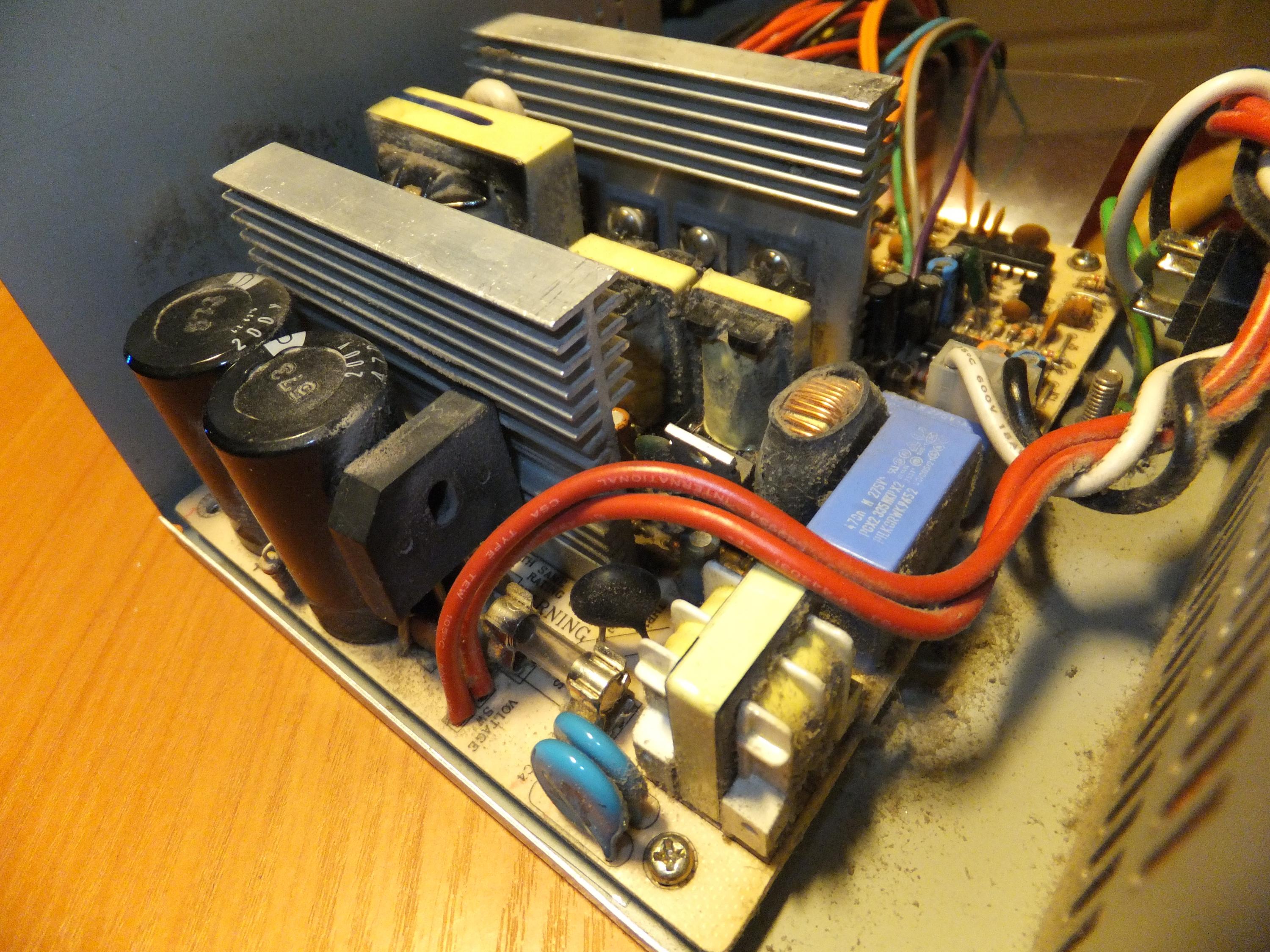

    Originally posted by Wester547
    The only thing of acceptable quality in that Allied PSU is probably the heatsinks and Pentium4's recap job. The heatsinks at least aren't finless. Other than that it looks of sheer tripe.
    Not to be redundant, but attached is a better look at the PSU I posted in May. These images aren't mine but images of the PSU found on a Google image search link. The PSU in question is a (RoHS compliant, from the logo on the label) Hipro 300W, or a HP-P3527F3. No PFC in this PSU and only 470uF/200V primary capacitors (Teapo @ 85C), with otherwise what looks to be a mingling of Teapo, (maybe) Su'scon, Ltec, and (maybe) G-Luxon capacitors. There's 32A on the 5V rail, 20A on the 3.3V rail, 16A on the 12V rail, 0.8A on the -12V rail, 0.3A on the -5V rail, and 3A on the 5VSB rail. 165W is the combined wattage of the 5V and 3.3V rails and 280W is the combined wattage of the 12V, 3.3V, and 5V rails together. It does say maximum output 300W but nowhere on the label does it say that continuous. The fan looks to me like it's a 80mm (80x80x25/12VDC) ADDA sleeve bearing (I didn't check, as yet, but probably a medium speed from what the airflow feels like from the grille so I'm guessing that means 2440RPM/31.4CFM and a static air pressure of .114"). Also, my 20-pin connector is not sleeved like the one in the added image. And I'm not sure the date on the image is correct either (if this PSU is RoHS compliant it'd have to be from 2005 or 2006). Does this PSU look underspec'd or subpar to anyone for one rated at 300W (right now it's powering a Pentium 4 2.66 GHz w/1GB of DDR266 RAM, a 40GB Seagate/80GB Samsung, an underclocked Radeon 9500 Pro, a Sound Blaster Audigy Gamer, a Promise Fasttrak ATA100 card, a floppy drive, a 2450RPM/80mm/33CFM AVC sleeve bearing case fan, and two DVD-+RWs)?
    And it has a pretty good transient filtering stage The only reason I'm using it is because it has such a low load to power. I have a Hipro with the same exact specs on the label as yours, but it has 470uf 200V Elite caps on the primary, all the rest are Teapo. Mine was manufactured in May, 2007. They're good little supplies. Efficiency is meh, I got 72%-76% out of mine. It powered a Pentium D, 2GB RAM, 7300GT, and 3 hard drives no problem for over a year, other rigs it was in used less power and it's still kicking.
      The only thing of acceptable quality (EDIT: besides the transient filtering stage) in that Allied PSU is probably the heatsinks and Pentium4's recap job. The heatsinks at least aren't finless. Other than that it looks of sheer tripe.
      That is not as overbuilt as older HiPros were but it should handle its rating just fine. At 100% load that system is right at the limit of that PSU, however few systems run at 100% load all the time. Unless you do hardcore gaming or graphics/video editing (these would be virtually impossible give the age and specs of that system) you should be ok.

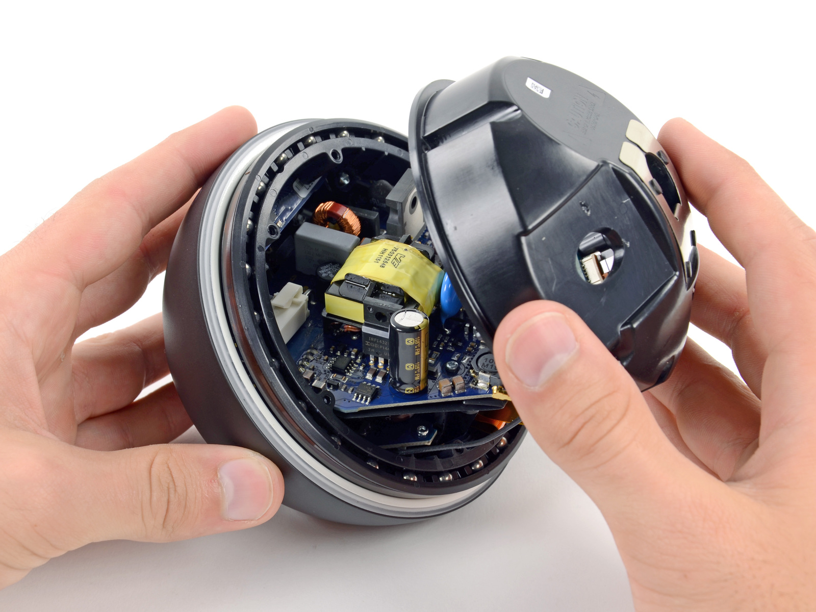

                            #753
                            Nexus Q
                            Panasonic FM , UCC KXG ...
                            Teardown here at ifixit : http://www.ifixit.com/Teardown/Nexus-Q-Teardown/9636/1

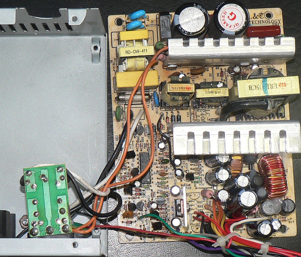

                              #754
                              Almost honestly spec'd LC, is that even possible?!?!
                              Don't notice the caps, it is after recap several years ago. Also the filtration was not all there originaly, but the minimum required was there (well, besides the varistors which I will add now).
                              It's labeled power is 235 W MAX, 20 A on +5 V, 7 A on +12 V, 0,5 A on both -5 and -12 V, 12 A on +3,3 V and 1 A on +5 V SB. Well, off course it won't do it on 115 V, but on 230 V it coudl work. There is original probably 4 A bridge rectifier, 330 uF caps, which could be higher, but together with 35 size transformer and 13007 it may work.
                              On secondary, only underrated is 16A shottky (!) on +5 V. Than 10A shottky follows on +12 V and 12A fast recovery on +3,3 V. Guess what, theres 1,5Avoltage regulator on the heatsink for +5 V SB
                              This si best LC I have seen so far. ADT ADT-2018 rated.

                                  #756
                                  That is the old Deer 230W platform, i have one around here somewhere that says Deer not L&C but otherwise is the same (including the shape of the heatsinks). About the only one which won't blow up your motherboard if 5vsb goes bad, thanks to that 7805 regulator.
                                    Maybe.
                                    Just make sure to change the 5VSB critical cap on the primary side near the heat sink. It's a small 22uF 25V cap. I can see there's already heat damage on your board so that cap may have started failing already. This causes over-voltage on the secondary of the 5VSB. The 7805 regulator will protect the motherboard from damage, but the 15V supply for the 494 PWM controller may go over-voltage and take out (or blow up) a small 47uF 50V cap on the secondary.
                                    See my post here with the same PSU with that cap exploded:
                                    https://www.badcaps.net/forum/showpo...&postcount=489

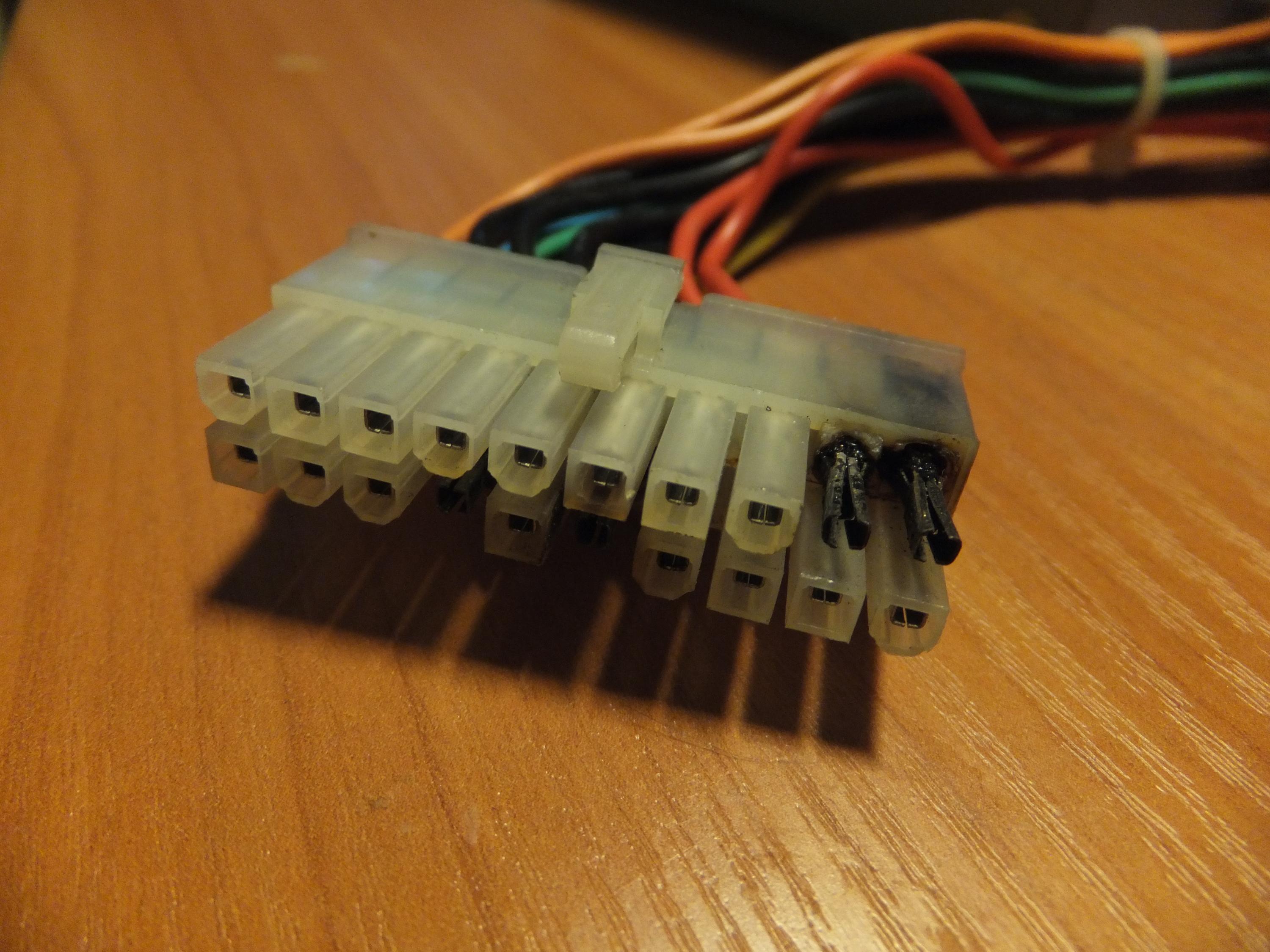

                                      Another generic PSU, GTA-250W
                                      This is a working unit, although the ATX connector is burned - maybe someone was drinking too much juice from the 5V line.
                                      All capacitors are JPCON.

                                        #759
                                        I'm betting more on crap connectors than excess power draw. Other than that, it looks pretty beefy for 250W. What are the secondary rectifiers?

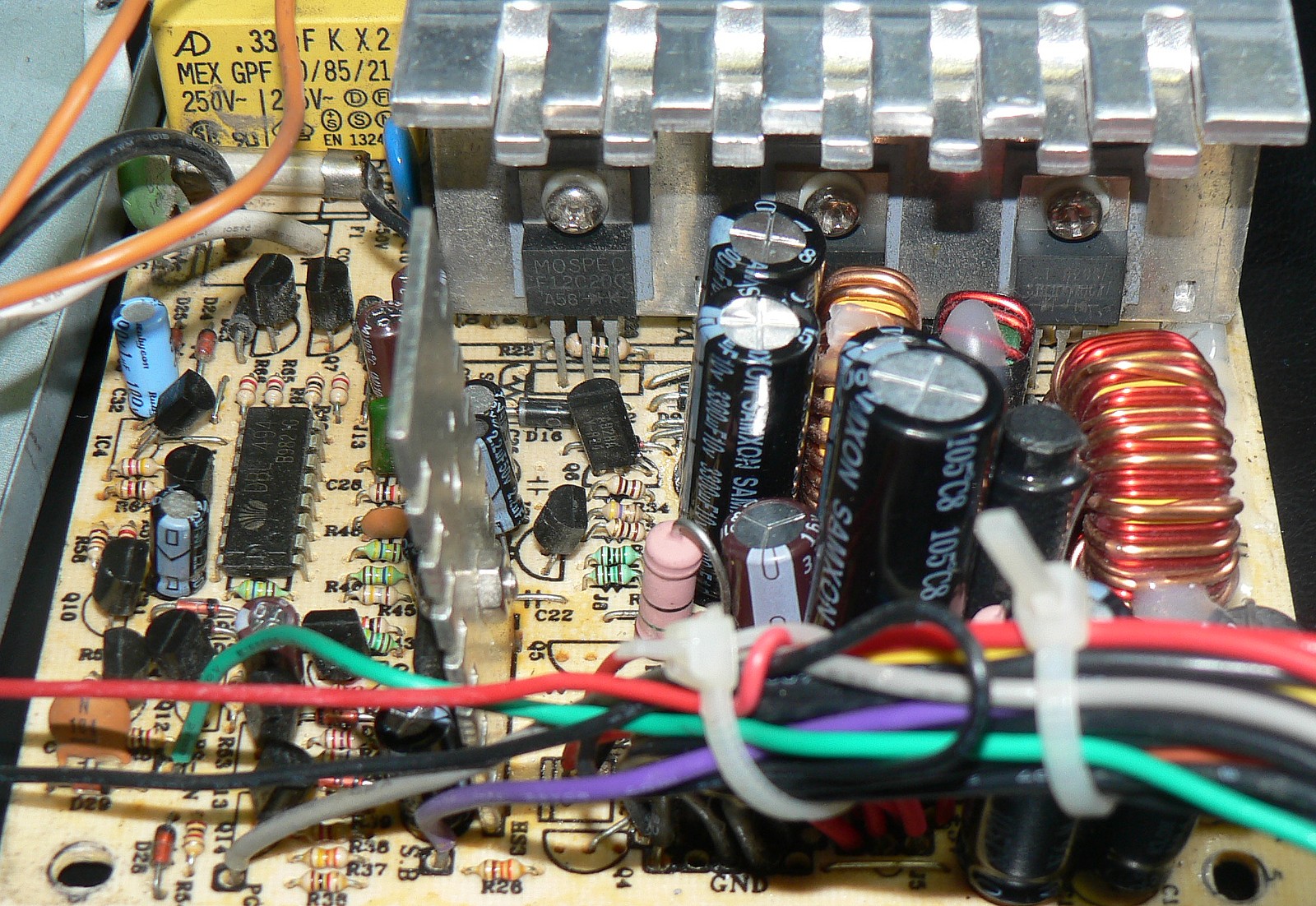

                                        A working TV? How boring!
                                        • b700029
                                          Banned
                                          • Sep 2010
                                          • 640
                                          #760
                                          Looks very similar to that L&C above, down to the 7805 for +5VSB.
