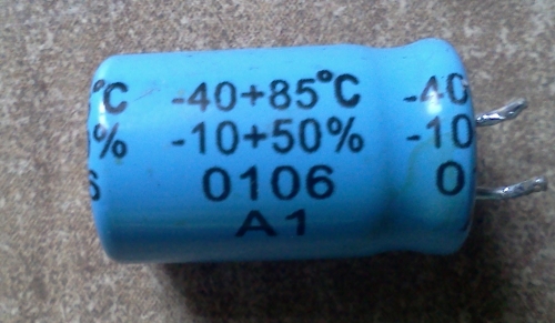

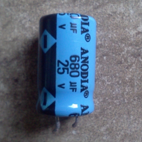

                                      • Mexico
                                      #738
                                      Originally posted by Pentium4
                                      ...The Primary caps are from a brand I've never heard of....Anodia?
                                      I've seen Anodia caps in wall warts before, but never seen them in SMPS until now.
                                      ANODIA ELECTRONIC CO., LTD.
                                      Off topic: Is there any chances of you posting some pictures of the caps?
                                      The ones I have seen never show any recognizable markings for Series, so it will be good if you can check if yours actually have Series markings.
                                      This is the only one i have at hand now and as you see there is nothing in the sleeve that can help identify at which series it belongs.

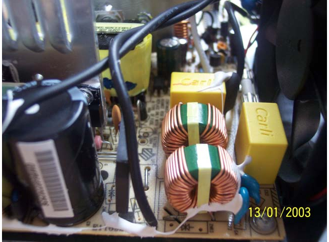

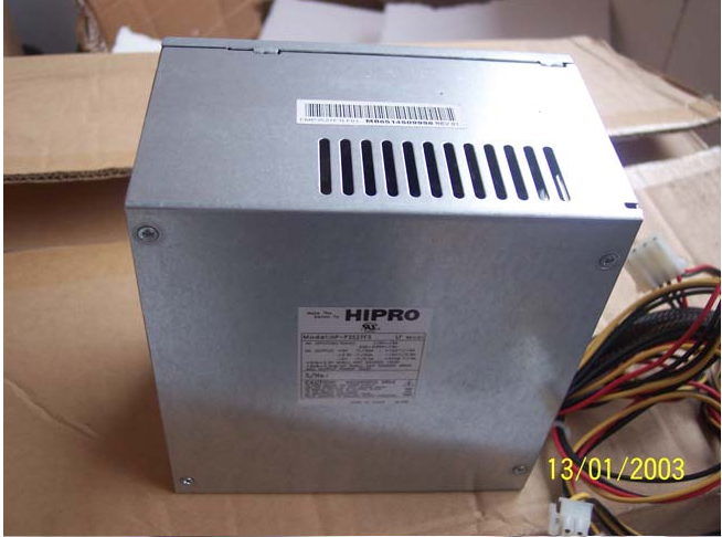

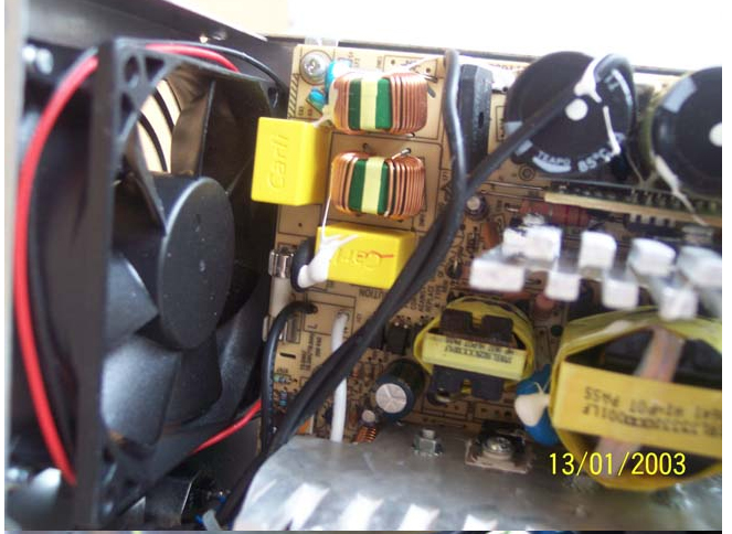

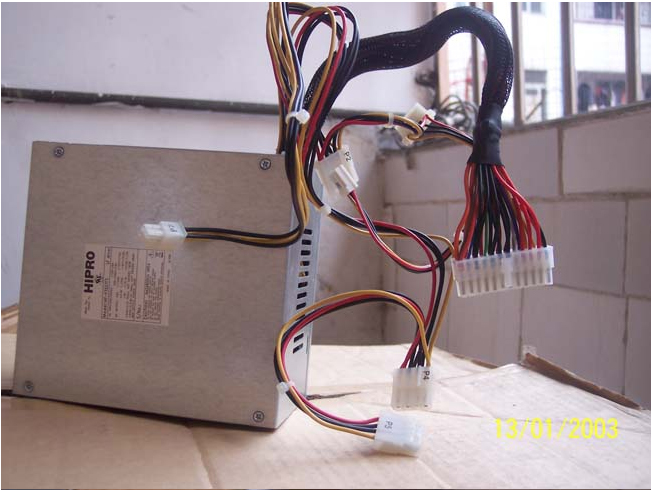

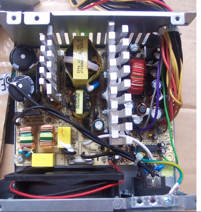

                                          The only thing of acceptable quality (EDIT: besides the transient filtering stage) in that Allied PSU is probably the heatsinks and Pentium4's recap job. The heatsinks at least aren't finless. Other than that it looks of sheer tripe.
                                          Not to be redundant, but attached is a better look at the PSU I posted in May. These images aren't mine but images of the PSU found on a Google image search link. The PSU in question is a (RoHS compliant, from the logo on the label) Hipro 300W, or a HP-P3527F3. No PFC in this PSU and only 470uF/200V primary capacitors (Teapo @ 85C), with otherwise what looks to be a mingling of Teapo, (maybe) Su'scon, Ltec, and (maybe) G-Luxon capacitors. There's 32A on the 5V rail, 20A on the 3.3V rail, 16A on the 12V rail, 0.8A on the -12V rail, 0.3A on the -5V rail, and 3A on the 5VSB rail. 165W is the combined wattage of the 5V and 3.3V rails and 280W is the combined wattage of the 12V, 3.3V, and 5V rails together. It does say maximum output 300W but nowhere on the label does it say that continuous. The fan looks to me like it's a 80mm (80x80x25/12VDC) ADDA sleeve bearing (I didn't check, as yet, but probably a medium speed from what the airflow feels like from the grille so I'm guessing that means 2440RPM/31.4CFM and a static air pressure of .114"). Also, my 20-pin connector is not sleeved like the one in the added image. And I'm not sure the date on the image is correct either (if this PSU is RoHS compliant it'd have to be from 2005 or 2006). Does this PSU look underspec'd or subpar to anyone for one rated at 300W (right now it's powering a Pentium 4 2.66 GHz w/1GB of DDR266 RAM, a 40GB Seagate/80GB Samsung, an underclocked Radeon 9500 Pro, a Sound Blaster Audigy Gamer, a Promise Fasttrak ATA100 card, a floppy drive, a 2450RPM/80mm/33CFM AVC sleeve bearing case fan, and two DVD-+RWs)?
