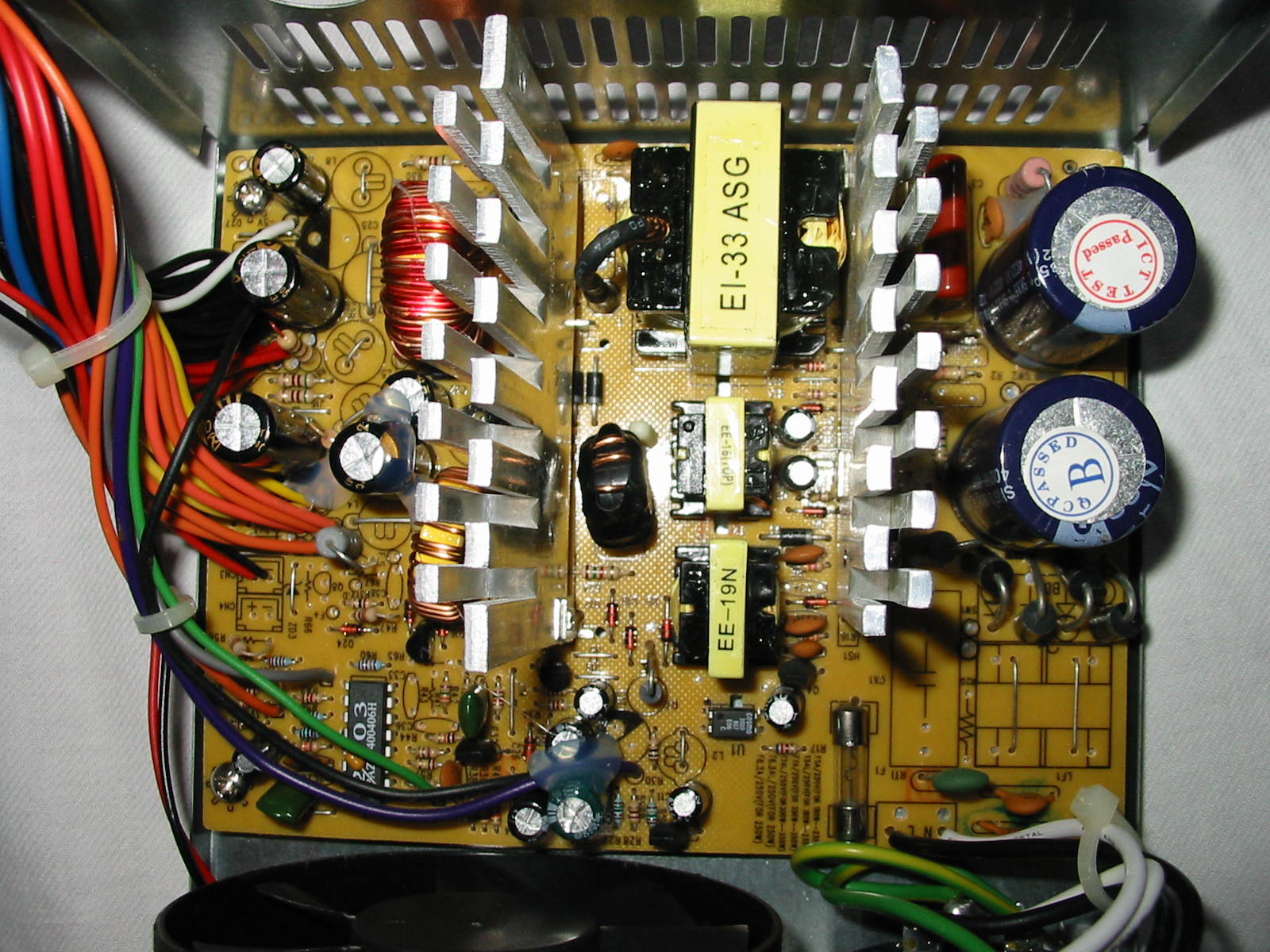

                    L&C Technology Inc. LC-250ATX
                    Alright, as per popular demand here, I decided to post my entire Deer/L&C collection (split into multiple posts below, so give me a few minutes as I post each).
                    Let’s imagine it’s 1999. In front of you below is a fresh out-of-the-factory North American Deer/L&C Technology sample. Plain and gray.
                    https://www.badcaps.net/forum/attach...1&d=1331835289
                    Next is a shot of the label. As the LC-250ATX model number suggests, we got us a 250W PSU. Those of you with the sharp eyes might have noticed the typo on the label for the 5VSB wattage. Apparently 5V x 0.8A is 5W.
                    And a top shot… (note: I disconnected the primary wires in this pic.)
                    Initial impressions: it’s not quite gutless (especially for powering 1999’s computers) but you can still tell corners were cut. There’s a lame choke for the primary input filtering, 2x 1 KV ceramic caps instead of proper Y caps, metallized polypropylene film cap instead of a X cap, and no insulating plastic sheet between case and PCB. On the not so bad side, there’s a RS405 bridge rectifier good for 4 Amps, 2x 200V 470uF primary caps (made by VIVA), 2x 13007 switching transistors, and C5027 for the 5vsb transistor. Text in the middle of the board says DR-240ATX. Fan is a CBE CB802512M 12V fan rated at 0.14A. Looks and feels exactly the same as a Rulian Science & Technology fan, though. All wires are 20 AWG. No P4 connector is included with this PSU (then again, this is in 1999 )
                    The bottom side:
                    The soldering is not great but still very acceptable. No long leads sticking out. There is some discoloration under the primary side of the 5vsb circuit and the secondary under the PWM controller. So let’s have a look at the top side again, this time the secondary…
                    PWM controller is DBL494. 5VSB transformer is properly sized.
                    3.3V rail: 2x bulged 2200uF 10V VIVA caps (no PI coil in between), 1x S10C40C 10A schottky rectifier, 4(?) Ohm 3W dummy load resistor.
                    5V rail: 1x 2200uF 10V VIVA cap (after PI coil), 1x 220uF 16V VIVA cap (before PI coil), 1x S16C20C 16A schottky rectifier, 47 Ohm 1W dummy load resistor.
                    12V rail: 1x 2200uF 16V Su’scon SD, BYQ28E-200 10A FR rectifier, 100 Ohm 2W dummy load resistor
                    -5V and -12V rails: 1x each 470uF 16v VIVA caps, 1x each PI coils, 2x each 1A or 1.5A FR diode rectifiers
                    5VSB: 2x 100uF 16V Jun Fu HK (1x before 7805 regulator, 1x after it), 7805 regulator for output, FR154 FR diode rectifier.
                    As the 7805 regulator might suggest, the 5VSB circuit in this PSU is self-oscillating. However, unlike the 2-transistor design, this circuit does not have feedback (hence the lack of optocoupler next to the 5VSB transformer). That doesn’t mean this circuit can’t go over-voltage – it can, but the 7805 regulator will (in most cases) protect the motherboard from damage. Like some of the 2-transistor self-oscillating designs, this circuit also has a critical cap on the primary – 22uF, 25V Su’scon SK in this case.
                    In fact, the 5VSB might actually have gone over-voltage before. Originally, I got this PSU from the trash. Apparently one of the small caps had exploded inside since there was paper and foil scattered everywhere. The base of the exploded cap is still there, though. Some of you may have already spotted that in the pictures. More particularly, look again at the last one above. To the right of the PWM controller is a green polypropylene cap, and next to it is the base of the exploded cap (the rubber bung with the 2 metal “probes” sticking out). Also note the secondary heatsink right above that cap and how one of the fins is bent. This exploded cap is actually responsible for filtering power going to the PWM controller, which is provided by the 5VSB transformer. My theory is voltages from the 5VSB transformer most likely went over-voltage and made that cap explode. And this doesn’t seem to be a unique case either. I have seen the exact same model of this PSU (here, on BCN) with the exact same cap exploded. Maybe even twice.
                    But other than that, this PSU is not so horrible. I already changed the critical and exploded caps and the PSU runs okay now (without load, of course – won’t try it on any computer with those bulged caps). The spot for the exploded cap holds a 47uF 50V cap.
                    Stay tuned. More Deer coming your way .
                                Is this bad??? This is the first time I read it here. I have some Maxpower psus with "brown" caps used for X caps...
                                Can you explain?

                                  Unsolder the transformer inthat last one. Often, they say ERL-35 on top and ERL-33 underneath
                                    Can you explain?
                                    I think momaka's meaning is that the caps used were not safety-agency approved polypropylene caps.
                                    PeteS in CA
                                      #498
                                      A proper, safety approved and tested X capacitor will not flame on surge or end of life. (It may burn and smoke, but that's all that is allowed, and it should extinguish after 30(?) seconds.)
                                      A proper Y capacitor is guaranteed not to short under any failure mode. If the Y caps short, it poses an electric shock hazard as the case becomes energised with one side of the line - especially so if the earth is broken, damaged or deliberately removed.
                                      A brown polypropylene capacitor may be okay for a line filter, but it won't meet the flammability test, so could pose a fire hazard. Then again, most L&C/Deer supplies are a fire hazard in many other ways, so it wouldn't make much of a difference.
