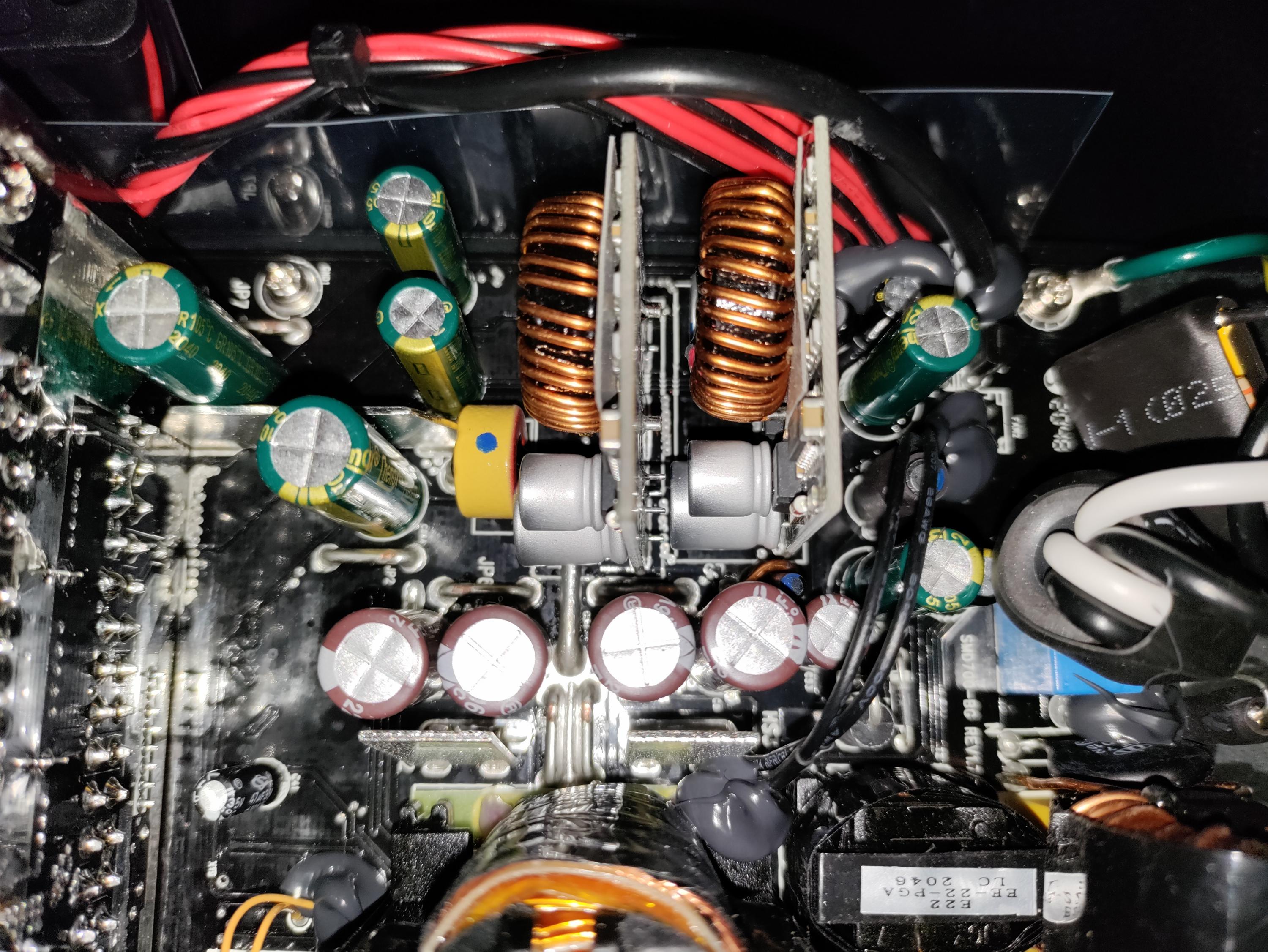

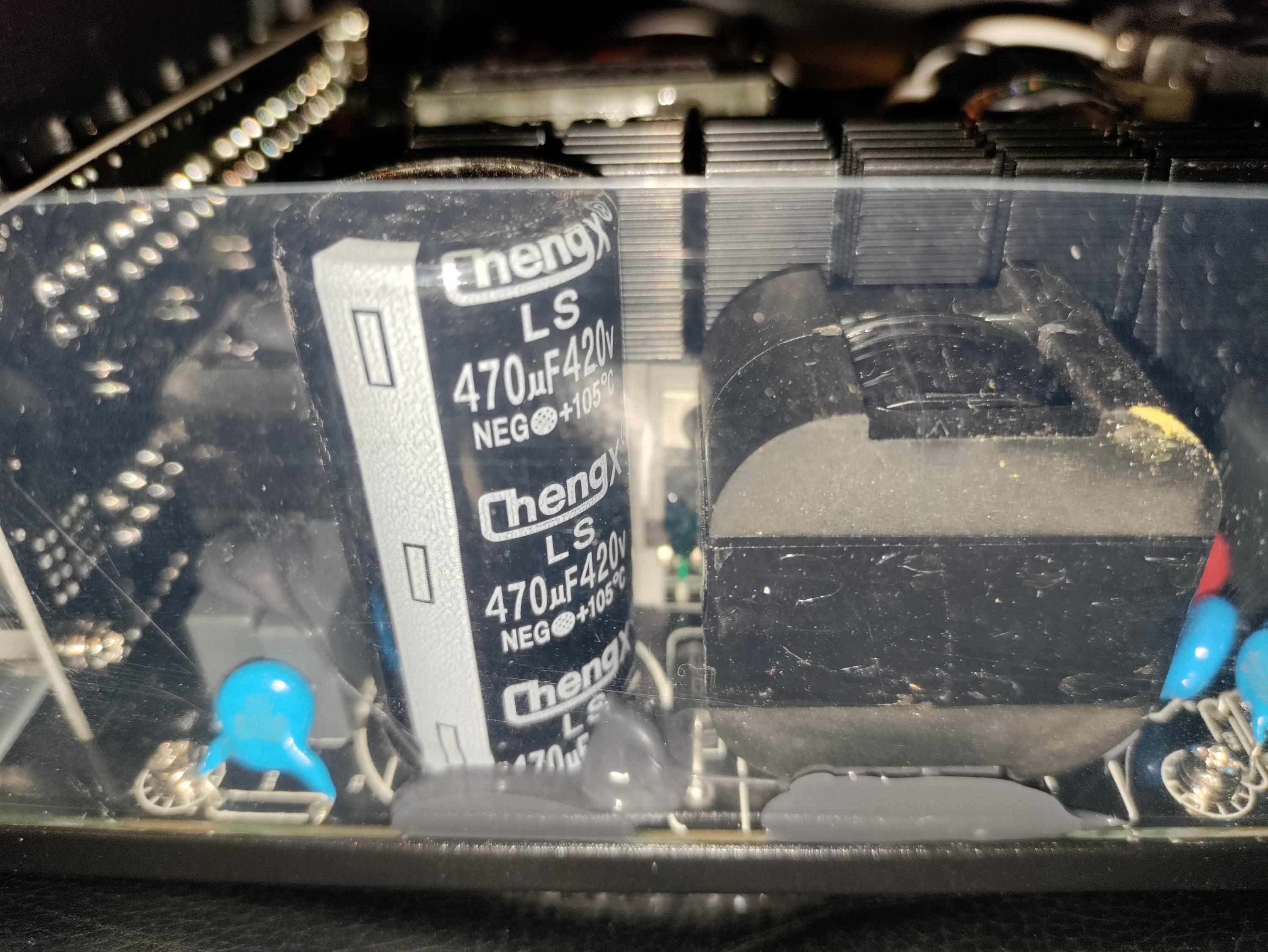

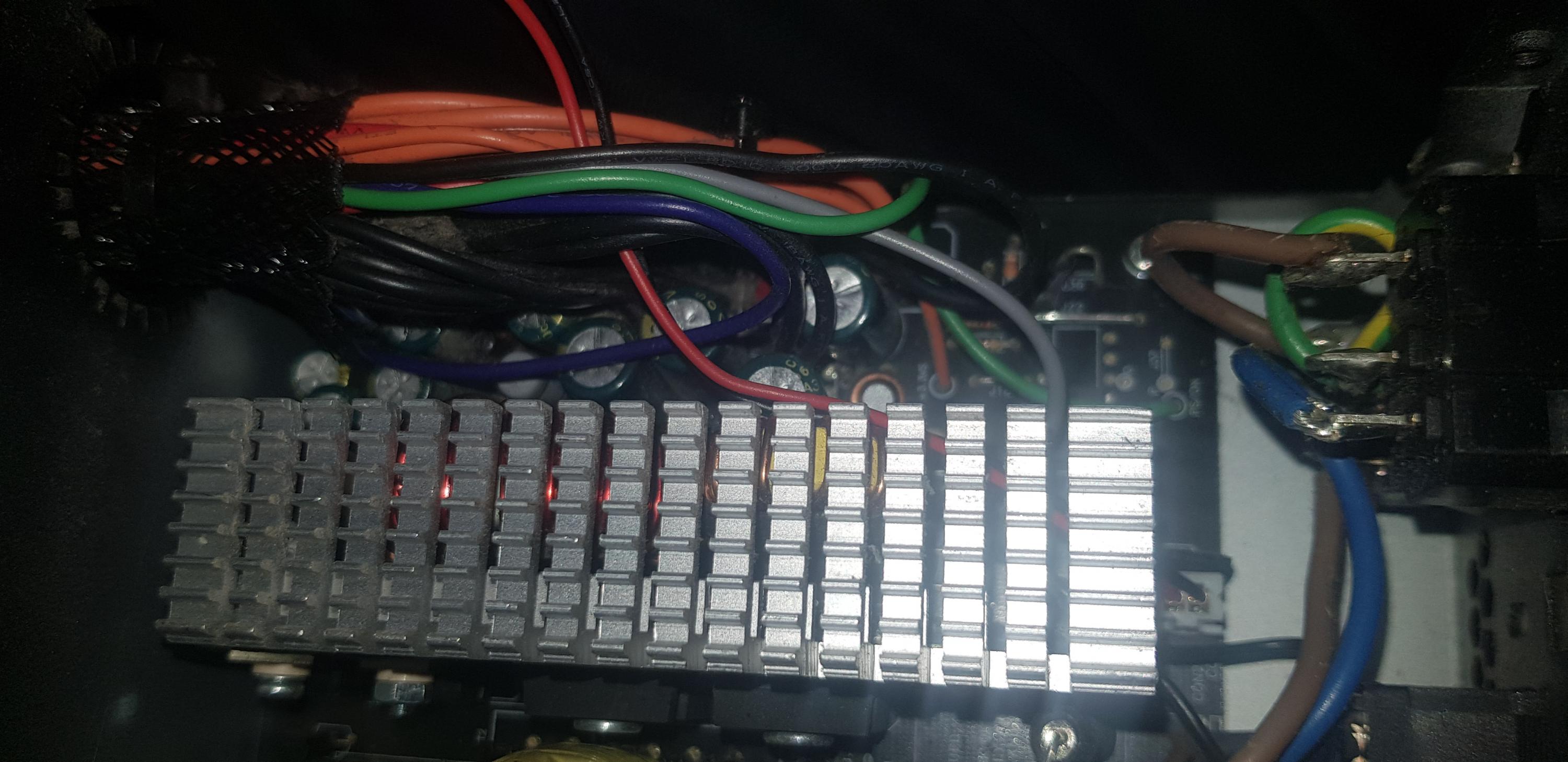

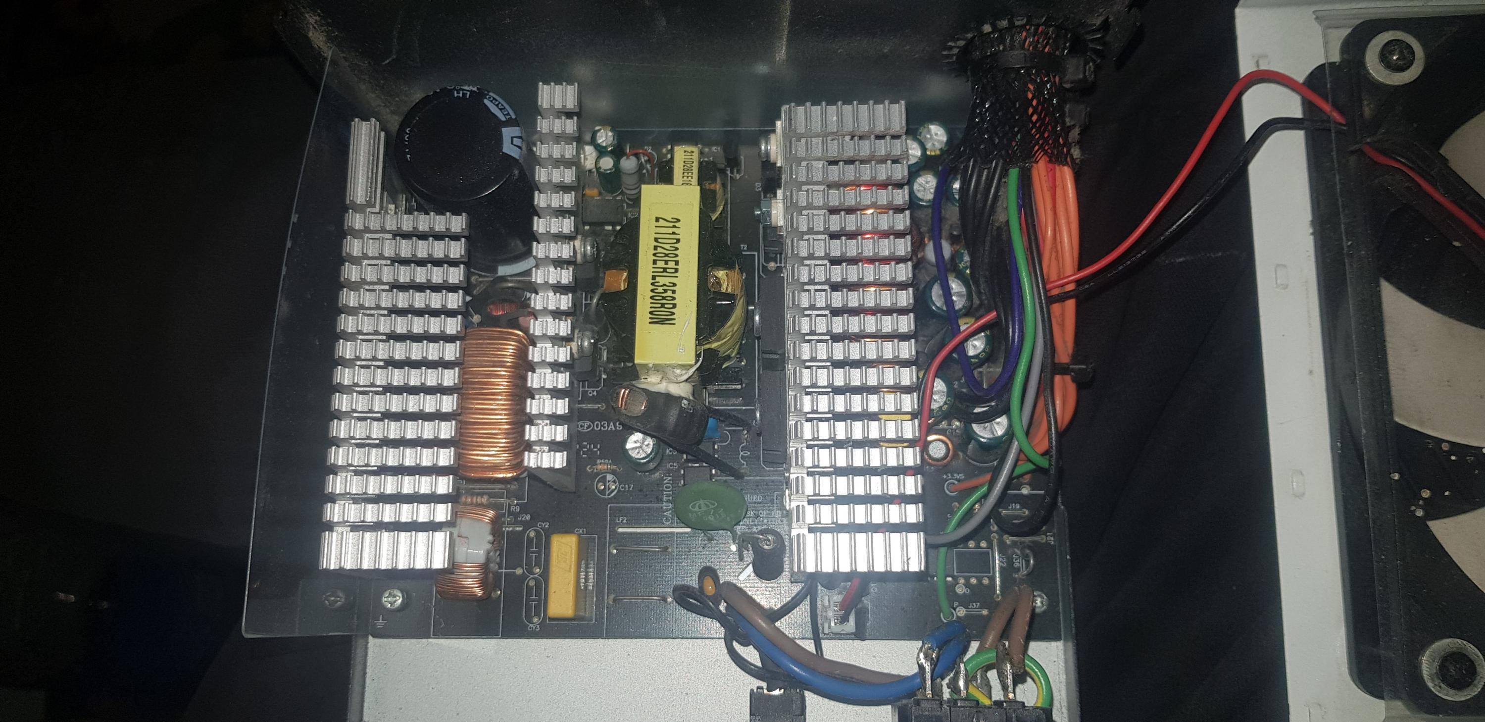

    Looks a bit bare for a 500w unit, particularly the transformer, heatsinks, and primary capacitor all seem a bit small. IMO, It might be fine for up to 400w, but probably not too much more.
    Speaking of Segotep, I have/had a Segotep 750w unit that I had bought for a computer I was building for my older sister, and before installing it, I took the lid off a took a couple of photos, and it overall didn't look like a bad PSU, other than the capacitor choice, which was a mix of Chengx with a few SC caps mixed in. And while I probably should've recapped it before giving it to my sister, I didn't because I didn't want the PSU to blow up the moment I recapped it, especially since it was still under warranty (it did not have any warranty stickers on it to stop me from opening it up, which is why I did). So odds are, it will probably be back here in a few years when I inevitably have to recap it.
    I'm not a expert, I'm just doing my best.

      Segotep is almost like Intertech - the more cash you pay, the better the unit. The less you pay, the worse it looks inside. And trust me, I've laid eyes on some units that were more atrocious than leotron's unit.
      As for OEM, couldn't find either designs... I highly doubt leotron's unit is made by Seasonic (it looks too barren to me) while yours apparently traces back to a brand named "Colorful".

          Looking at that SEGOTEP "500W" P/S, the input lytic, TO-220 switch devices, heatsinks, and output inductors (-26 material, suggesting transistors and a switch frequency under 50KHz, probably 70%-75% efficiency) look more suited to 235W-250W continuous.

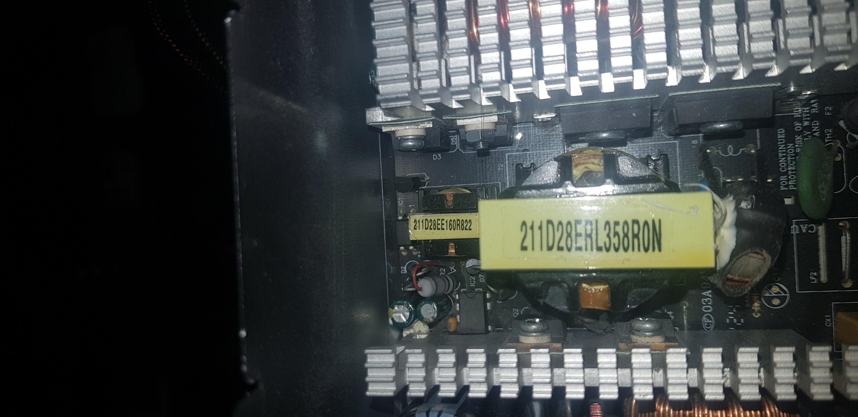

                              Since the segotep doesn't have anything below the board my dream on building power ful PSU is become a reality
                                I'd be careful pulling more than 180W max from that.

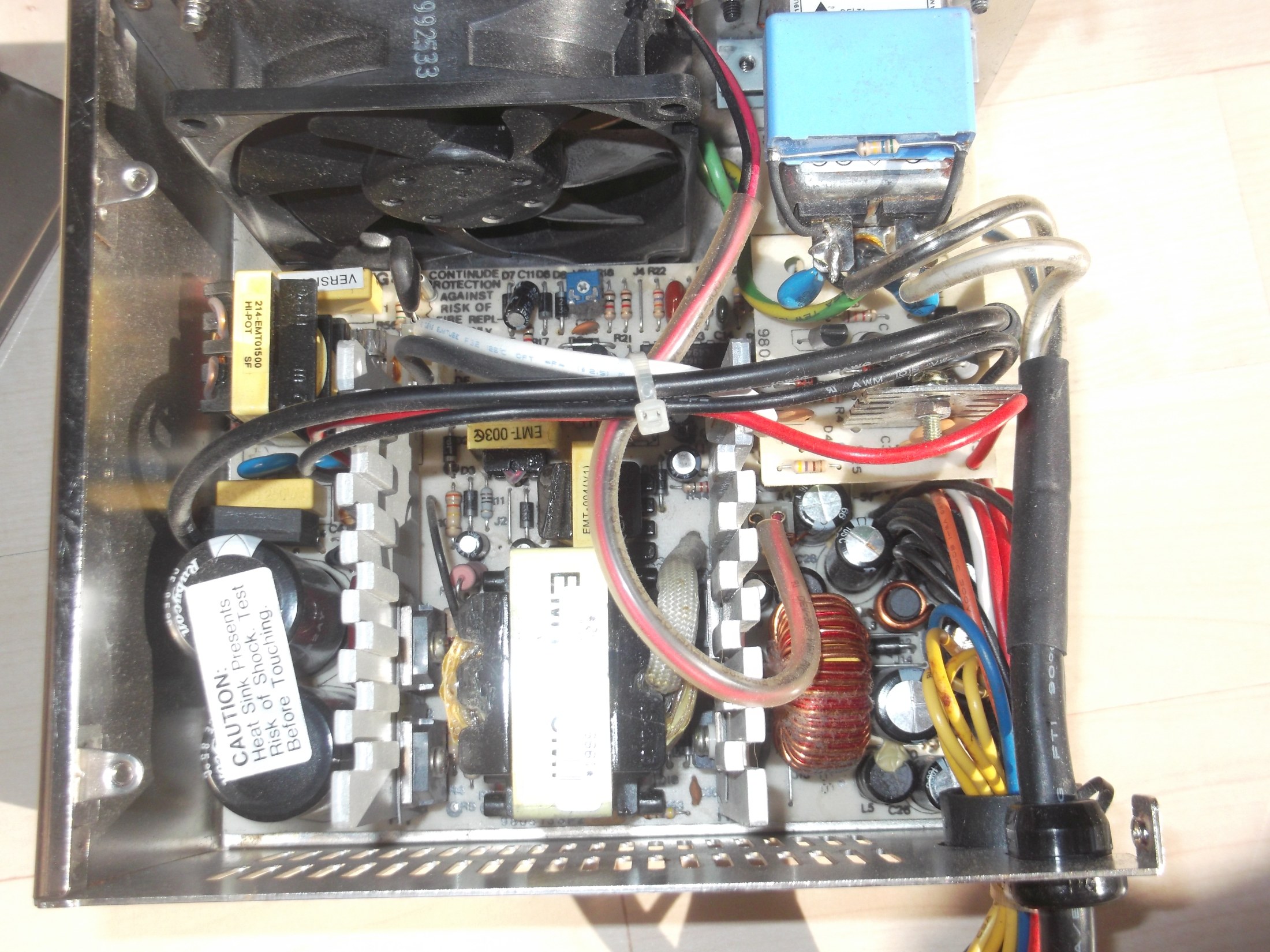

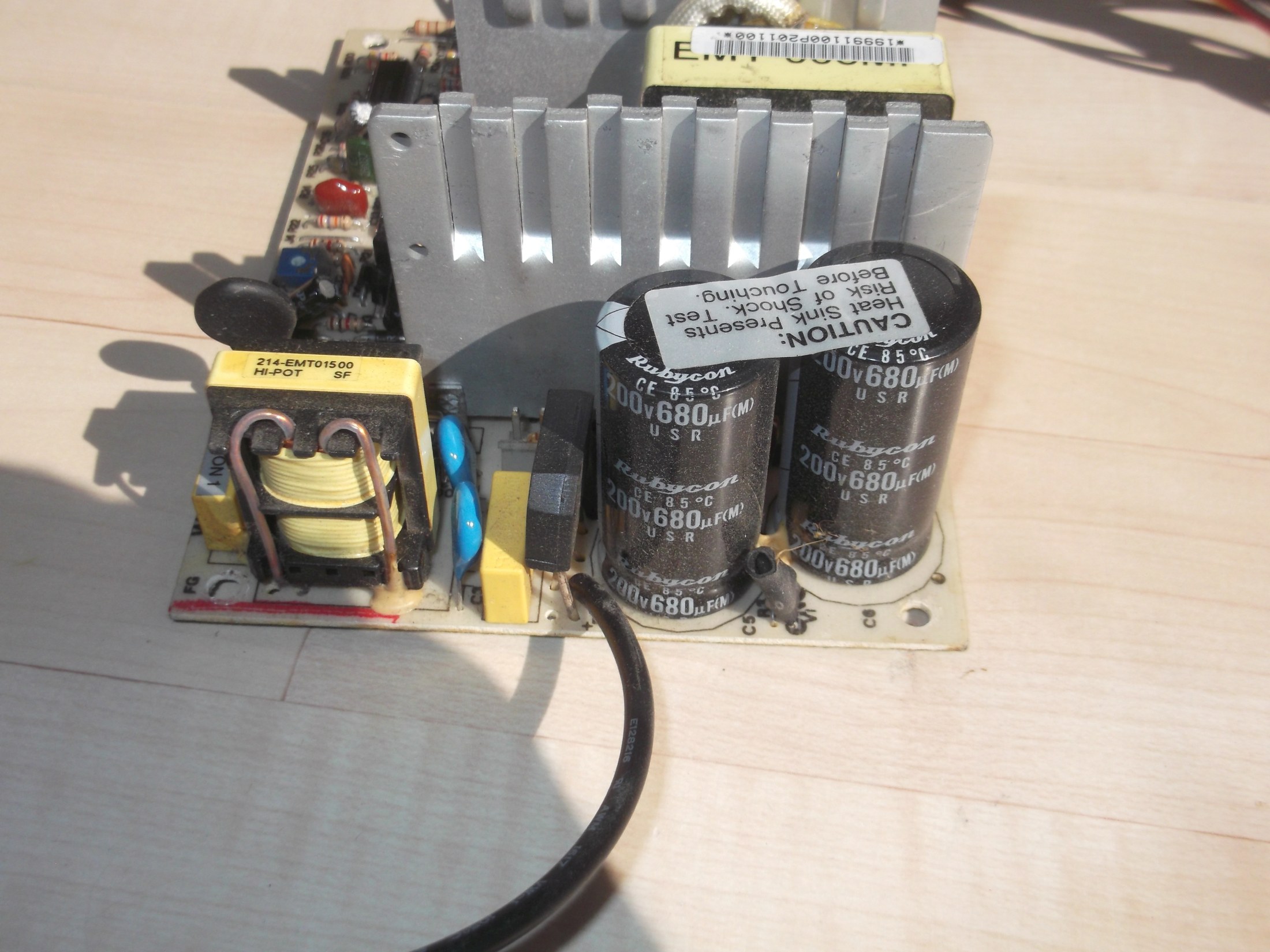

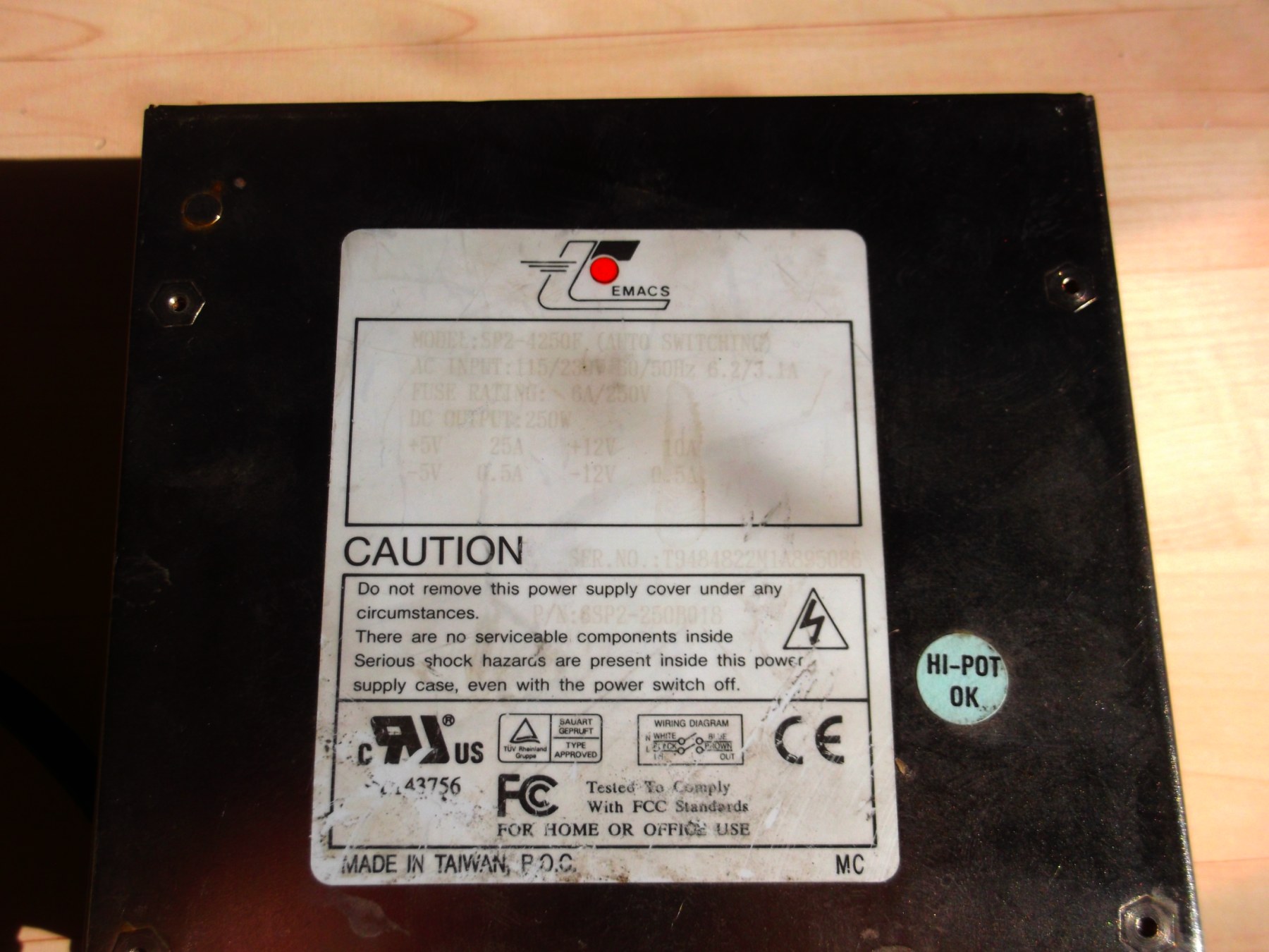

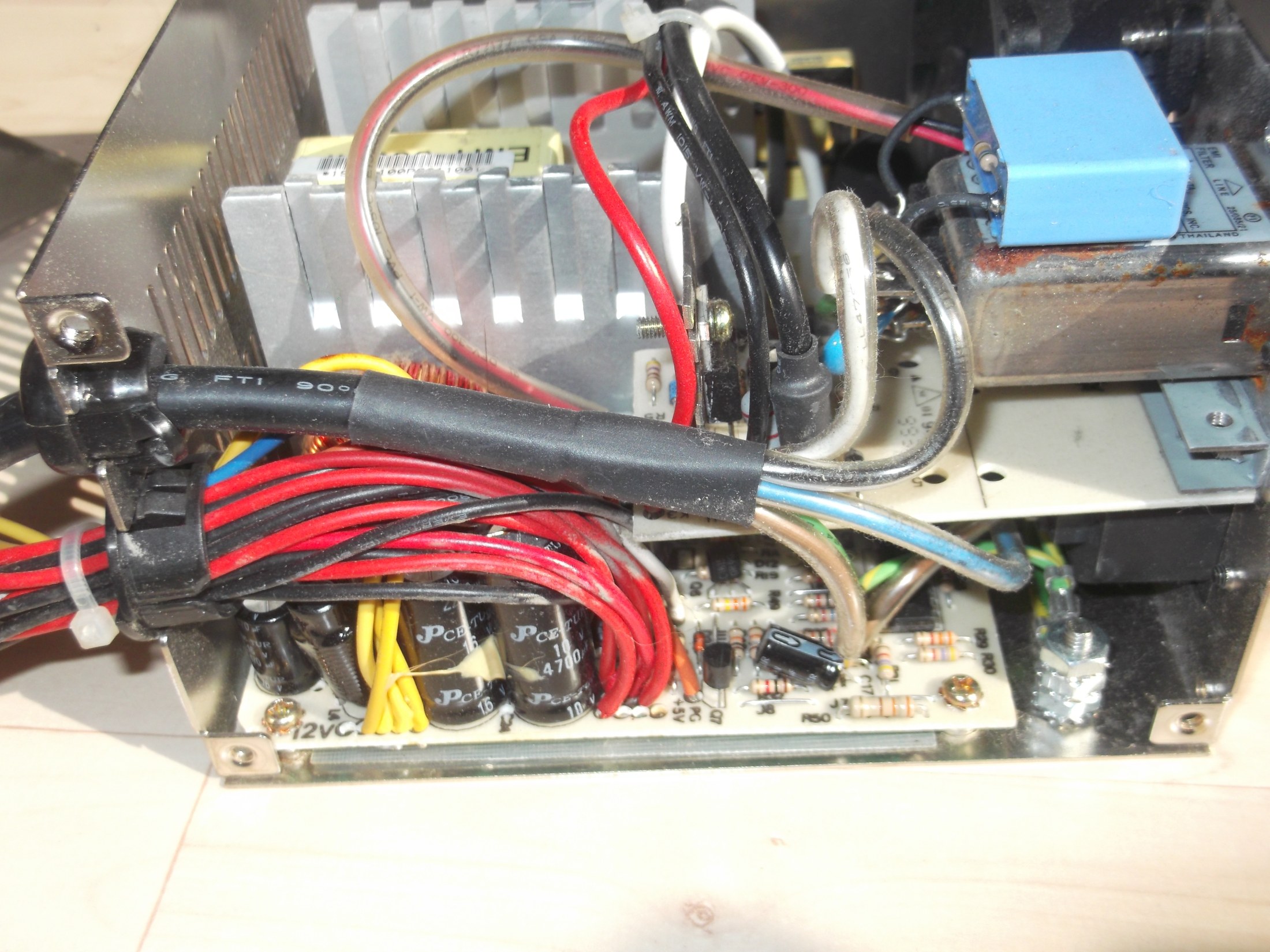

                                        I've got a decently build AT PSU:
                                        SP2-425F EMACS.
                                        Has an automatic input voltage selection circuit.
                                        Very decent EMI input filtering.
                                        Input buffer capacitors are Rubycon USR 680uF.
                                        Half bridge switching two 2SC2625 NPNs.
                                        Center tapped 44 size main transformer.
                                        Some of the output capacitors are swollen, all PCE-TUR .
                                        TL494 PWM for primary switching.
                                        LM339 in the secondary for protection and voltage supervision.
                                        Lots and lenghty peripheral conectors. AWG 18 wiring.
                                        I haven't a clue who is the OEM. 1999 date code on the pcb.

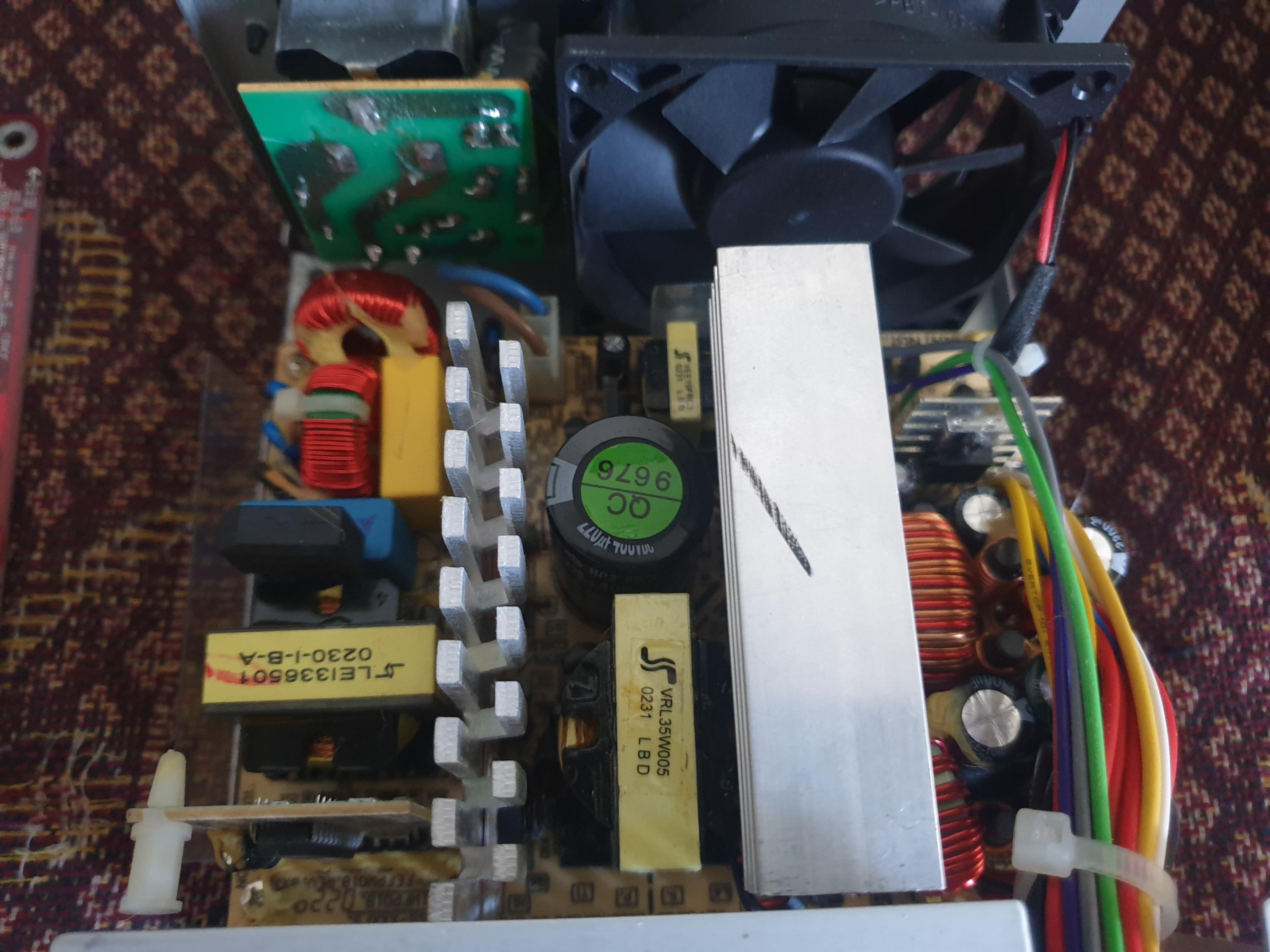

                                          #3220
                                          No-name special
                                          Why is it special? The insides shall tell you everything.
                                          No case swap involved, that is really how I found it, in a rather nice MSI K8T Neo-FIS2R + NX6600GT AGP custom build.
                                          FWIW, according to the fuse chart, this thing is realistically just 50W short of its rated power. Not bad, unlike most china specials I've had to work with.
