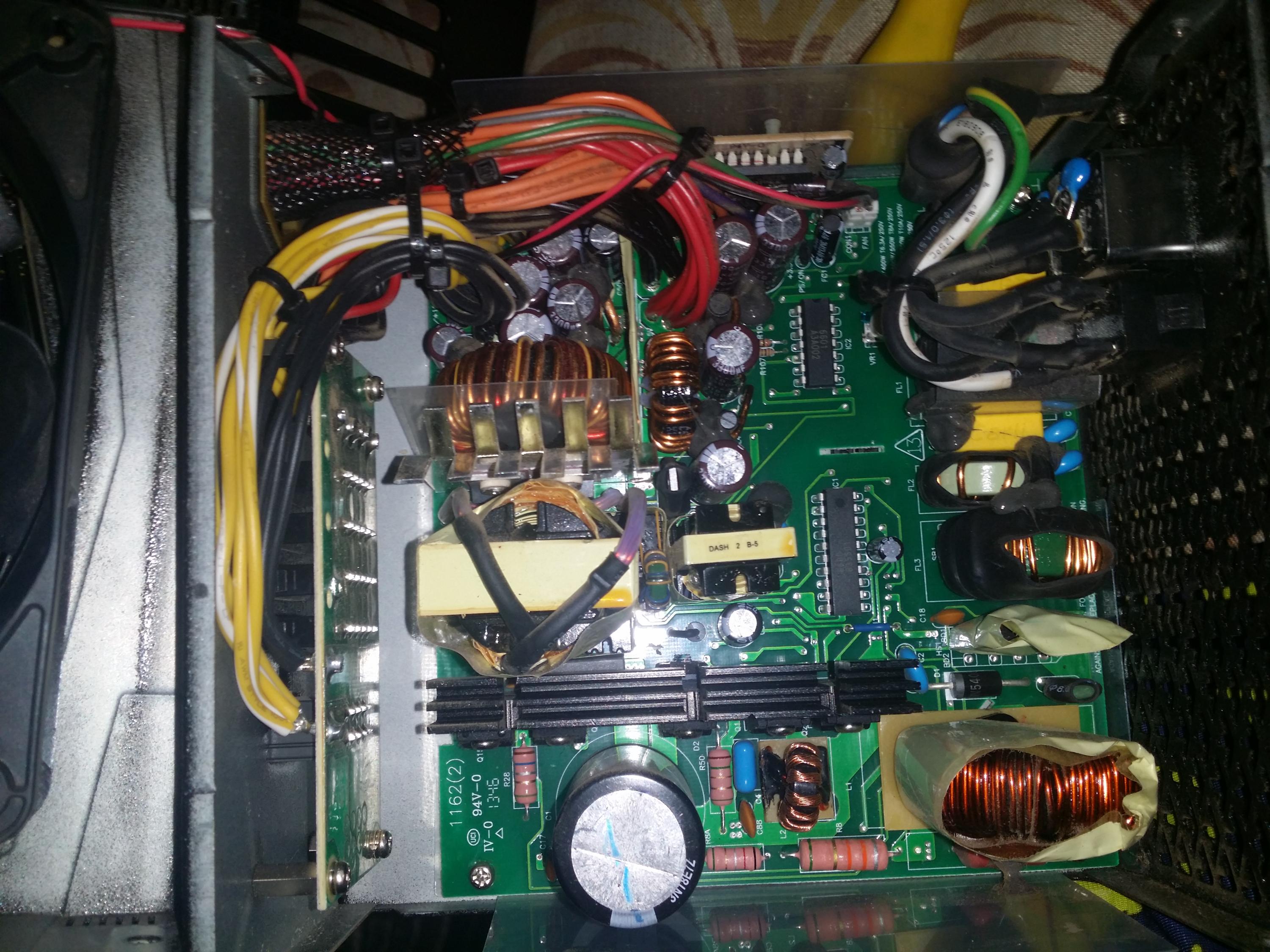

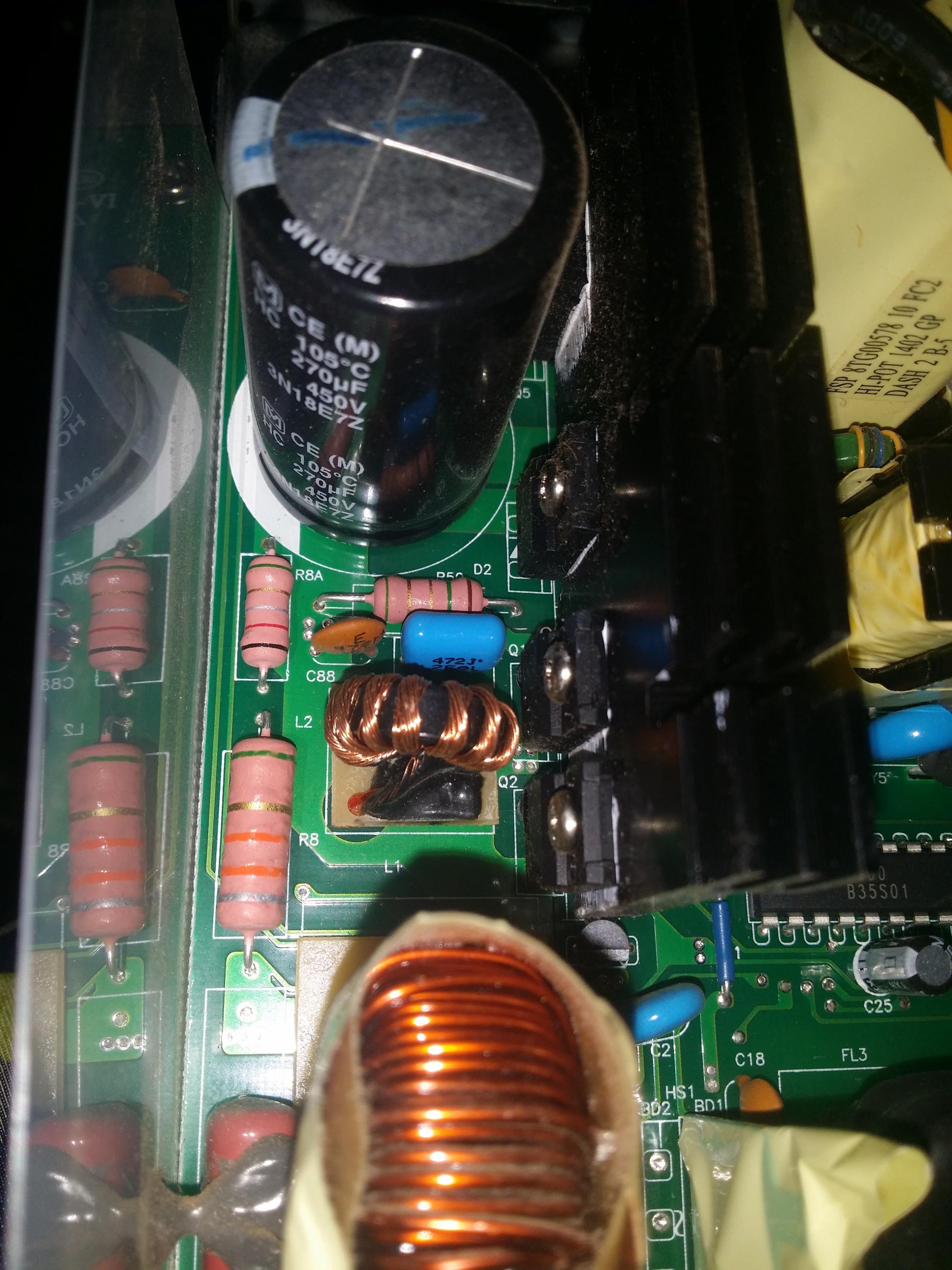

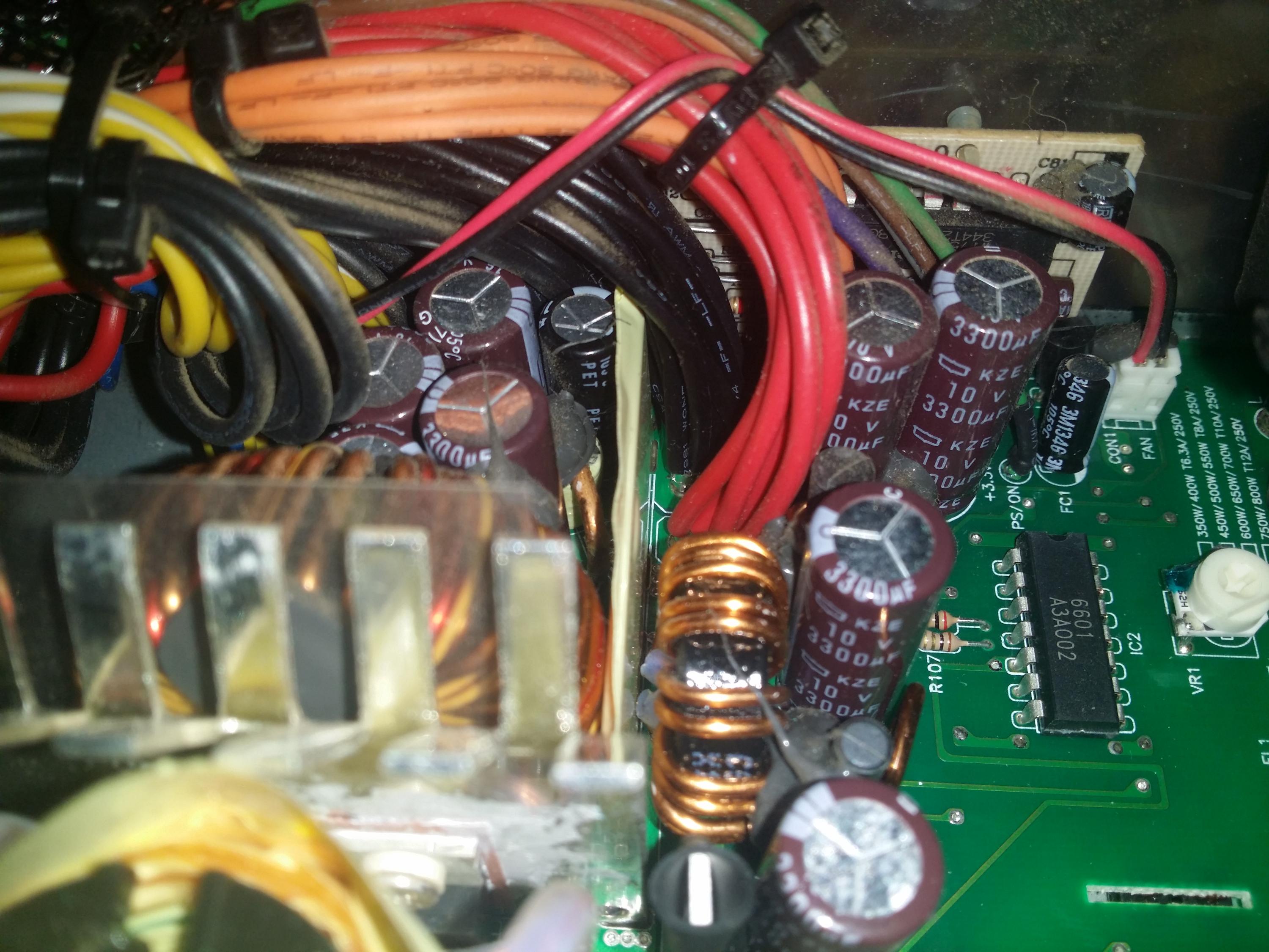

    Well, the most recent date code I spotted in the pix was "9752", on the PCB. So this was built in early 1998. This is consistent with the .7A 5VSB rating.
    Late 90's sounds about right, especially with that 5VSB spec, as you mentioned. Also, I just noticed a Gateway logo on the second case shot, so this most likely came out of a Gateway PC.
    We had to change the 7805 to an LM317, because the 5VSB turned on too fast with the 7805. By using the LM317 we were able to use a cap across an adjustment resistor to slow the 5VSB rise time. The customer, Sun Microsystems, was concerned that too fast a rise time might damage CMOS gates in the relevant circuits.
    Interesting.
    I suppose that was a valid concern back in the day, as many motherboard ICs were directly connected to the PSU rails, including 5VSB. Actually, I think this went on pretty much until late-era socket 462 and 478 boards.
    One of the reasons why many eMachines PCs died from the infamous Bestec ATX-250-12E PSU is because the socket 462 boards in those PCs typically had their LPC SIO, as well as some other TTL power control logic circuitry directly connected to the 5VSB. Thus, with the 5VSB from the Bestec overshooting to 10V or more, many of those ICs died. I actually have a board like that in my "for a rainy day" pile that I've attempted to fix. Most of the TTL ICs I mentioned were rated for 4.75V-5.25V. So no wonder they released the magic smoke.
    Nowadays, the 5VSB on motherboards usually goes through a linear regulator of some sort (typically generating 3.3V stand-by) and then goes to the ICs. So many boards are somewhat more protected from overshooting and quick-rising 5VSB.
    That is one beefy PSU! I might believe it good for 235W or 250W.
    I wouldn't be surprised if that's the case. For many OEM PSUs, the maximum rating on the label meant maximum _continuous_ power the PSU can supply (and even higher peak, if needed). Hence the overbuilding. Quite a contrast from the cheapo PSUs with 250-300W ratings that could only hope to peak that high for a few seconds before blowing up.
    The big usefulness limiter nowadays would be that 5VSB output current rating.
    And the 12V rail! Even a Core Solo won't be able to run with that PSU.
    But for an old 5V-heavy PC, it should be fine - especially socket 462 boards, as those usually didn't support S3 sleep (only S1, which means 5VSB was used, at the most, for WOL, WOR, and power by [PS/2] keyboard/mouse.) Actually, most Pentium II and 3 boards supported S3 sleep, but even those were stated to require no more than 500 ma to 1 Amp on the 5VSB. So I have a good number of motherboards that will work with this PSU.

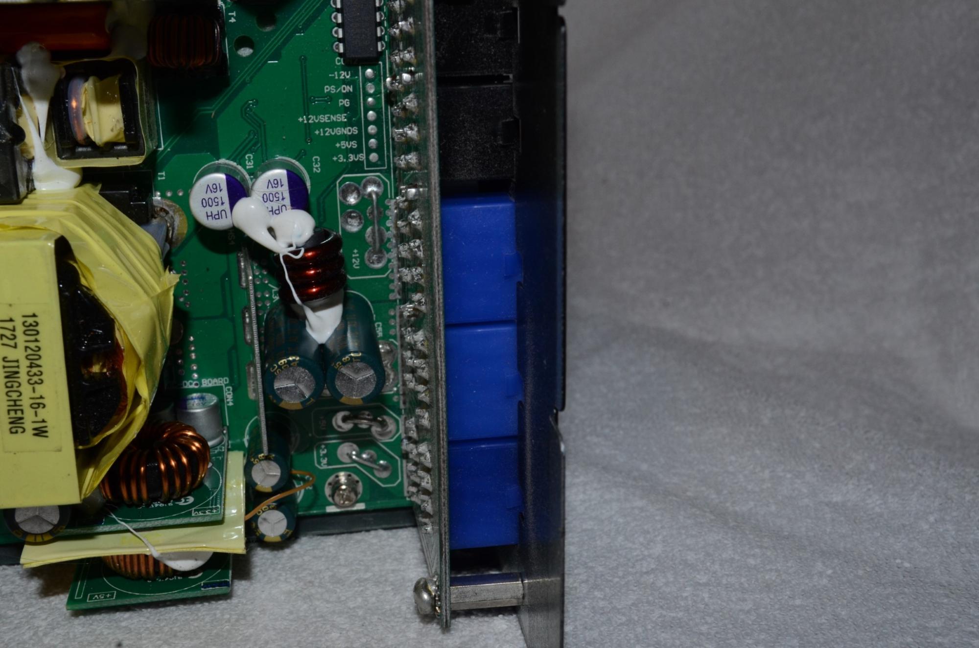

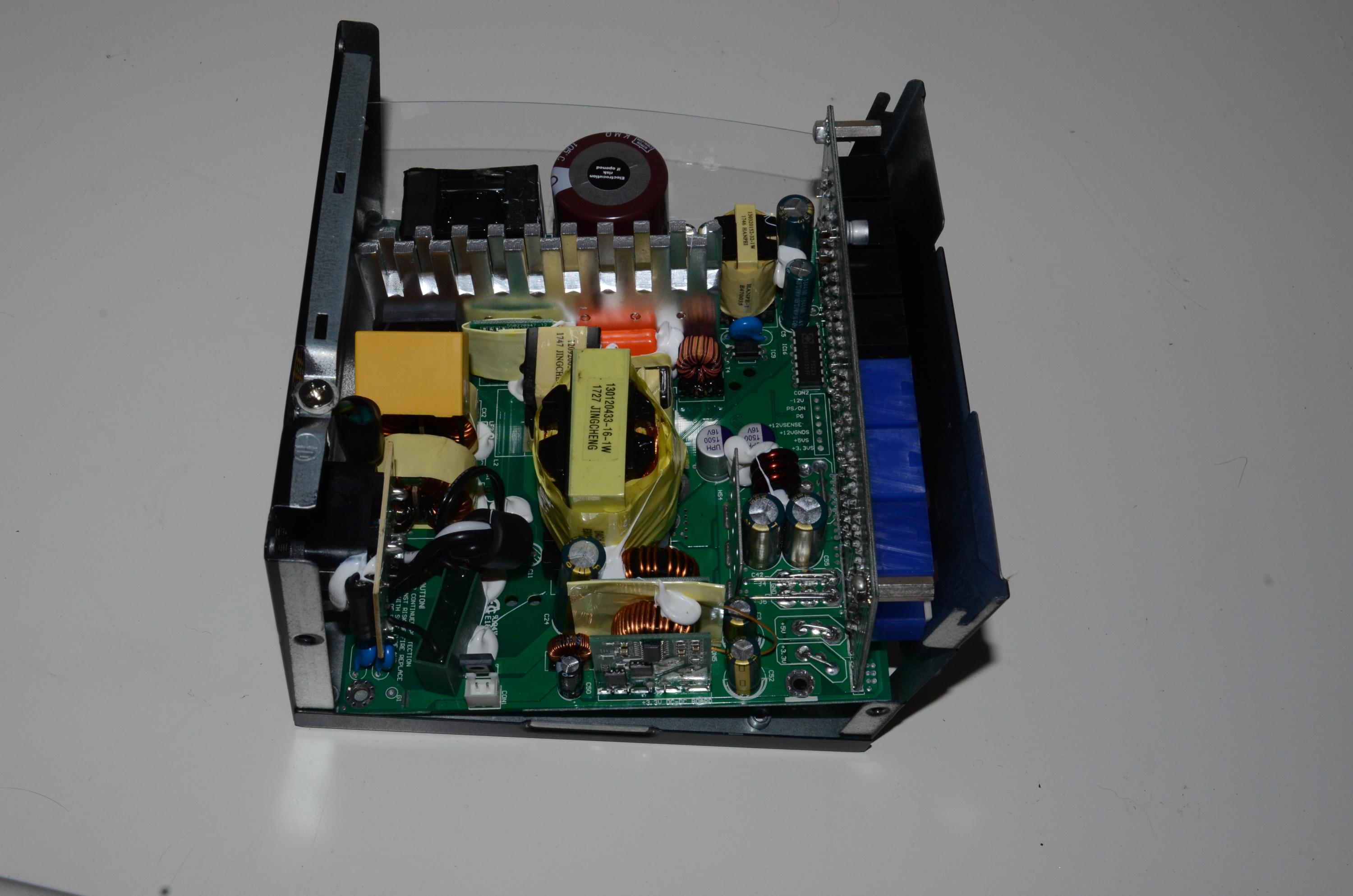

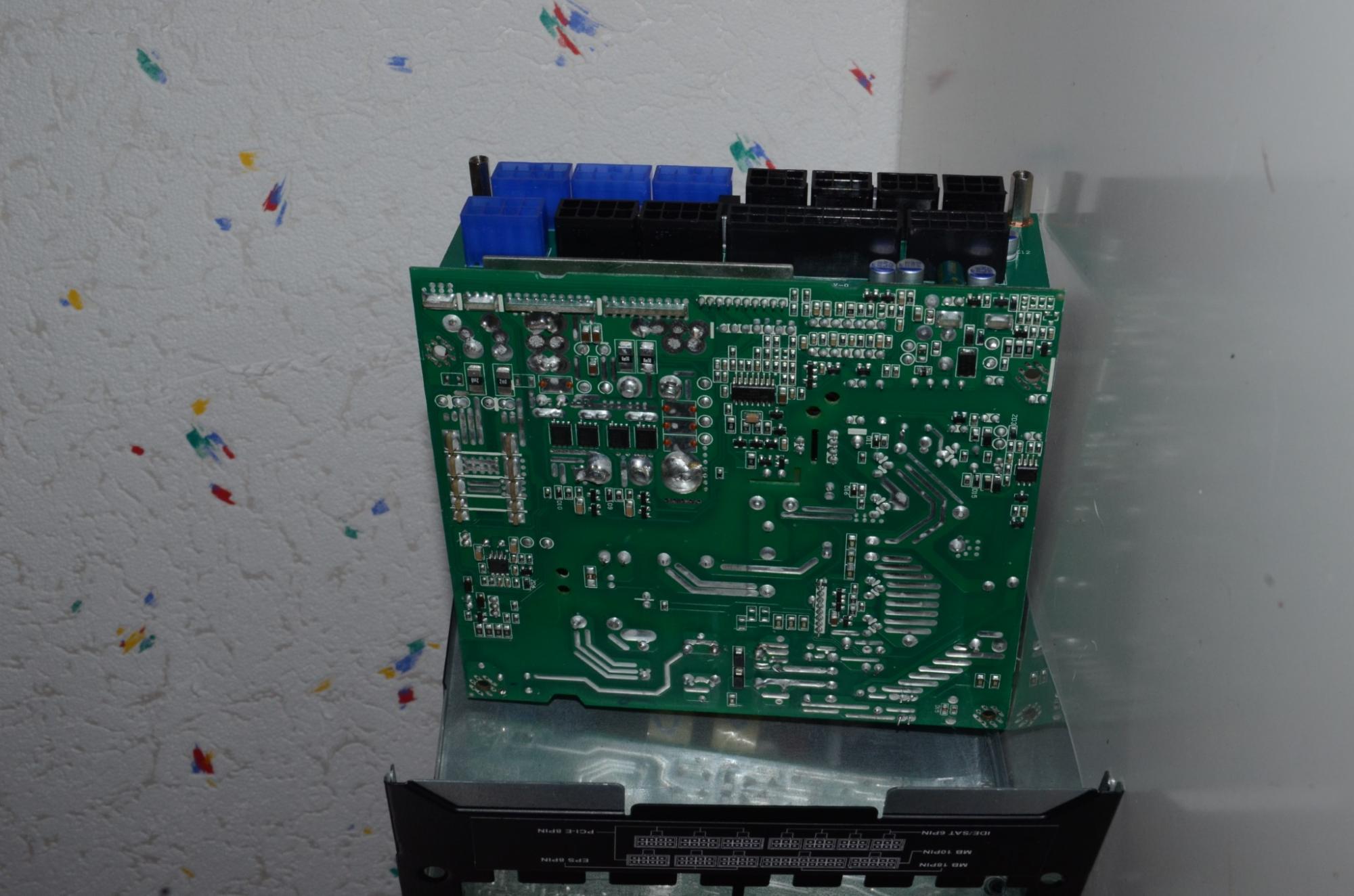

        ^ Oh come on - would it really kill you if you posted a label shot?
        I really dislike playing this "guessing game" as to what it is. Yes, it's an ATX PSU. Yes, it's fully modular **. Yes, it has APFC and sync. rectification. And yes, it has crap cap brands on the outputs. With that said and not knowing how much it's rated for on the label, it's hard to judge it. Overall, I'd say it looks OK. But really, it's just another modern unit without anything noteworthy.
        ** Regarding the fully modular thing: I just don't get why they make the 20/24-pin connector modular too. It's not like you will use this in a server or to power your phone... or whatever else. No, it's an ATX power supply meant for an ATX mobo and thus will have its ATX connector always used. There's really no reason to add extra resistance with modular connectors, at least for the ATX cable. And it's just another cable that can get lost when people "put these away" in their closets, or wherever.
        Sorry, I just don't get the whole "looks over function" thing, which modular seems to push in some way.
        But again, other than that, it seems like an OK PSU. Maybe even better with a recap. I'd guesstimate it's rated for 450-550 Watts range? Perhaps 600W with some magic?? At least I like how they pushed all of the components towards the back of the PSU where the vent is (especially that primary heatsink), so that the fan can blow air more easily into the PSU... that is, hoping this is not one of those "eco" designs that doesn't run the fan until temperature X (read: components cooking) is reached.
            WHere's the fun in that?
            But honestly, its a 650W PSU with 20A on minor rails.
            with the blue PCIe Connectors, its obvious who sells it (hint: Stone and Silver)

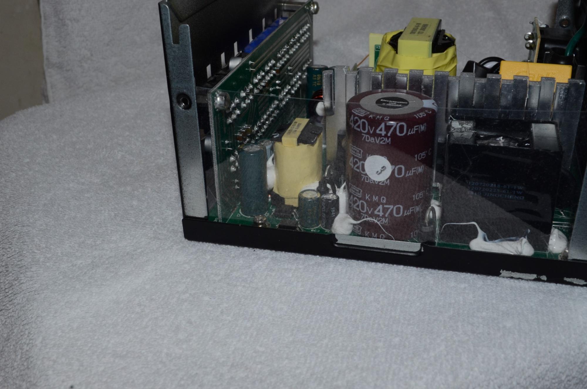

            With the Caps I strongly disagree: I see 1 Taicon and a bunch of Teapo SC. I'm fine with that.
            The JunFu/AsiaX and ChengX mix in CWT GPS units worry me more...
            https://www.silverstonetek.com/produ...id=813&area=en
            People not knowledgable about electric stuff want the shit be modular.
            I'M fine with a semi modular PSU with ATX, CPU and one PCIe cable with 2 connectors hardwired.

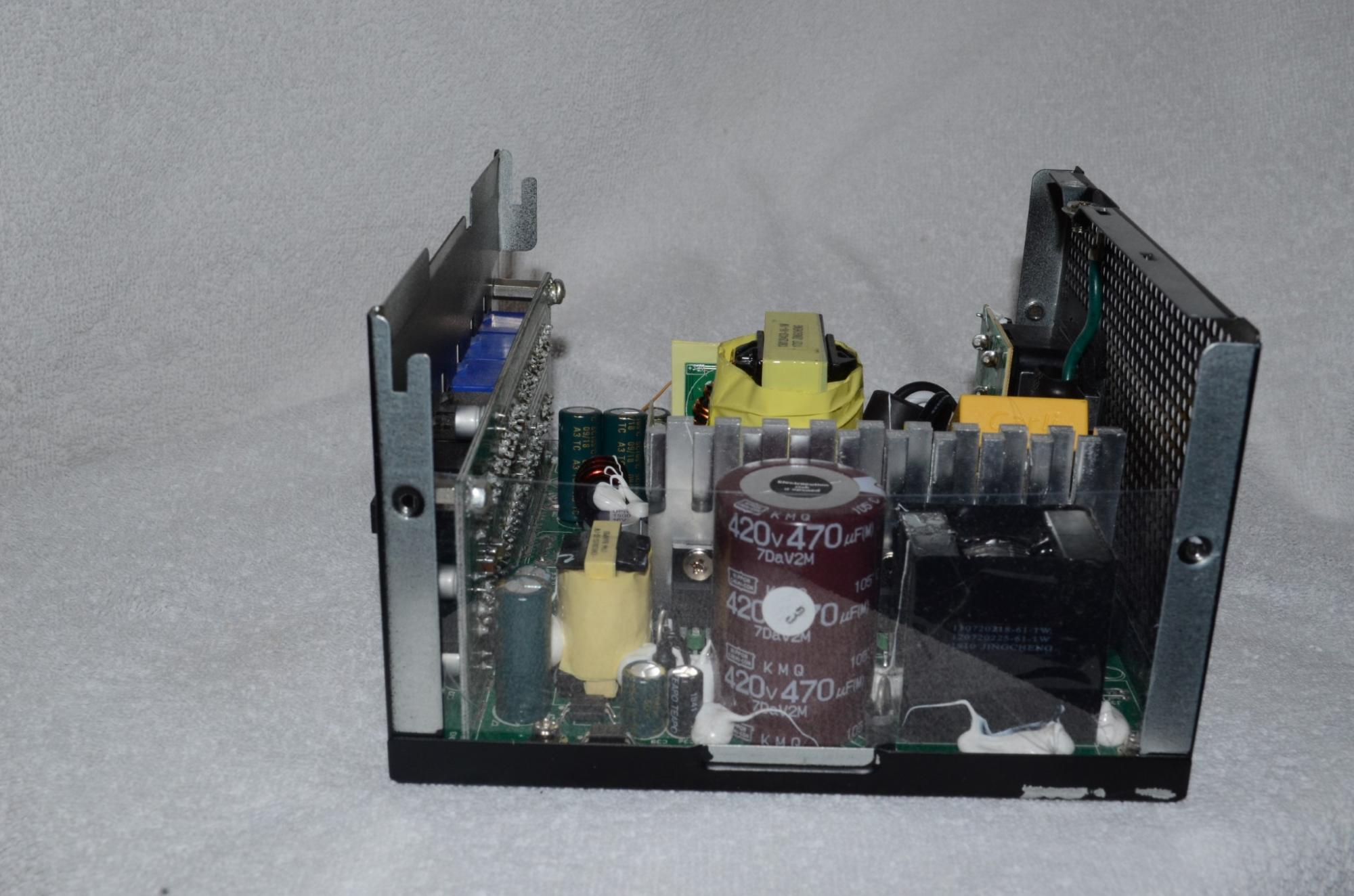

            People still consider an almost 10 year old group regulated unit without OCP anywhere, no OTP and UVP on 12V as good, even for 50€ or more, just because "Wapanese Caps", wich are made in China anyway because Import Tax...
            Ähm, its 650W and possibly 750W as well.
            The 2 Polymer Caps are whopping 1500uF/16V ones.
            So the capacity on 12V is at least the same as the CWT GPS thing, that one:
            https://img.tweakpc.de/image/dsc-4476-andere.FEe
            Has 6x470uF/16V and 2x2200uF on 12V...
            This one has 2x1500uF + 2x2200uF/16V right next to it. However, there is a big 3300uF/16V Cap right next to the DC-DC Module...

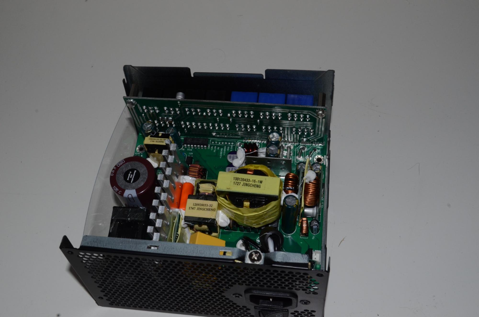

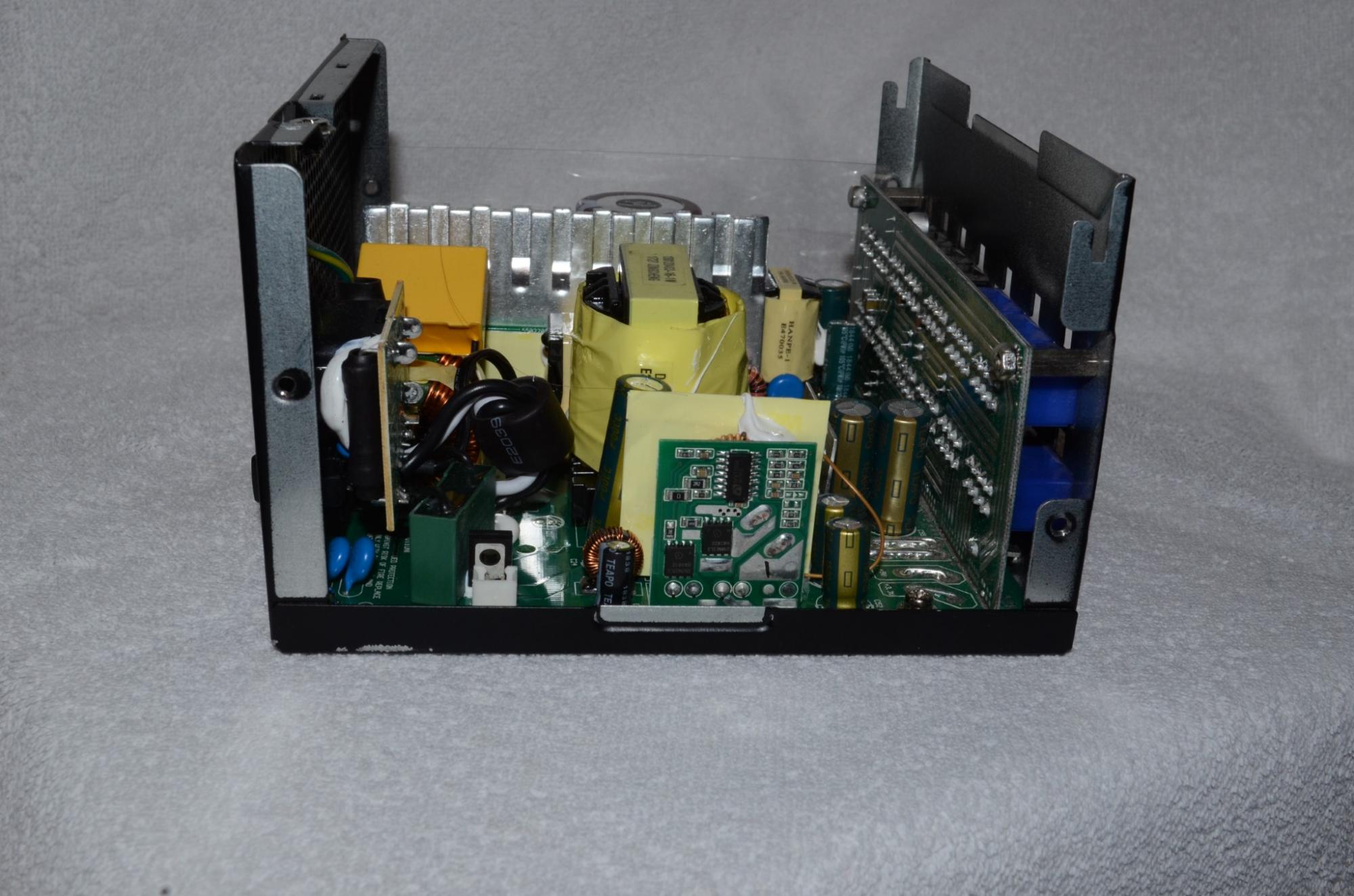

            No, its not semi-fanless (pls bash Seasonic and Corsair for that shit) and it has a rather high fan speed.
            What I measured is around 800rpm or so. Of course only 120mm. And a sliht sirring sound. Not too annoying like the Hong Hua Fan in the CWT GPS I linked above. And that one was 750W...
            Just some nice note:
            The +12V Rectifyer are heatsinked to the Case with a big Thermalpad, wich is a nice touch.
              Yeah, well I don't spend all day reading PSU reviews or do enough builds with Silverstone PSUs to know that.
              Because you have the unit in front of you. I can't see jack-schit from those pictures.
                Oh well, its enough that you know how to repair them
                That's a Skill I don't really have so my old 420W Super Flower (Silentmaxx) unit died for no reason...
                OK, you want more pictures. Why don't you say so?
                Your wish is my command:

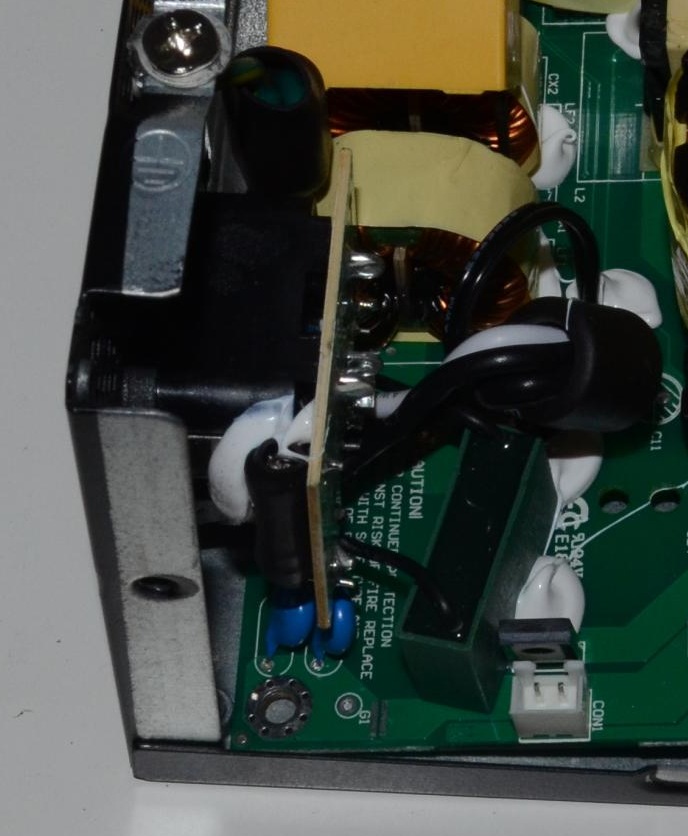

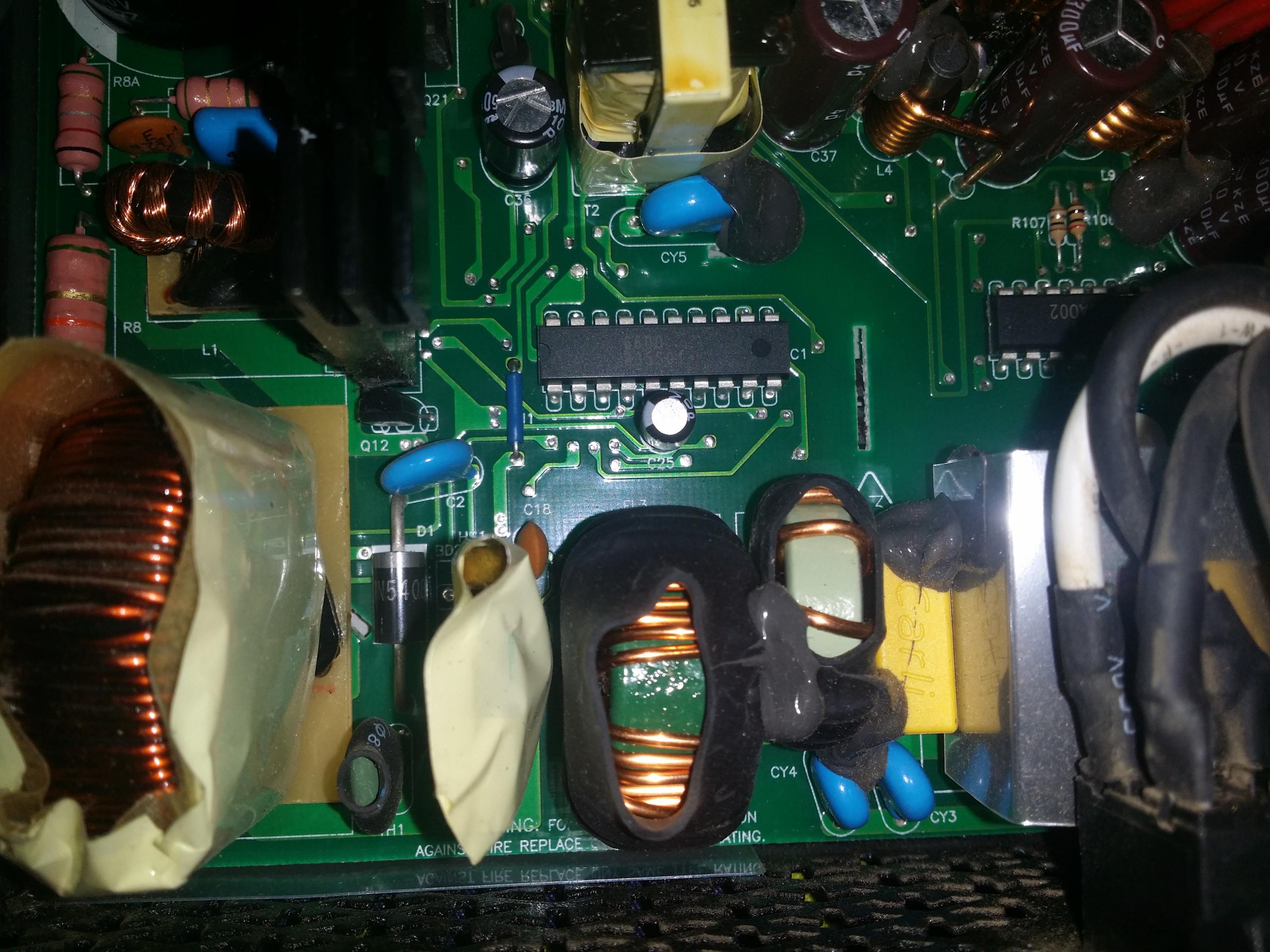

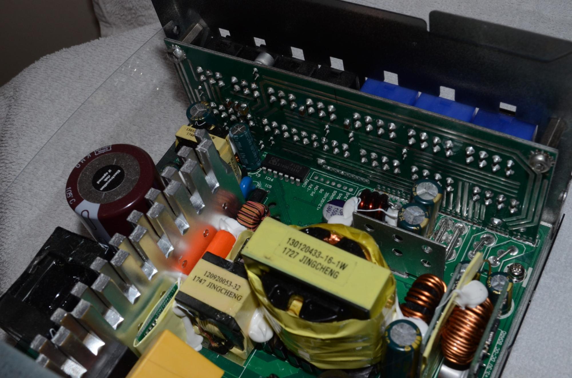

                  It's pretty funny that they could not find a spot to solder the X capacitor to.
                  Considering it's actually glued ontop the main PCB maybe it would have fit there lol
                  Or on the input PCB mounted on the backside, or make that a few mm larger.
                  But no, lets's just put some flying wires and hot snot, she'll be alright
                      I did - I wanted a picture of the label!
                      But I suppose all the other pictures you posted will do, too.

                              #3014
                              FSP Aurum 550w CM
                              Primary Side with 450V Panasonic HC Capacitor
                              Secondary Side With Nippon Chemicon KZE Capacitors. Daughterboard handles protection duties.
                              Barely visible on the chip due to lighting,FSP 6600 IC.
                              Transformers. Massive 12V Coil.
                              Transient Filtering.
                              All capacitors are:
                              -Panasonic for Primary Capacitor.
                              -Rubycon for the small capacitors.
                              -Nippon Chemicon for all secondary capacitors,barring the lone Rubycon.
                              It is Group Regulated, based on the active clamp resonant forward topology with synchronous rectification.
                              Phone camera can only do wonders on low light conditions,sorry for the bad pictures.

                                Beautiful ... power supply porn!

                                  Originally posted by Sacon_FZ
                                  FSP Aurum 550w CM...
                                  Nice solid-looking unit.
                                  Only thing I will nick it for is the 270 uF primary cap - seems a bit on the low side for a 550 Watt unit. 330 or 390 uF would have been preferable. More if the PSU is supposed to be "upper" -tier. You can even see there is space on the PCB for a bigger cap.
                                  Other than that, not much else to complain about on this one.

                                        master hoarder
                                        • May 2008
                                        • 12175
                                        • Bulgaria
                                        #3019
                                        Today its to be avoided...
                                        Why would that be? Just because it's group-regulated?
                                        From what I see, most OEM builds today still use group-regulated double-forward (and in some cases, just STF) 200-350W PSUs. It's hardly an issue, even with modern hardware, where power draw variations between idle and max load can be quite large sometimes.
                                        Also, I'm pretty sure the above PSU should have OPP, as just about any single and double forward design usually does. Perhaps you meant OCP? I do see at least one current shunt in the above PSU. though.
                                        • Stefan Payne
                                          • 1267
                                          #3020
                                          Yes and the brutal transient.
                                          Try a double forward with VEGA. Or x080ti from nVidia. That is aweful.
                                          It works but not something you'd want.
                                          The Power Saving mechanisms are just that brutal with modern Hardware...
                                          Öhm, no, not really.
                                          You can't have a group to regulate if you don't have a group, can you? ;-)
                                          Those PSU are usually single voltage.
                                          Maybe, maybe not. I know that old first Generation HEC units back in the day had a pretty brutal Voltage drop.
                                          But why risk it when you can get lower end DC-DC units for 40€ and every mid range from pretty reputable Manufacturers have DC-DC anyway...
                                          FSP Aurum ain't no Double Forward Design.
                                          Its Active Clamp Reset.
                                          Based on the Proprietary FSP6600 series for the primary and secondary (3,3V only) 6601. My be quiet Pure Power 10 with independant regulation has two of those FSP6601 on a modular Board.
                                          Here Picture:
