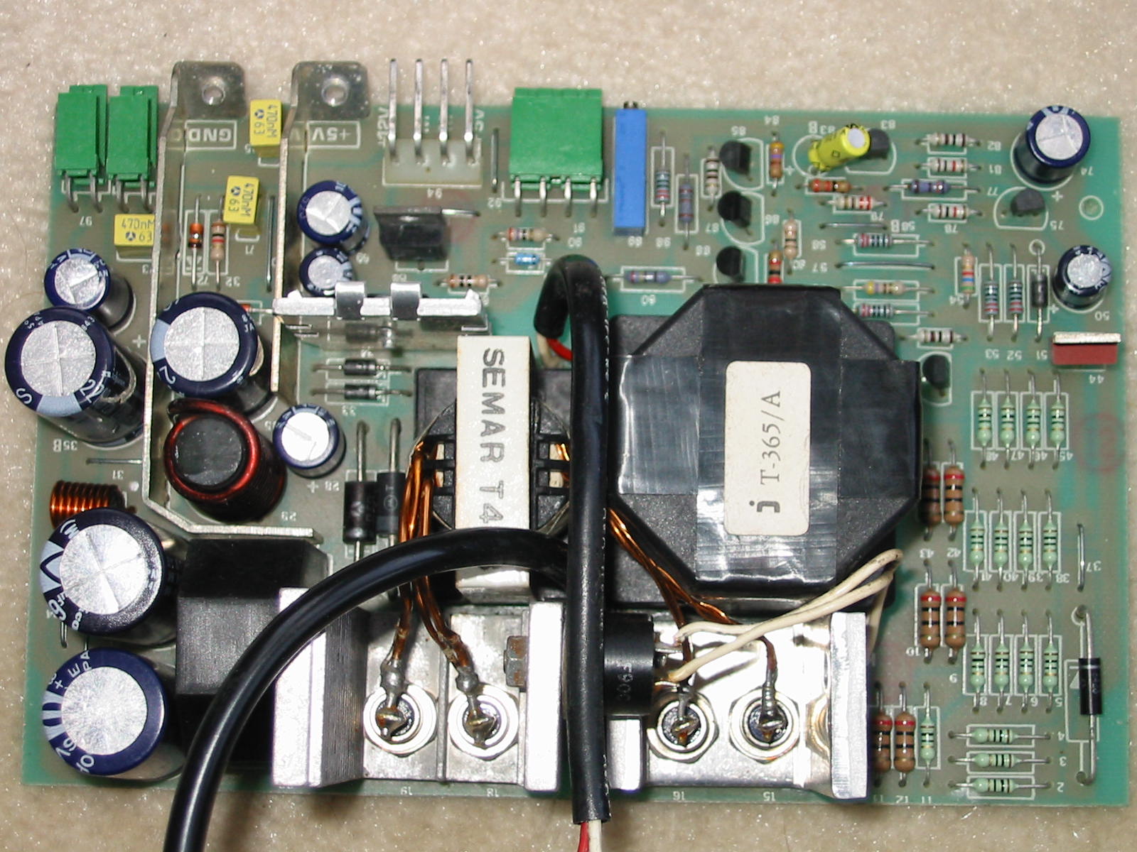

    Originally posted by momaka
    I'm also surprised only "350V" caps were used for the input. That's obviously cutting it a bit close, as a 230V AC line comes out to about 325V DC.
    We have 230V since 1997 before it was good old 220V.
    These capacitors are connected in series so they could handle the rectified ac even now.
    But most of the electrolytic caps have to go. Some measured so leaky and high esr that could be part of the many problem the unit has.
    Btw Line and Neutral are fused since there wasn't really a standard how the AC socket was wired.
    Wow! That almost looks like it was hand built by a hobbyist!
    Check out how the primary of the main transformer is connected. That modification is all genuine factory condition!
    Keep in mind that it's a 286 PC commie knockoff unit. Not something that was made on the US
    I might be able to contact the original engineer who worked on this model. I'm still trying to figure out some values of some foil capacitors and resistors. Markings have burned or peeled off...

        Originally posted by pdavid
        IMB PC compatible power supply from the late 80s Hungary.
        More pics pls!

            Originally posted by Stefan Payne
            More pics pls!
            Date codes on parts are ranging between 83-89. Lots of Ukranian/Russian resistors. Inductors/magnetics, electrolytic capacitors are from Hungary. Back then the the COCOM list was in effect, so a lot of advanced western parts weren't allowed or quantity was limited to be imported to the USSR and it's allied states.
            I'm going to create a separate thread for this historical piece and about the restoration process. It's going to take some time.

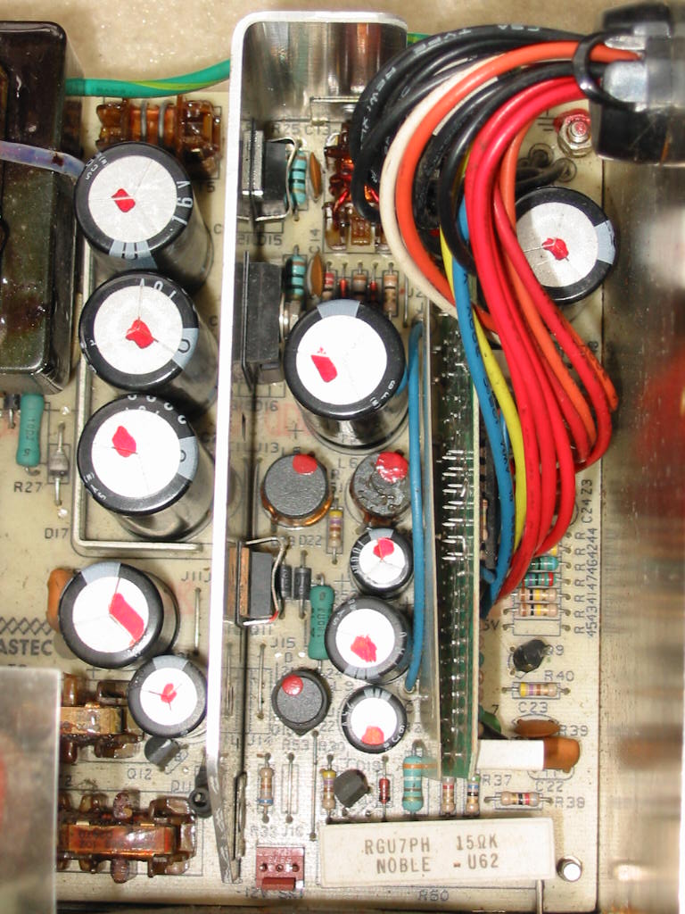

              Astec AA12156 [IBM 6447192] AT power supply
              So I got five (5) old power supplies off of my local CraigsList in the summer. Owner said they were bad / failed bench testing many years ago. I still haven't tested any of them yet. But as with anything I get from CL, first I open it and clean it, to make sure there are no roaches or other pests. And with that, I also take pictures.
              For today's PSU, I have an old Astec AA12156 [IBM 6447192] power supply for you. Looks like mid-80's vintage – AT form factor (I think!) with the usual AT motherboard connectors, along with a few Molex and floppy drive connectors. There is also a big switch on the PSU case.
              https://www.badcaps.net/forum/attach...1&d=1547532390
              … and a close-up of the label shot:
              Adding up all the currents, looks like the 5V rail is rated for 15 Amps, the 12V rail for 4.2 Amps, the -12V rail for 250 mA, and the -5V rail for 300 mA. That adds up to 130.9 Watts total output. The label, however, doesn't say what the power supply is actually rated for, so I don't know if that's the real rating or not. Thus, let's see some pictures of the insides.
              Overall shot:
              I like big CAPS and I cannot lie, you other brothers can't deny.
              Looks well built, I'd say. Besides the big caps, the main transformer is also quite chunky. Wires are all 18 AWG. There is also a dedicated input EMI/RFI filter board – something that Astec did on quite a few of their old PSUs.

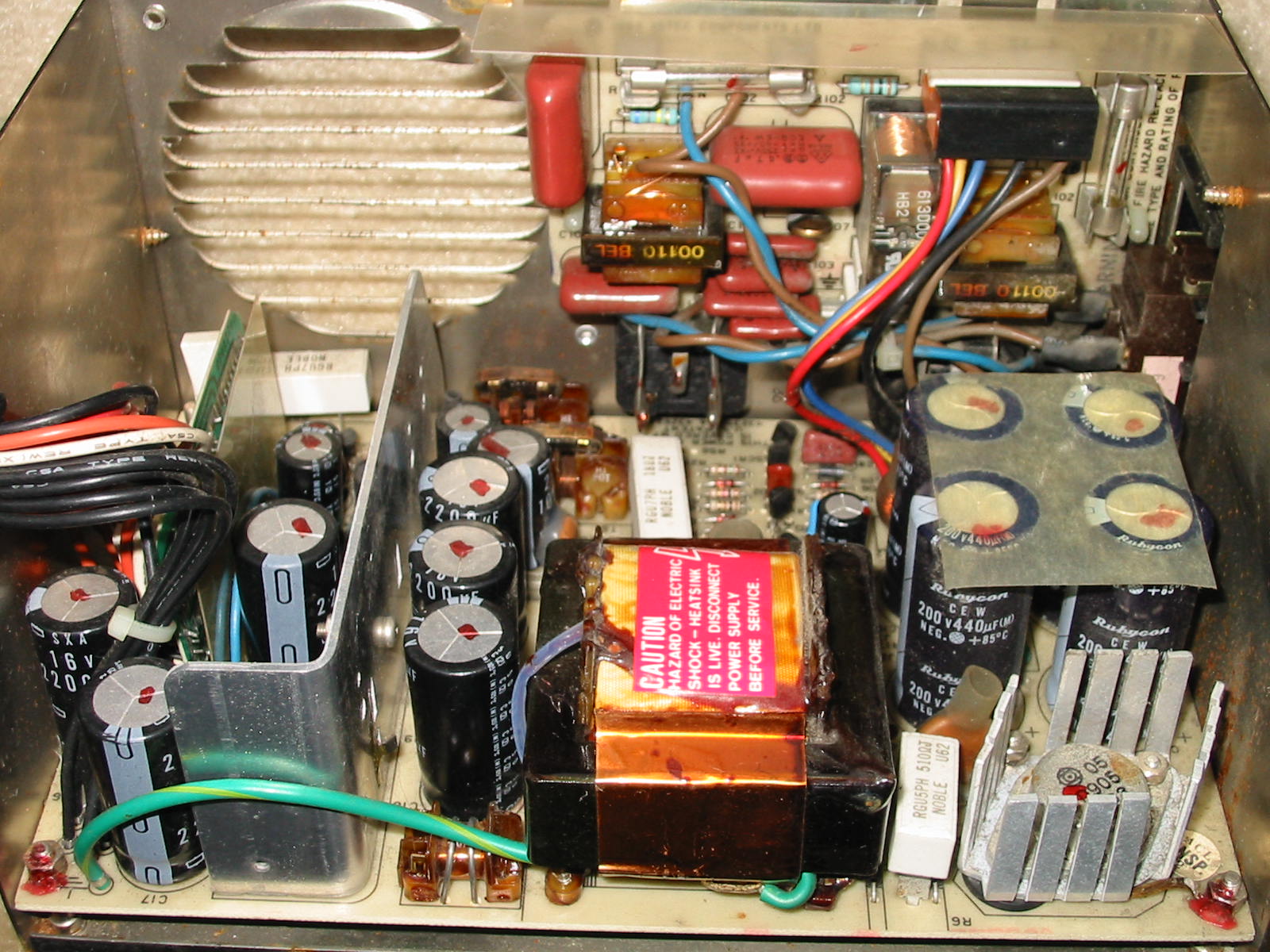

              PCB suggests the design is from 1984. We have two fuses, a relay, two transformer-like components (I am going to guess these are the EMI/RFI common-mode chokes), and lots of PP film caps – some with safety logos, so probably X2 class. The double fuses suggest this unit might be double-pole fused (i.e. a fuse on both Live and Neutral). And I'm not sure if the relay is used just to bypass an NTC inrush current limiter / thermistor (which I don't even see.) or an automatic line voltage selection for 115V and 230V modes. I know Astec did the latter in some years later, like with the Astec PSU in my NetServer E-800 did (posted here a few pages back.) I don't see any Triacs, though, so maybe not.
              Next, a shot from the back… or is it the front?
              Here you can see the capacitors a little better. Input has 4x Rubycon 200V, 440 uF caps (most likely wired as two sets of parallel caps in series for the voltage doubler – i.e. 440 uF total capacity at 400V.) Now that's some serious input capacitance! -Especially considering the low output ratings. But that's just Astec quality. The output filter capacitance seems equally serious, with a total of six (6!) United Chemicon SXA,16V, 2200 uF caps. Unfortunately, I couldn't get this unit opened fully, so I didn't trace how they are connected. Either way, I'm sure at least 3 or 4 of these are for the 5V rail, with the rest for the 12V rail. The -12V and -5V rail are probably filtered by the “smaller” capacitors behind them.
              As this shot shows…
              … there is no toroidal inductor on the output after the main transformer, so this unit likely utilizes a flyback design. This would explain the large capacitors on the output. We also see two TO-220 components and one TO-247 component on the secondary heatsink. I couldn't read their numbers, but most likely the TO-247 is the 5V rectifier and one of the TO-220 components is the 12V rail rectifier. The third one I'm not sure about – could be a 7912 or a 7905 linear regulator for either the -12 or -5V rails, respectively (more likely a 7905.) But again, I couldn't get the main board out, so I couldn't read any of the part numbers. Same goes for the components on the small daughterboard on the secondary side - there is a 14 pin DIP chip on there that I'm not sure what it's for (I suppose this is the first time I make such detail-lacking post here. )

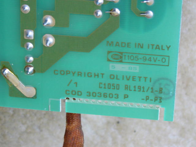

                    #2989

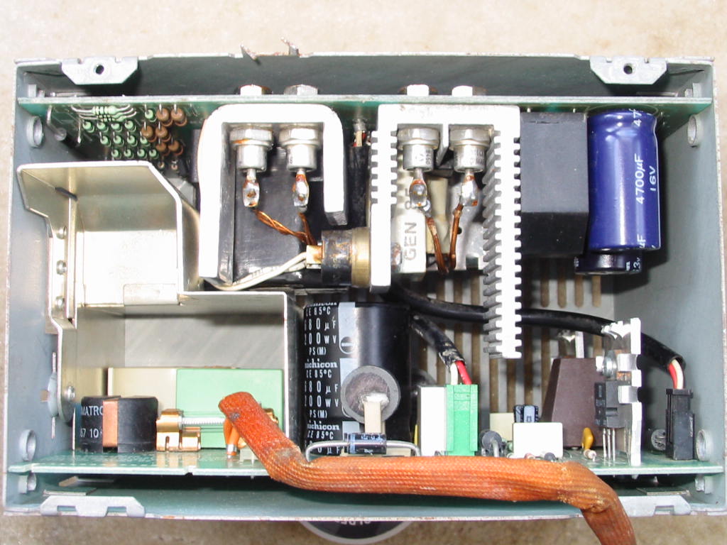

                    ALI LA 16 - MACOM [RL191 1-b] AT Power Supply
                    Another old PSU from the 5 non-working PSUs on Craigslist. I don't know if this one is AT or not and what it came out of or what it was used for. So if anyone has more info, please feel free to share it. Meanwhile, here are the pictures of the unit:
                    https://www.badcaps.net/forum/attach...1&d=1547939016
                    And here is a picture of the label:
                    I think it's a very old power supply, possibly even before AT standard (main frame or whatever it is called?), or perhaps just a custom-made unit for who-knows-what kind of computer. In any case, this unit does not have any standard output connectors aside from the two Molex drive ones. The thick 0 AWG red + black wires connect to the units 5V rail and ground, respectively. One set of the thinner wires has 12V and -12V, IIRC, and the other -5V and ground. As for the label – it doesn't say much regarding output power. And I'm not even sure if the “ALI LA 16 – MACOM” on the label is the model number or not. Anyhow, let's continue with the internal pictures.
                    Front cover removed, exposing the internal dual-PCB layout of the unit
                    The bottom board is the primary side and the top one the primary side.
                    To get the PSU taken apart, the PCBs slide out, leaving an empty metal shell
                    I don't know if this picture can give any prespective about the thickness of the metal used for the case… but I must say, this is the thickest sheet metal I have seen used for a PSU case – it's about twice as thick as that of any well-made PSU today, and very heavy. Clearly, we won't be dealing with a cheapo PSU here. I mean, take a look at the input connectors and their wiring too:
                    … properly color-coded, with removable clamps. Wire were 20 AWG, 600V, IIRC, which is probably okay for this unit.
                    Next, a shot of the primary-side input filter and protection components, sitting under a metal shield:
                    And here is the rest of the primary side:
                    We have two big Nichicon 200V, 680 uF caps, four diodes next to then (for the bridge rectifier) and two Aluminum heatsinks with the two switching transistors. Also note the 110V/220V jumper selector on the PCB. As for the two components with what appear to be short ferrite cylinder buttons… I have no idea what they are. MOVs? NTC thermistors (more likely)?
                    Speaking of the switching transistors…
                    … a pair of BUV47R NPN BJTs, rated for 9 Amps continuous… and [B]Made in Italy[b], it appears. If I had to guess, this unit uses half-bridge topology. The black “pyramid” component between the two BJTs is their driver transformer, also made in Italy! (Now, is anyone curious enough to call the telephone number listed on it? )
                    For anyone that wants to try and figure out all the questions above about the primary side, here is a PCB shot of the solder-side:
                    And in case the info written on the PCB is not too clear…
                    https://www.badcaps.net/forum/attach...1&d=1547939133
                    I am guessing that above is the PCB number (the “C1050 AL191/1-B”.) And again, we see another “MADE IN ITALY” label… so perhaps this PSU was all made in Italy, after all - nice!
                    Let's move onto the secondary side PCB.
                    Here, we see two transformers of some sort (one is probably just the output torroid), the output rectifiers and caps, and also some TO-92 components likely used for making the “logic” of the unit. Speaking of which, I don't see any ICs anywhere, so it must all be done with those TO-92 components. Most of them were just small transistors too, IIRC. Here's a closer picture of those “logic” components that are used to drive the primary-side transistors:
                    Next, the output rectifiers – old-school case-mounted diodes
                    And then the output filter caps:
                    Here we have a 6.3V 10000 (10k) uF and a 10V 2200 uF Nichicon 85°C general purpose caps for the 5V rail. The 12V rail is done by that single 16V 4700 uF blue vent-less Panasonic cap, IIRC, along with another smaller Panasonic cap. And the other caps are for the -12V and -5V rails, if I am not mistaken.
                    Here is a “front view” of that secondary side, particularly where the connectors are:
                    As you can see, the 5V rail has a steel… well, rail to accommodate for the output current. Same goes for the ground return path for that 5V rail. I assume the blue trim pot is for adjust the voltage? Another thing: the -12V and -5V rails are produced by a pair of 7912 and 7905 regulators, respectively. Also, when I looked at the secondary side, it appeared that the 4700 uF cap for the 12V rail was bulging from the bung. Moreover, the 10000 uF Nichicon cap for the 5V rail certainly had a slightly rounded vent. I tried pushing against it, but it was hard as a rock. So most likely that cap is/was starting to go bad at some point… or was it?
                    I was curious, so I pulled both the abovementioned caps and put them on my cheap ESR + capacitance meter after reforming for a minute @ 5V with a 10K series resistor. This is what I got:
                    Believe it or not, both of these caps are still in spec. The 4700 uF Panasonic is a bit high on capacitance, but still well within its 20% tolerance.
                    And finally, a shot of the secondary PCB's solder side:
                    Not much to say about it, as it looks rather neat. Again, we see “Copyright Olivetti” written on the PCB, so this must be some custom-made Italian PSU. Anyways, it looks pretty clean and well designed. However, there were a few cracked and under-soldered solder joints that I fixed. Perhaps this is what was wrong with the unit? I'll try to test it some day when I have more time and interest to dig into these old PSUs. Not sure if I'd have a user for anything this old either, but why not, right?
                    That said, if anyone has more info on this power supply, again, just feel free to post it here. Otherwise, that is all I have for now.
