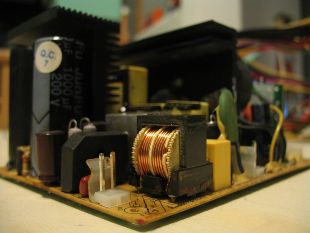

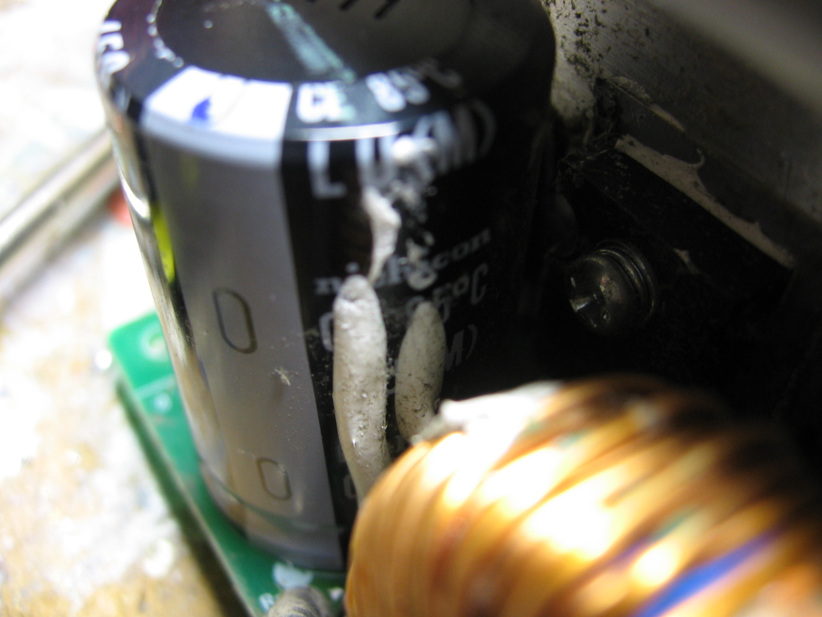

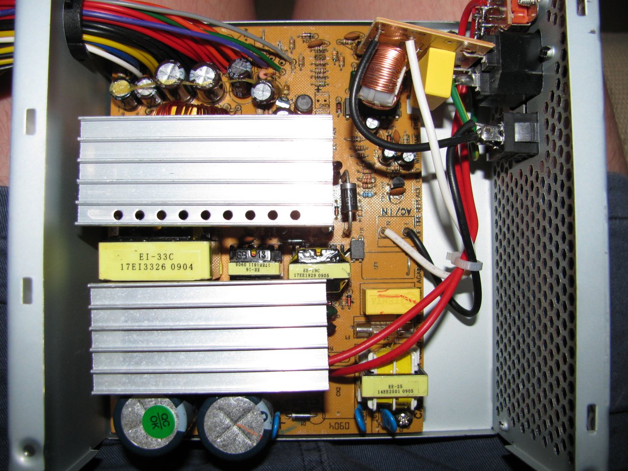

Here a 400W PSU made by Jou Jye Electronic.
I have recapped it because it looks well built, it has a passive PFC, a complete input filter, I forgot to take a pic of the case where another small PCB has another part of the input filter.
I replaced all Capxon with Samxon, Rubycon and 2 Teapo, I left the 2 Jun Fu on the input.
I checked the replaced caps: most of all were good, only 2 small caps 2,2uF 400V were completely ruined, I replaced them with Teapo... I had no other caps with such values.
To be honest I didn't understood why there are those 2 caps: they are connected at the input bridge, between + and -, with 2 diodes and one 2 resistors and the common point is connected on one AC input pin of the bridge. It looks like a kind of "input filter".
Here some pics.
Ciao
GianniAttached Filesif you find these attachements useful please consider making a small donation to the site

I am familiar with these power supplies. In fact I can have as many as I want for free, thanks to the 5vsb Capxon caps that always fail and make the psus not work anymore.
The circuit you mention seems to be a voltage booster.
Here is a schematic I made:
https://www.badcaps.net/forum/attach...9&d=1268165068
https://www.badcaps.net/forum/attach...0&d=1268166583
I think that the best thing to do is remove completely those 2.2uF 400V caps. They get really hot because of the resistors and it is a matter of time to fail, regardless what brand they are.
By removing them, you disable that circuit and the power supply gets noticeably cooler.

goodpsusearch the circuit is identical!!!
I thought it was a kind of filter due to the passive PFC.
It will be very interesting to know the right reason why they put this circuit, I can't see any good reason.
from your post I read:
I read you have removed caps to avoid useless power dissipation, I will do the same.Originally posted by goodpsusearchThere was much heat coming from the resistors and diodes after bridge rectifier and when measuring DC voltage, I got 350-360V!!!
This is way above normal DC voltage generated after bridge rectifier in a typical psu.
So, the circuit among big caps and bridge in that JOU JYE psus boosts voltage when PC is off. With no fans moving, a significant amount of heat is produced, that leads to the board discoloration in just every same JJ psu I have seen...
I decided to put out the small 2.2uF caps and disable that circuit.
Heat produced when psu is in 5vsb only mode is now negligible, and voltage is normal.
