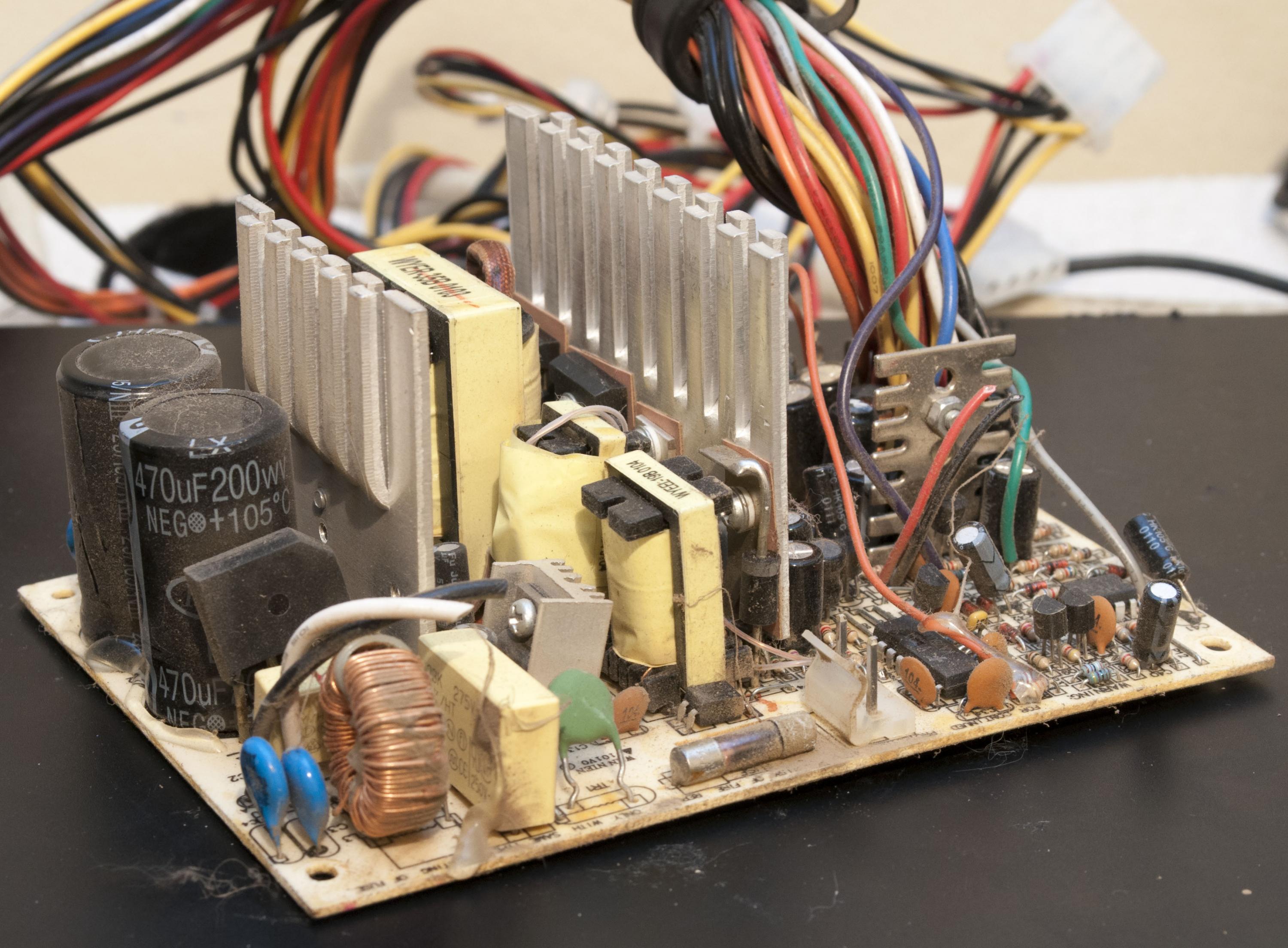

      Next, an overall view with the cover off:
      https://www.badcaps.net/forum/attach...1&d=1460862225

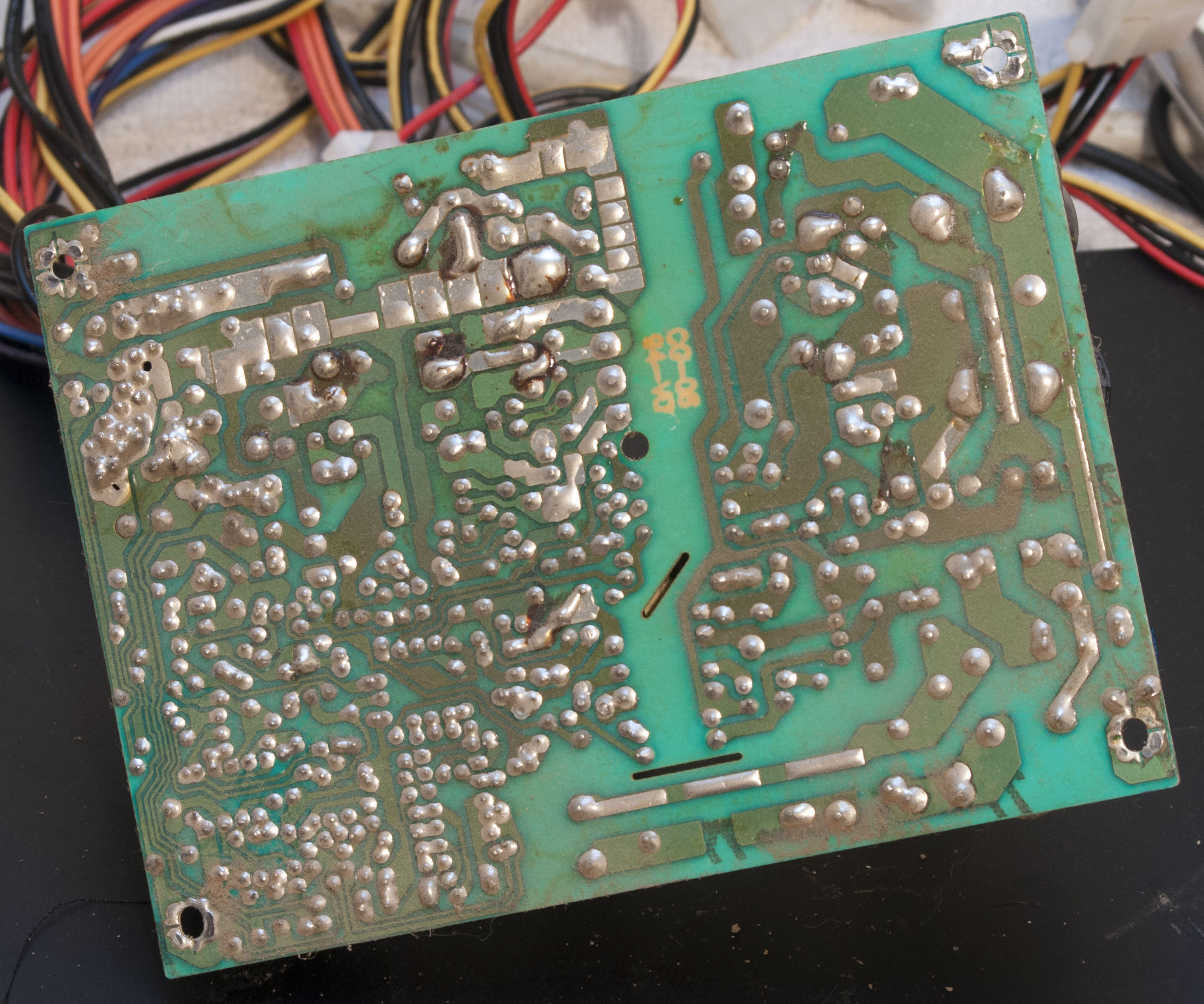

      On the reverse, we see the solder side. Apart from that black wire, it looks clean. No SMD components anywhere here. Also, the solder joints are nice and shiny.

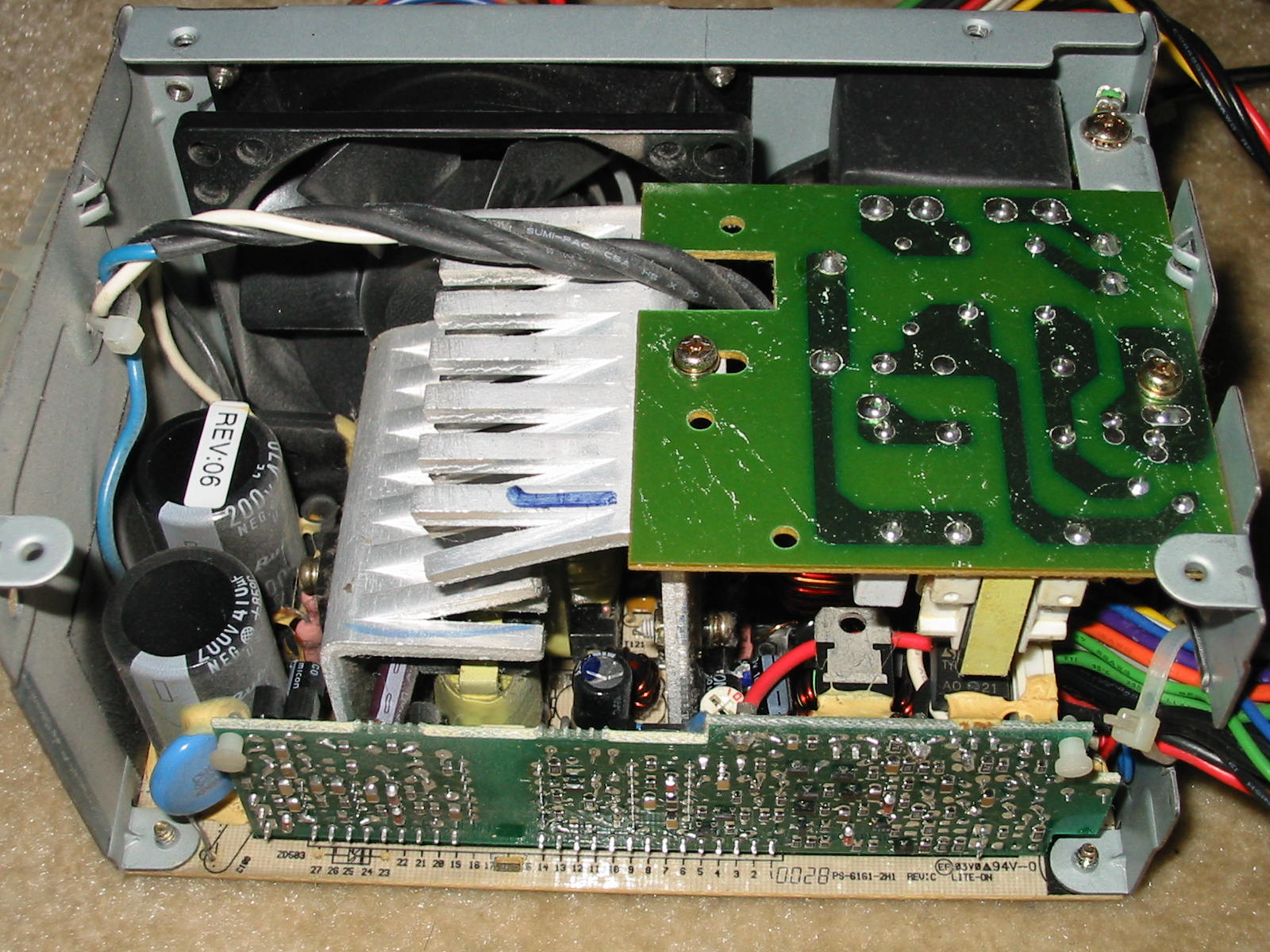

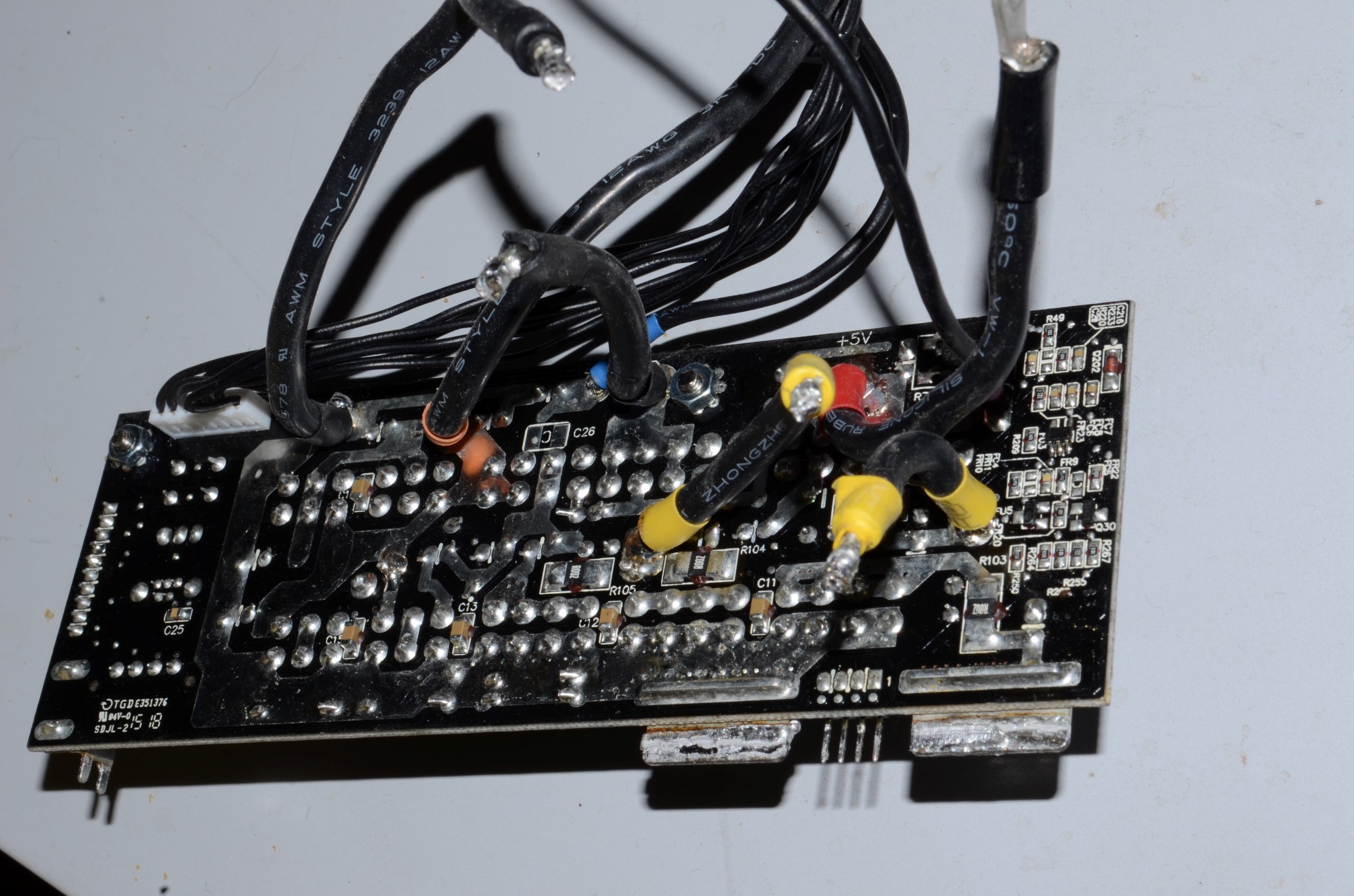

      And the solder side of the logic daughterboard – more clean soldering here, though this one does have lots of SMD components.

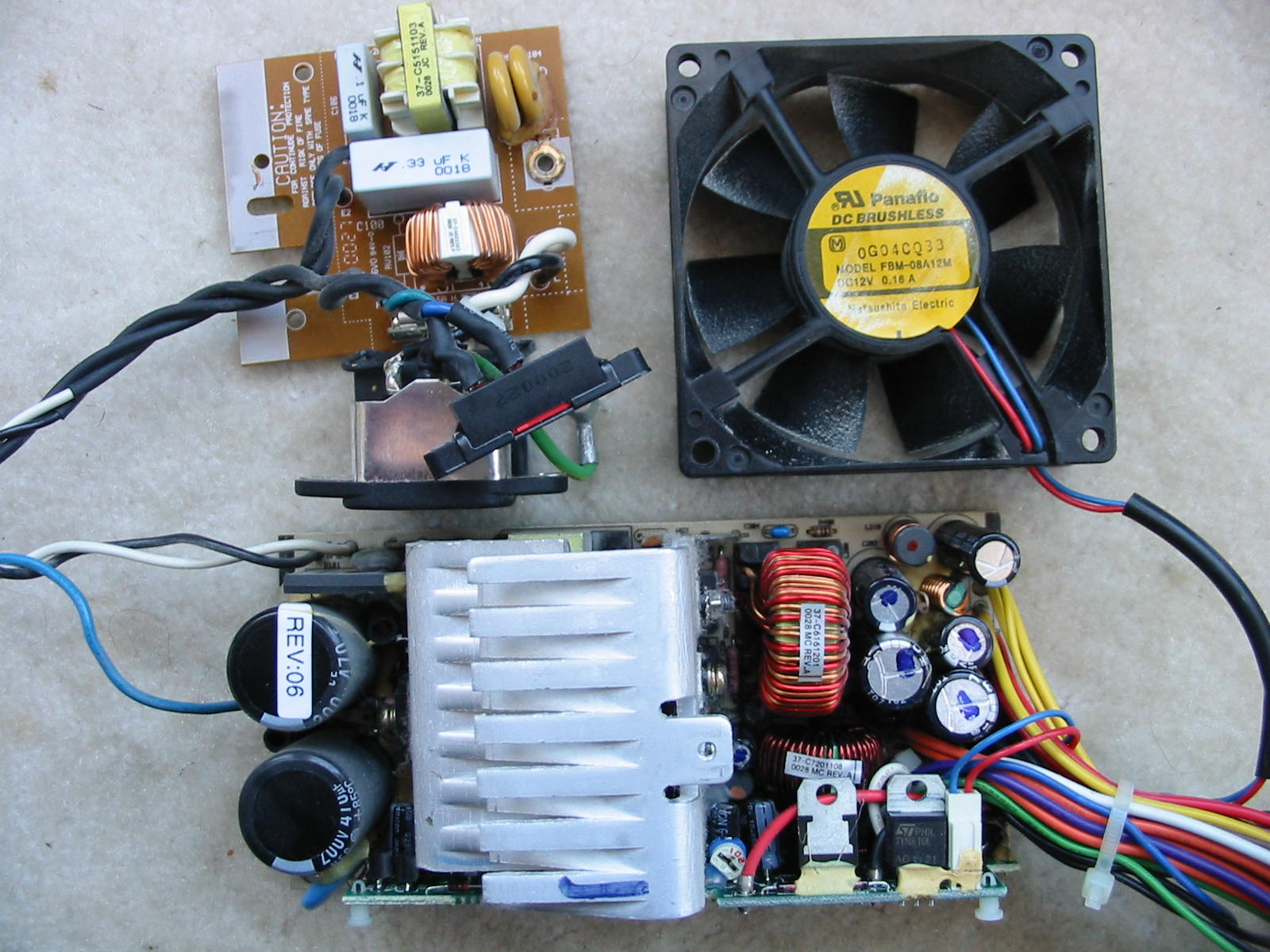

      Unpacking and removing everything from the case reveals the arrangement below.
      Although the PSU is very compact, it has everything on there. Quality really is top-notch (I’m sure many of you PSU freaks have already noticed the “T” vents on the secondary, but more on that in a bit ). Even the fan is premium – a Panaflo FBM-08A12M (80 mm diameter, 25 mm thickness). And here is the filter board for the input:

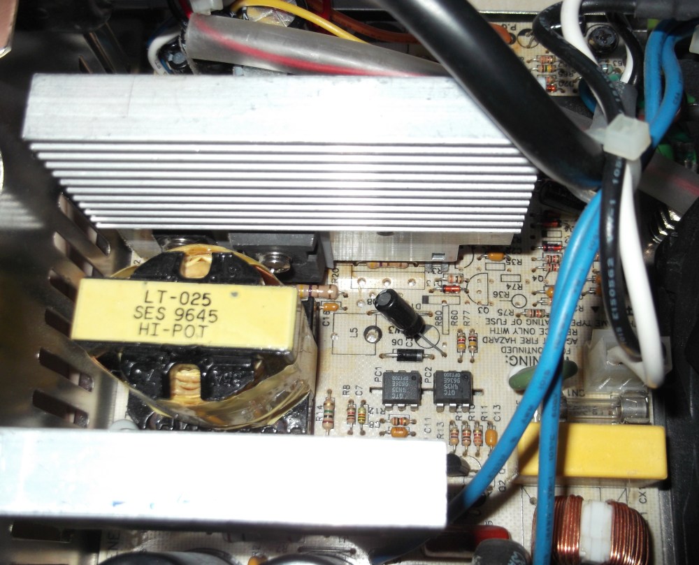

      Now let's have a closer look at the primary side under the heatsinks (which, by the way, are definitely more than adequate for a 188 Watt PSU). Topology is single transistor forward with a 2SK2654 transistor in a TO-3P case. Main transformer appears slightly smaller than “33” size, but larger than “28”. Personally, I think the primary could handle up to 200-250 Watts continuous.

        Nice PSU! Being 16 years old, it's still in good shape because of the caps and nice fan Do you use it at all?
        The thing is compact but they did good as far as orientation, putting both heatsinks close to the fan. The label states it can run at 50C ambient. Should be fine if you don't live in death valley with your computer outside
        This is a 188W PSU....and it has more filtering capacitance than some 400W! They also used nice and beefy toroid/PI coils.
        What's the wire on the bottom for? Soldering looks good. Not perfect, but good.
        It won't need a recap but it could use some glue removal!
