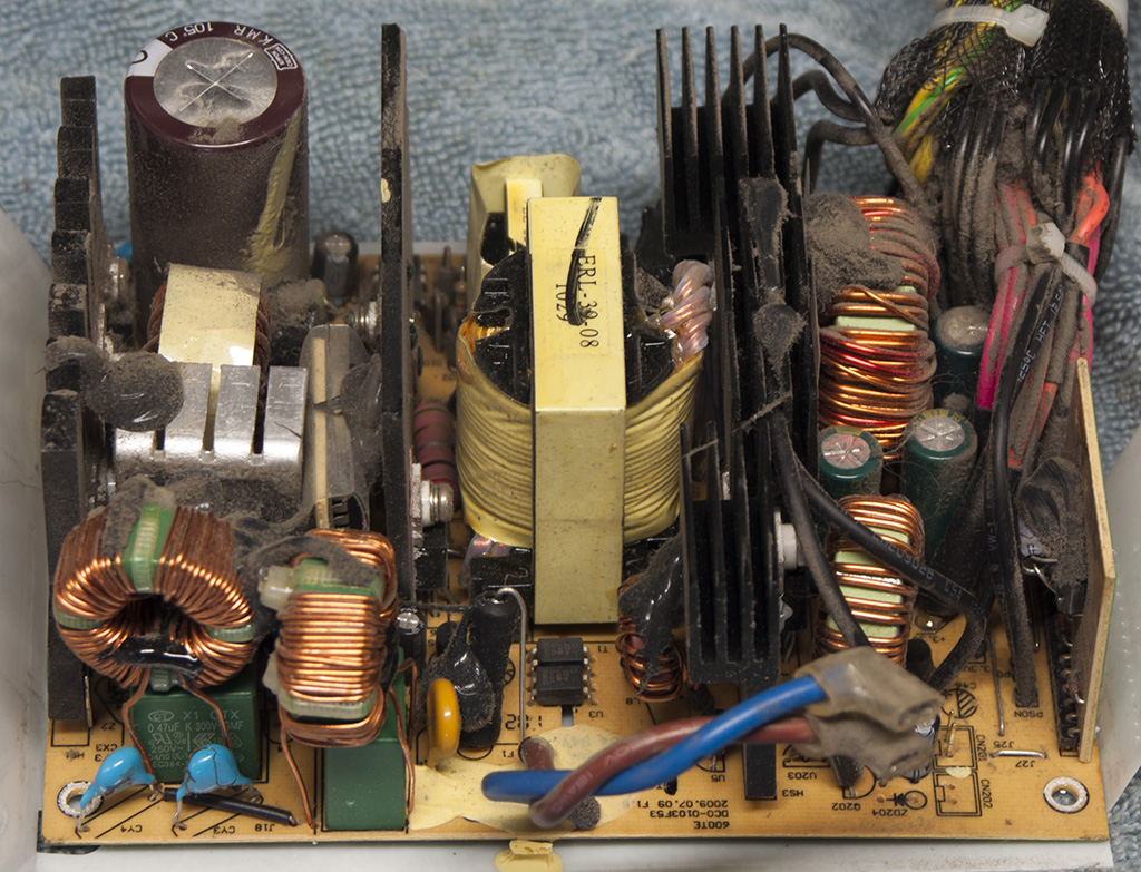

      Picked this up at a thrift store for $2.50, decided to actually get decent pics of a PSU for a change.
      It's a Xigmatek NRP-602. 600W, 80+ Bronze, made by HEC.
      Not a bad looking chassis, all dark grey with nothing special.
      Actually has filter caps, plus the PCB connects using spade connectors rather than direct soldering. That's not something I've run into a lot.
      Once inside the board states it's a "600TE" PCB.
      Caps are a bit interesting. There's a mix of Nippon Chemicon, Teapo and "SK". Not sure who made the SK caps, not Teapo as they're 105*C rated.
      Here's a HEC branding
      Soldering...could be better, not the worst I've seen.
      Fan's just a Young Lin Tech DFS132512H. Seems it's been used in a few Cooler Master PSUs as well.
      Here's full res pics, rather than 1024px downsampled. Didn't want to make you guys wait a week for the images to load: http://imgur.com/a/OAhZ6

        The 105*C "SK" capacitors are likely Su'scon.

          Looks like that'd be them. I guess that means this PSU was built with decent caps, probably alright caps and less than favorable caps.
          Not a huge deal, this'll be reserved for those mid range systems that'll draw maybe 300W on a bad day. I'd never trust a Xigmatek for a proper gaming rig.

            I'm almost certain they're Jamicon.

              Jamicon's SK series is rated for 85C rather than 105C.

                Hec doesn't usually use Jamicon but they use Sus'scon. So it's very probable that those are Sus'scon caps...
                Had such unit on the Chroma 6000 ATE btw.
                Ripple was rather poor on that unit...
                20%, 50% and 100% load:
                Oh dear...
                I haven't seen the voltages on a scope though, so I can't tell how bad it actually is or if it's just some random EM noise bullshit that just looks bad but really isn't.
                Can't say for sure.
                The HEC SIlver Plattform of that time had some problems with somethings like that so it's possible it's the same with this one...

                  Weird to see HEC use a Japanese cap for PFC filtering...I've only ever seen them use CapXon. Yeah those are Su'scon caps, HEC is known for using them. And Su'scon always outlines the capacitor series letters, as seen in 4th picture on that little black capacitor.

                    They're doin it for some time now - since the first Cougar units...

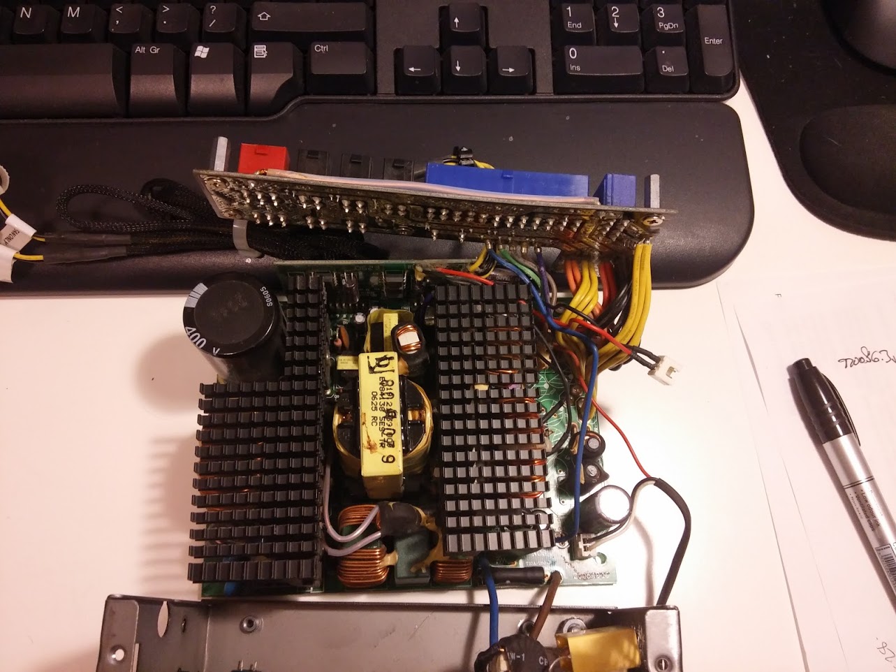

                      Hey guys
                      I am in the middle of recapping an old Jeantec Storm 700w unit I bought way back when in 2007.
                      It was used for a couple of years as my main PSU during the Core 2 Duo era then relegated to server duties for the last 4 years.
                      It has never skipped a beat but the limited reviews about were mixed on it, I thought I would ask what people thought of it? I am still not so clued up about PSU design.
                      The OEM is Sirtec.
                      Apologies the pictures are half way though removing caps.
                      Main filter is a Su 'Scon LZ 470uf 400v (I have left this)
                      The rest were Teapo,
                      1000uf 6.3v x 2 (Near transformers, one vented)
                      3300uf 10v x 2
                      3300uf 6.3v x 2
                      1000uf 16v x 2
                      3300uf 16v x 1
                      470uf 16v x 1
                      Few other 10-2.2uf
                      Have recapped with
                      1000uf 6.3 Panasonic FC x2
                      2700uf 16v FC x4
                      1000uf x 2 16v FR
                      3300uf x 1 16v FR
                      470uf x 16 FR
                      Few other low values with identical FR caps.
                      Hopefully will last another 8 years, what do people think of it?

                        Looks quite decent. Should last many more years with the recap (probably even more than with the original caps.)
                        The only problem you *might* run into the future is with APFC blowing itself - either due to it killing the primary 400V cap or just because APFCs like to fail in general. But when that happens, you just replace the primary cap and remove APFC MOSFETs, and PSU is good as new again. (actually even better, IMO.)
                        Of course, you also *might not* run into that problem ever.

                          Well it powers a i7 920 and a 7870 while running stress on the GPU and CPU at the same time for a couple of hours.
                          Fan got pretty loud and the readout on the back got near 400w however accurate that is.
                          Not bad for a old unit
