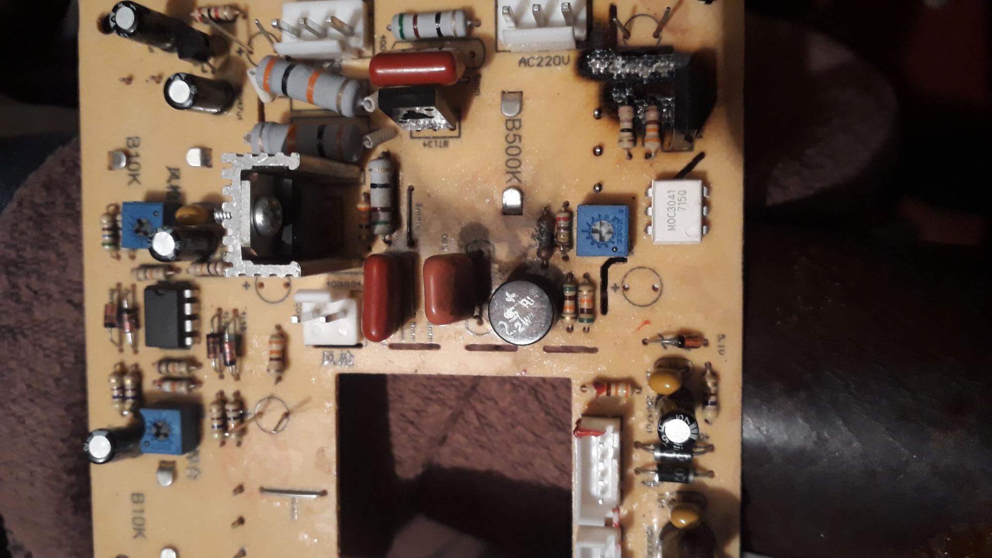

Kada 852d+ need schematic
  • ktmmotocross
    Boardkiller
    • Feb 2014
    • 3622
    • slovakia
    Re: Kada 852d+ need schematic
    damn. still not solved. still running full throtle after few seconds
    • ktmmotocross
      Boardkiller
      • Feb 2014
      • 3622
      • slovakia
      but why it worked after desoldering ic? maybe just another heat to make some component work normal
      • ktmmotocross
        Boardkiller
        • Feb 2014
        • 3622
        • slovakia
        So i think i have broken controller of temp. I try to hook up my iron from another station and it wont turn off on temp like the hotair.
        looks like everything is controlled by that long IC in socket, but it is absolutely nothing marked on it
          • 31214
          count the pins and see where they go - or atleast the power goes on it.
          • ktmmotocross
            Boardkiller
            • Feb 2014
            • 3622
            • slovakia
            loos like it have voltage from that 5V regulator LMxxxx
            Voltage looks everyvhere ok on its pins.
            i was thinking that compressor looks after sensor to cool and shut off, but after power off it cools heater right one minute before turn off, so it is not controlled by it
            so sensor driven controller circuit not work
                I have a KADA 852D+.
                Have not torn apart into it in years... but let me know if you still need any info, like where wires connect and whatnot.
                Mine was a 230/240V version that was re-wired as a 120V version by simply changing the plug by whoever sold it to me. Luckily, I found another transformer from a similar dead station and wired the two transformer outputs in series to get the proper voltages.
                  Someone has a connection to the cables, I burned a resistance, I don't know what value it is
