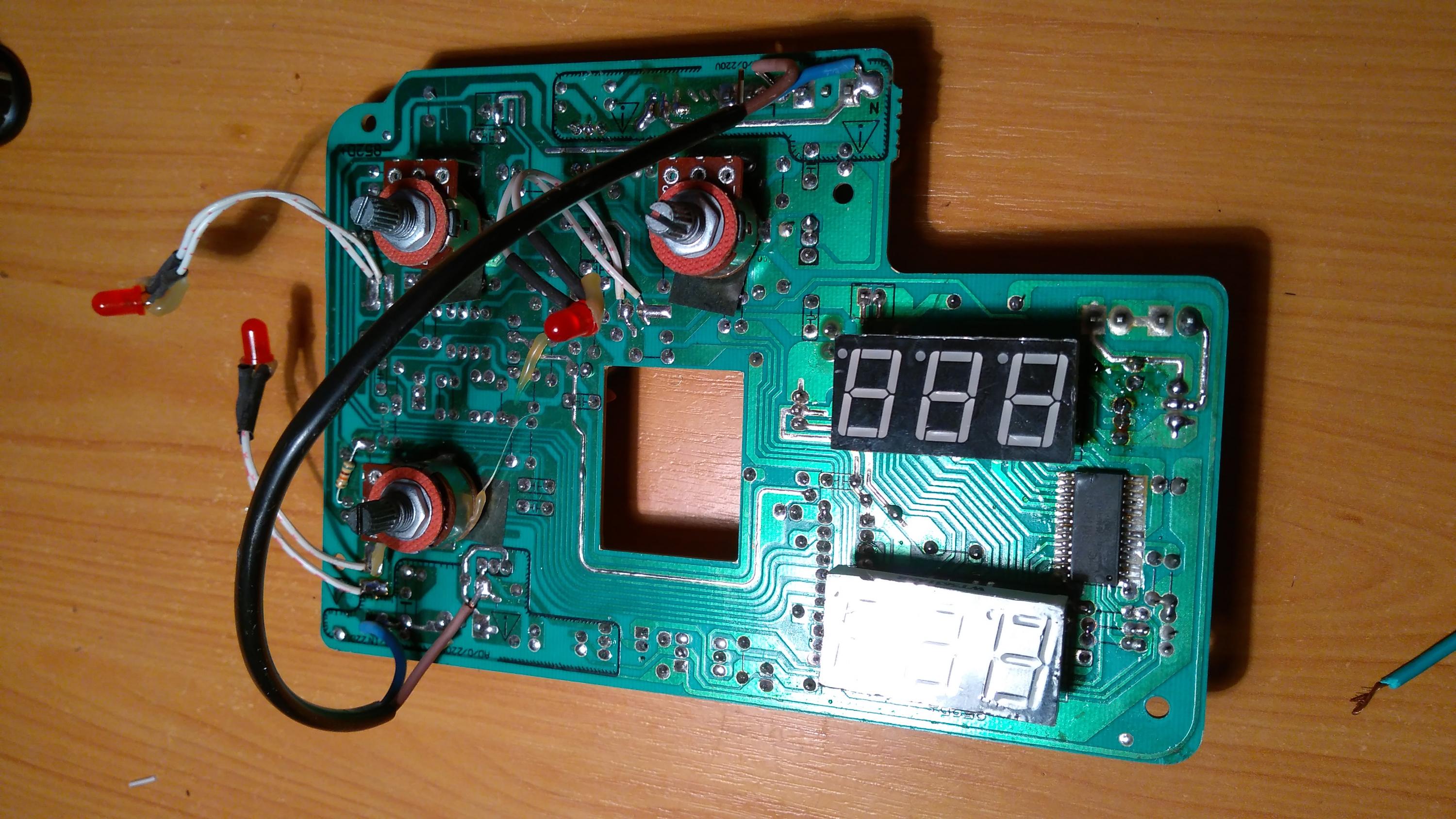

    Hello have this hotair and soldering iron station that is not work.
    have anybody schematic for it?
    • 31044
    Re: Kada 852d+ need schematic
    what is bad, the iron or the air?
    those combo units usually have a different board for each side.

      i allready modified this station wirh my own regulators to use only hot air because its iron is total crap
      but u know i want to learn so i want to repair this board
      i dont measure anything, because i want to first find schematic, if it is awailable
      on picture "SNIM" is marked sensors connectors and "ZHAV" is marked heating elements connectors

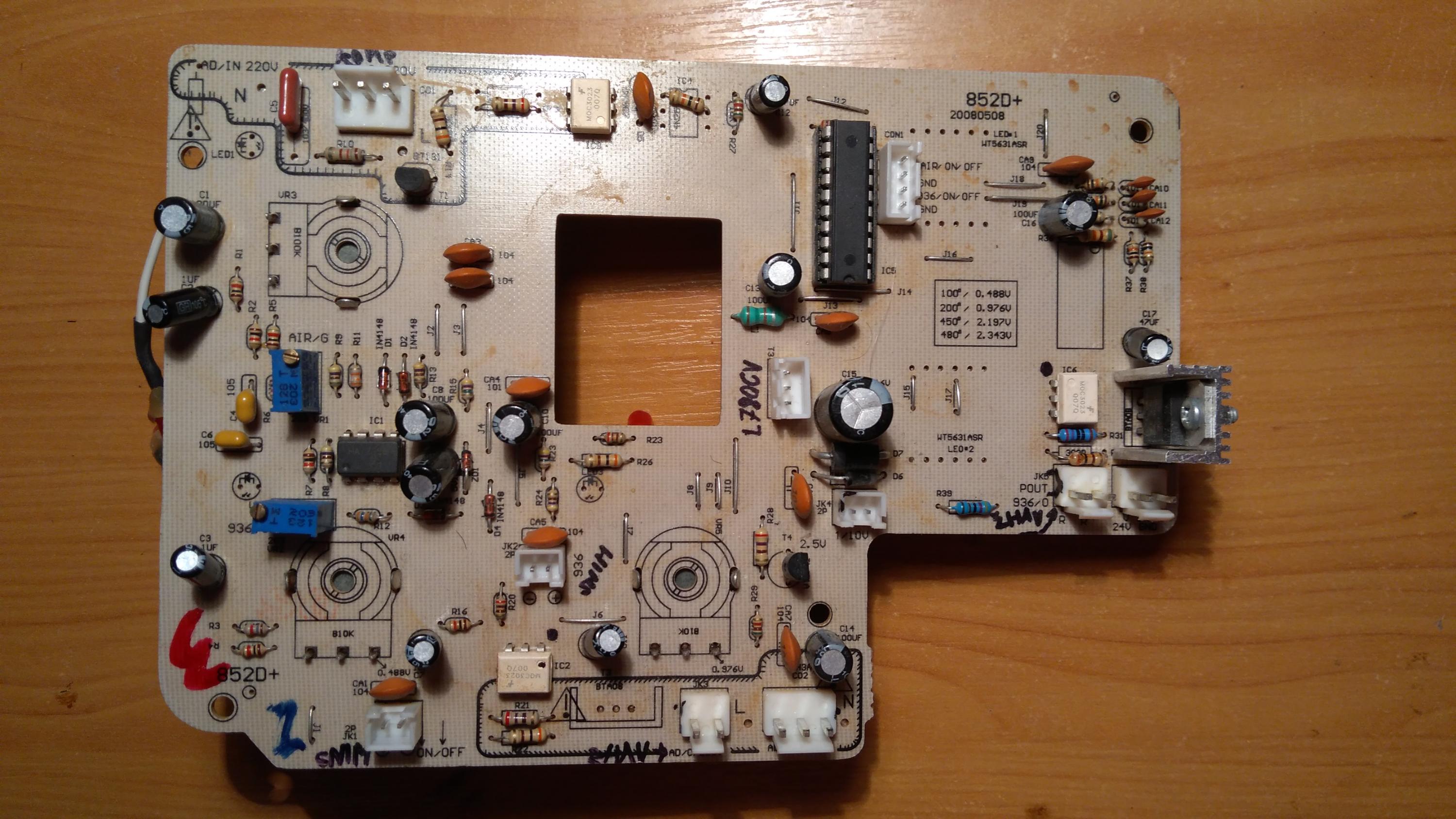

            i realize there is triac missing so i replace it, but now i must measure resistance of temp sensor in heatgun to attach some resistor for testing
            do u think i can replace BTA08-600C with BT139-800 ?
            BTA08 - is 8A and trigger current 5-50mA
            BT139 - is 16A but trigger current is 5-10mA which im afraid of
              • 31044
              139 is better.
              btw, most soldering gear sensors are thermocouples, not resistors.
              they look like a short-circuit and generate a variable voltage that rises with temperature.

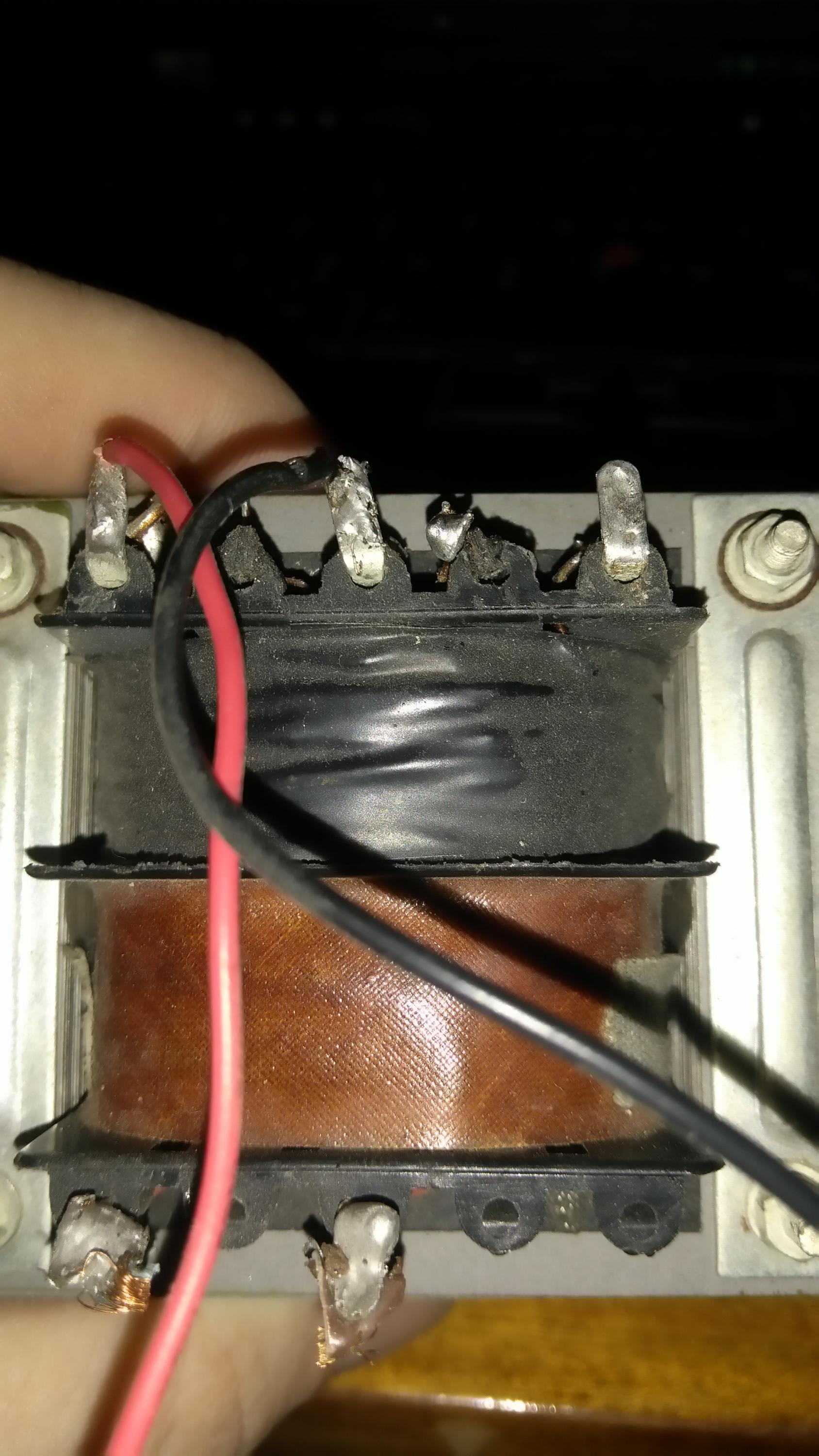

                      and please one photo of secondary windings of transformer, because i found one wire disconnected
                        • 31044
                        the transformer is usually 24v and 9v secondary's

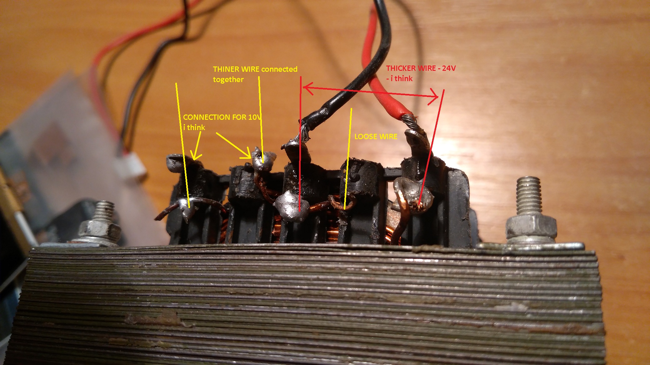

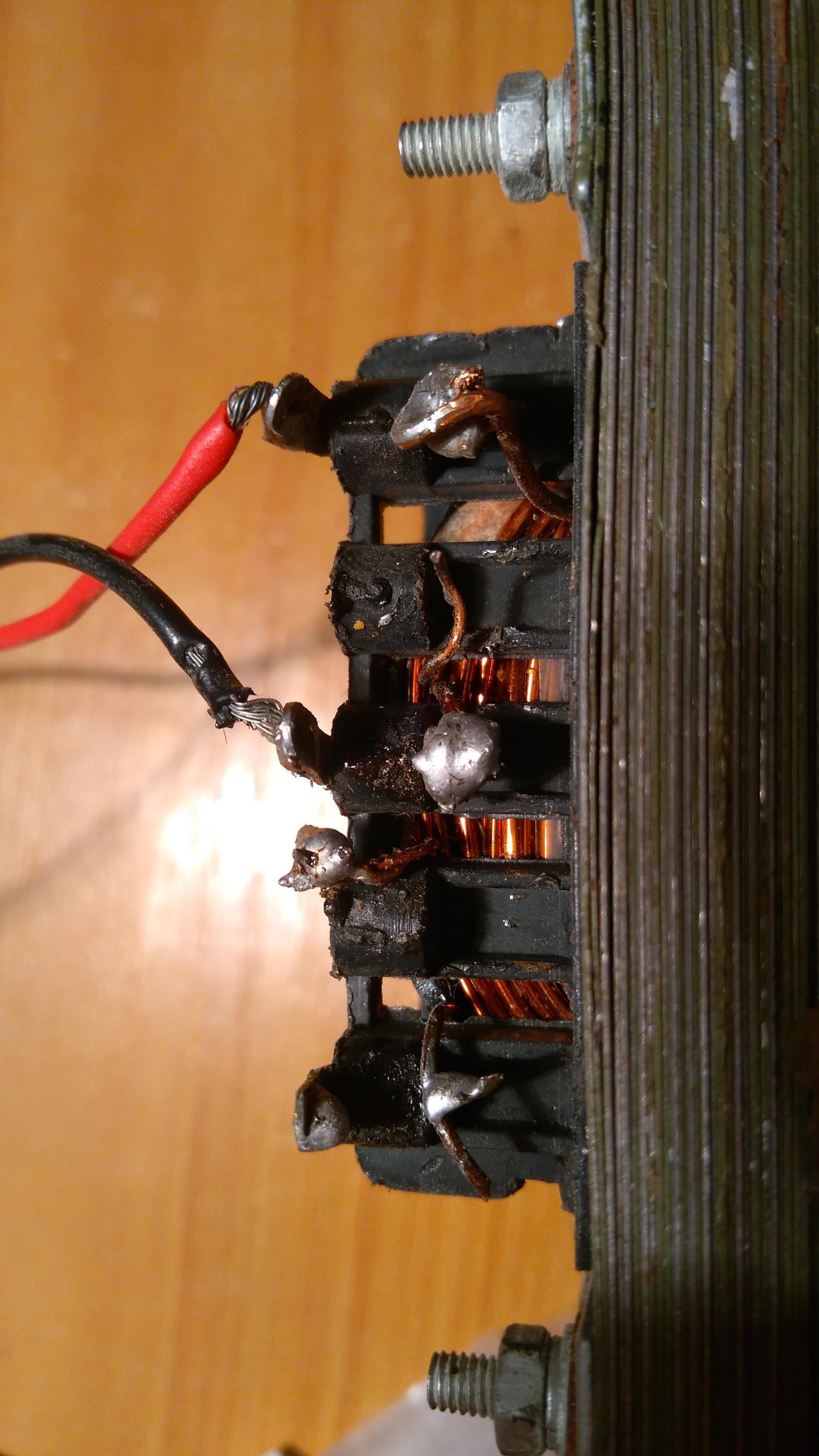

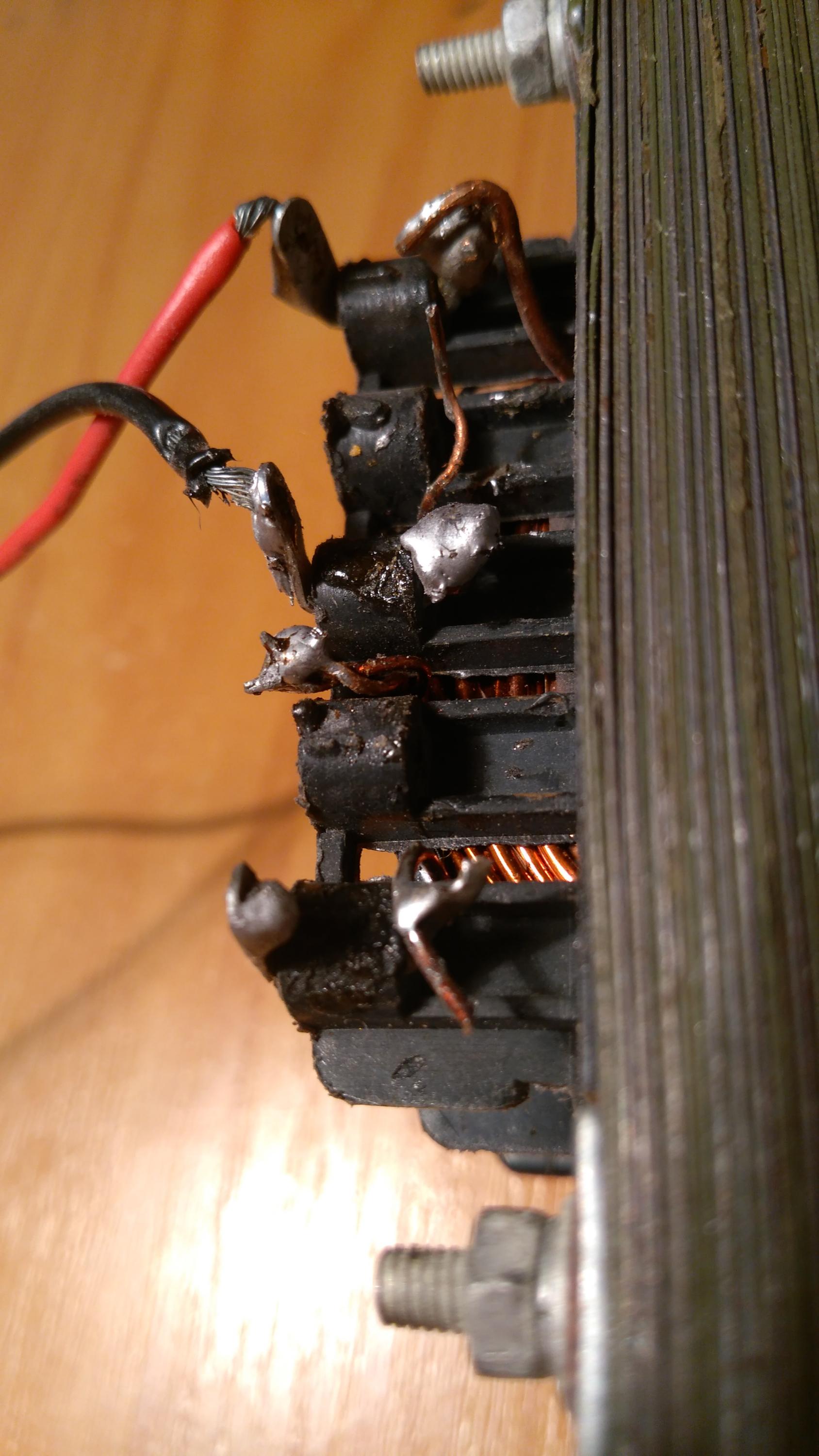

                          i think i have 24V and 10V/its marked on board/, but i have there three windings.
                          one 24V i think because of thicker wire/iron power/ and two with thinner wire connected in the middle - see picture. dont know why it is the second thinner winding with loose wire
                          there is only 3 connection pads so maybe it is two 5V winding connected together to give 10V
                          that 1st picture have bad marks/yellow/ because 2x5V winding come in mind later

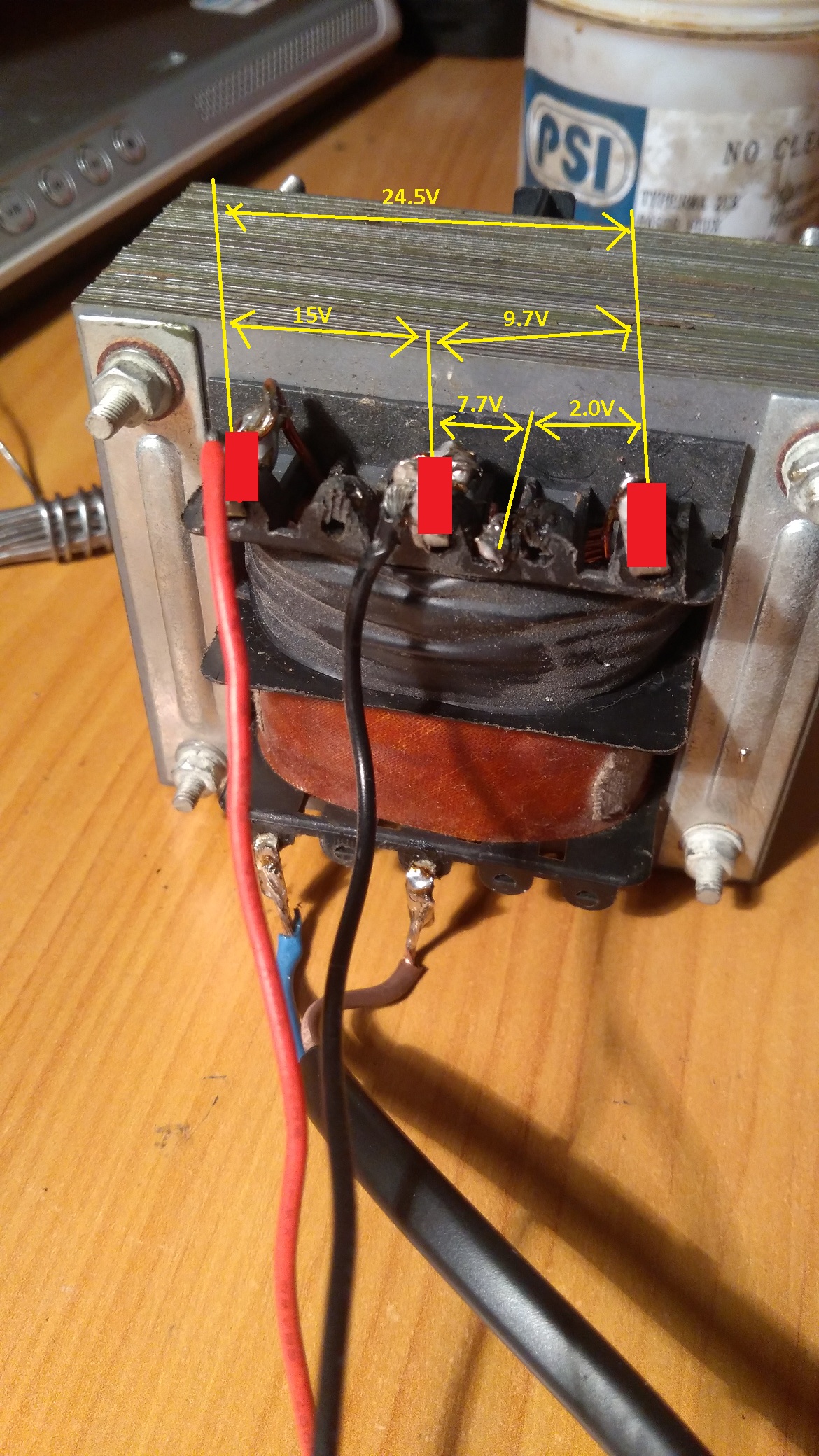

                            now i really dont know what to think about this chinese crap station
                            look at the picture with measurements
                              • 31044
                              15v to rectify and drop to 12v/5v for the logic, 24vac for the iron.
                              2v probably not used here - but handy to drive VFD heaters!
                              is that original?? every station iv seen inside had wires coming out - no solder tabs.

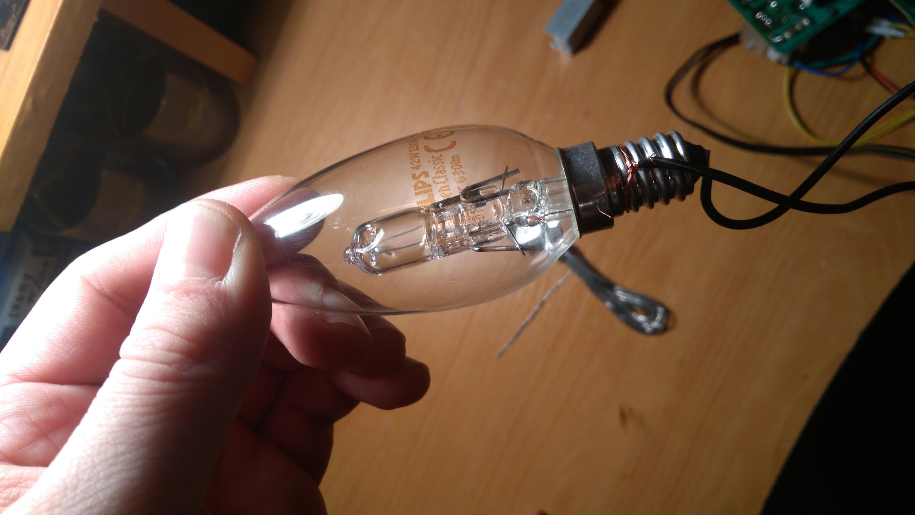

                                must open station and cut whole cables to get out connectors and find out what is going where.
                                i connect 10V to connector marked 1/10V which i think is for logic and 24V to connector marked 24V for iron heater
                                dont know why this chinas engineer marked +/- on resistive sensor, and 24V IN/GND when it is AC voltage
                                and i forgot that this station dont have main switch so transformer is still working
                                looks like everything is working but dont have voltage on heating for hotair heater.
                                maybe it is because of my sensor replaced by resistorand test load is bulb, so i connect it right to the station.
                                but i will test it at the morning
                                        and looks like we have a winner
                                        i take MOC3023 from iron heater and solder it to hotair heater and looks like its working.
                                        now i put everything to station and give a final test
