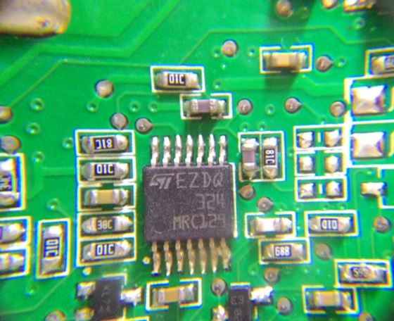

please help identify IC, repairing supermicropPSU

    Please help identify this IC with top markings: EZDQ 324 MRC129. It has an ST logo also. This is from the Supermicro PSU usually used for bitcoin mining. Thanks all

    Re: please help identify IC, repairing supermicropPSU
    Hi.
    Maybe Amplificator operational, LM324. Check pin 11 to GND and Pin 4 for VCC.
      • 31166
      seconded,
      LM324 quad op-amp.
      btw, it may be better to replace it with LM224 if it's failed.
      LM224 is the higher temperature version.
